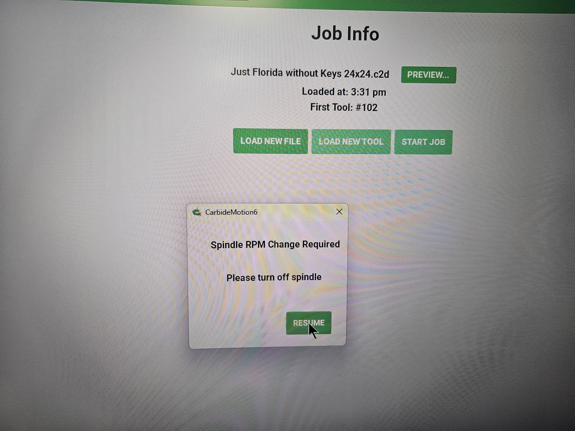

My spindle got stuck with a piece of wood wedged in the vacuum. I cleared it rebooted and am now receiving this message.
What do I need to do or did I kill the spindle?

Power down and unplug the power supply from the wall and reboot your computer and wait twenty minutes or so, then plug things back in and try the Setup Wizard — if reconfiguring doesn’t get things running again, check in with support@carbide3d.com we may need to walk you through deleting your preferences.
I did the unplug routine. Didn’t work. Ran through the reset and it worked!!! Thank you so much!!!
