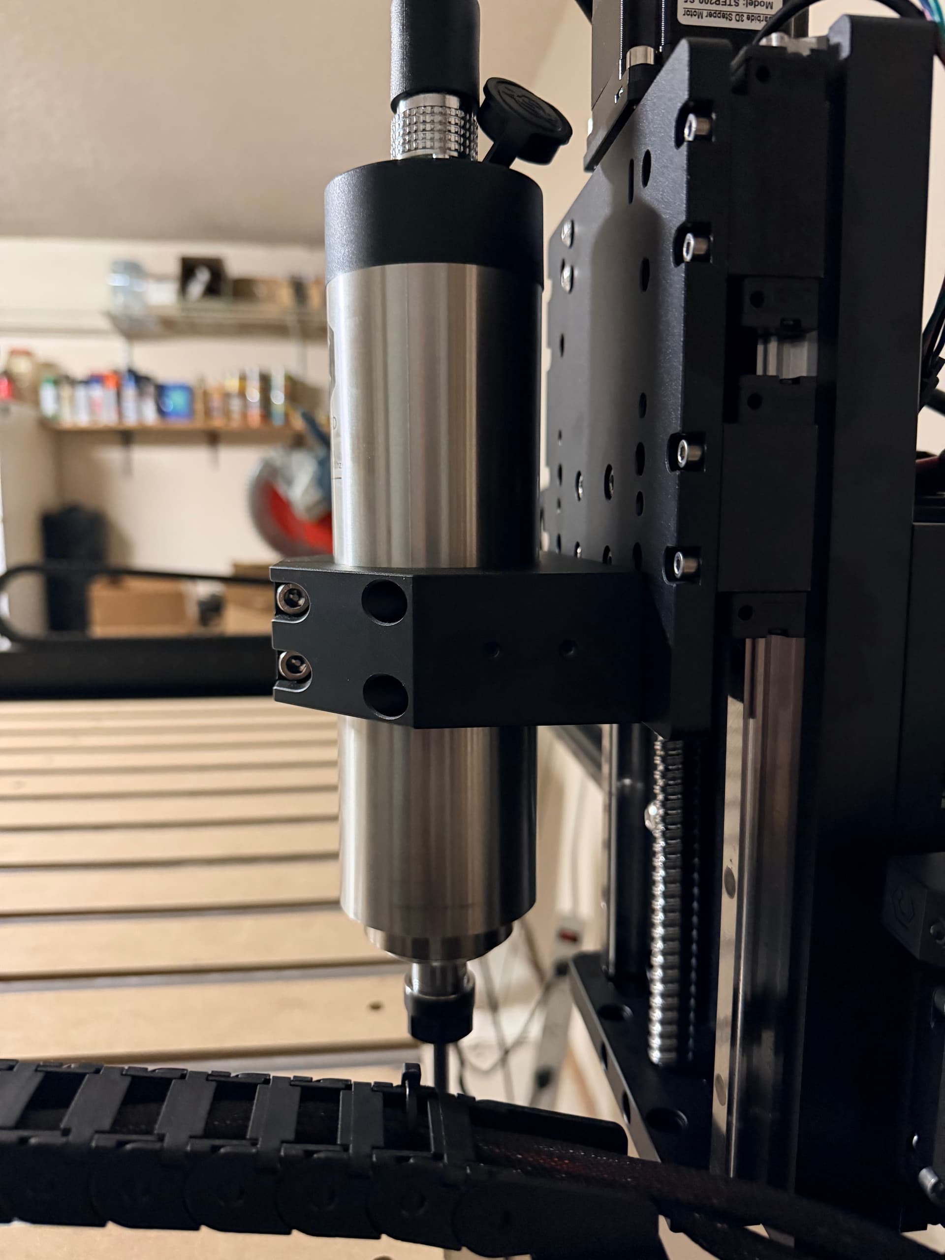

Just got done with assembling our new 5.1 Pro, however there were no instructions on how to install the spindle. So we installed using logic, but we really could not get an idea of the placement or height of the spindle on the plate. Any suggestions?

So we put the bit that came with the machine in and moved the whole HDZ down, but that would put the spindle right at the bottom edge of the spindle by the chuck. That didn’t seem right so we just measured about 4.5" from the end of the chuck to the bottom of the HDZ and tightened it down. Set up new machine went through initialization, and bit setter set and all seems to work. Tomorrow we will do our first cut and hope all goes well.
Can you post a pic of how you have it mounted?
@SweetSuthernBelz
I don’t have access to my machine right now but I believe mine is set at 2.5” from the bottom side of the spindle mount to the bottom of the 65mm spindle case itself.
@SweetSuthernBelz
That should be fine, as long as the Z axis will raise high enough with the longest bit you will use and clear the X gantry.
