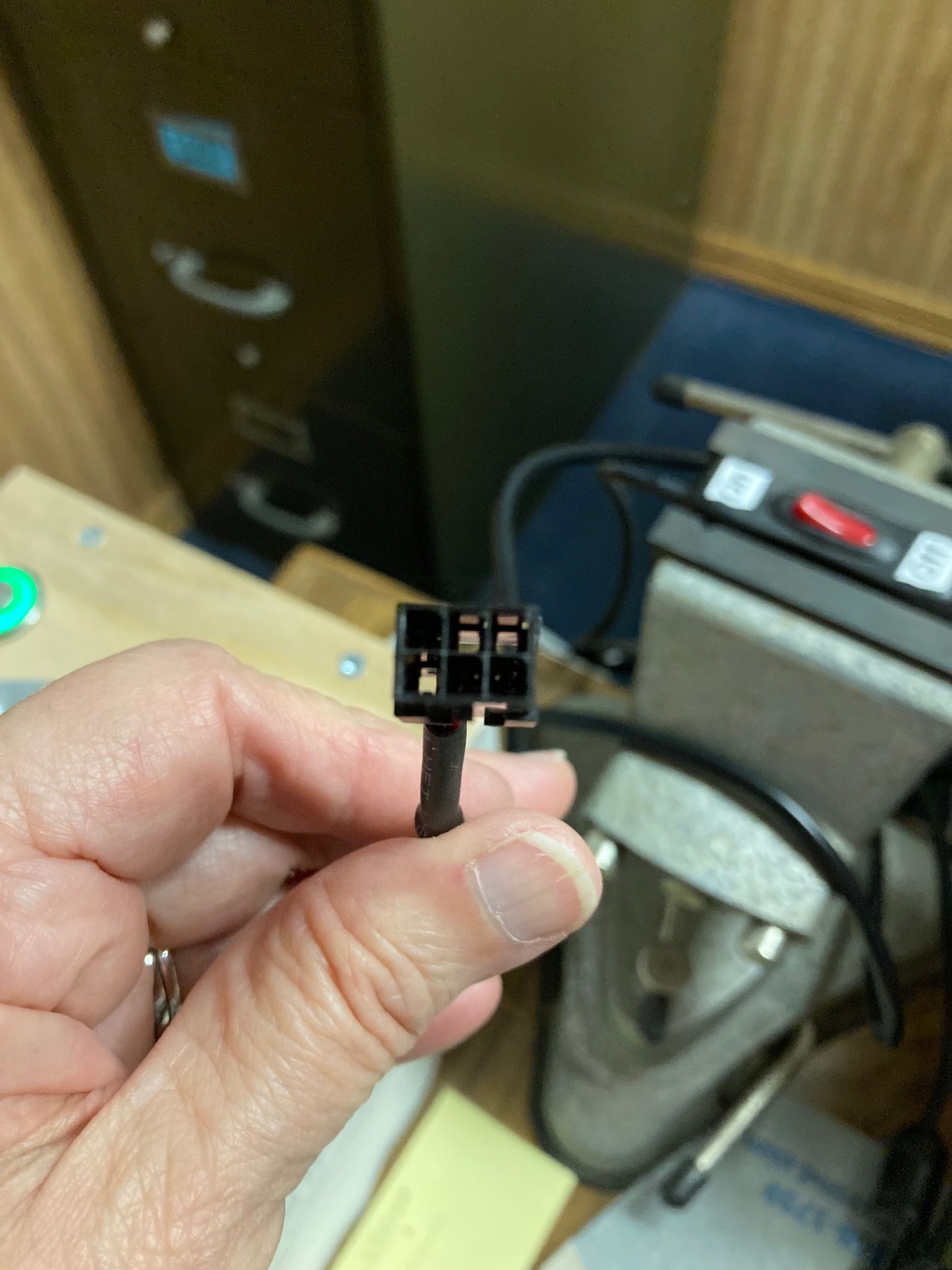

Trying to install the cable from a VFD (early version) to the controller of a Shapeoko 3. I purchased a new cable from Carbide3d (they carefully verified the P.N.) The connector slipped easily into VFD and clicked into place. Not so with the controller connector. I have read where you can easily damage the PCB if not extremely careful. I have taken the cover off the controller but the parts do not easily align. Is there a procedure or technique I am missing ?

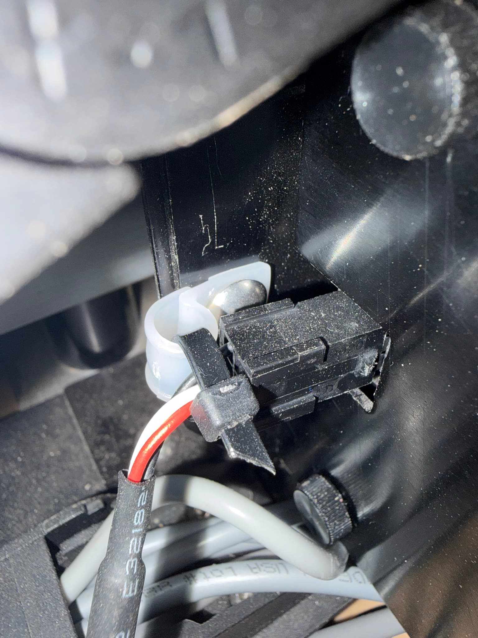

This is the connector on the Shapeoko 3XL controller board.
A new cable (verified as correct by Carbide3D support) was purchased but does not fit. I have read that this connection is VERY tight to the point of breaking the solder connections on the PCB if not VERY careful. I am working with support but so far no solution. Does anyone know what size or type of connector this is so if I have to resort to having a custom cable made I can. Hopefully won’t have to go down that road.

This is the connector on the cable that does not fit.
Is the connector on the cable a different size and wont physically connect to the control board connector?
When I upgraded to a spindle I found that connector was a very tight fit at the control board. I took the cover off the control box, held the board connecter against the board and pushed the connector hard onto the board connector. Also make sure the connector is correctly aligned pin to pin with the board connector.

I have the cover off the control board. I cannot get the cable connector to slip over the PCB connector to even try to push it on. I have verified I am aligning the pins correctly.

Looking at the two pictures it appears that the plug pin shapes do not match the controller board receptacle. I had a similar issue with my VFD controller cable, support shipped me a different cable that matched up. Apparently they have several different supply chains for connectors they use, I imagine this makes it very difficult on the company to keep track of who has what version.
Yeah that connection to the board is pretty fragile. I held mine in place with finger pressure against the connector then pushed the cable connector on. The connectors do move slightly and I’ve had to use a tiewrap to hold it in place so my VFD stays connected.

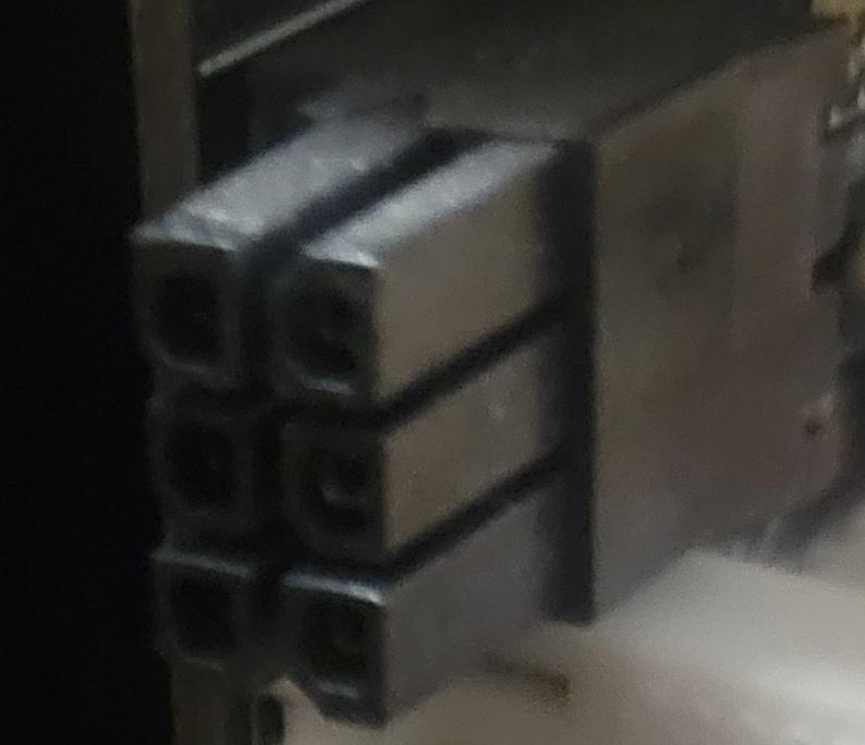

Its hard to see the plug and receptacle shapes in your photos, if the slanted corners of the plug match the ones on the receptacle then it should work.
It could also be that the pins in the plug are off just enough (out of center) that they are hitting the edge (metal part) of the receptacle.
Jarret:
After your posting of a new cable fixing the issue I took some careful measurements comparing the old (damaged cable - the VFD end) and the new cable.and found .005" difference in the length. Knowing where I needed to apply a little careful pressure (using a small rubber band to compress the fingers of the PCB connector) and direct pressure with the point of an Xacto knife I was able to slip the two halves together. After that I could apply careful pressure to push the two parts the rest of the way to make a snug connection.
