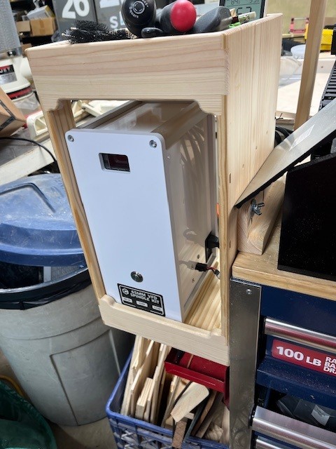

Ran out to the shop to illustrate

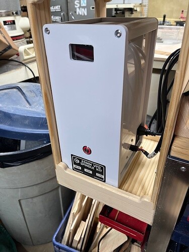

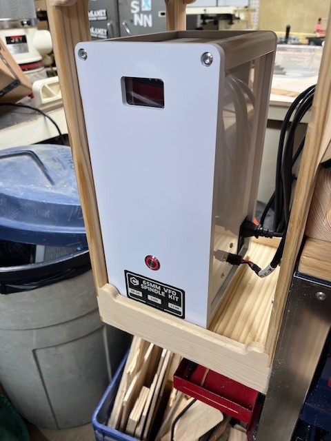

Picture of my spindle controller in various states
Following is the CNC is turned off and the switch on side of Spindle controller is off (no lights visible)
Next is CNC turned on and switch on side of spindle controller is off (enable switch illuminated, but no numbers in window of controller --sounds like your state)

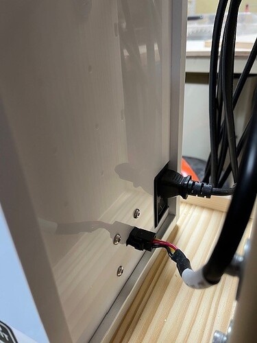

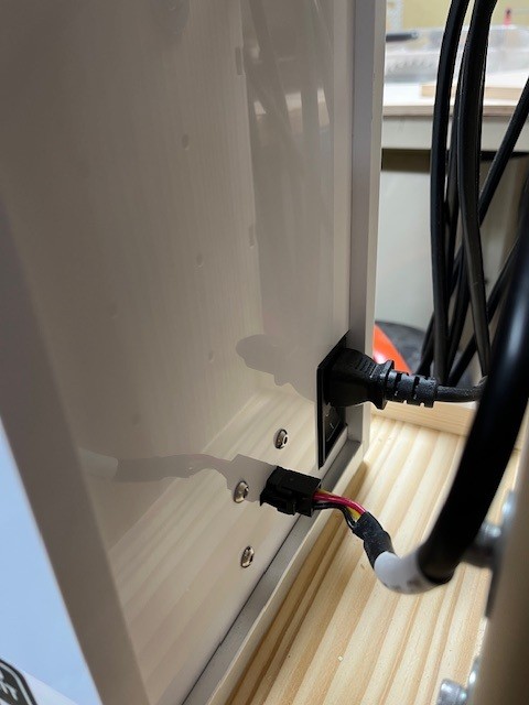

This is the power switch on the side where the power cable for the spindle controller comes in

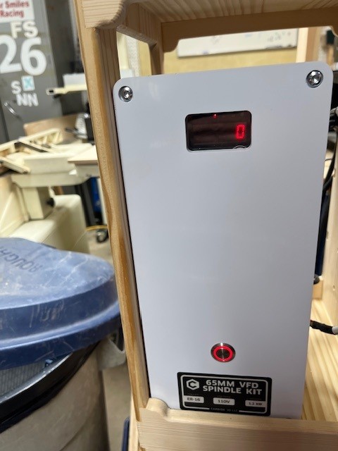

After turning on both the CNC and the switch on the spindle controller (enable switch illuminated, and numbers in the controller window)
Hope this helps

Did you verify that the main power switch for the VFD, the one located under where the power cord plugs into the VFD from the wall socket, is turned on?
Look at the third picture in my prior post
The NEMA power cord comes into the right side of the spindle controller. (This is the thicker cord to the back.) this supplies the mains power to the vfd controller inside the spindle controller box. Since I have the 65 mm spindle it’s the 110V from the wall (I think the 80 mm is 220V, but I am not sure), This is the one that powers the box that has the number display.
The enable/disable switch is powered from the cnc. (It can light up Without power to the VFD)
BOTH switches must be on for the spindle to run.
