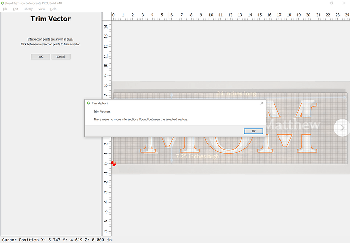

Convert the text to paths, draw a rectangle over it, then use the Trim Vectors tool.
This is pretty easily done.
First, set up the stock:
Then set the Background:
and adjust as necessary:
Set the text:
Then Convert to Curves:
Draw a rectangle:
Select everything
and use the Trim Vectors tool:
to remove all the geometry which is not wanted:
OK
Then use the “Join Vectors” command to close things:

Will, what do you mean by “Convert the test to paths, draw a rectangle over it, then use the Trim Vectors tool.”? I assume you mean TEXT and not TEST. But I cannot find that function in Carbide Create Build 743.
Yes, text, not test.
See the balance of the post.
The Trim Vectors function is available when suitable geometry is selected — see the step-by-step instructions in the balance of the post above.
