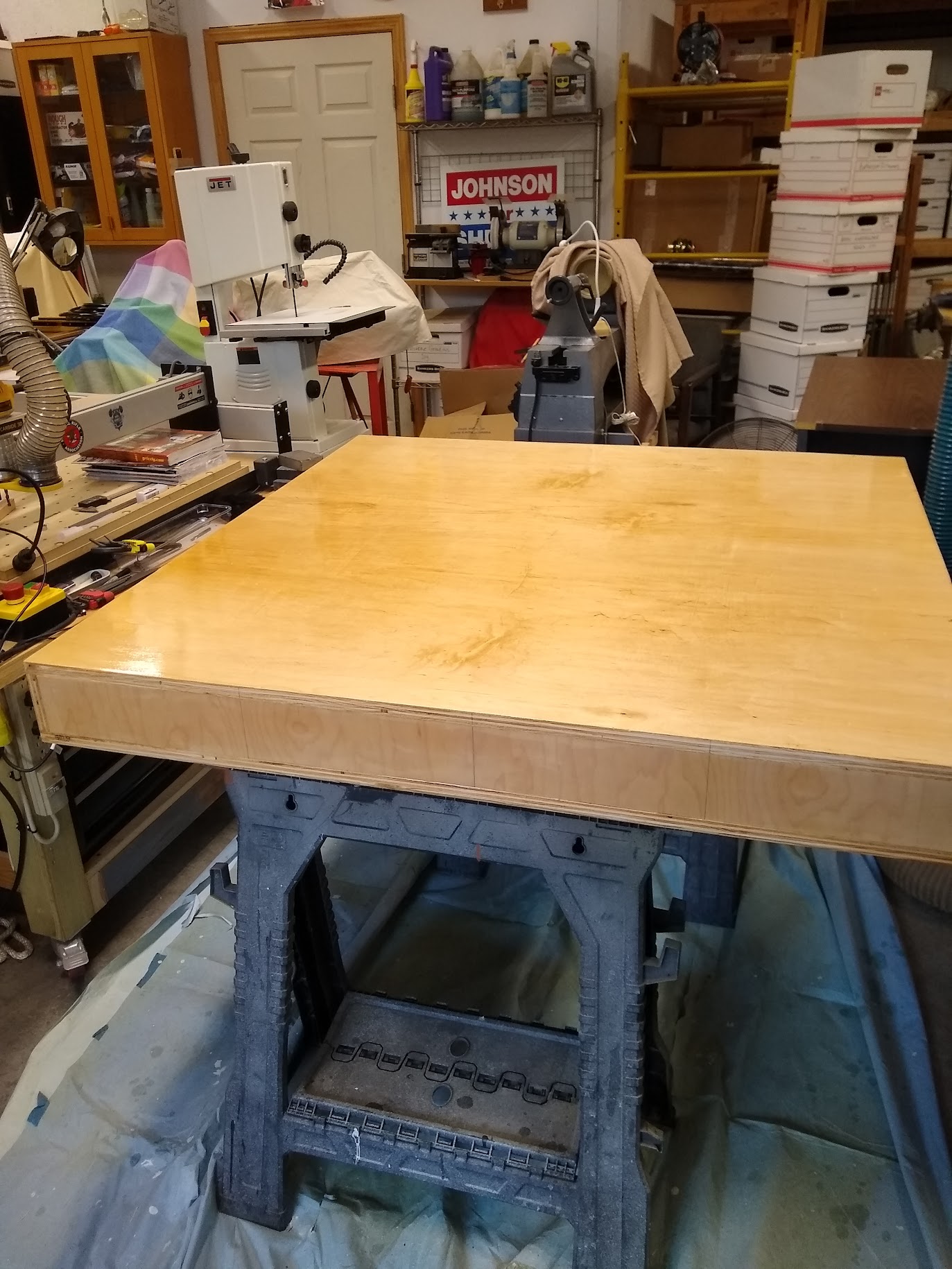

This may not help with your deflection but I built a torsion box. I only have a lowly SO3. I removed the leveling feet and put a 3/4" piece of rigid foam under the machine. I have never measured for deflection of my spoilboard. On my SO3 they have a 3/4" piece of MDF for the base and then I make a 3/4" MDF spoilboard that has 1/4" Tee nuts and I use cam clamps and a big L fence to locate projects. A torsion box gives you a good stiff base for the machine to sit on. Torsion boxes dont deflect like a table with a plywood/MDF top that the machine sits on. Making a torsion box is not all that hard but could help with giving you a solid base for your machine to sit on.
