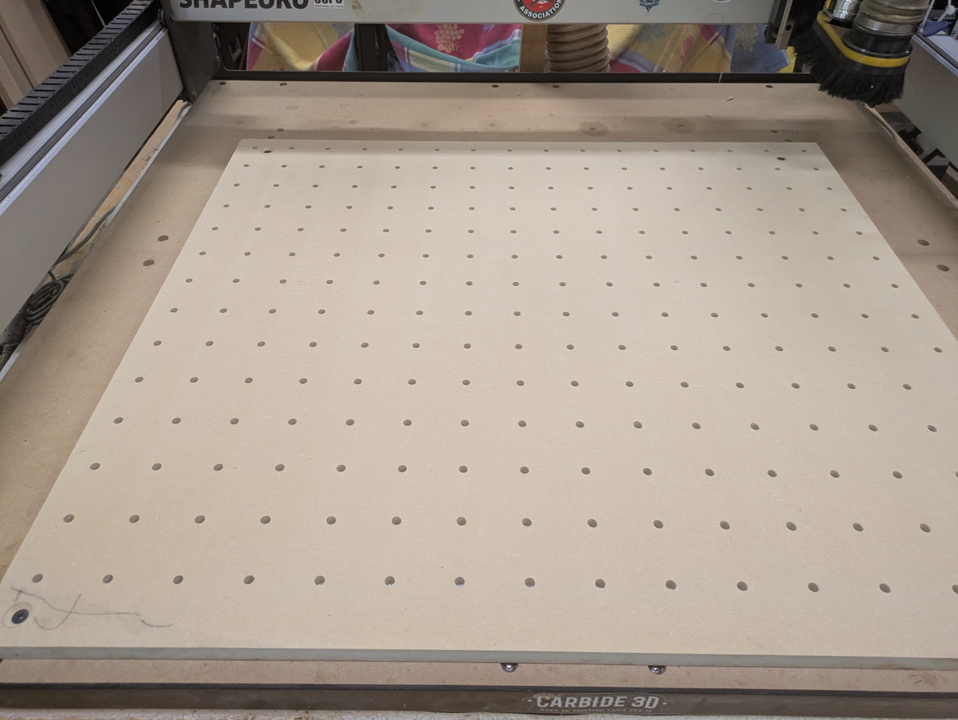

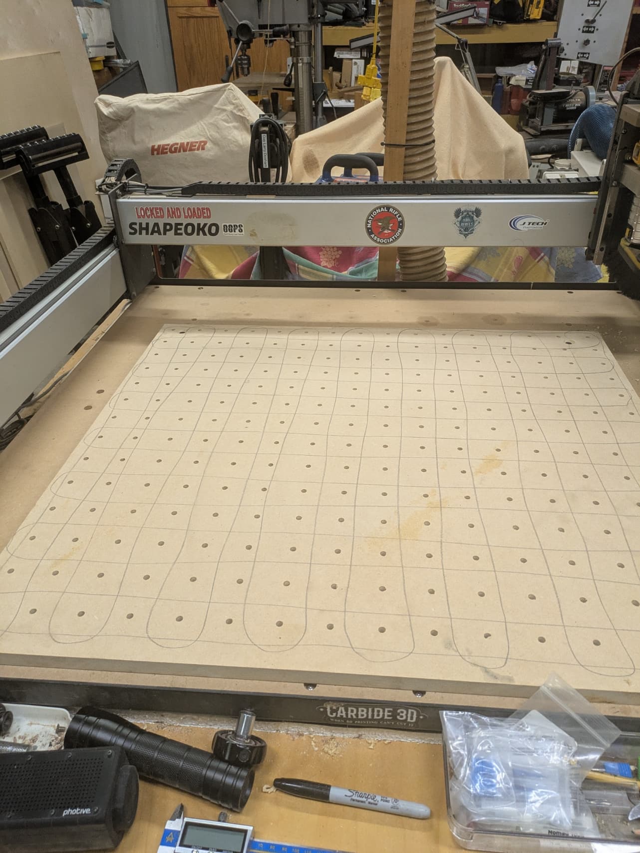

I decided to replace my spoilboard for my SO3 XXL. I make mine 29" x 32" and have written up why it is that size. I was able to reuse the tee nuts from the last one. After machining the new spoilboard I flattened it. I had to run the flattening file twice. The front was somewhat lower than the back half.
The very front two corners still had pencil marks. I likely wont run the flattening program again but I might. It is just too hot today to run it again.
I put pencil marks all over the spoilboard so I would know when it was completely flat.
As stated above my old spoilboard is about 3 years old. I have not had much scarring on it since I started using bottom of material instead of the top. I did have one bad one that was my fault but kept using it. I had bought a sheet of mdf about 6 months ago and cut it to gross size and was tired of moving it around. So now I have a new flattened spoilboard.
