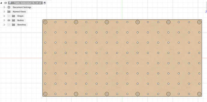

I’m getting ready to cut my first full-size spoilboard for my Shapeoko XL. Since I’m in metric-land, I’m looking at 50mm hole spacing and 8mm holes for my threaded inserts.
All of the Shapeoko MDF spoilboards I’ve seen have had a regular grid structure, like this one:
However, I’ve seen some aluminum fixture plates where the rows are offset
Have any of you created your spoilboards with offset holes? What are your thoughts on it?

I rarely use my threaded inserts, but I use 8mm dowels for alignment on most jobs.
I’ve agonized over this sort of thing, and have determined that the next time I do threaded inserts, I’ll machine holes through the spoilboard and into threaded insert board as/where-needed, and then finish drilling the threaded insert board and then install the threaded inserts from underneath to that I’ll be confident each hole is used at least once.
The thing about uniform spacing for your spoil board is you can make jigs to hold irregular or special shaped objects. I made some minimalists wallets out of glued up veneer and I made a jig to hold the thin and flexible material down. I also made another jig to hold down some round knobs so I could carve on the top of them. Both of these jigs had holes in them so I could bolt them down on my 2 inch grid of holes.

So having an even spacing it is easy to make jigs for special purposes.
