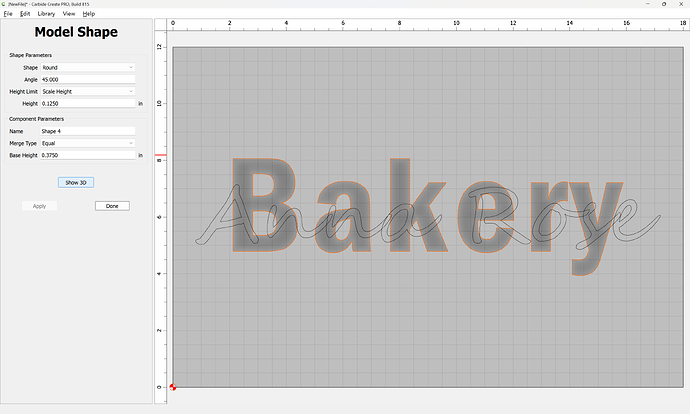

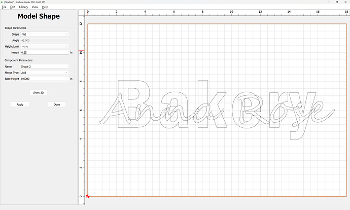

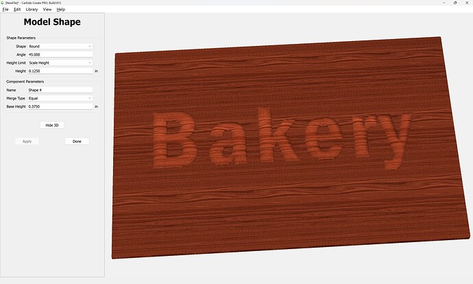

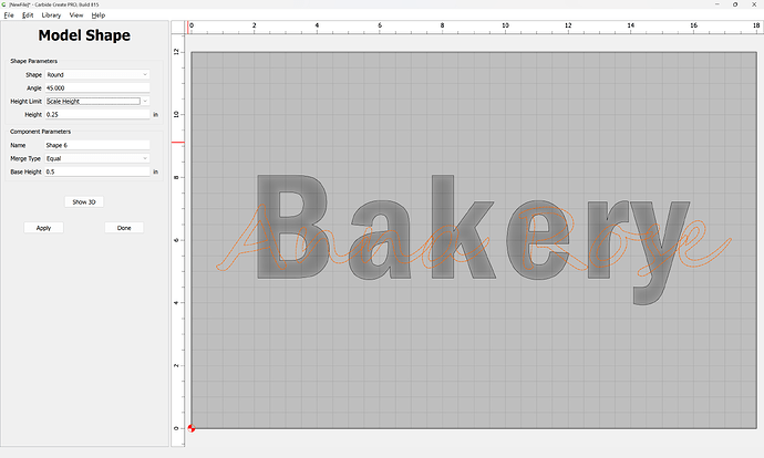

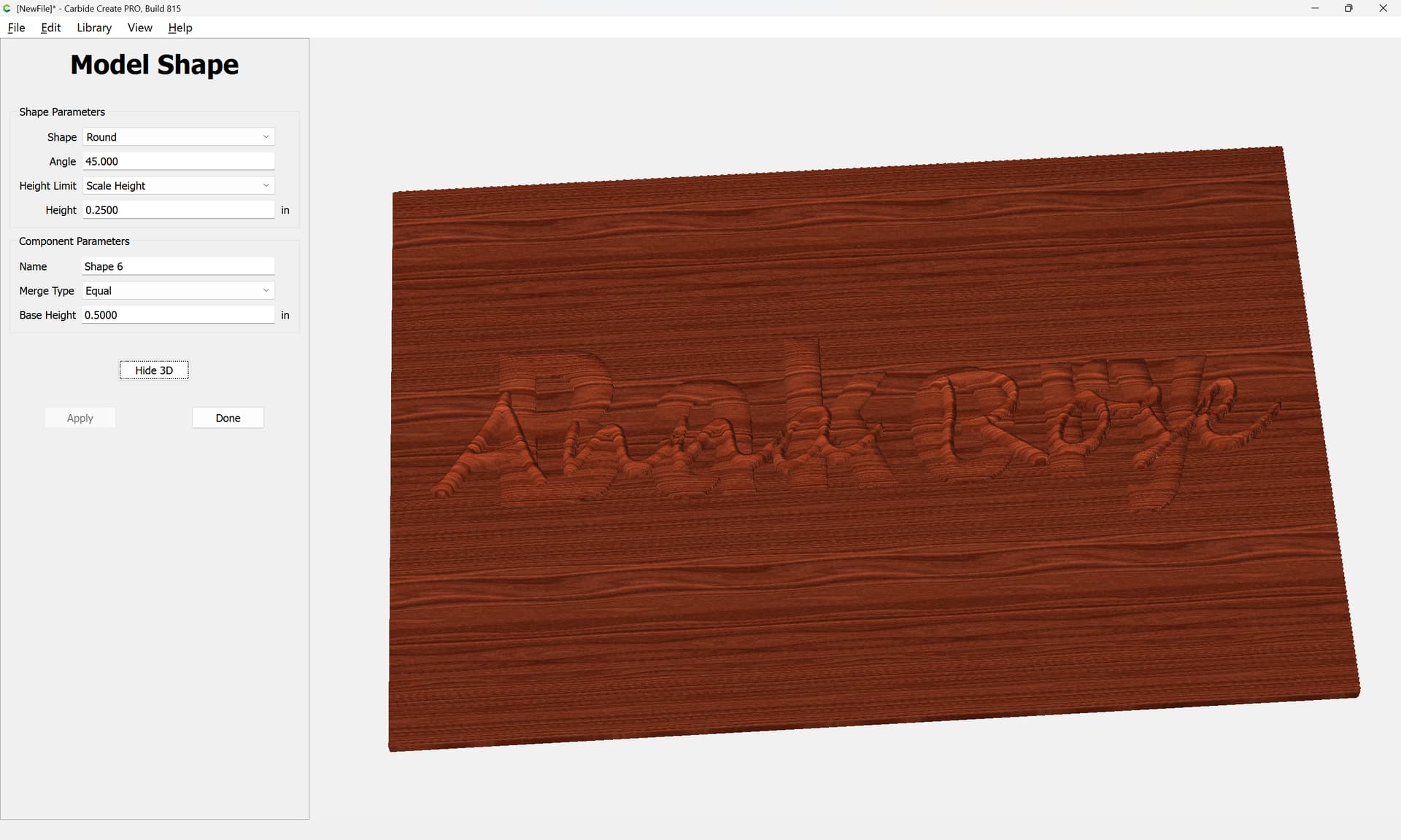

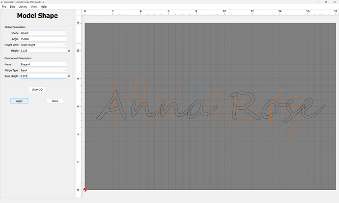

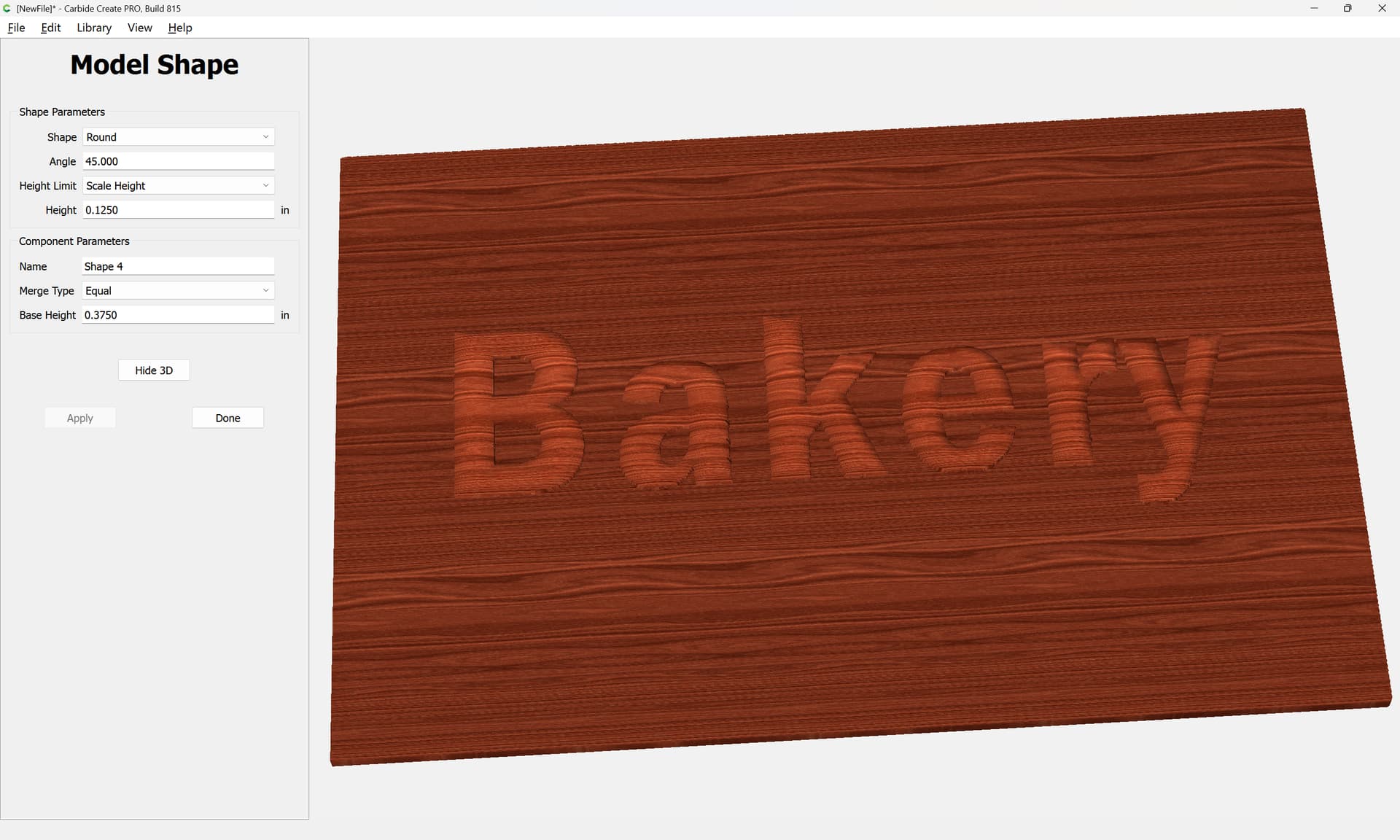

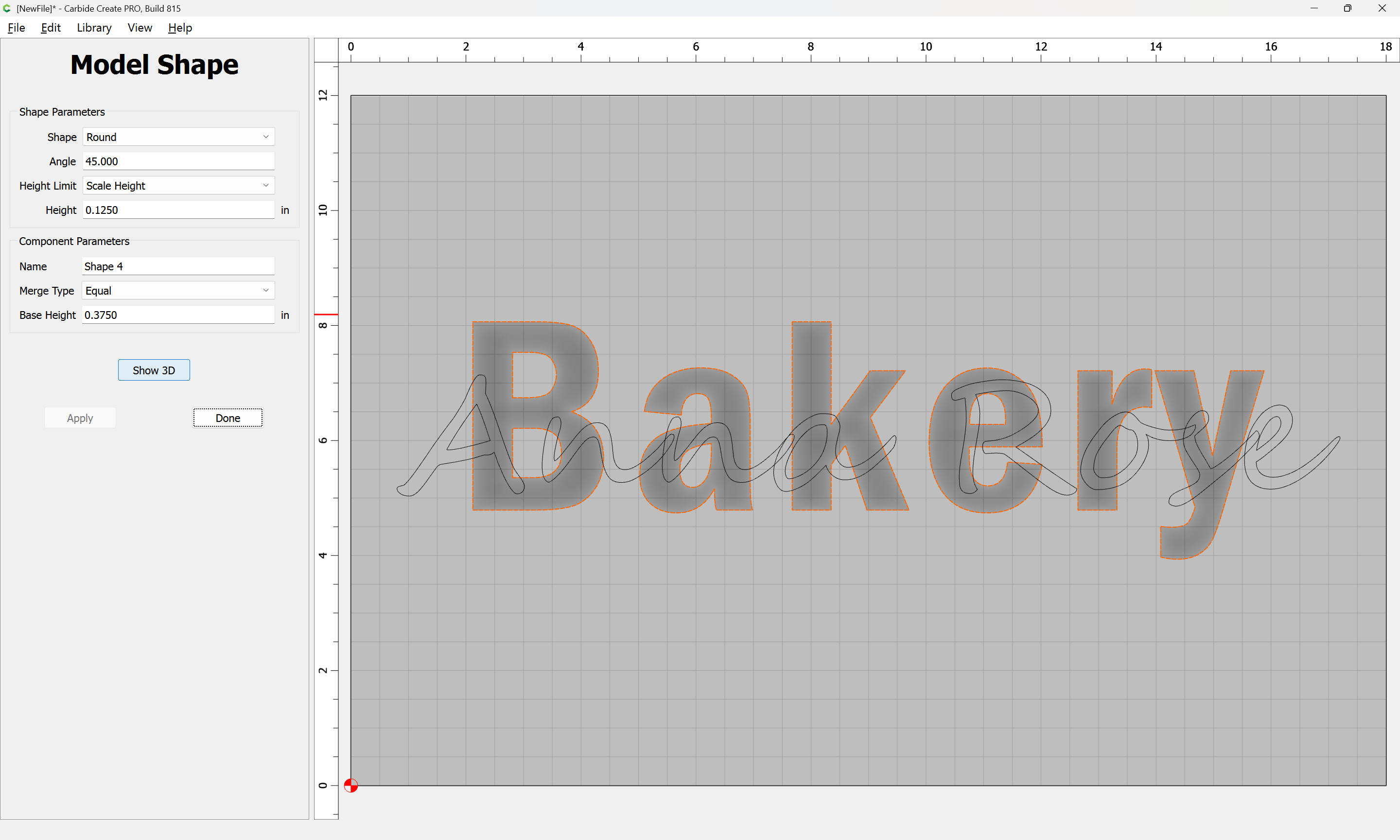

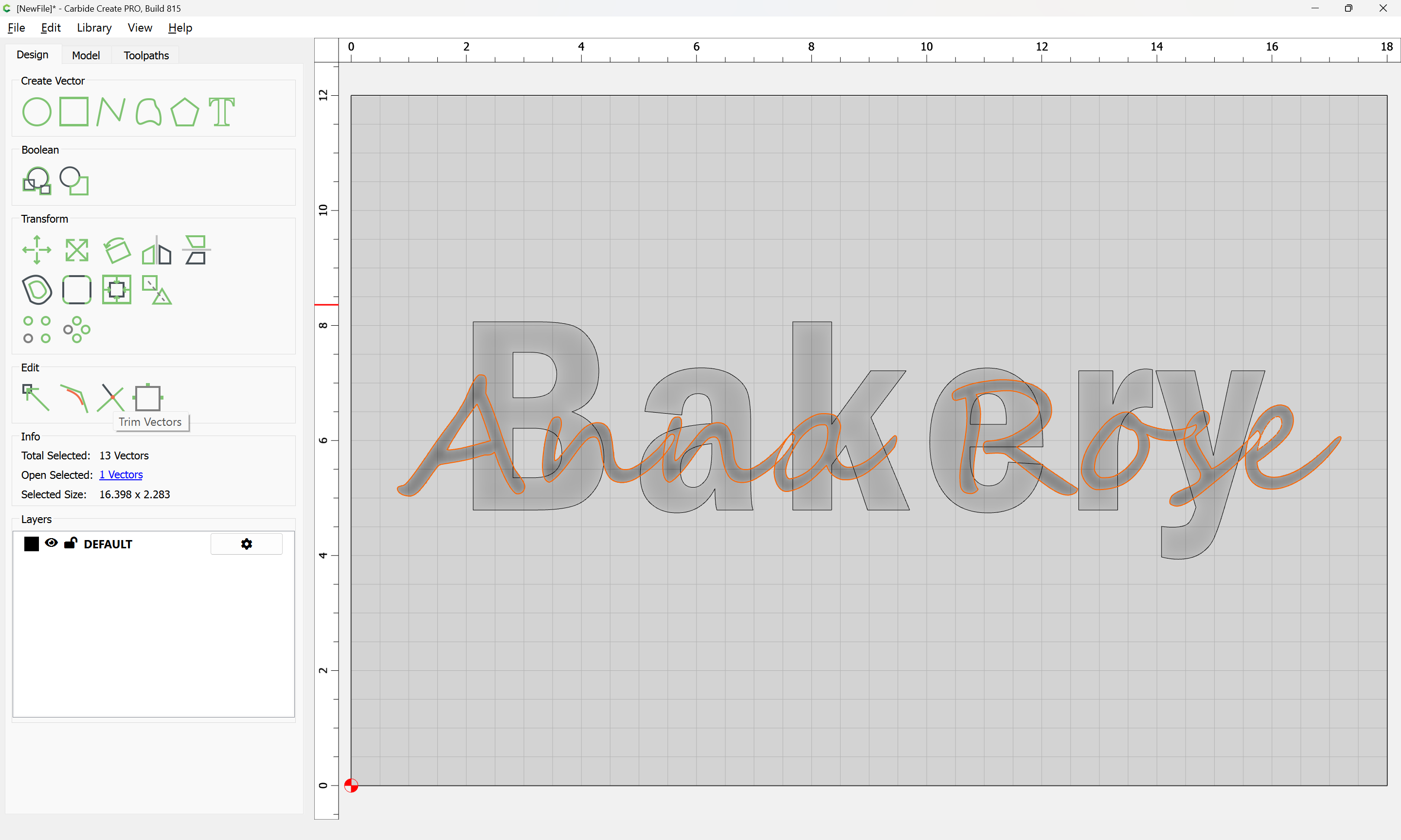

Given the desire to make a rounded design, we draw up something like to:

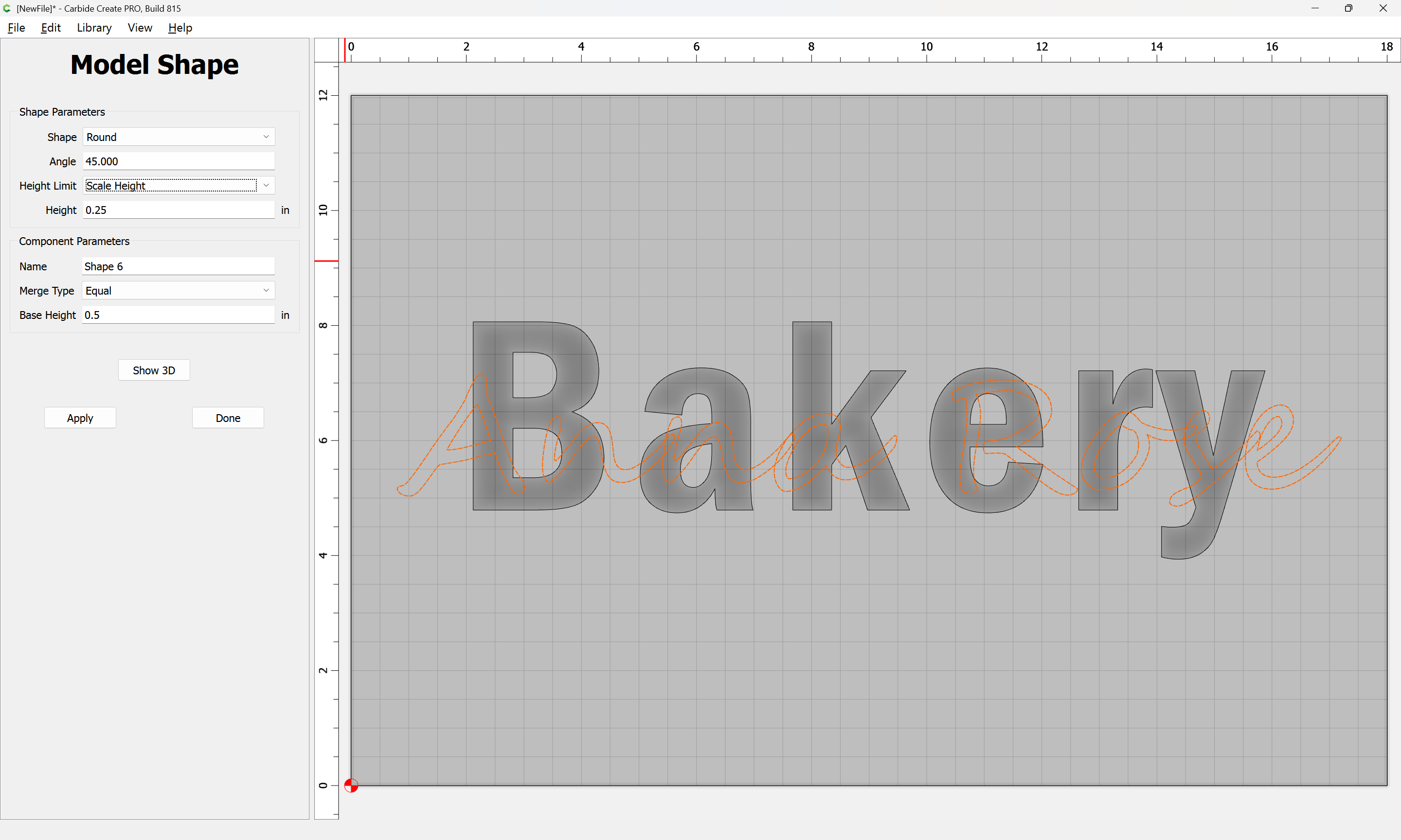

and then model it as:
and then:
Apply
Show 3D:
Apply
Show 3D

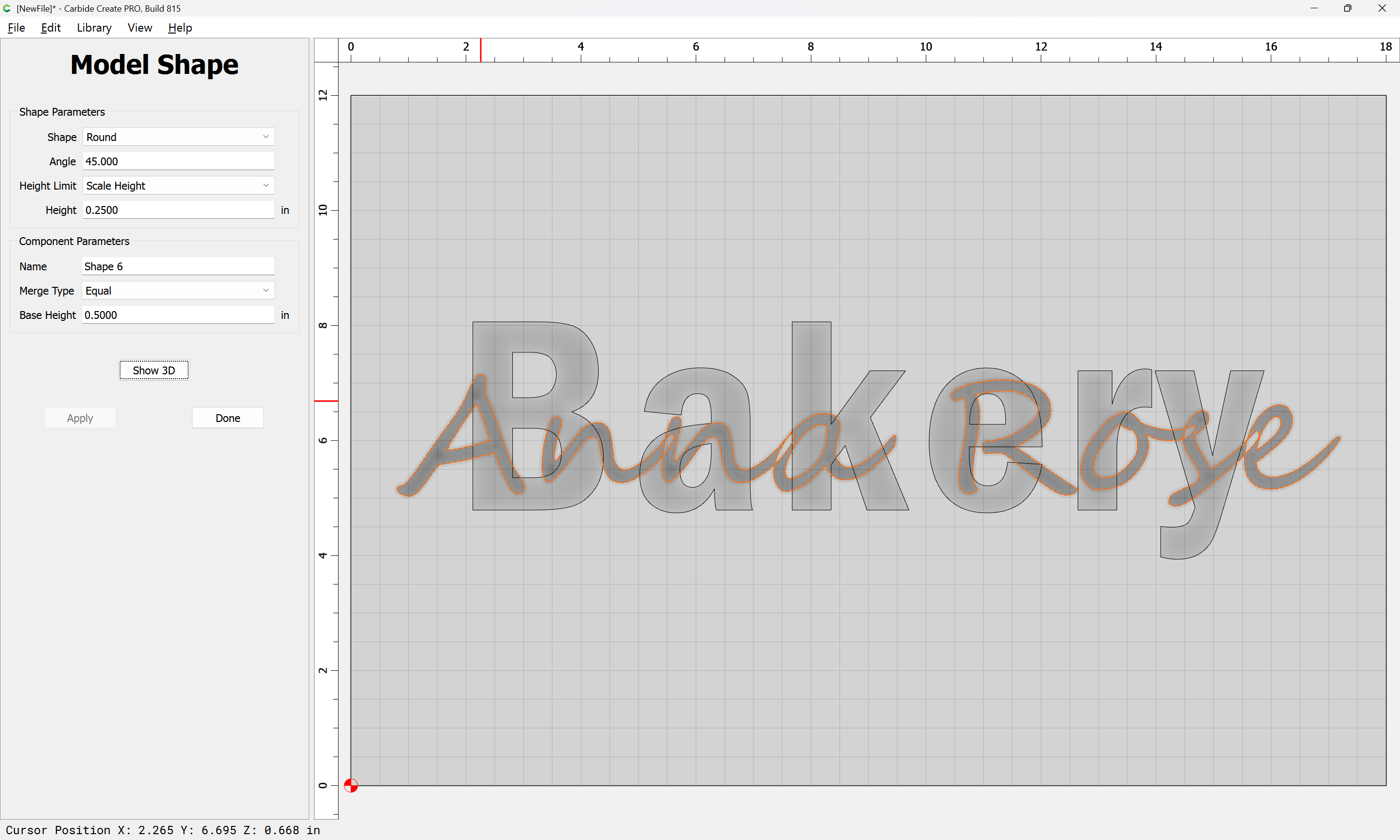

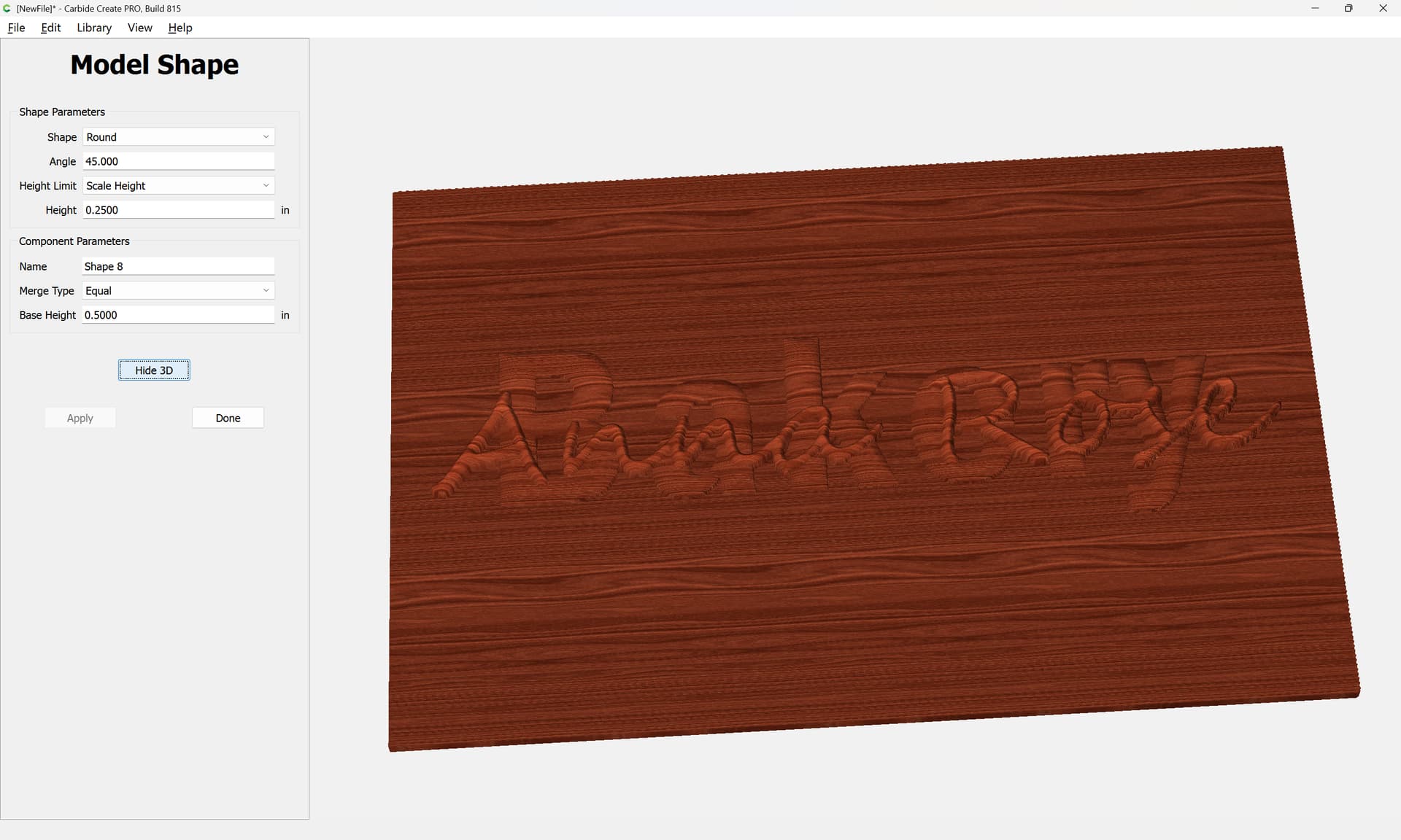

The things which make this work, as an examination of the 3D modeling settings will show are:
- assigning a Base Height
- scaling the Rounding
- assigning the Modeling type to “Equal”

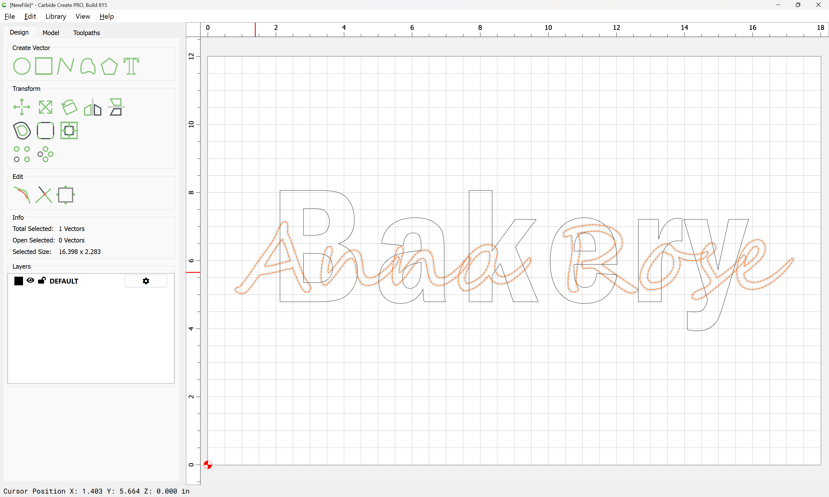

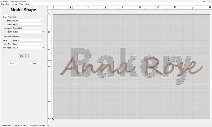

Obviously it will be necessary to Boolean union, or use Trim Vectors to join the joined text so as to remove the overlap, for that see:
https://carbide3d.com/blog/merging-script-fonts-in-carbide-create/
WillAdams
(William Adams (Carbide 3D))
3

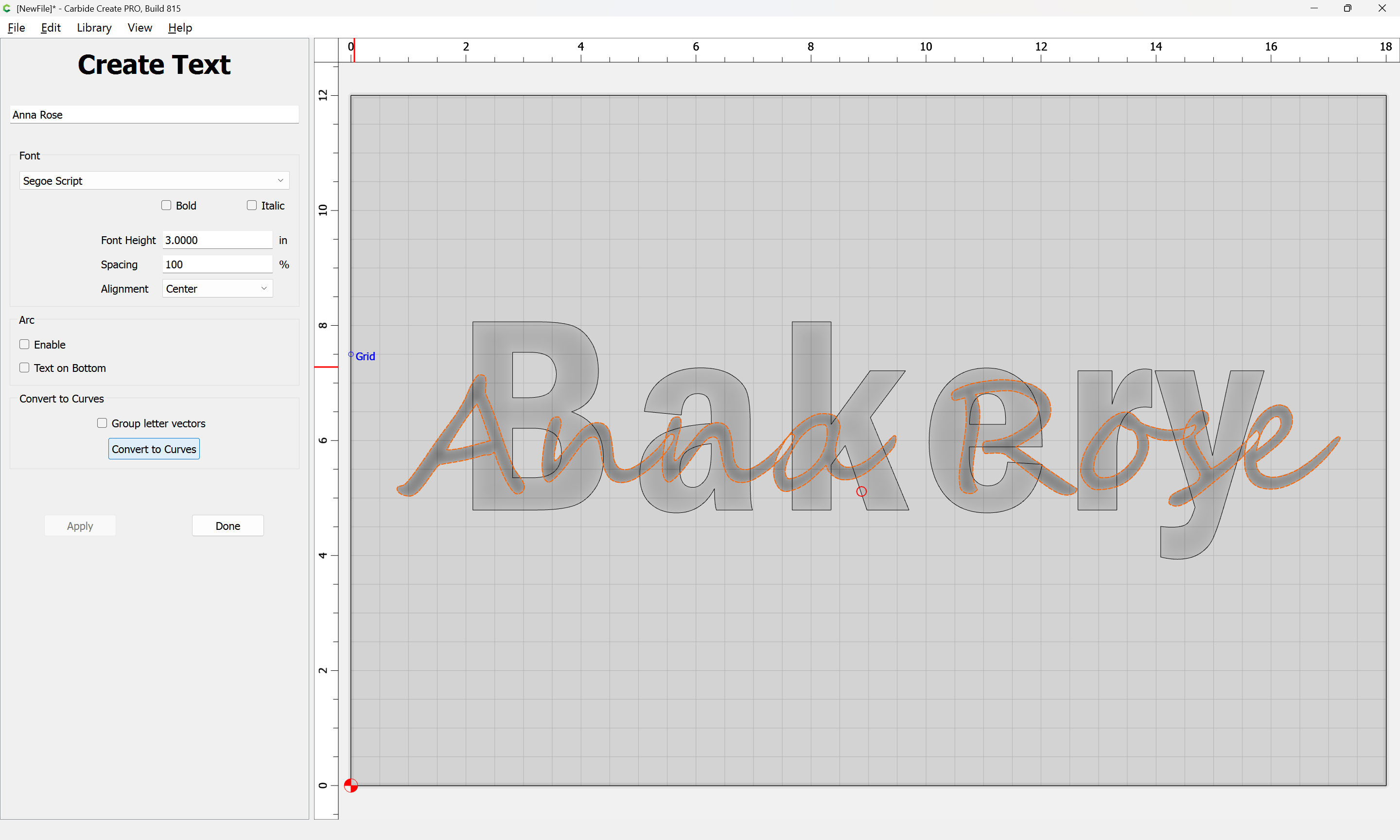

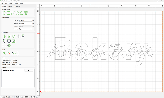

Basically, Convert to Curves in the Text object:

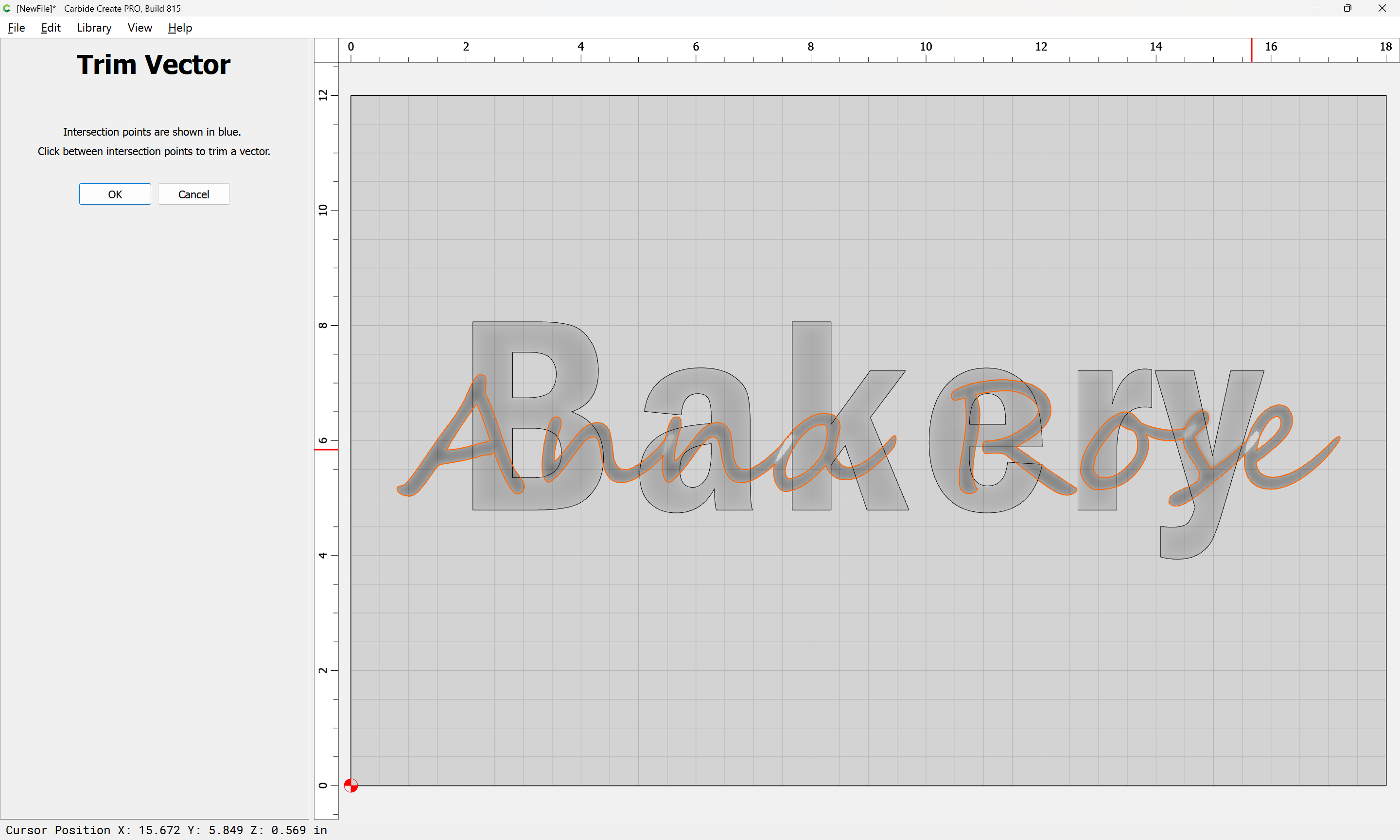

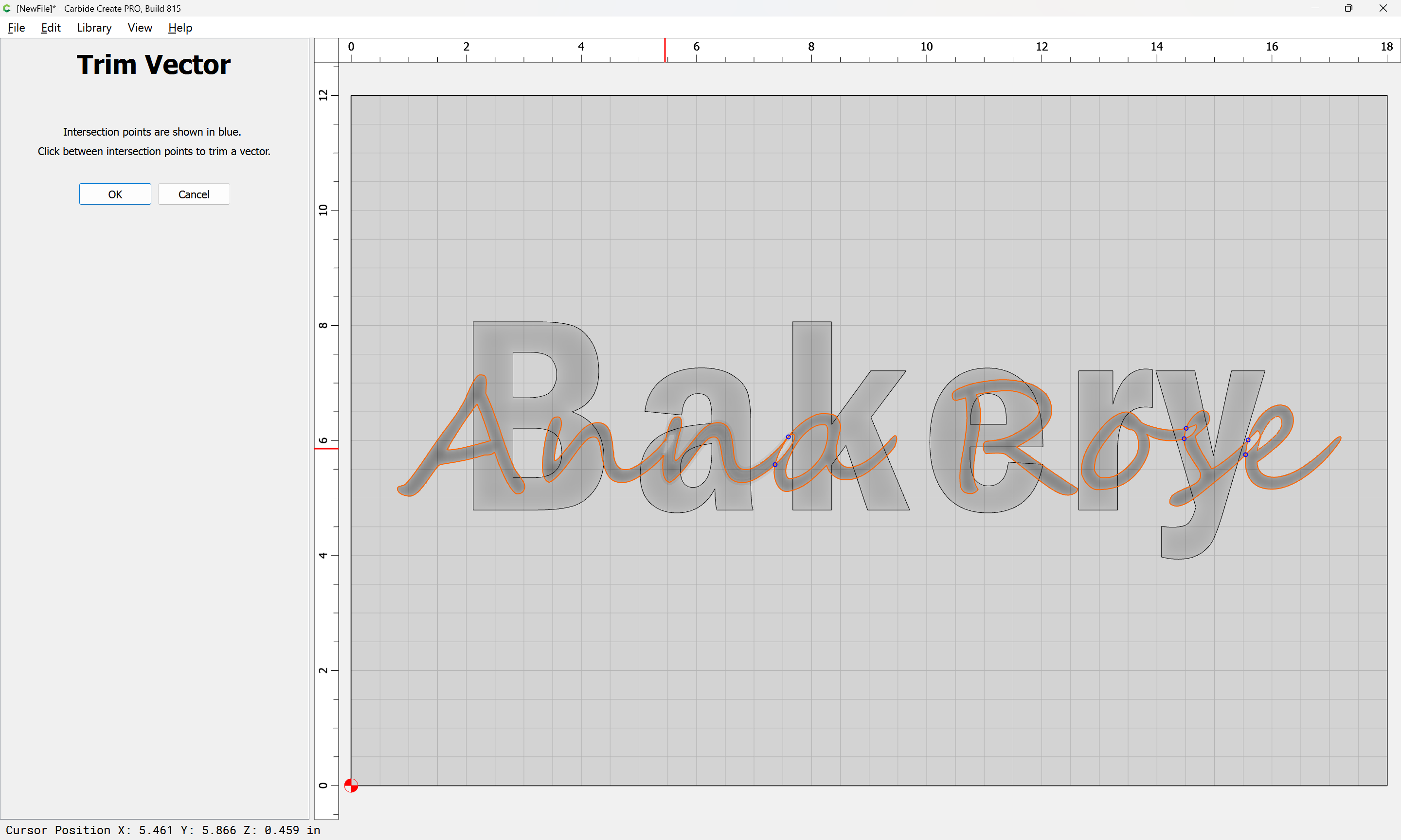

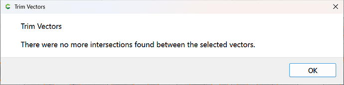

Trim Vectors:
Remove what is not wanted:

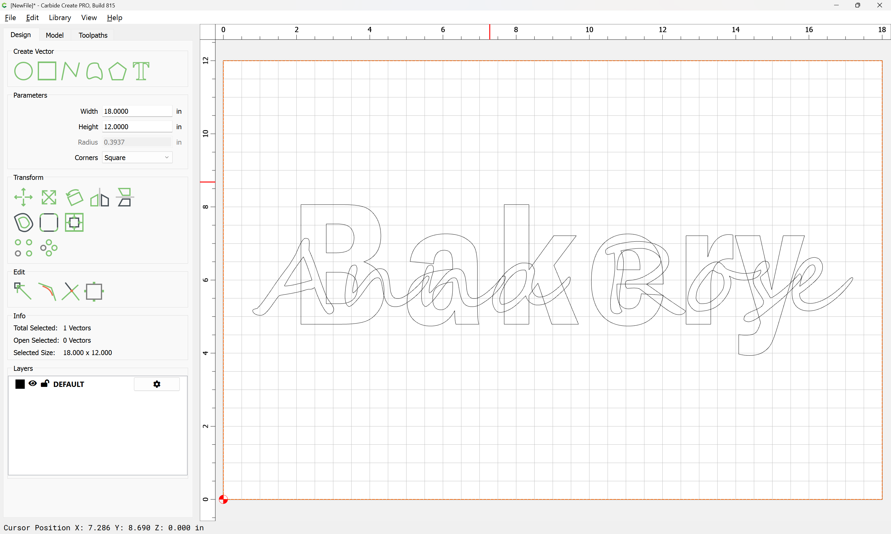

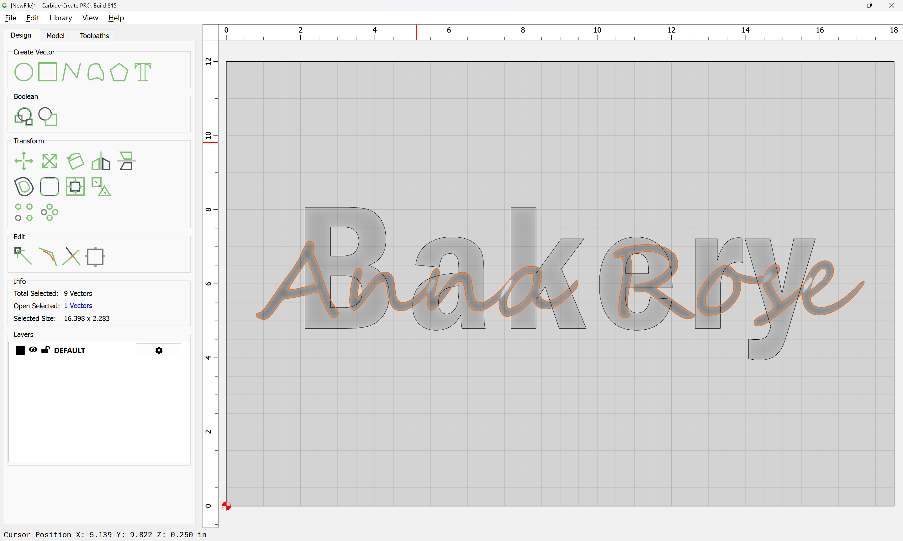

until one arrives at:
OK
OK

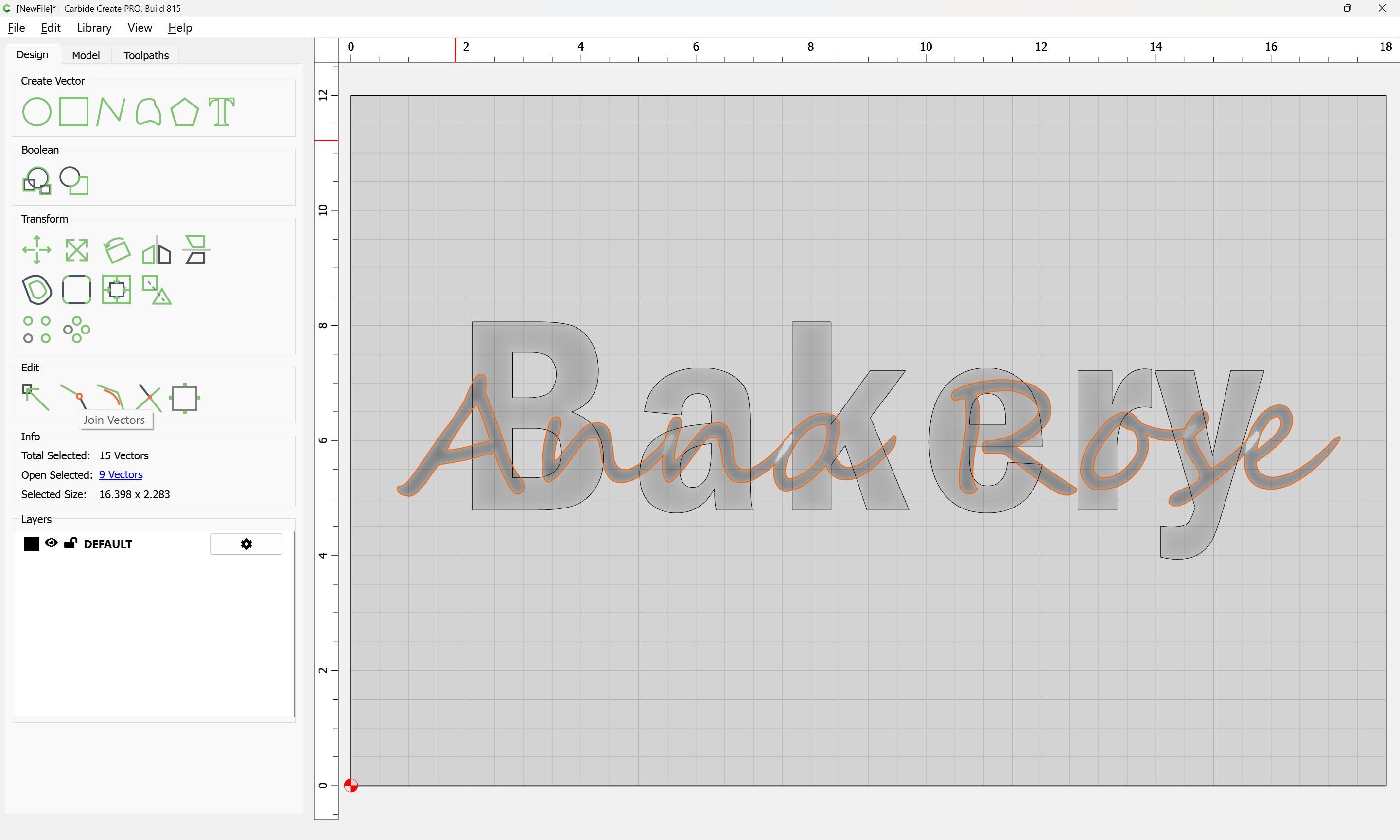

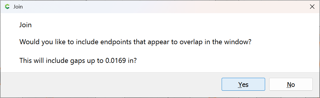

Join Vectors
Yes
n

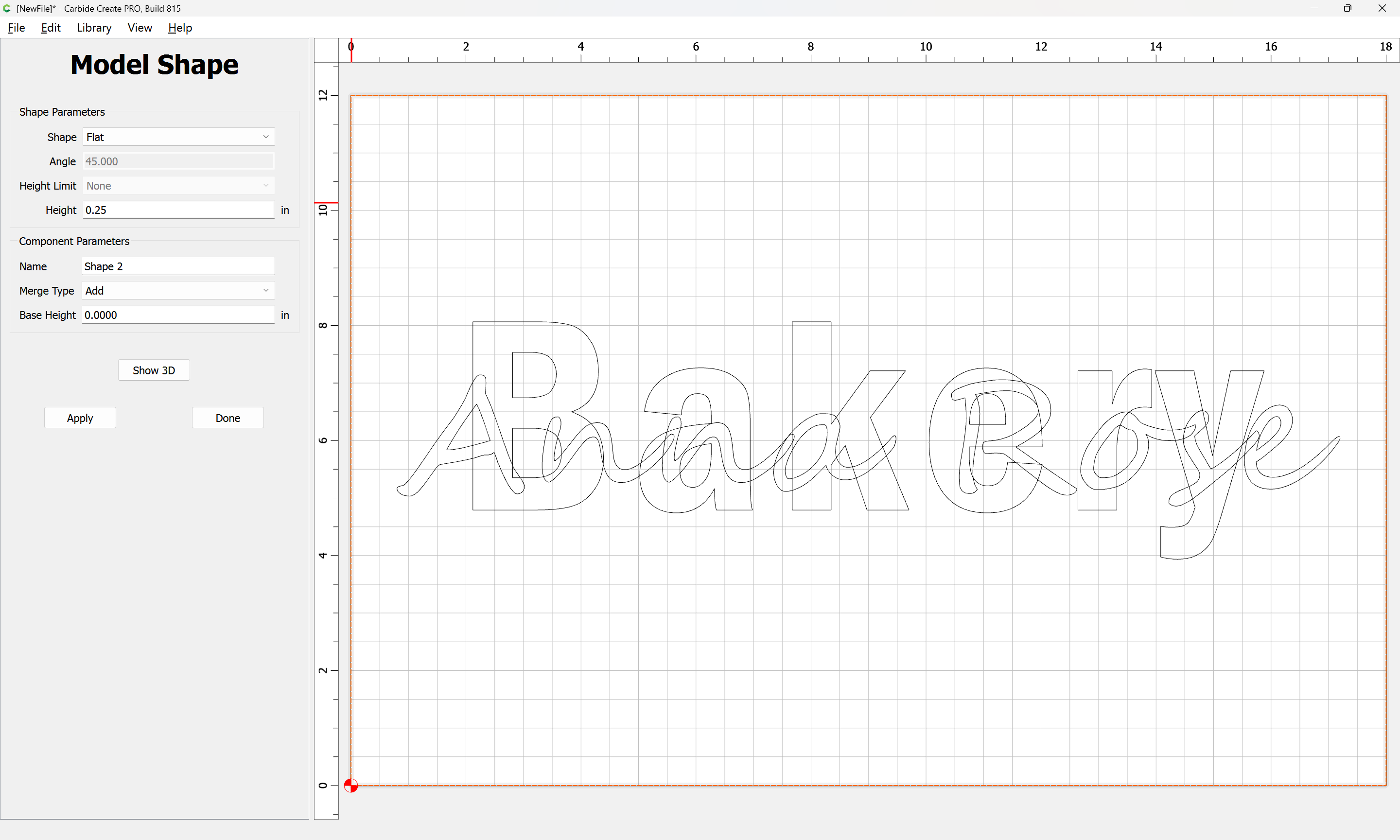

and re-make the script text 3D model:
