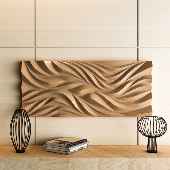

Do some sort of 3d texture over that space?
Something like this:
Then paint it all white, so that it looks at quick glance to not really be much, but has some neat detail?
@WillAdams : it’s a small hallway, no other function in that space, it’s a transition area between different parts of the house. This will be a shoe cabinet for the Mrs.
@Radiation: yes that was definitely on my radar and I had pre-selected a few textures like those, but I thought it would be “too much”. Now, the “painting it all white” may well be the ticket, along with making the 3D pattern subtle enough. Thanks! One complication is that I still need to fit handles, and if I go with a 3D texture I’ll need to plan for attaching them (or somehow carve the handles in the design directly)
A 3 dimensional texture w/ subtle/integrated handles seems like the best fit (shades of the bed for the young Paul Atreides in Dune which had one manipulating parts of a decorative wave carving for various room controls),
So a series of vertical textures (that should minimize their catching dust) w/ the larger, more prominent features working in/hiding recesses for handles.
