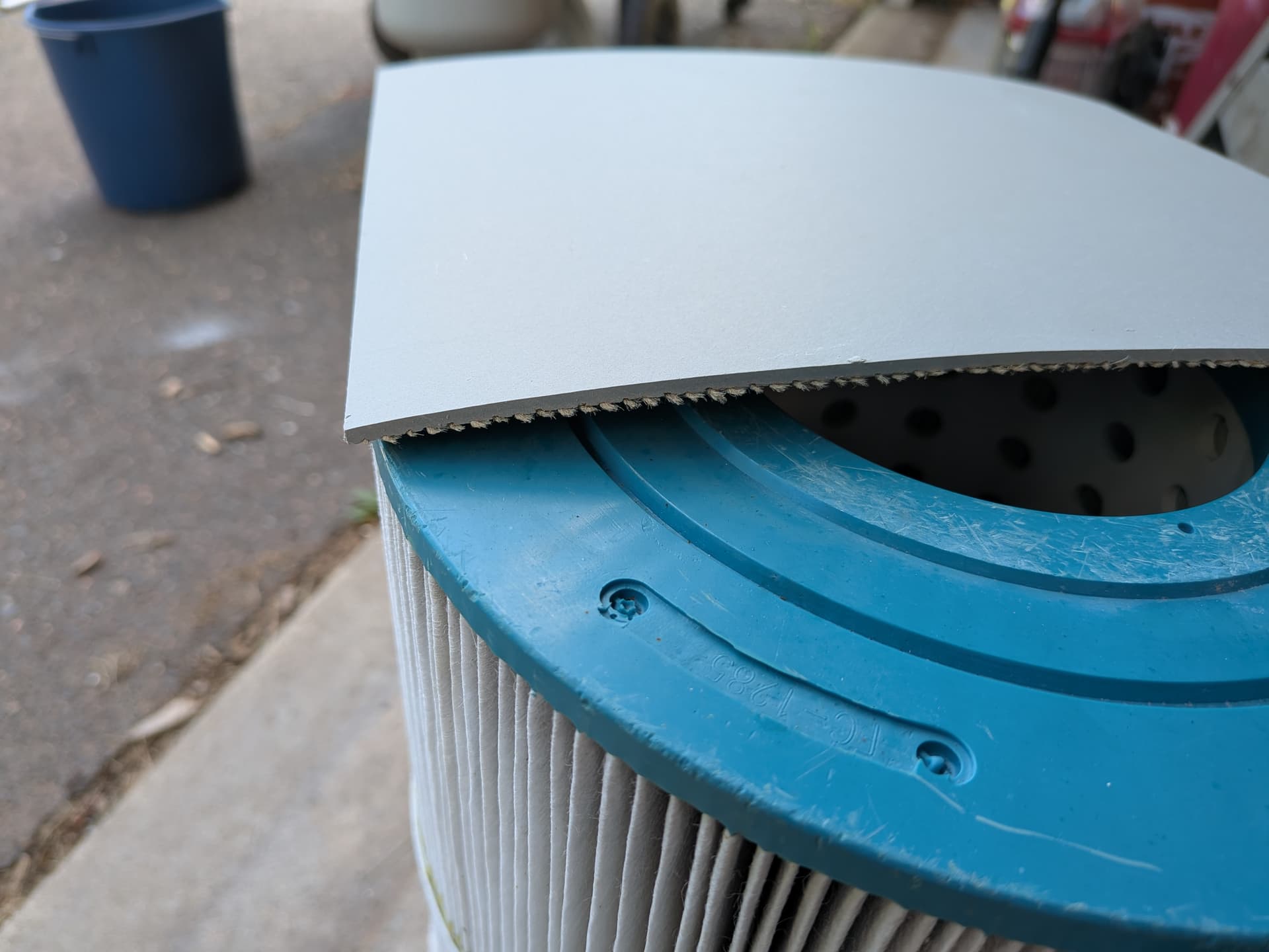

This is a different material but it may help some.
Anthony
That material is generally Linoleum with a fiber backing to withstand the abuse of repeated inking and pressing.
I’ve cut a bunch of that linoleum stamp material. If the plan is to make a stamp with a back to it, I’d add the stiff backing material first to aid in work holding.
As far as cutting goes, it cuts about as easily as anything you could try. No need to freeze or anything. Feed very fast and cutting in two passes will help with the “chips”.
