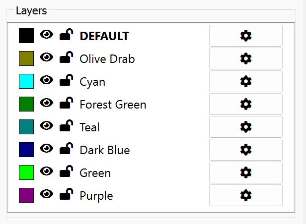

while the default layer colour/ordering for Carbide Create seems to currently be:
Usually I use Cyan for reference images (since it matches the guides in Macromedia Freehand) — anyone have any especial preferences or habits?

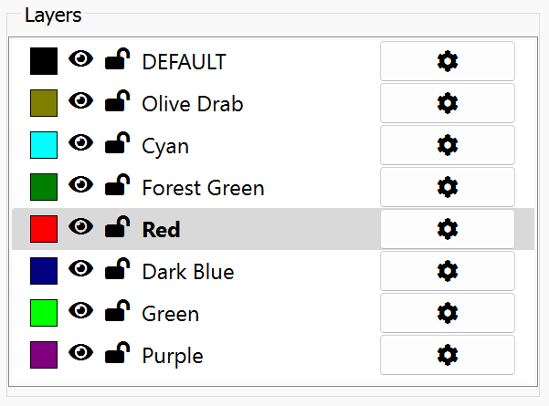

which has only a few matches. Given that Teal is potentially confusable with Forest Green, my inclination is to get in the habit of replacing it with Red:

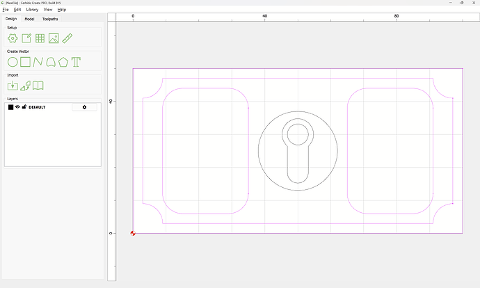

gcpdxf.dxf (3.5 KB)

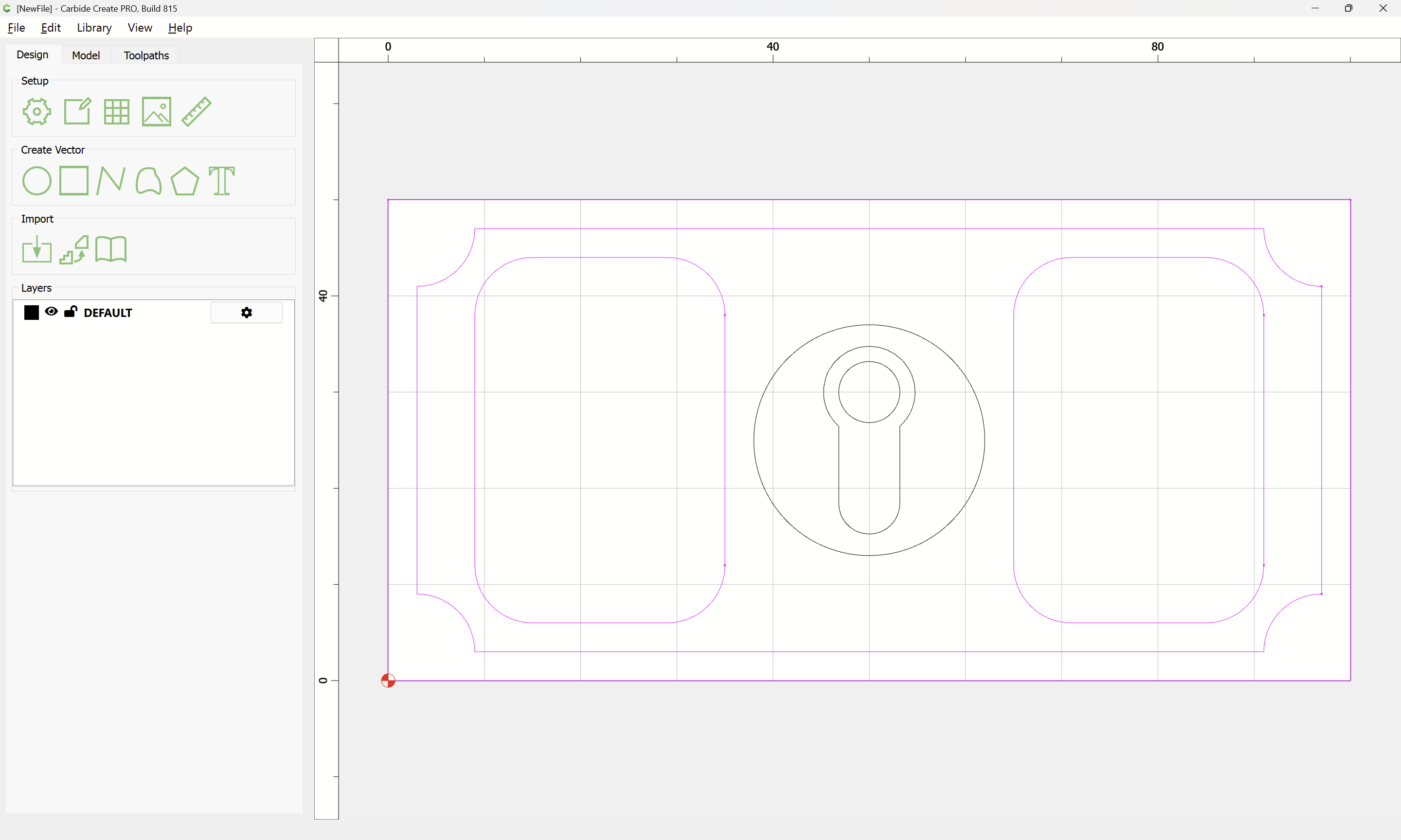

which imports into Carbide Create as:

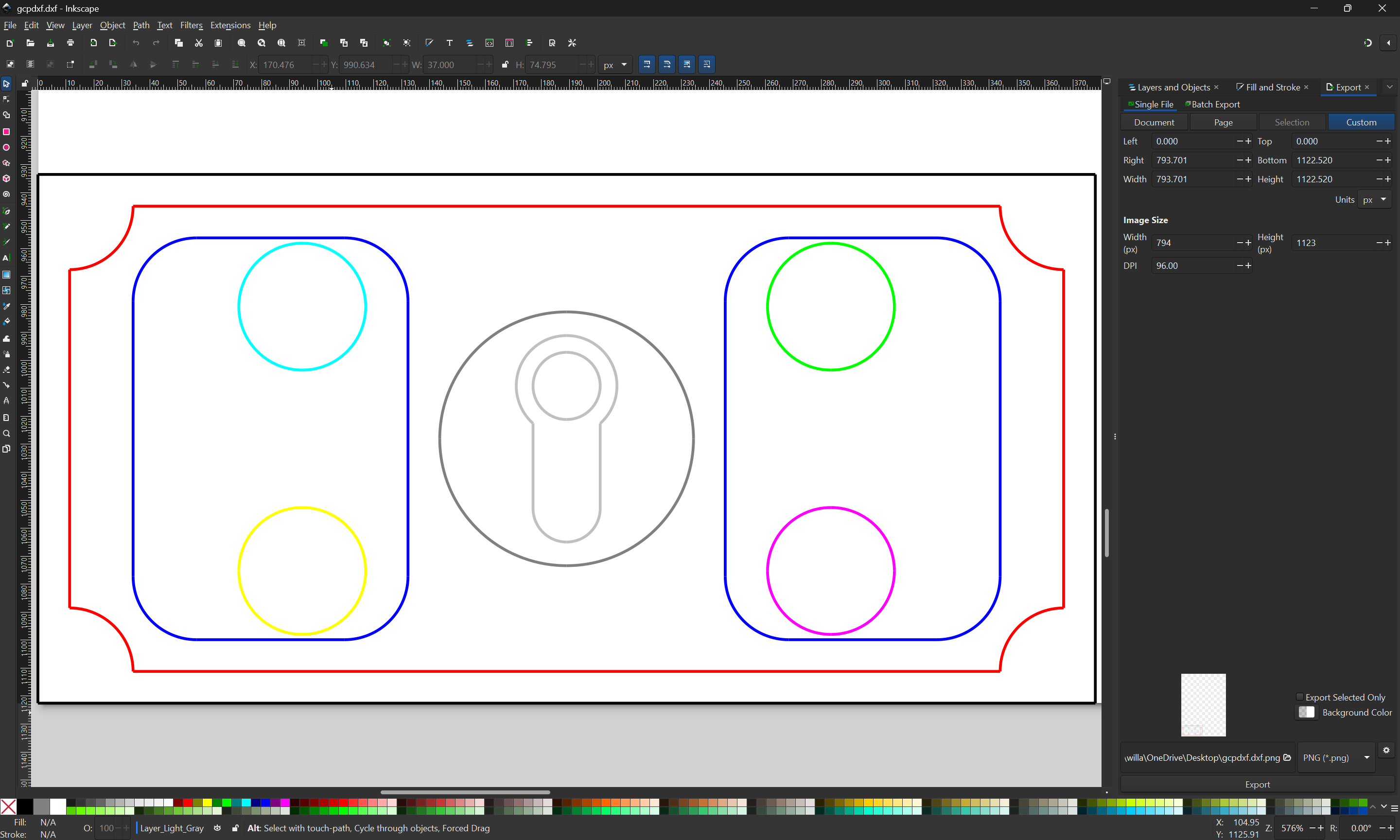

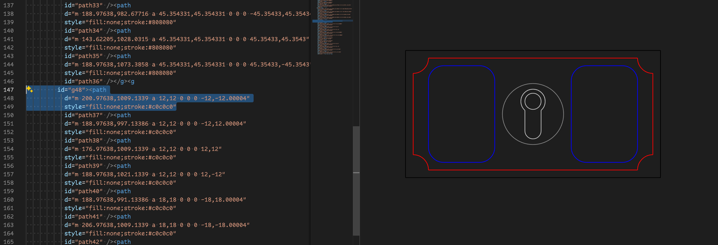

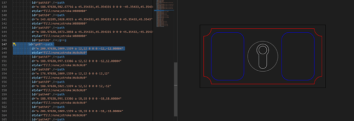

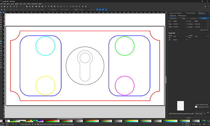

It looks like opening the dxf in Inkscape and simply “saving as” svg will keep the color information on the strokes. It is converted to hex, not sure if that matters for your application.
Example path from the grey element:
id=“g48”><path
d=“m 200.97638,1009.1339 a 12,12 0 0 0 -12,-12.00004”
style=“fill:none;stroke:#c0c0c0
It’s pretty neat that Inkscape does this by default. That said, I still want to find a “replace colour palette” plugin for mapping colors [a; b; c] → [e; f; g]

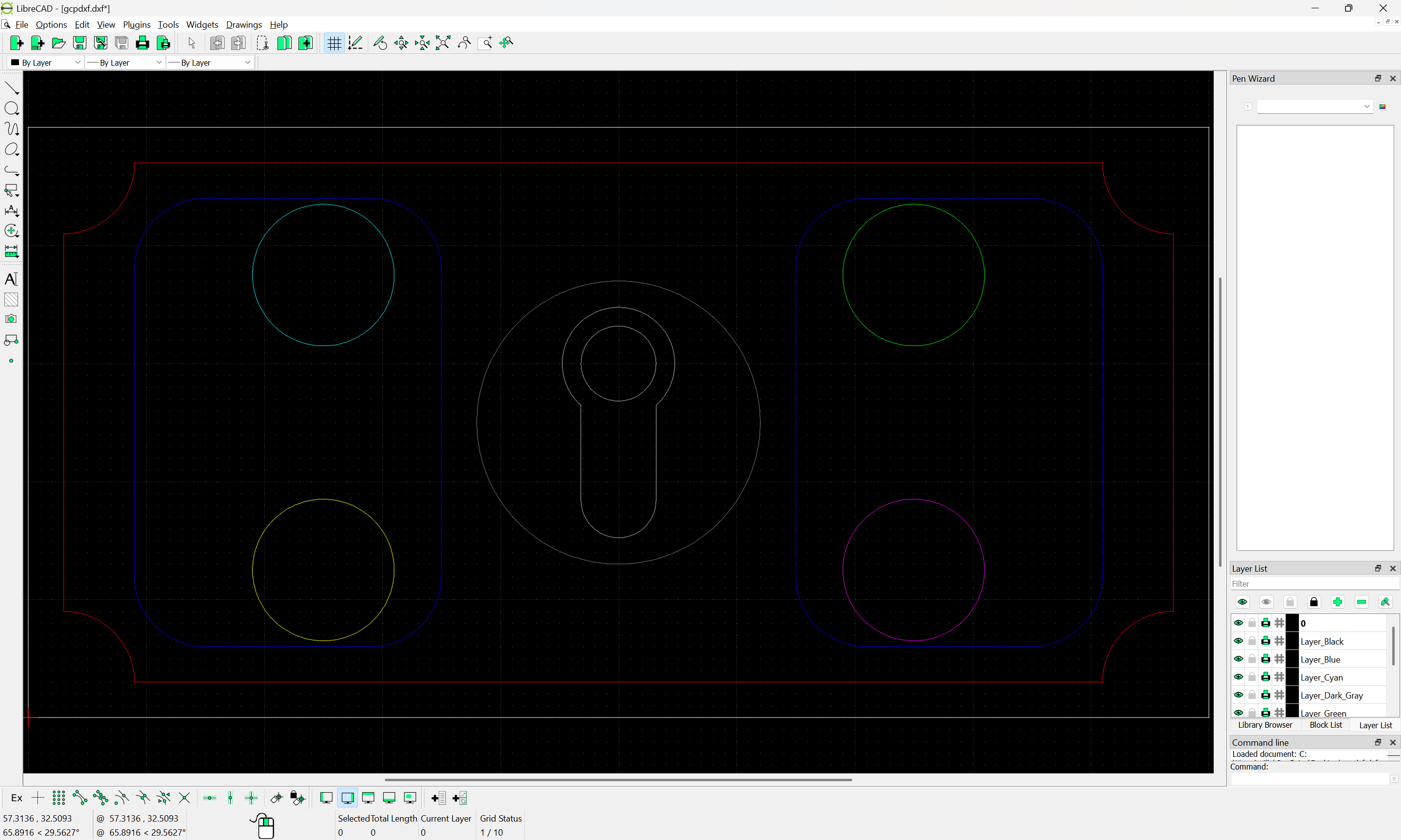

which works as expected in Inkscape as you describe:
matching LibreCAD:
Thanks!

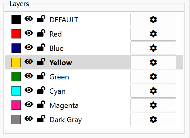

Made a template file in Carbide Create which matches that pretty well:
Design_layers_DXFcolours.c2d (44 KB)
