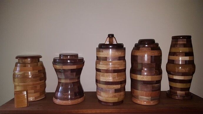

I just want to share a couple of the segmented urns I’ve made over the years. I use O-Rings as a seal between the lid and the base. Then use titebond wood glue under the rim to permanently fasten the lid to the base.
Those are very nice. Do you know the inside volume? My Segmented Pro sw said mine was 232 ci and my friends ashes box is 254 ci. I told sw .75" wall but will make the wall thickness .5" to get the extra ci hopefully. If there are more ashes than room for I will make a mini urn for another family member to have.
I love Segmented projects. I am the only person in my turning club that does Segmented turning.
To the best of my knowledge 1 C.I. = 1 pound of body weight, so the volumes would vary depending on the persons weight. Most of them were around 220 to 250 C.I. but a few of them were 150 to 180 C.I.
The wall thickness ended up being somewhere between 3/4 to 1/2 inches. I would make them a little bigger than required just to make sure there was enough room for all of the ashes to fit.
