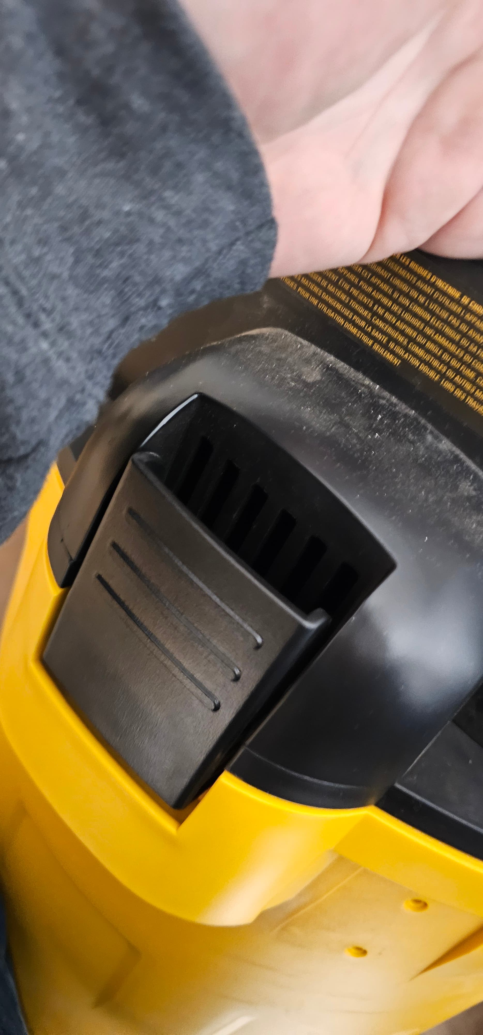

So I did experiments with my Stealthsonic to see how it would handle being on a motor speed controller. One of which was to attach a temp probe to the motor. To do so I had to take the thing apart so I am familiar with its inner workings. The 12G model has vents on the sides where the clips that hold the motor head to the bucket are for taking in air to cool the motor.
They are a bit hard to see in the picture, but if you zoom in you will. This is for when you are sucking up stuff like water or when the hose gets blocked the motor can remain cool. As such it is possible that the the motor head could suck in dust from your shop bypassing the bag and filter.
Shopvacs, for as long as I’ve used them & been taking them apart(25+yrs), are designed with a separate airflow stream to cool the motor. The vacuum air stream never touches the motor. This allows for them to be used to suck up water & crap as it won’t short out the motor or cause it to sieze up.
Fine wood dust hanging in the air doesn’t really affect the motor - too turbulent when it’s running. Though I will say that drywall dust can coat the motor & inside the cowling pretty good.
Most times when a shopvac fails while running, it’s due to bad bearings siezing up & causing the motor to overheat & burn out the windings somewhere.
Other times it can be the power switch no longer makes proper contact - so you try to turn it on & nothing happens. The switches are usually pretty easy to replace as they are a common type & electrical rating.
