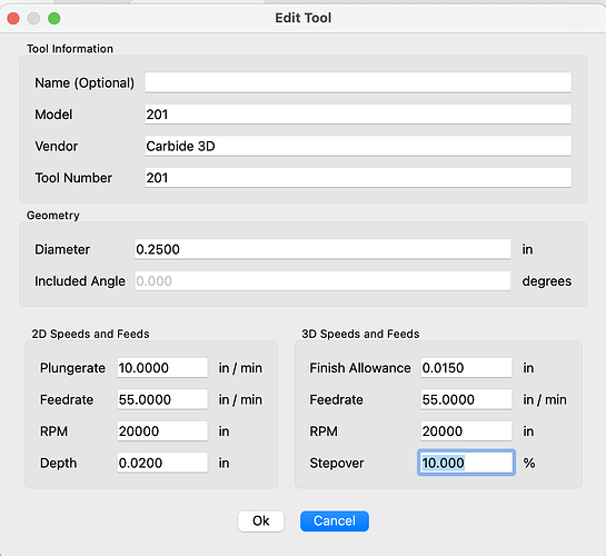

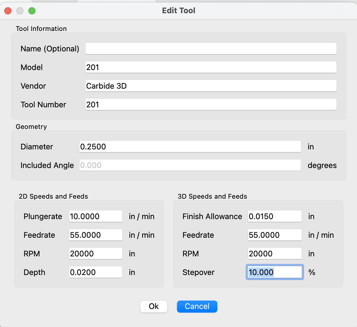

In the Edit Tool dialog, there is no 2D Stepover value, only for 3D.
Everything seems to indicate you have to set the 2D Stepover manually each time you select the tool for a toolpath.

2D Stepover is not in the tool data file. It’s calculated, and it’s hardcoded as 50% of the tool diameter.
For custom tools you can set step over. That is why I recommended a custom tool that copies what the stock tools are with his required step over.
No you can’t. You can set the 3D stepover, but that doesn’t affect 2.5D operations like pockets. All you have to do is look at the CSV file, there’s no field for stepover!
