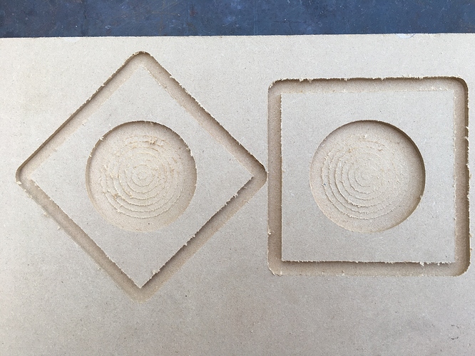

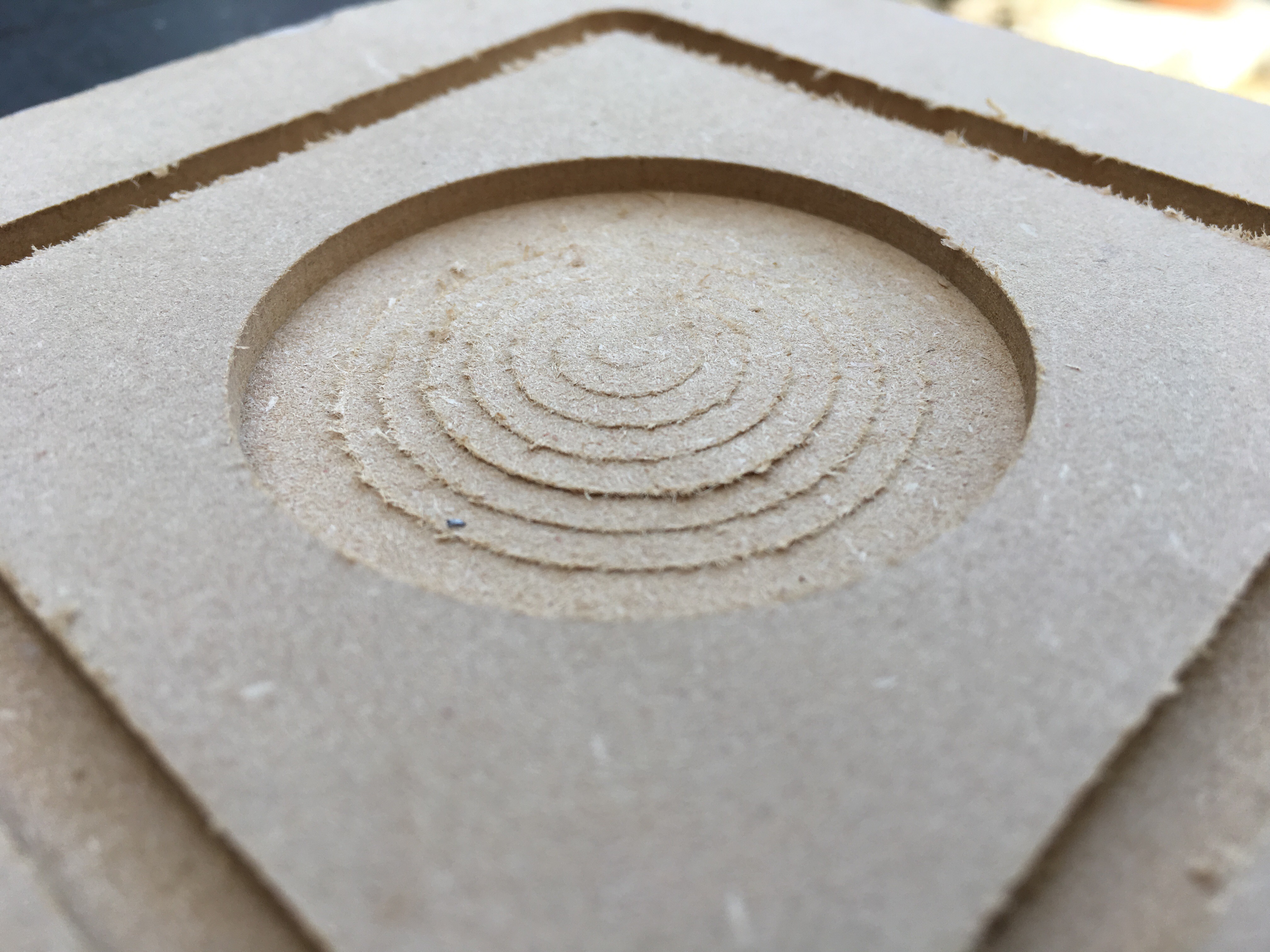

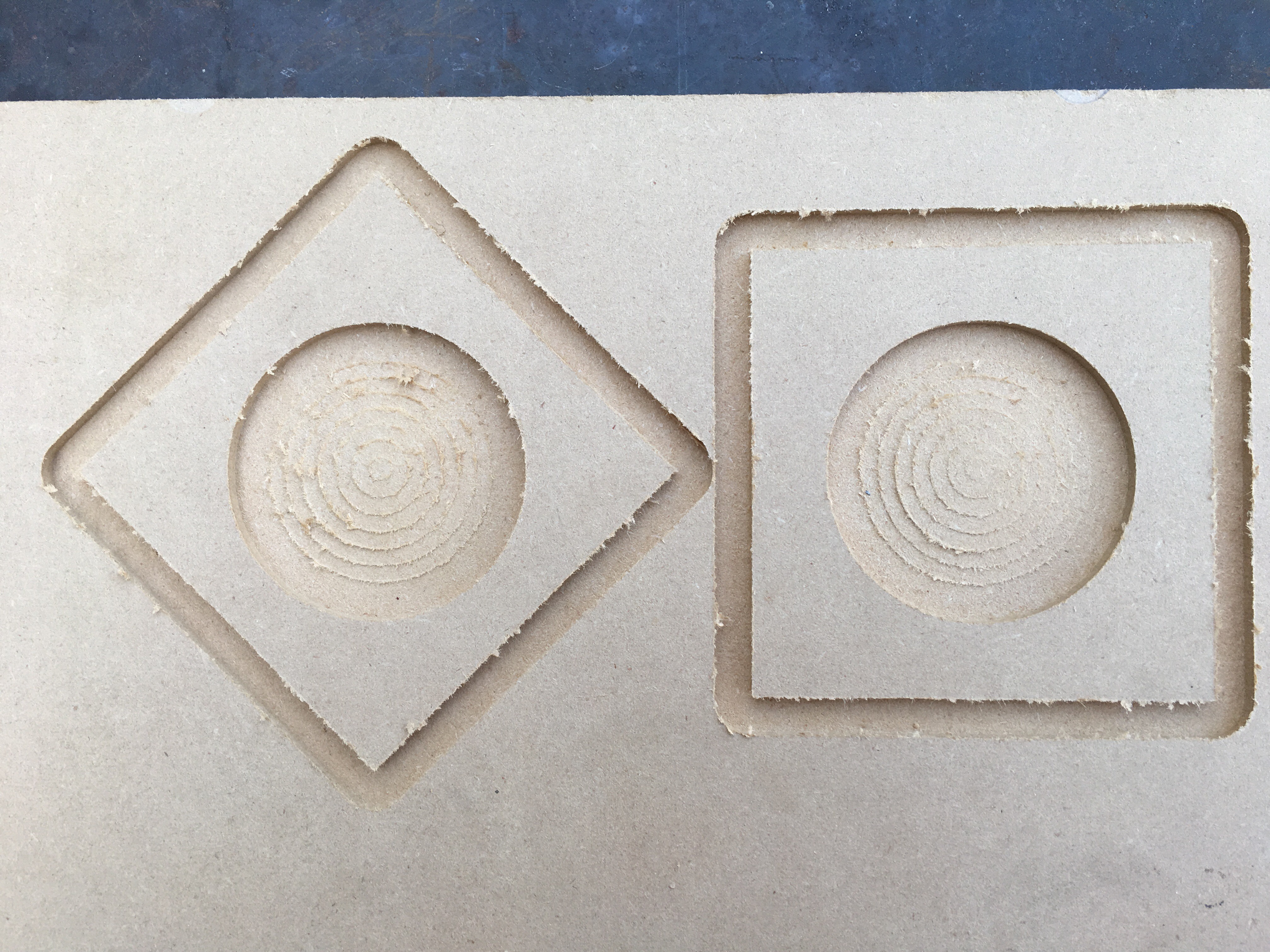

I’ve been having lots of trouble with my machine lately. Unit is about 6 months old. I’m getting bad stepping when I try and do pockets. Same thing happens when I try to surface the wasteboard.
Seems like the z-axis is drifting down for some reason. The belt tension is pretty darn tight. V-wheels are smooth and adjusted so no wiggle. I have an aluminum plate as a base so it’s quite rigid. The unit is square and I trammed the spindle so it’s within .003 over 3 inches. Runout is only .002. The X & Y seem fine as the test shapes are accurate sizes.

Another strange thing I noticed is the outside of the circle is the perfect depth. Right at where I set it. Like it’s starting high in the middle and slowly spiraling down.

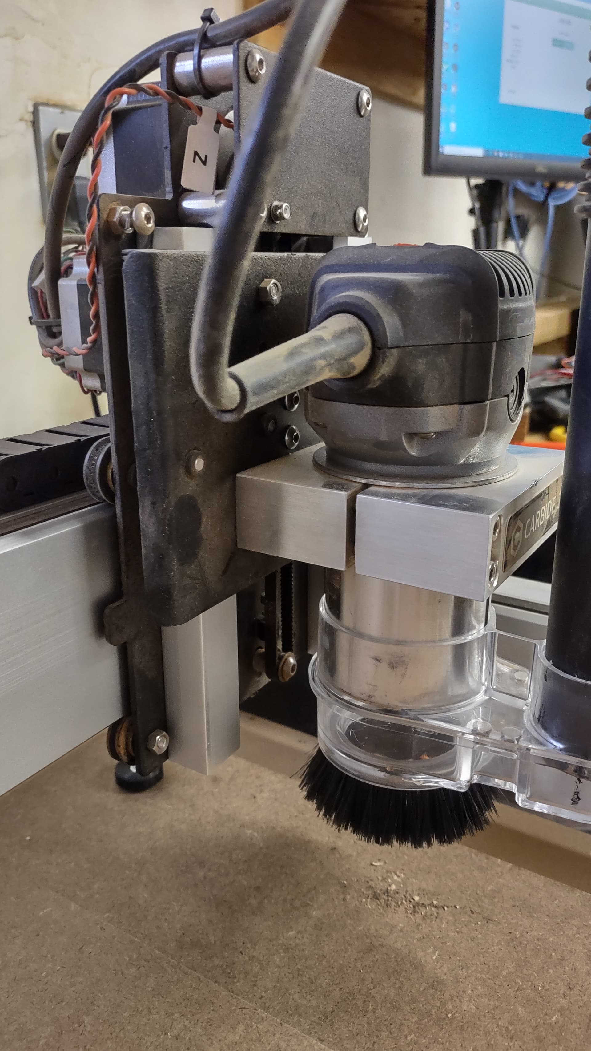

Out on a limb here, but the Z axis is belt is super tight? Could be so tight that it’s actually inducing drag in the system? Also, are you in a “Not fit for dogs” kinda cold weather garage (like the one I’m sitting in right now)? Belts can get stiff, I had this problem last year around this time. Also, are you using a dust boot that moves with Z axis, not fixed height (like a Suckit)? My old dust boot brush would foul on pockets just enough to do what you’re showing.
looking at the pictures is one side i.e. the left of the design shallower/deeper than the other? It almost looks like the bit is cutting at an angle, which would suggest your router/mill ins’t aligned vertically?

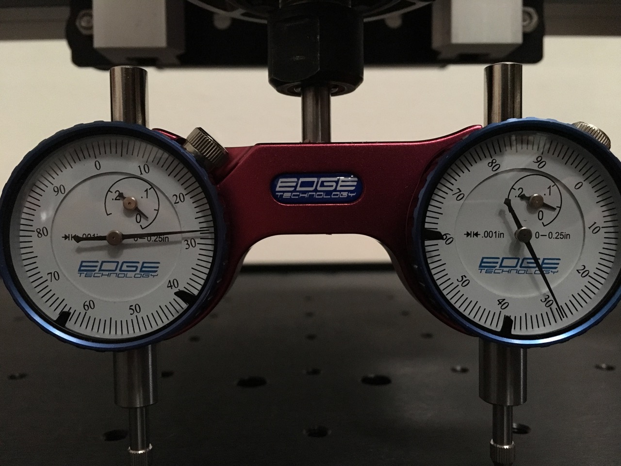

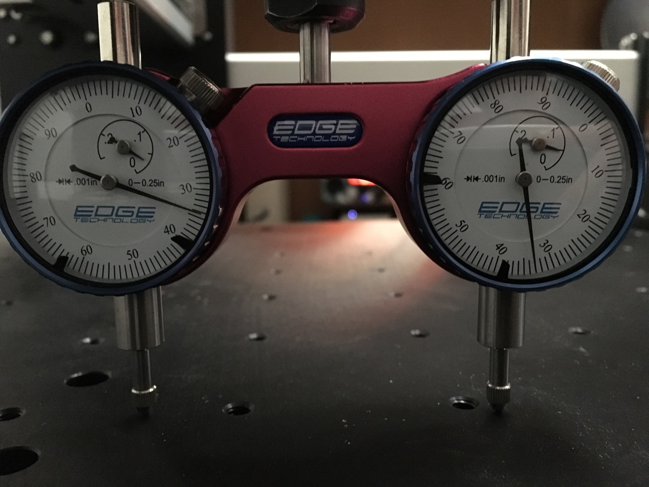

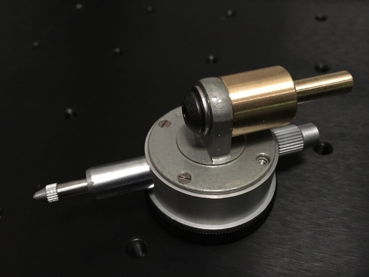

Using the Mini Pro Tram gauge I am square to the aluminum table within .002 in each direction.

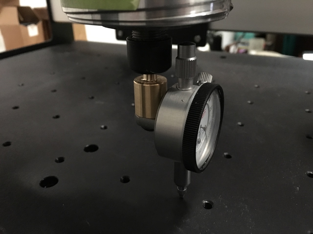

Made a dohicky to attache a small dial indicator to the spindle. This is direct to the 1/4 collet. This gave me the best info. It looks as if the z-cannot move consistently. I ran some circles with the indicator and it didn’t vary as much.
I clicked through .001 and .010 steps with the indicator and found it moves around a lot. I adjusted the belt from real tight to real slack to find the best place and there is still some drift. I’m thinking worn belt. Also messed with the z-axis v-wheels a lot and it didn’t seem to make a major difference. I know this unit is supposed to be accurate within ~.004
I think I’ll order a replacement belt and some v-wheels and rebuild that area. I did do a long run of engraving with a drag knife so I’m thinking the belt was worn going up and down so much. I did rotate the belt but it didn’t seem to help.

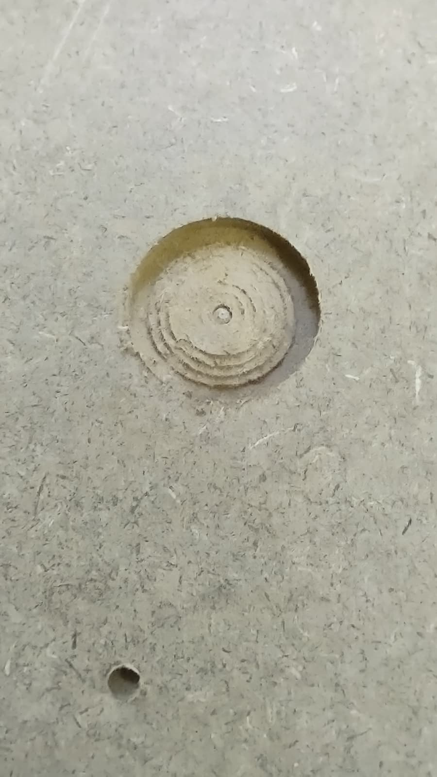

I’m pretty sure the belt is slipping. The pocketed hole should have gone all the way through the board and the first pass of the remaining steps started out above the board. I’m thinking either the belt needs tightening or replacing. What should my next steps be?
