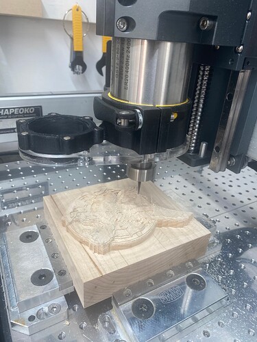

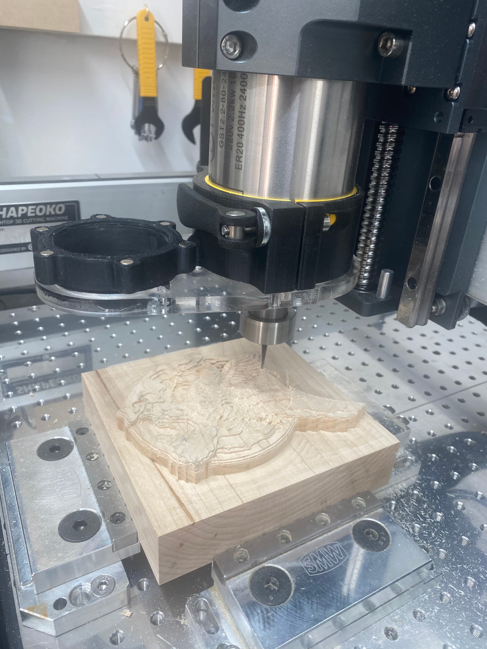

I recently upgraded my Z plus Z axis for the HDZ with ball screw Z axis. I am now comfortably using a 2.2kw x 80mm spindle/VFD combination and it works really well. It is probably outside of the original design specifications considered for the standard S3 but the machine is really capable. I would be unlikely to part with it now it is properly fettled.
Spindle

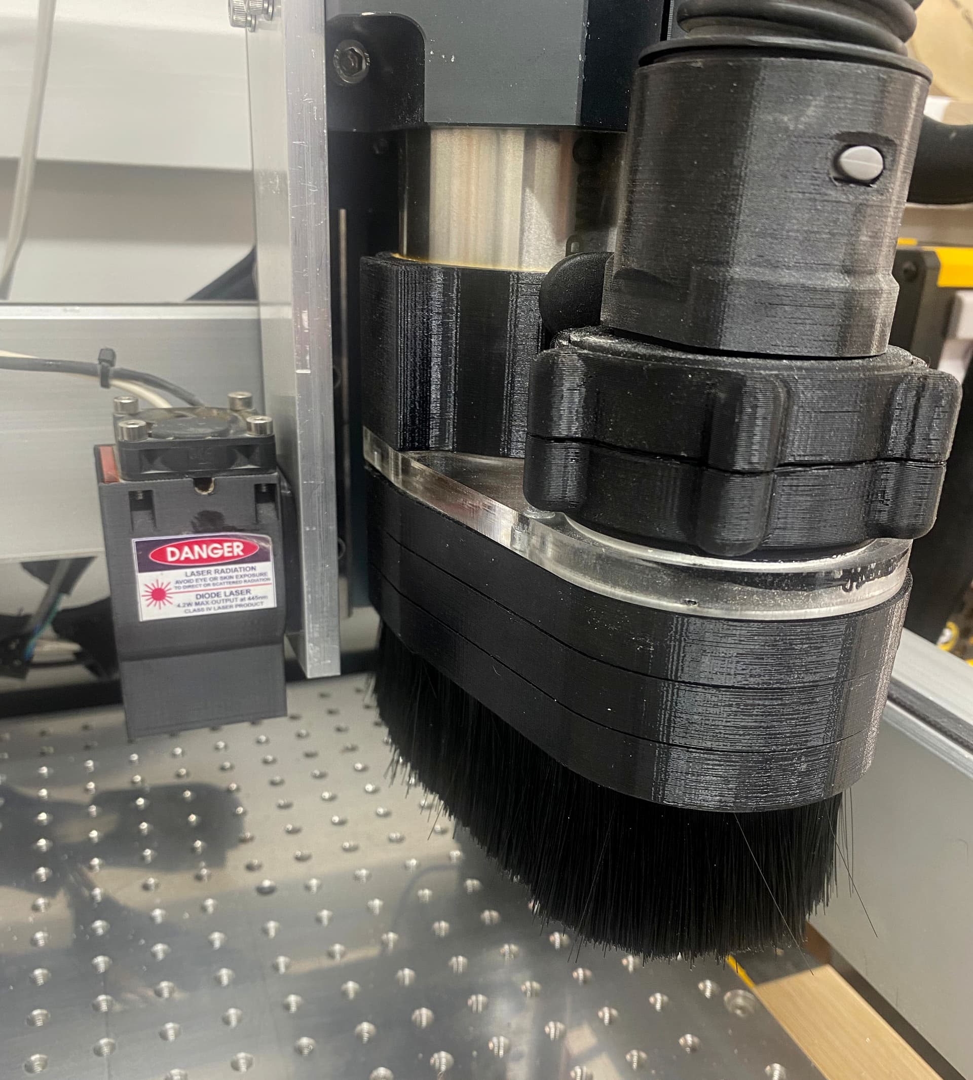

Laser alongside dustboot

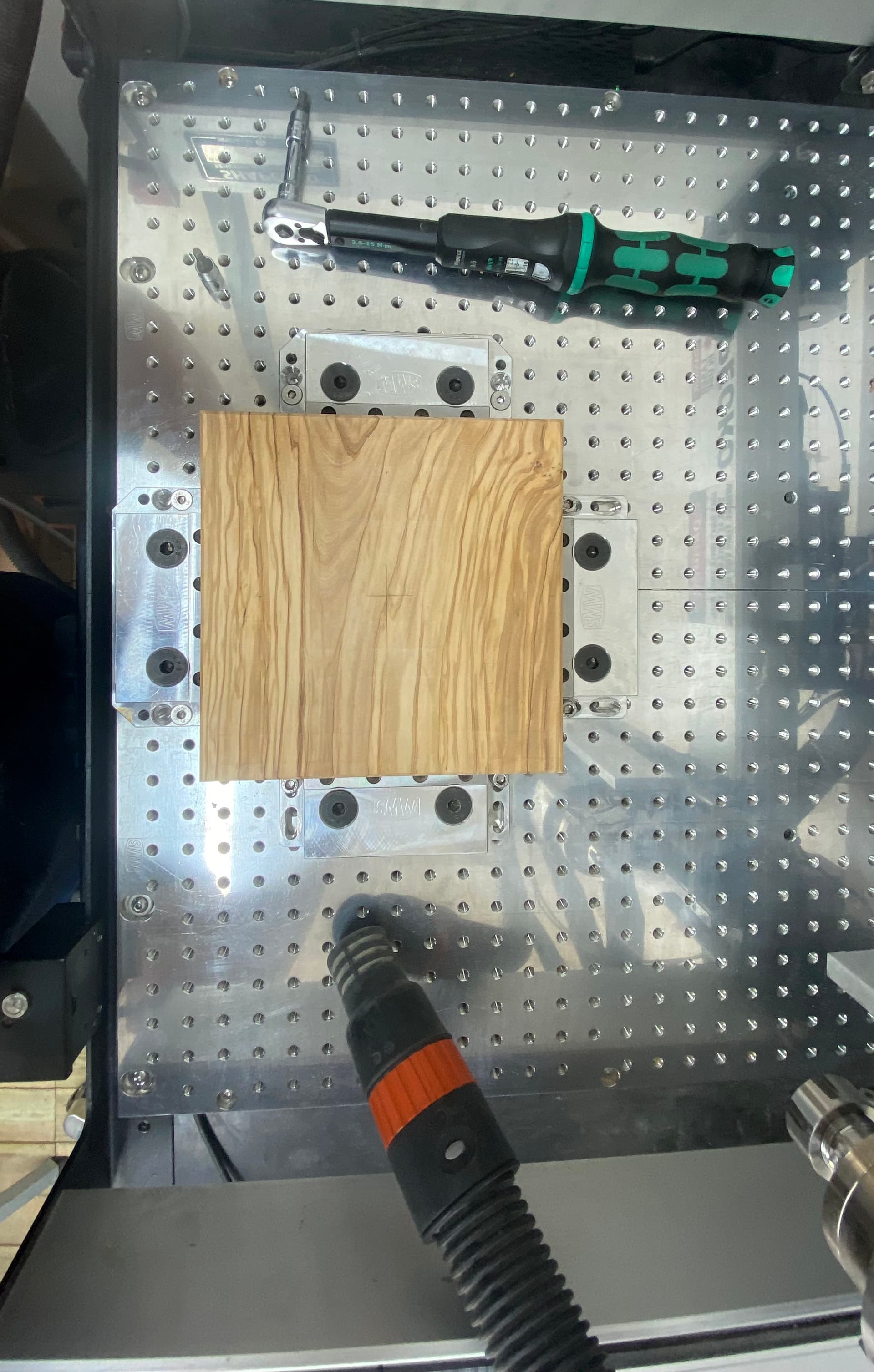

A pair of modular vices and 12mm thick 6061 baseboard (824 x M6 holes)
