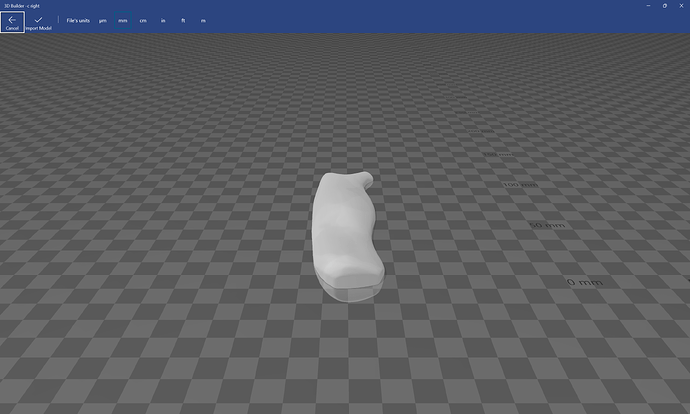

and the STL files seem fine:
and even allow getting the dimensions:

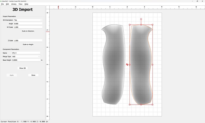

we try importing things into a suitable file:
Then select one scale:
and try importing:
which seems to line up as expected
Repeating this for the other side:
also seems to work.
