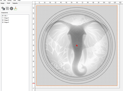

The Model Component List seems pretty quirky still. Had made a quick model using an STL file, then added 2 more components - one which subtracted from the STL & one which added. Saved the file like that. Came back to it later to test out the Toolpath simulations.
Decided I needed to draw a larger rectangle around the previous model to create a base slab so as not to have the 3D carving paths hit the bottom of the stock material. Tried to add a flat component to the existing model using the rectangle & the model got sort of screwed up - one of the previous components just vanished & somehow 2 instances of the new flat component shows up.
Seems like it has to do with the fact that it didn’t name the new component shape with ‘5’ & then added a new component as well as over-writing the existing ‘Shape 4’
Tried adding the rectangle shape component named as ‘Shape 5’, but it just does the same thing - takes the existing ‘Shape 4’ component & over-writes it.
