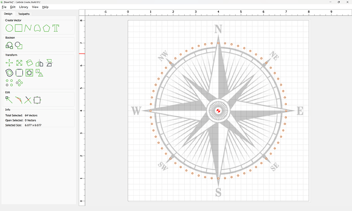

How to draw a compass rose

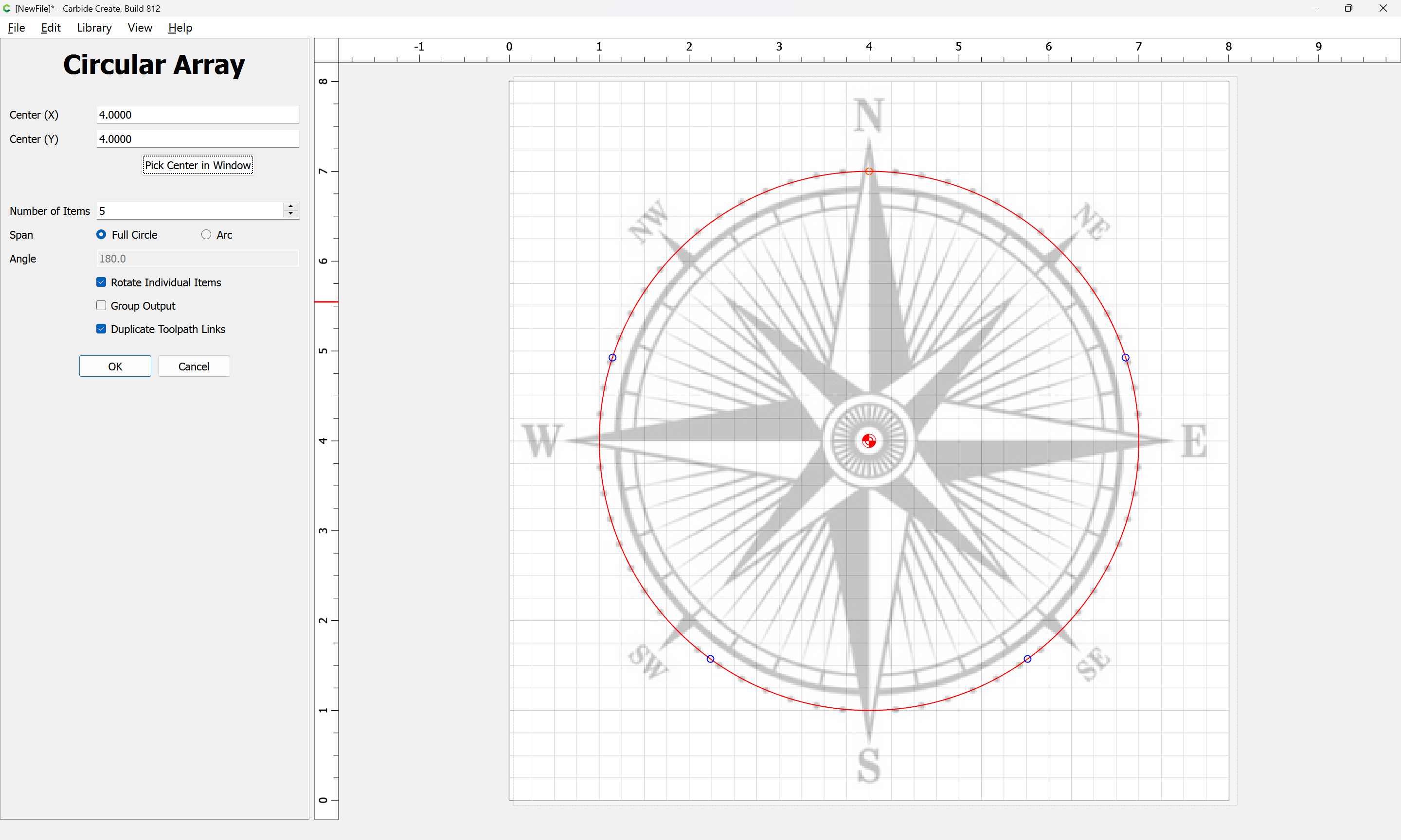

Since the above tutorial was posted, Carbide Create has gained a “Circular Array” tool:
so we will use the (currently new, currently in open beta) v8:
to re-create this.

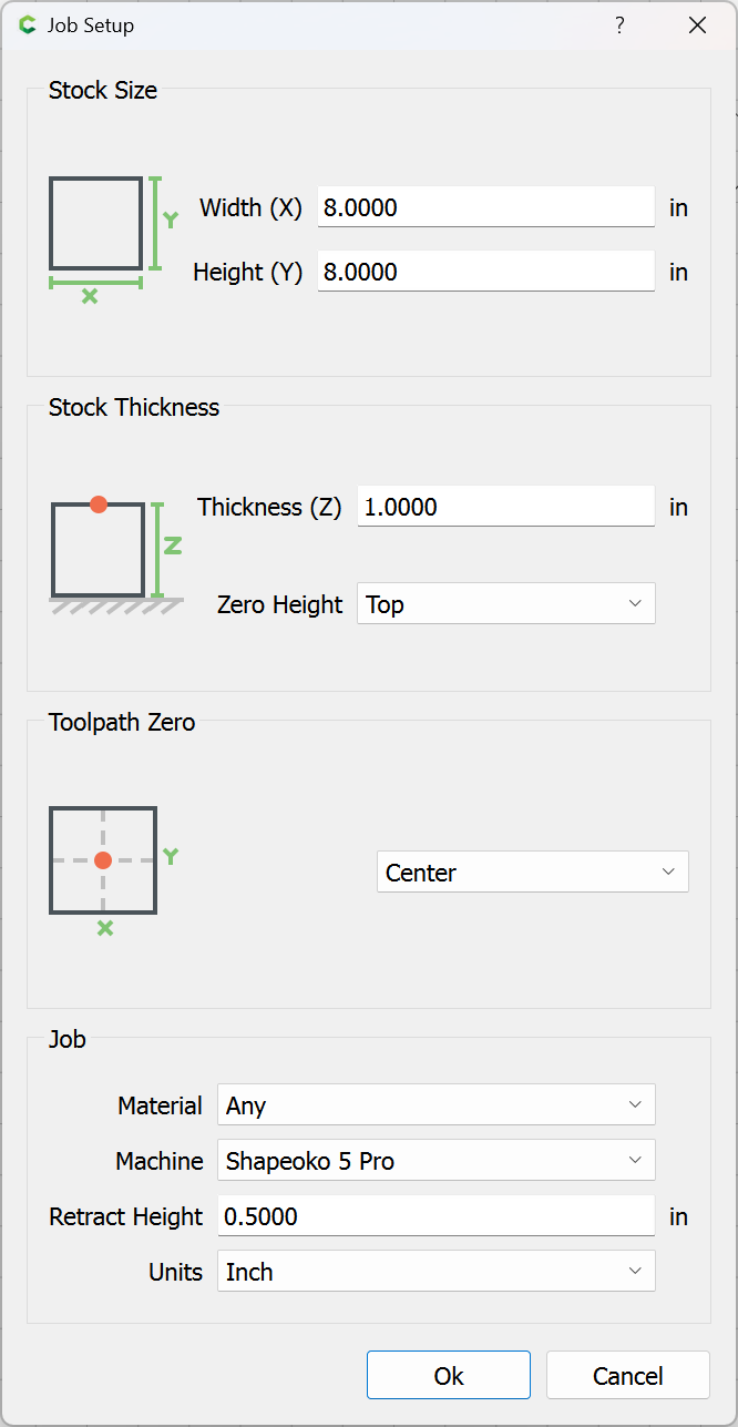

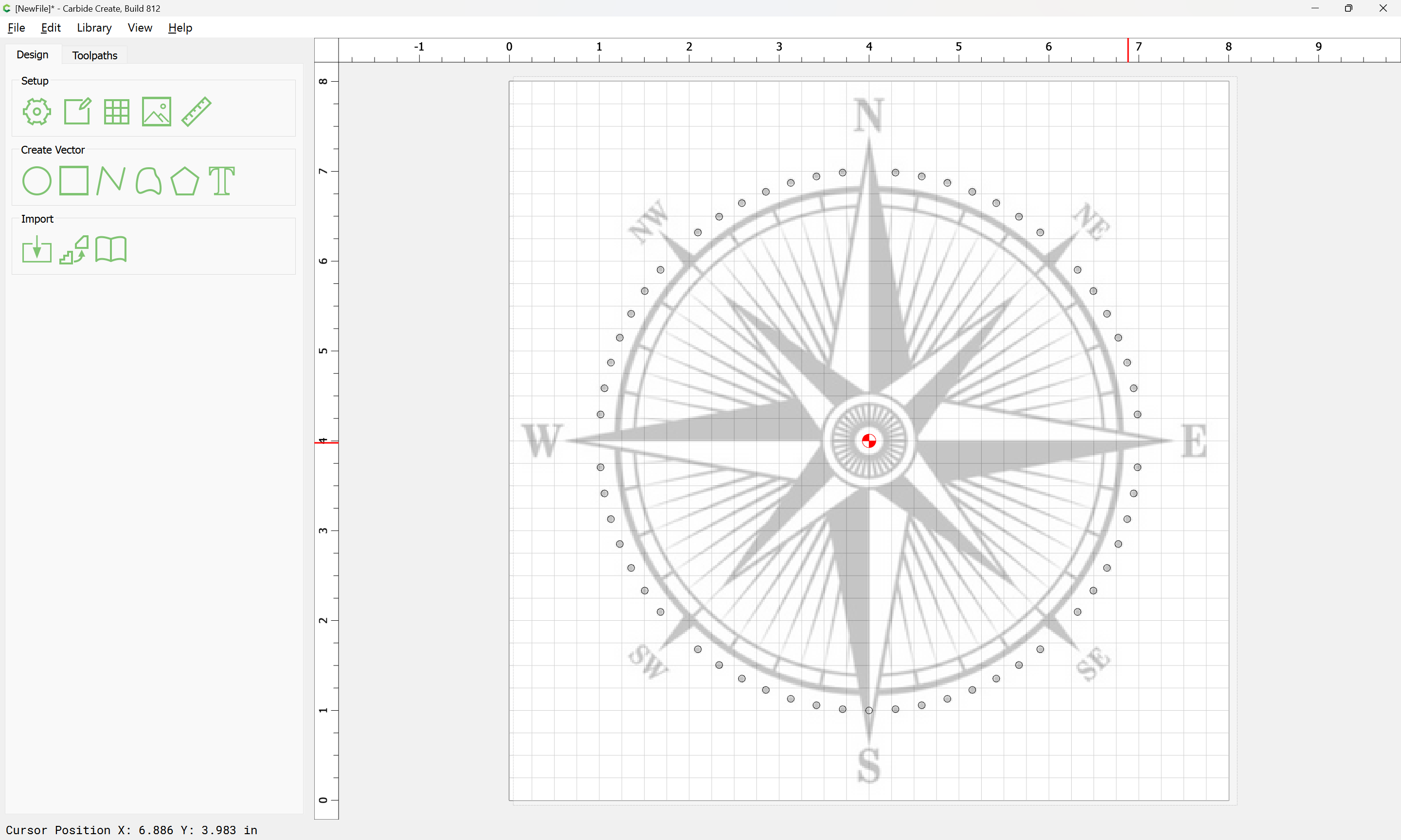

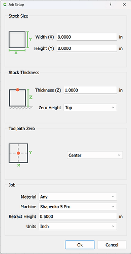

We will work at 8" x 8":
with the origin at the center:

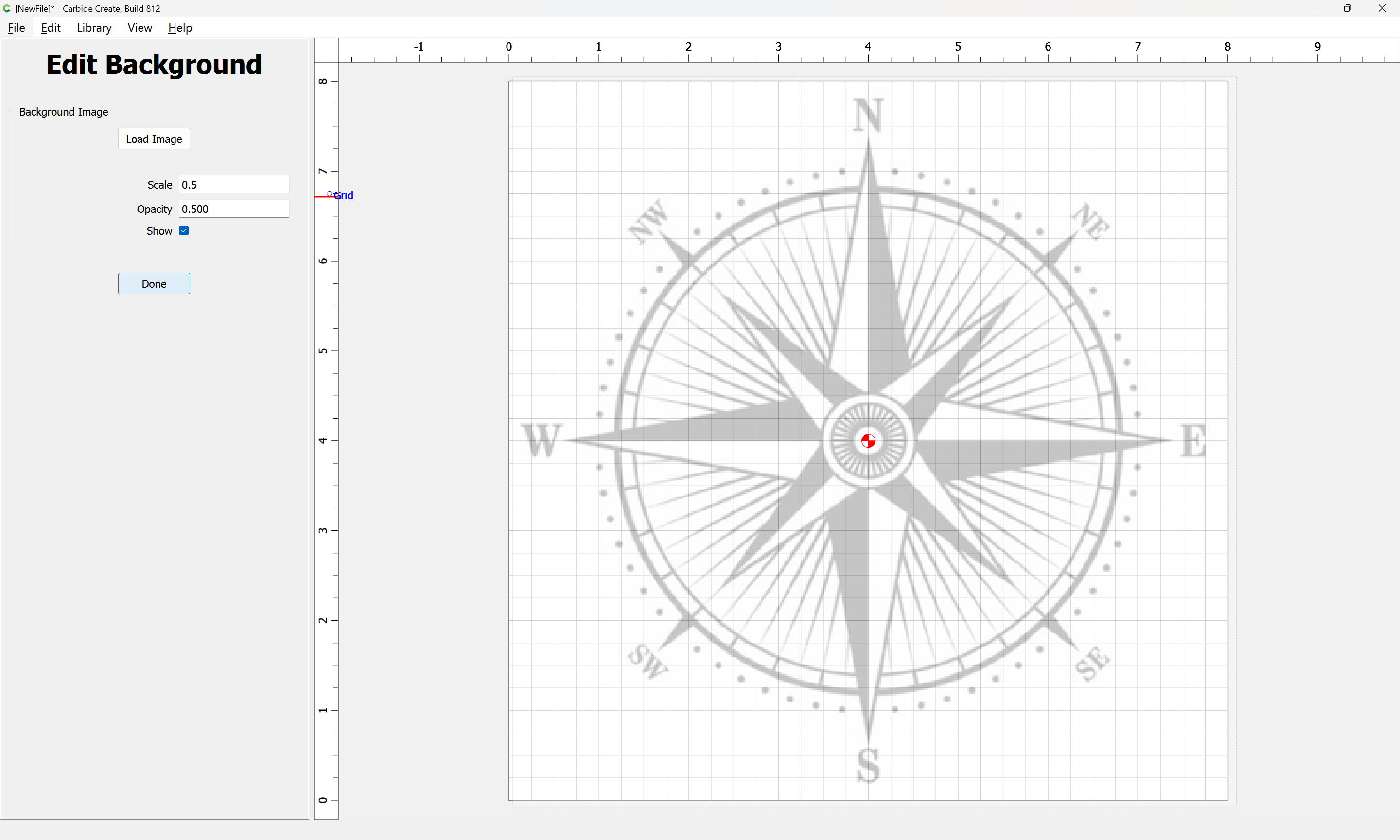

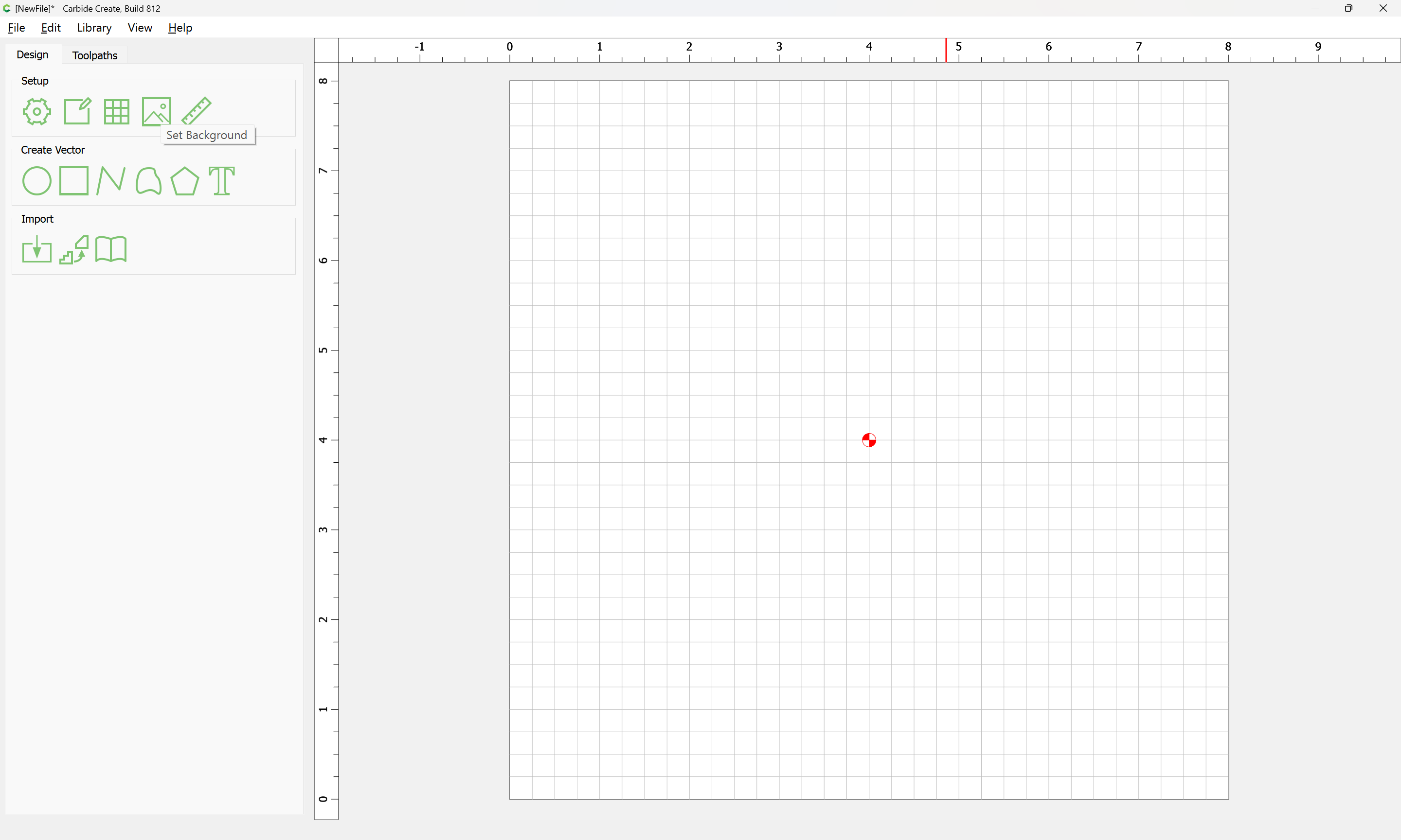

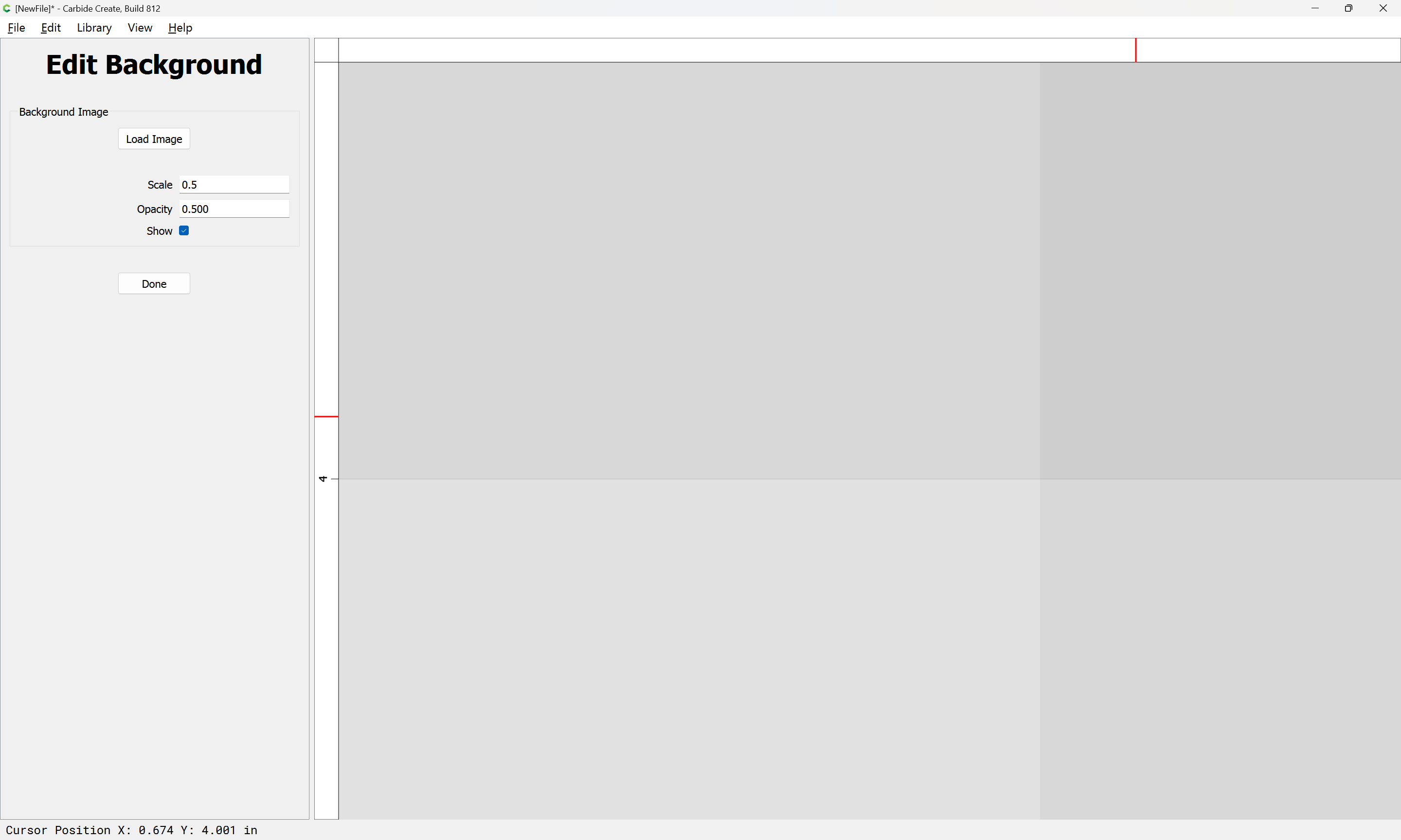

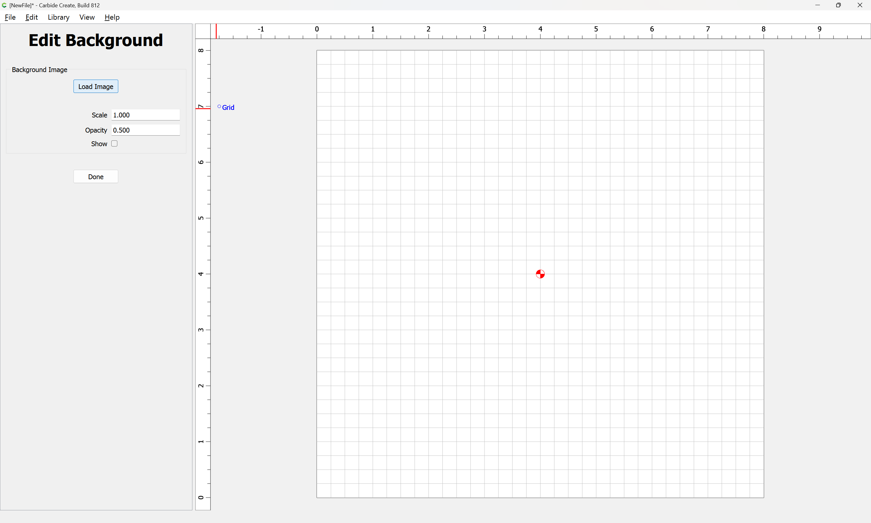

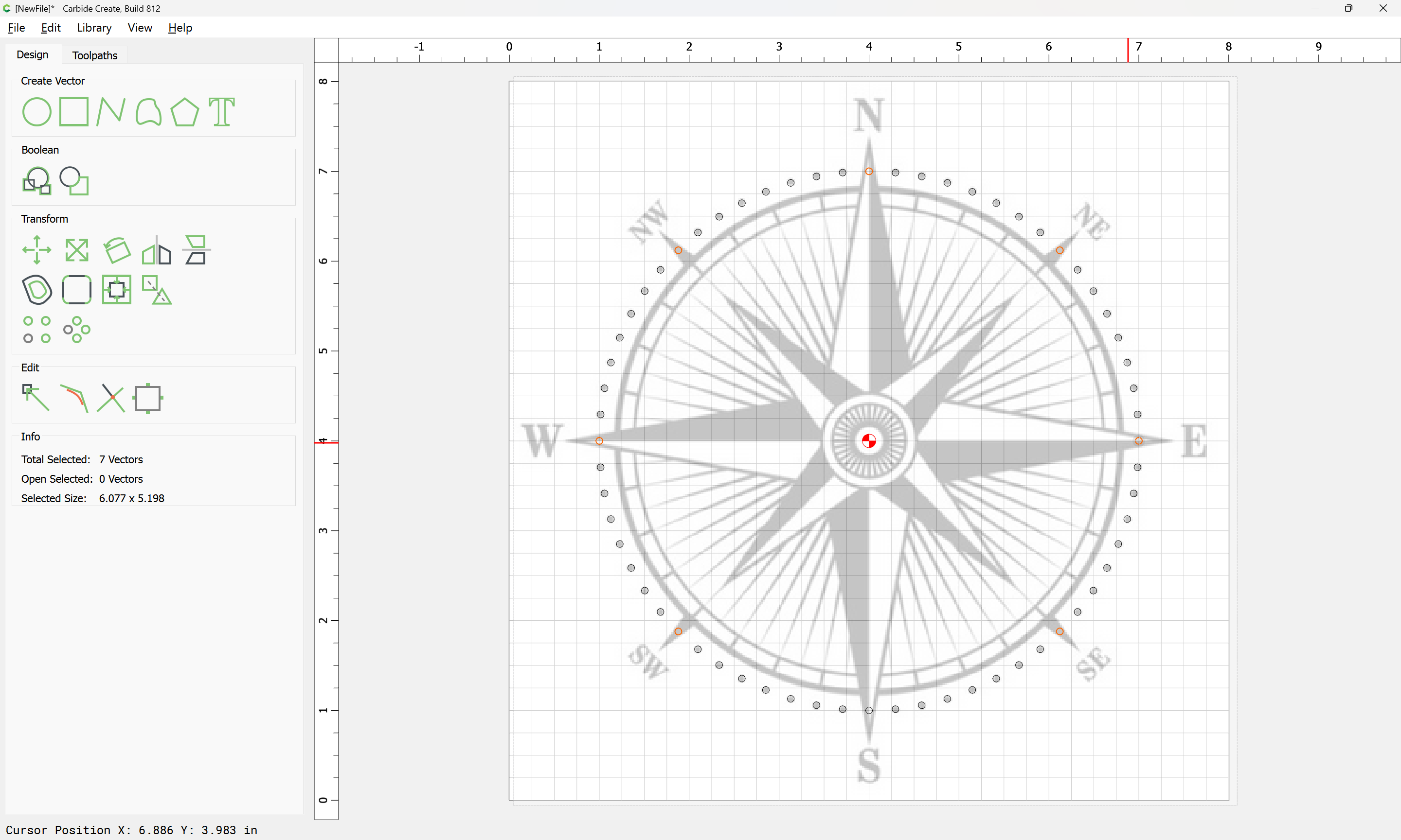

as before we “Set Background”:

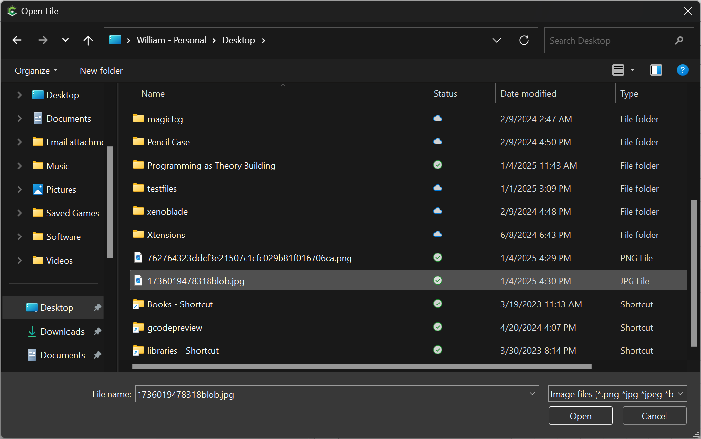

“Load Image”
selecting the file:

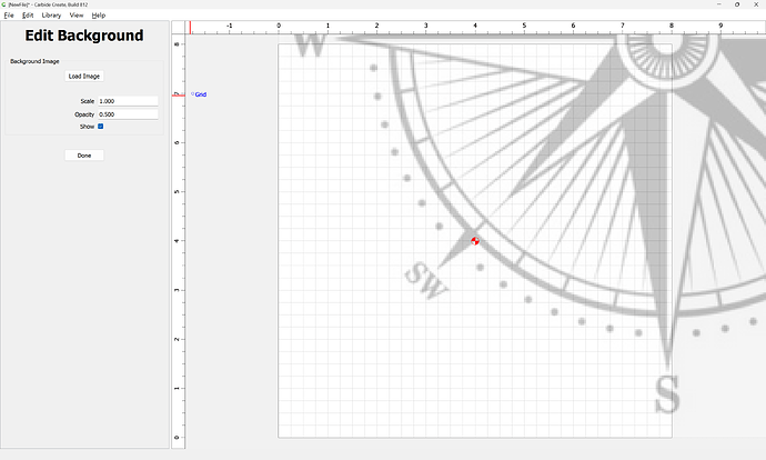

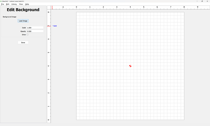

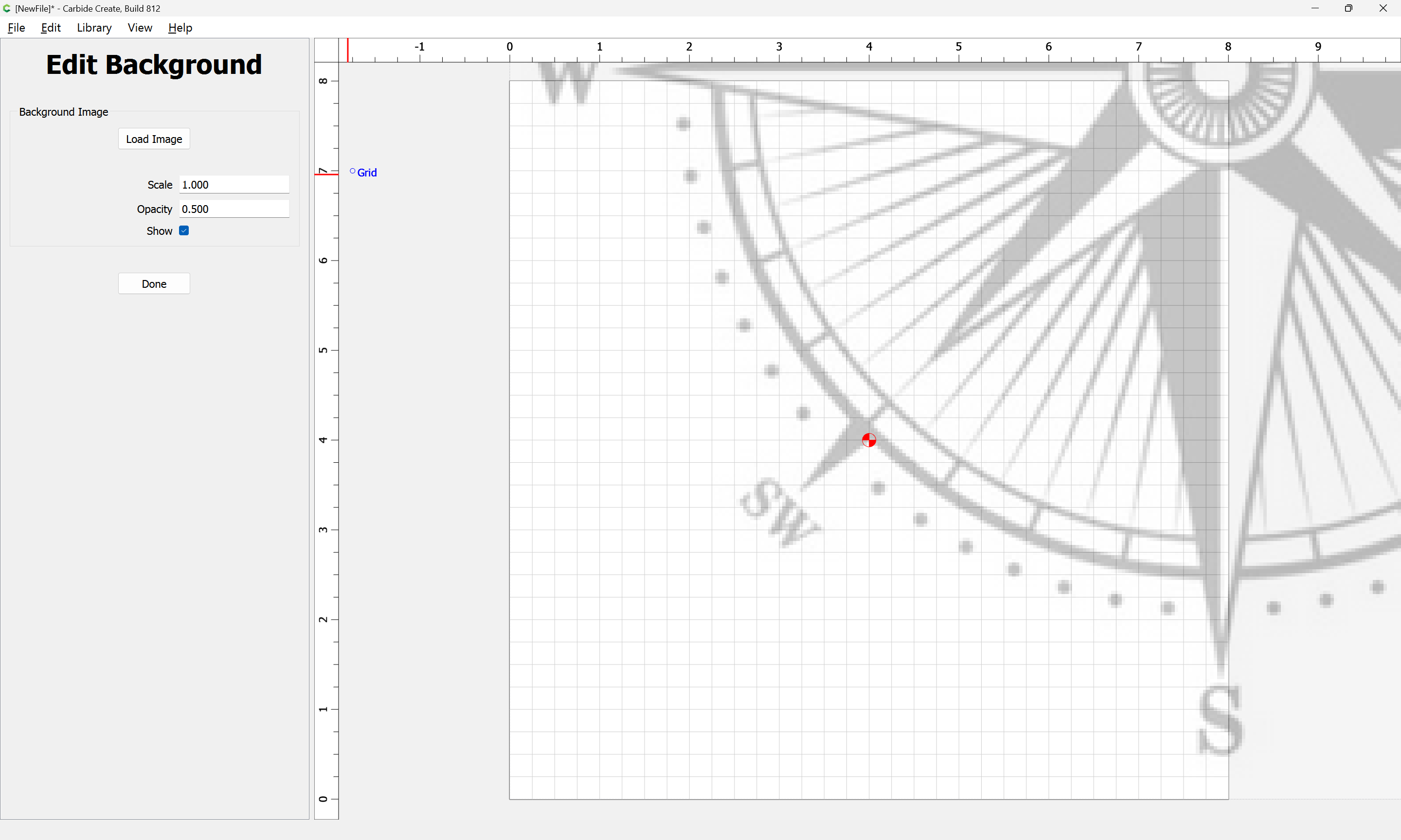

and adjust size and position as necessary, zooming if need be to make sure things align:
Done

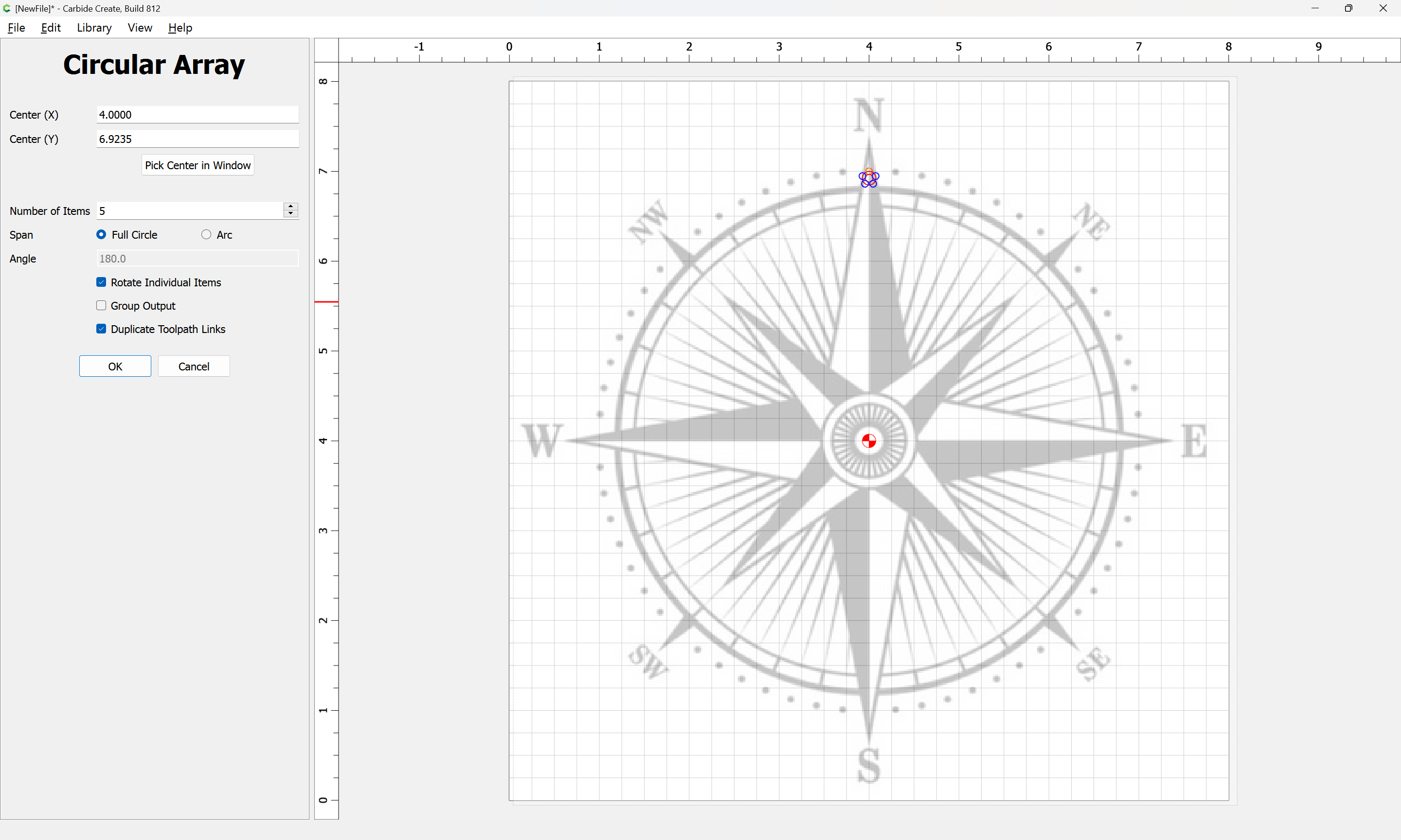

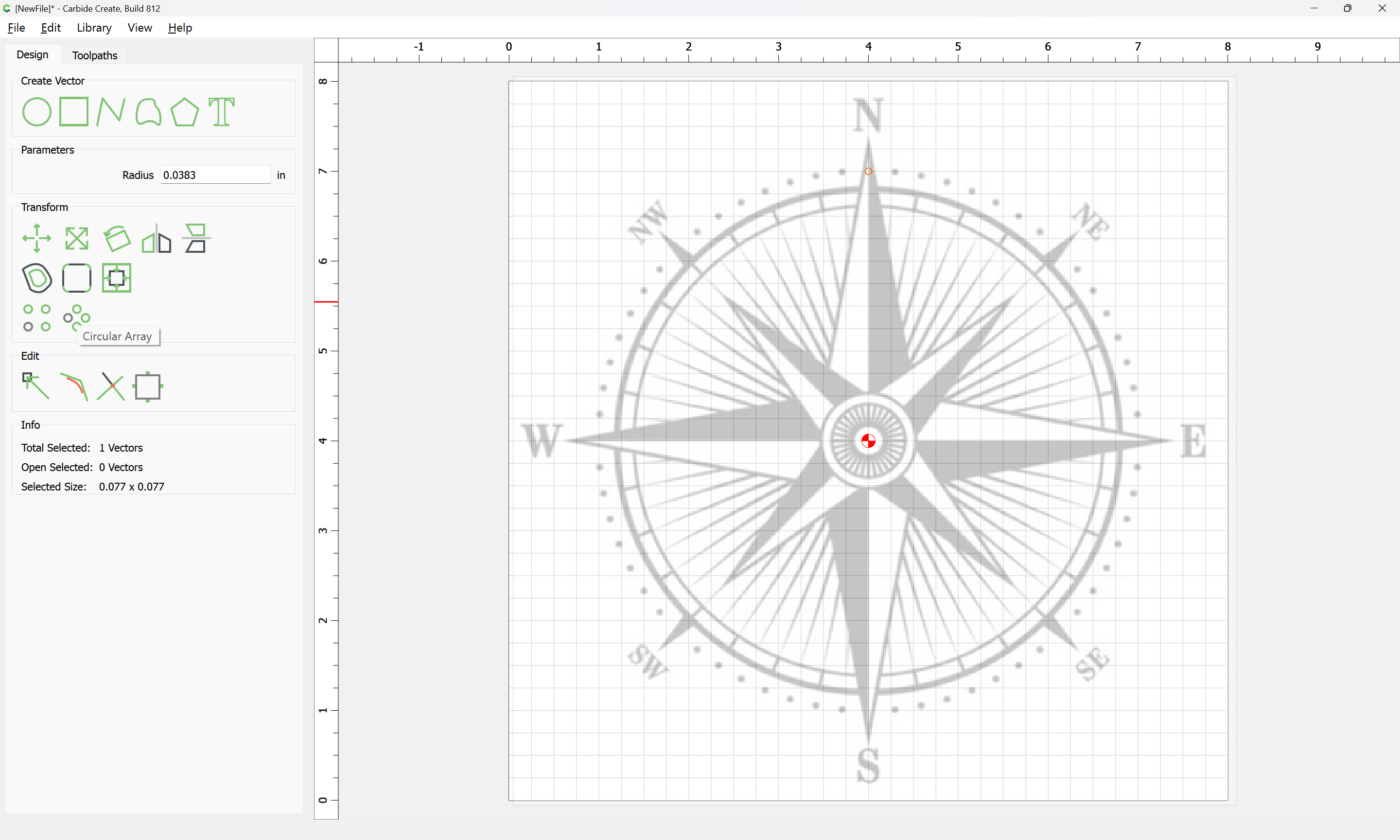

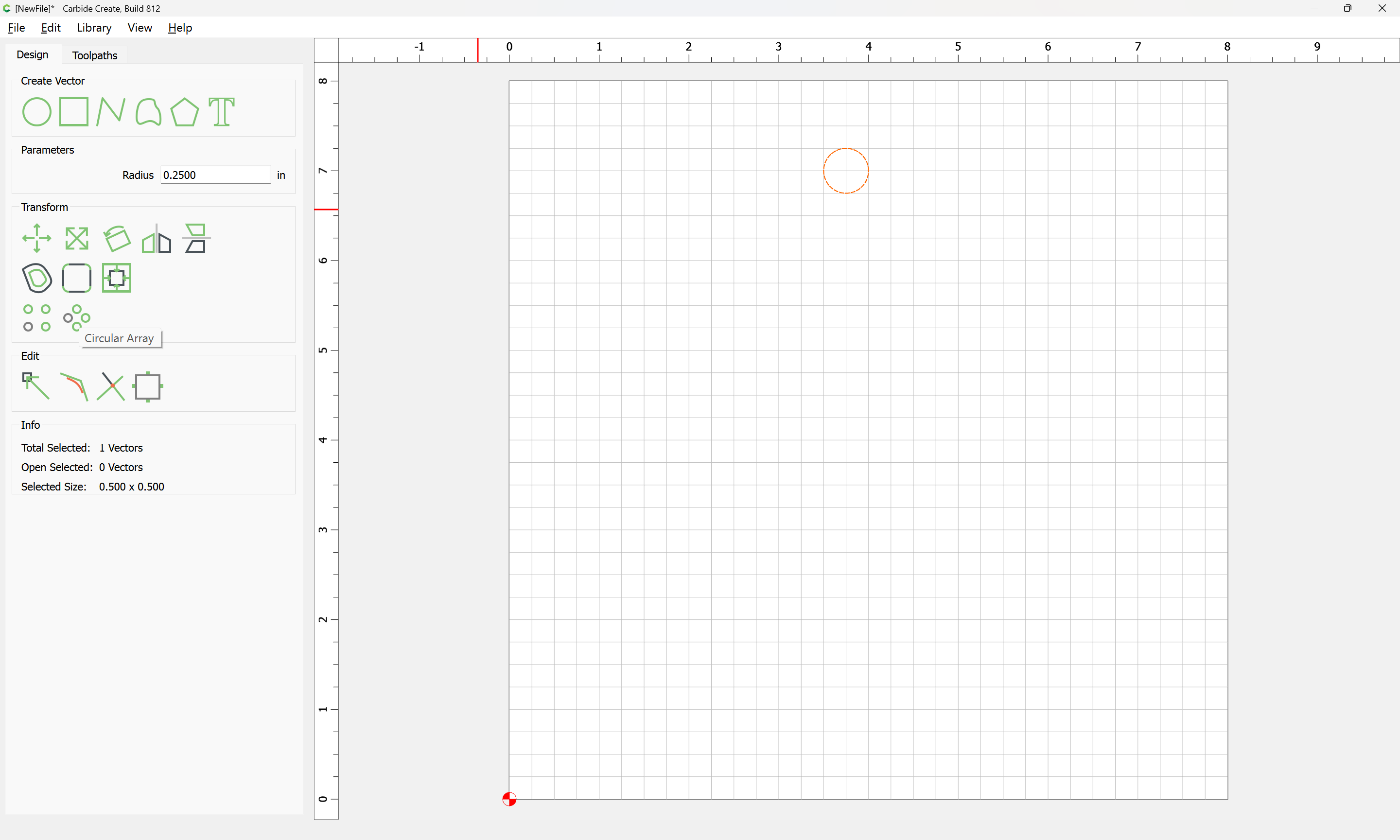

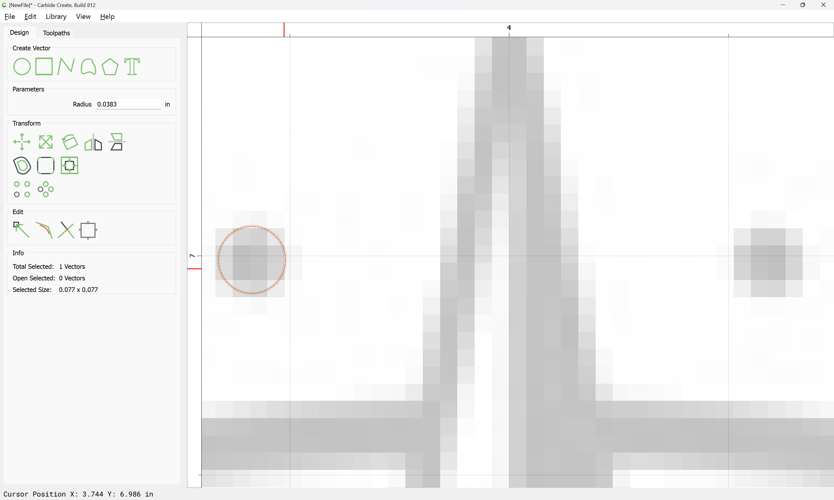

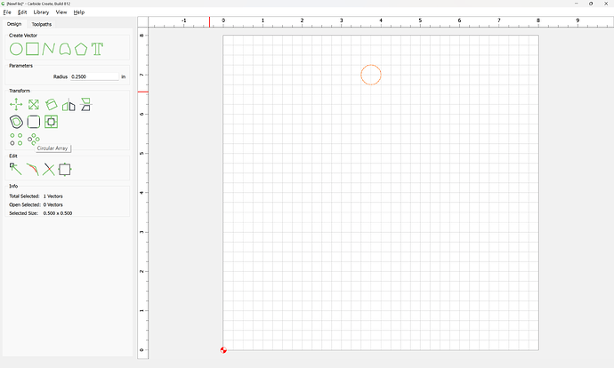

We start with the circles:

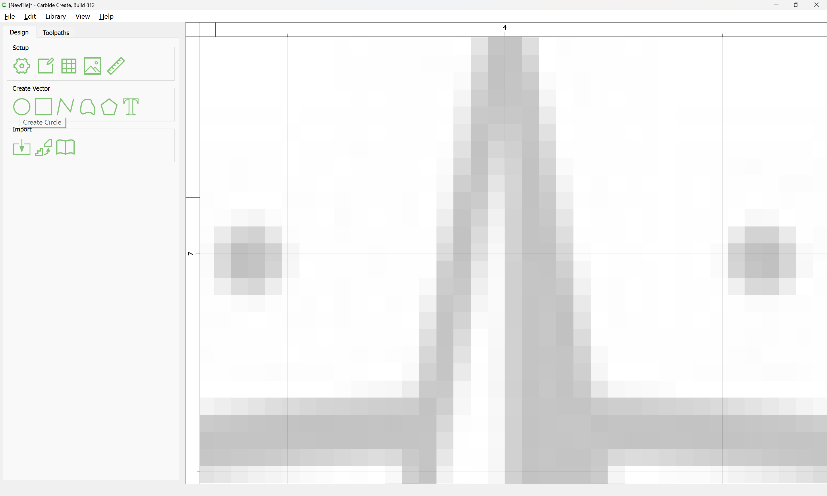

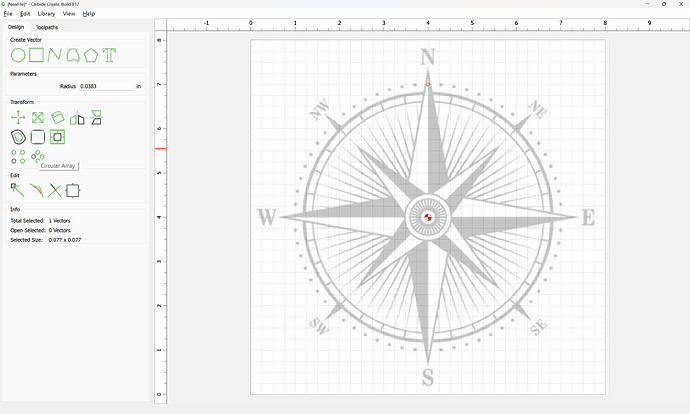

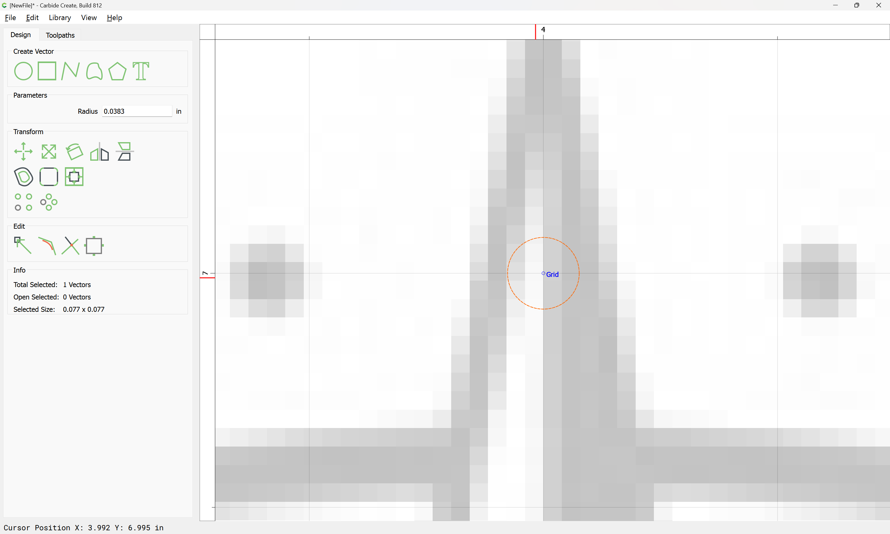

positioning the first on a grid point aligned with the center axis:
which seems sufficiently higher than the surrounding ones that it should be correct:

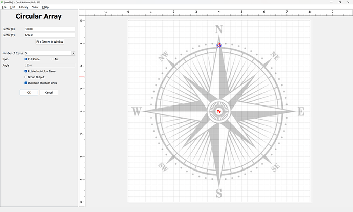

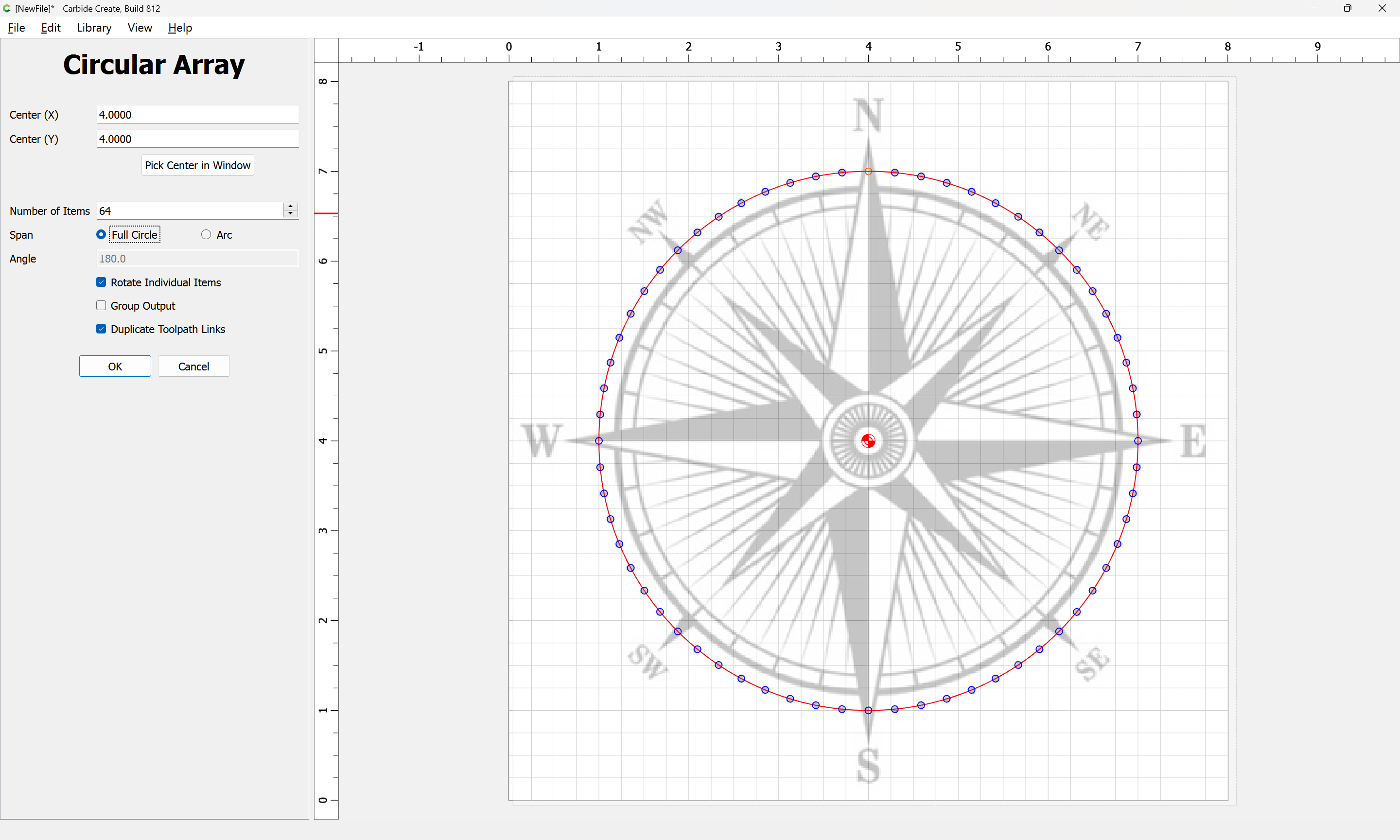

“Circular Array”
Adjust the parameters as necessary:

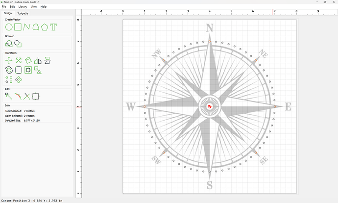

Count the circles to arrive at:
OK

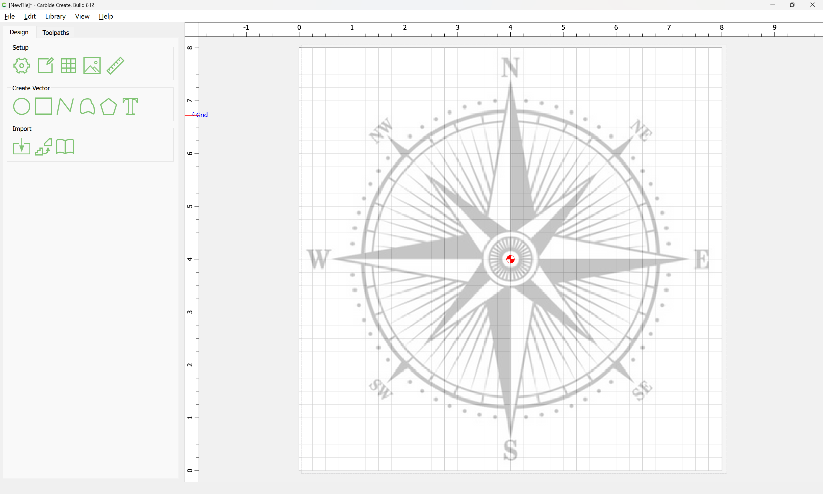

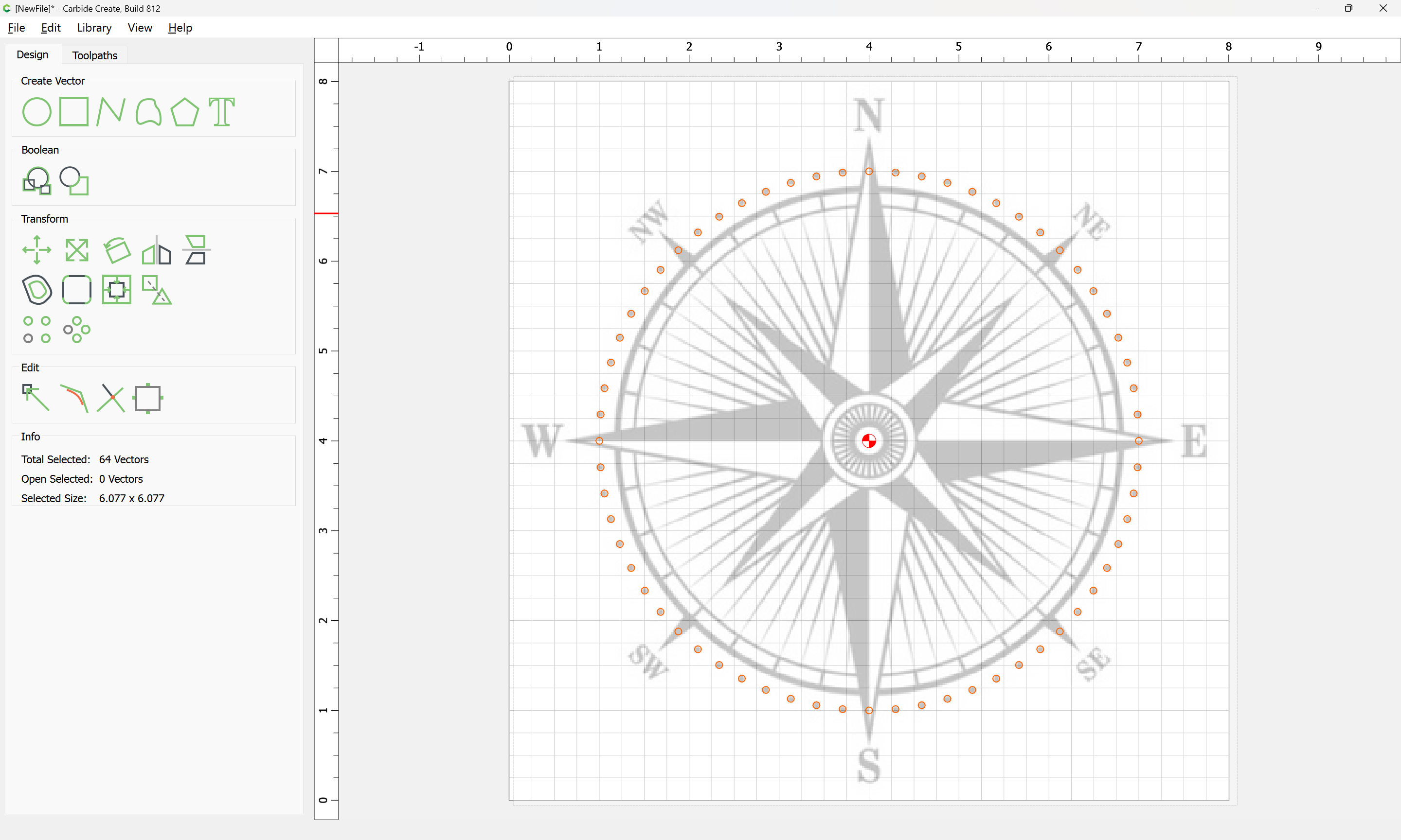

Delete the unnecessary ones:
Then draw the next element and repeat…
