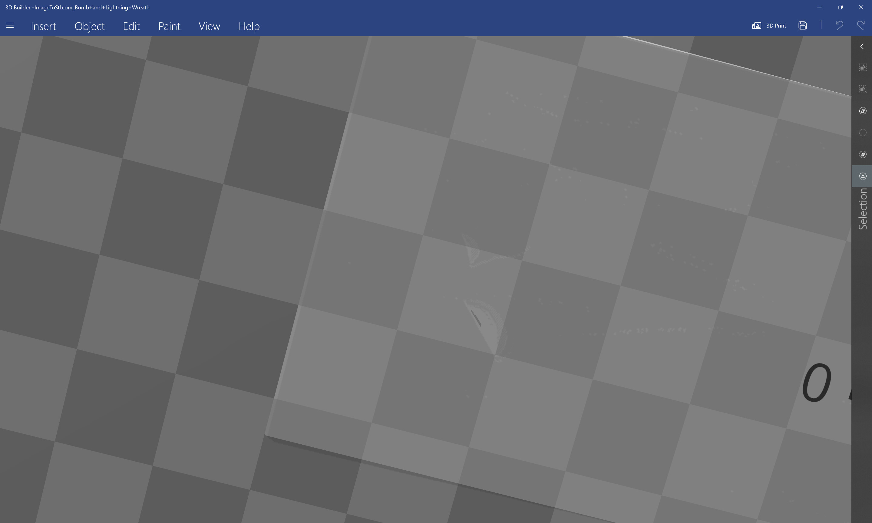

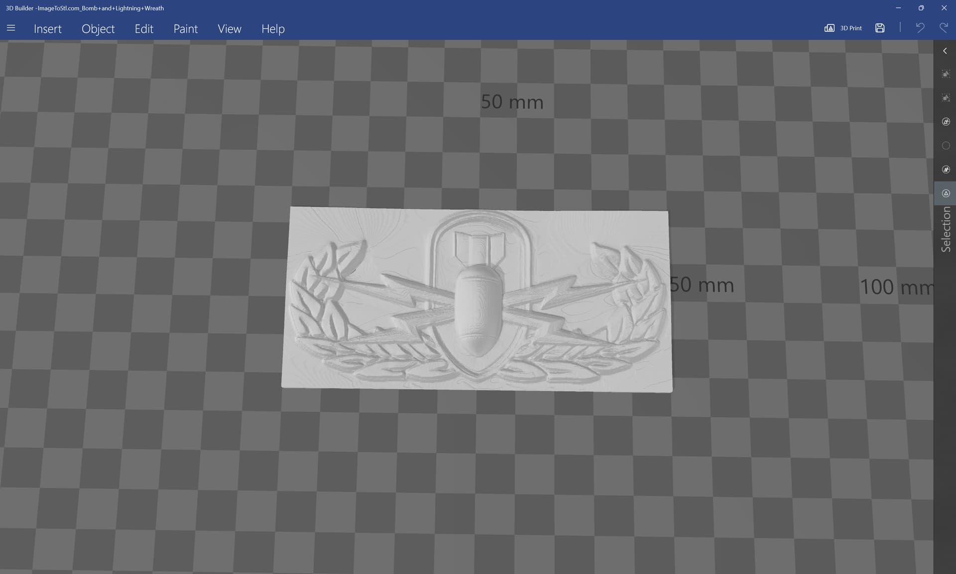

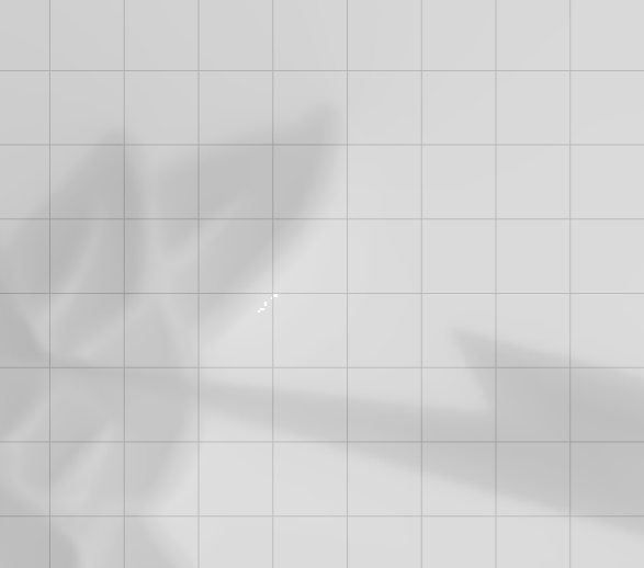

I have this STL file and there are these white spots that I think are going to be a problem. How do I get rid of them?

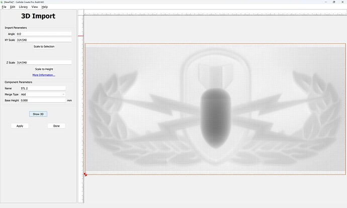

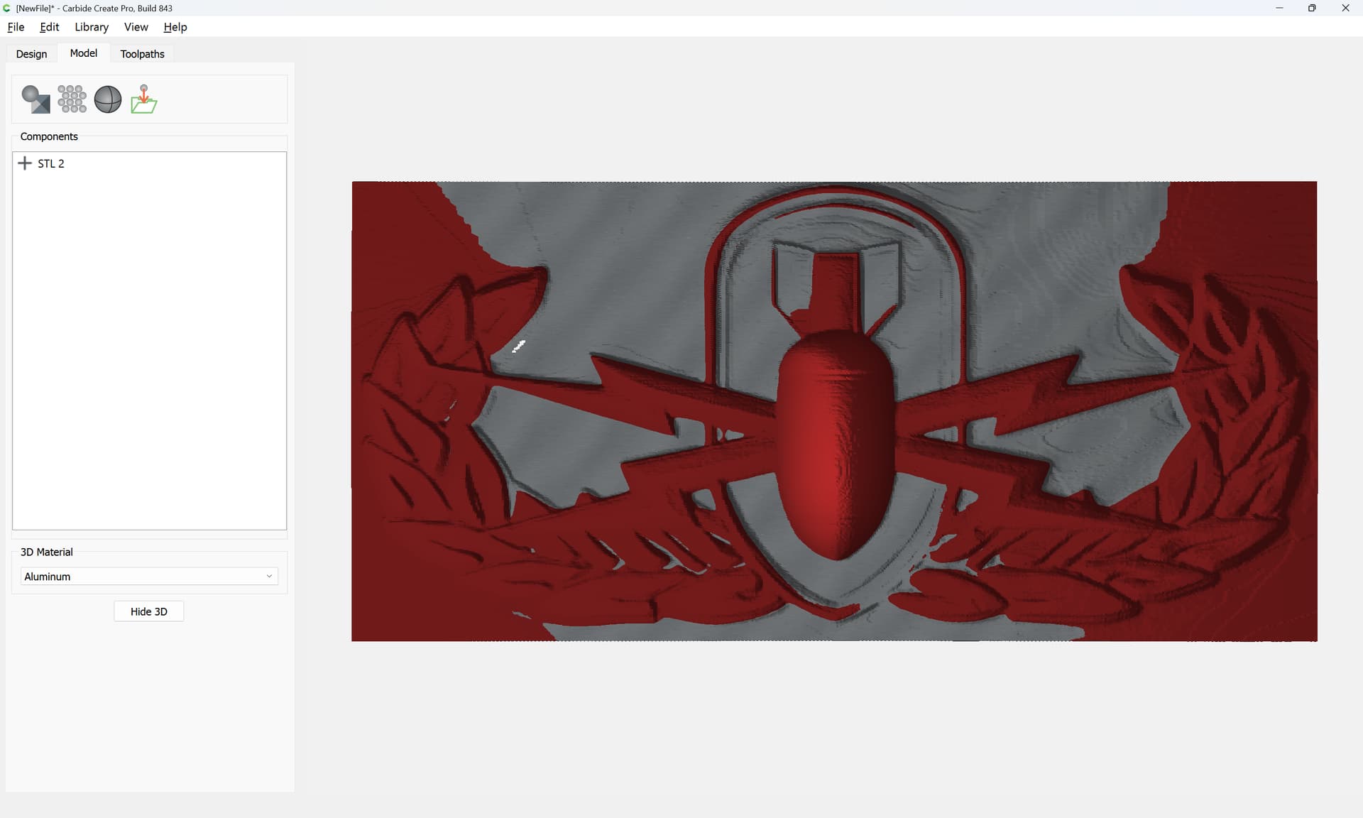

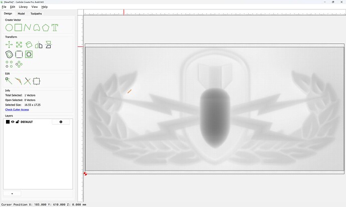

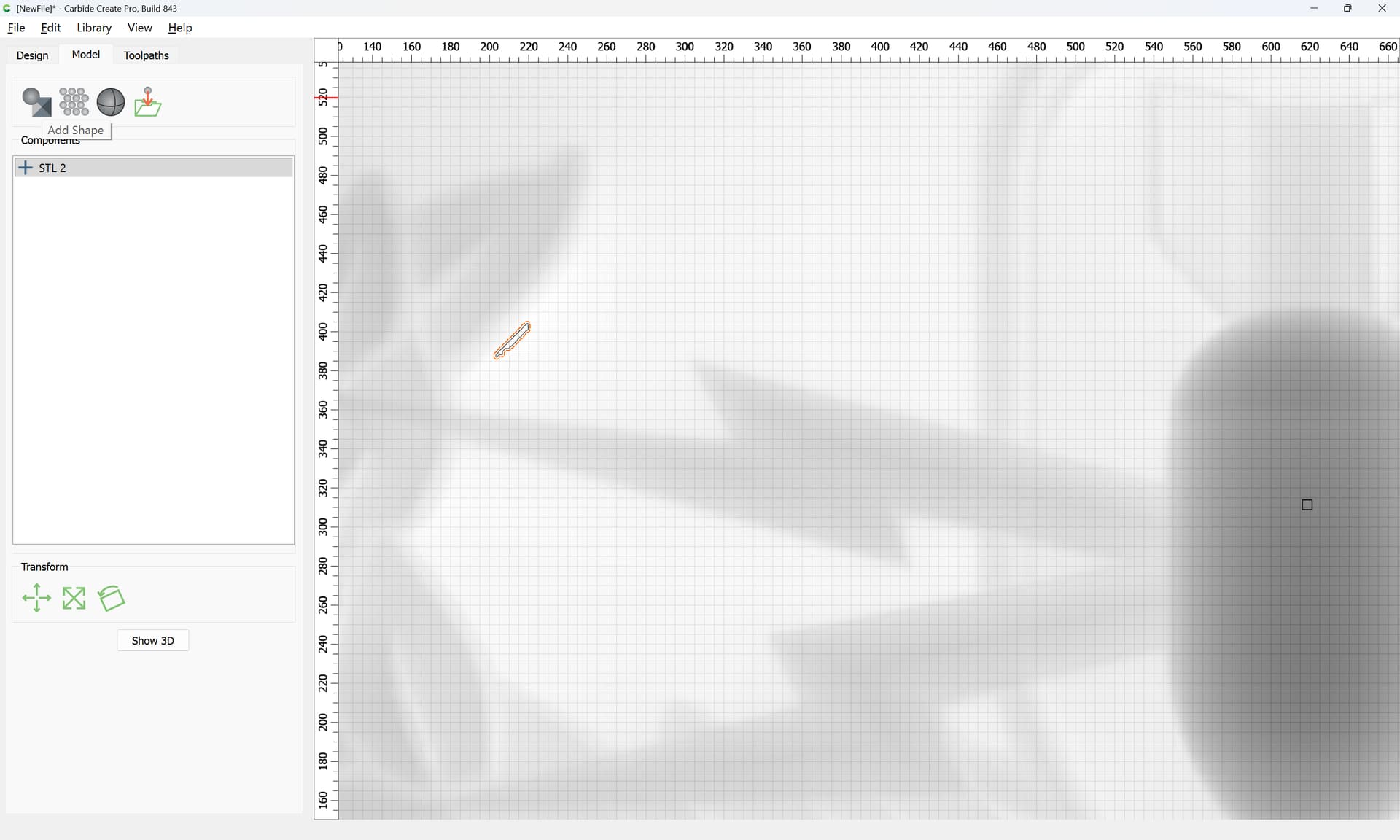

That file opens as expected:
though there are some odd discontinuities visible from the underside:

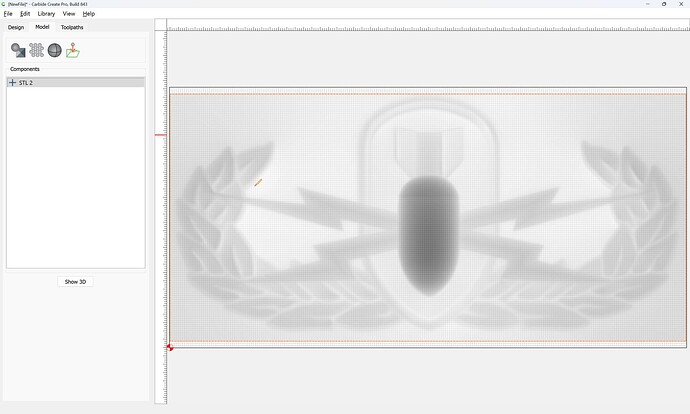

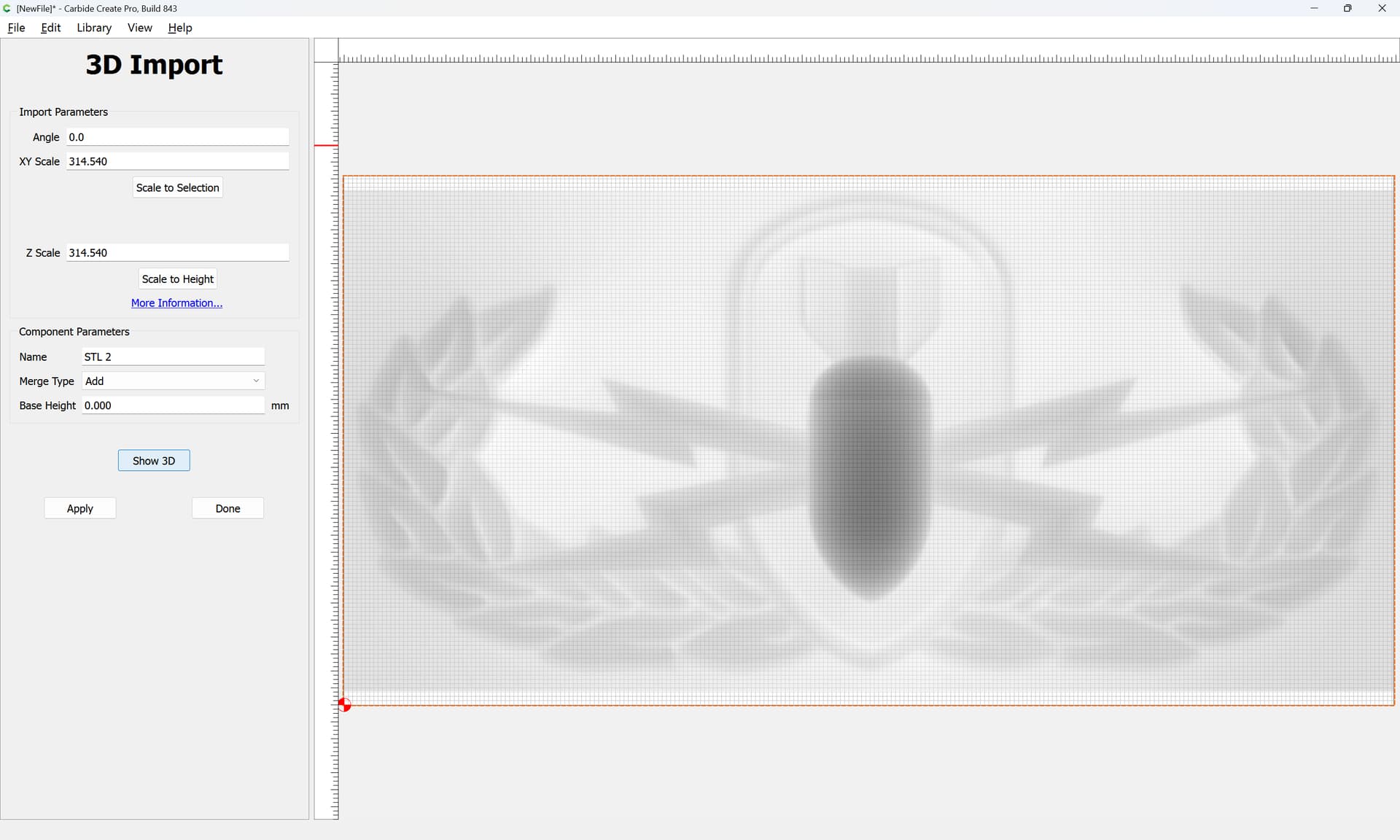

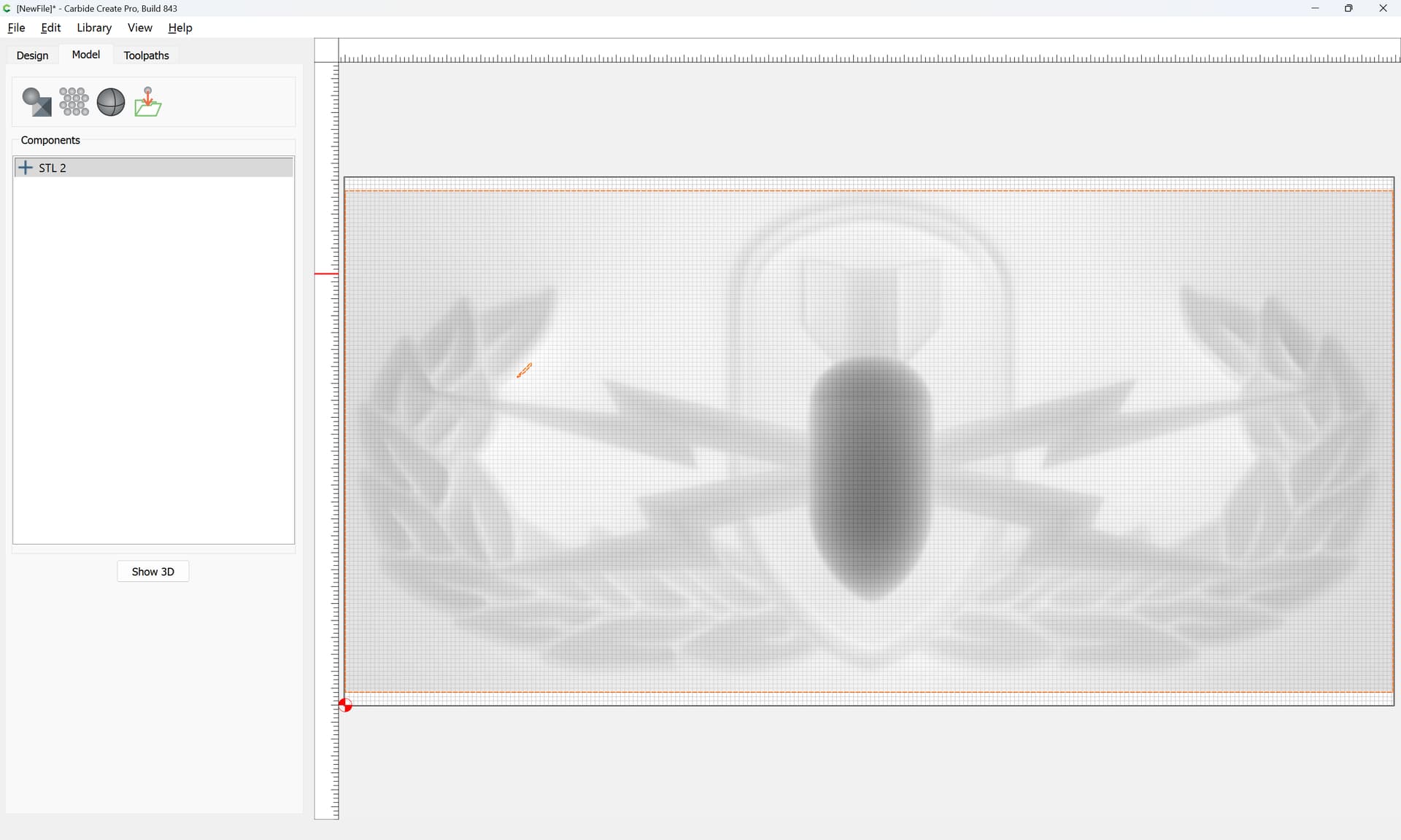

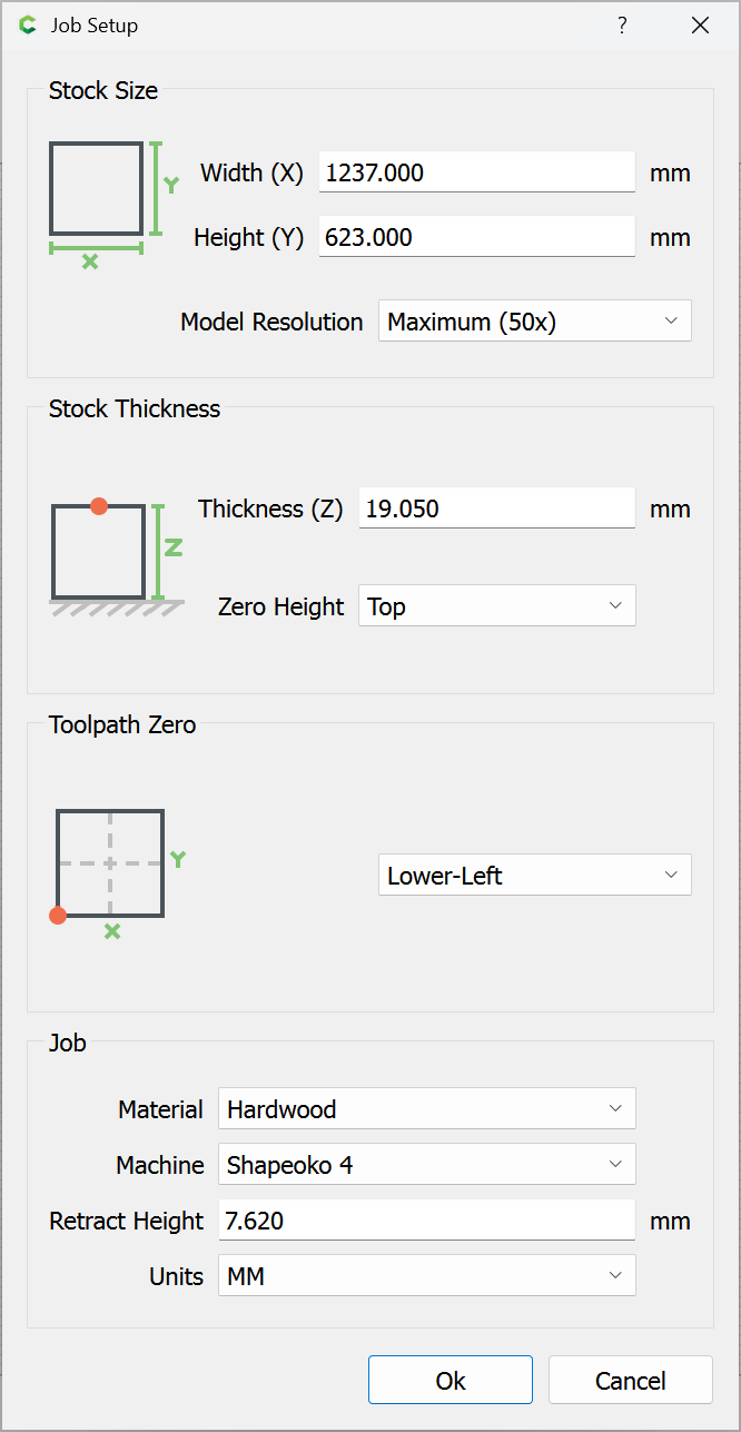

Setting the import resolution to Extreme:
and importing:

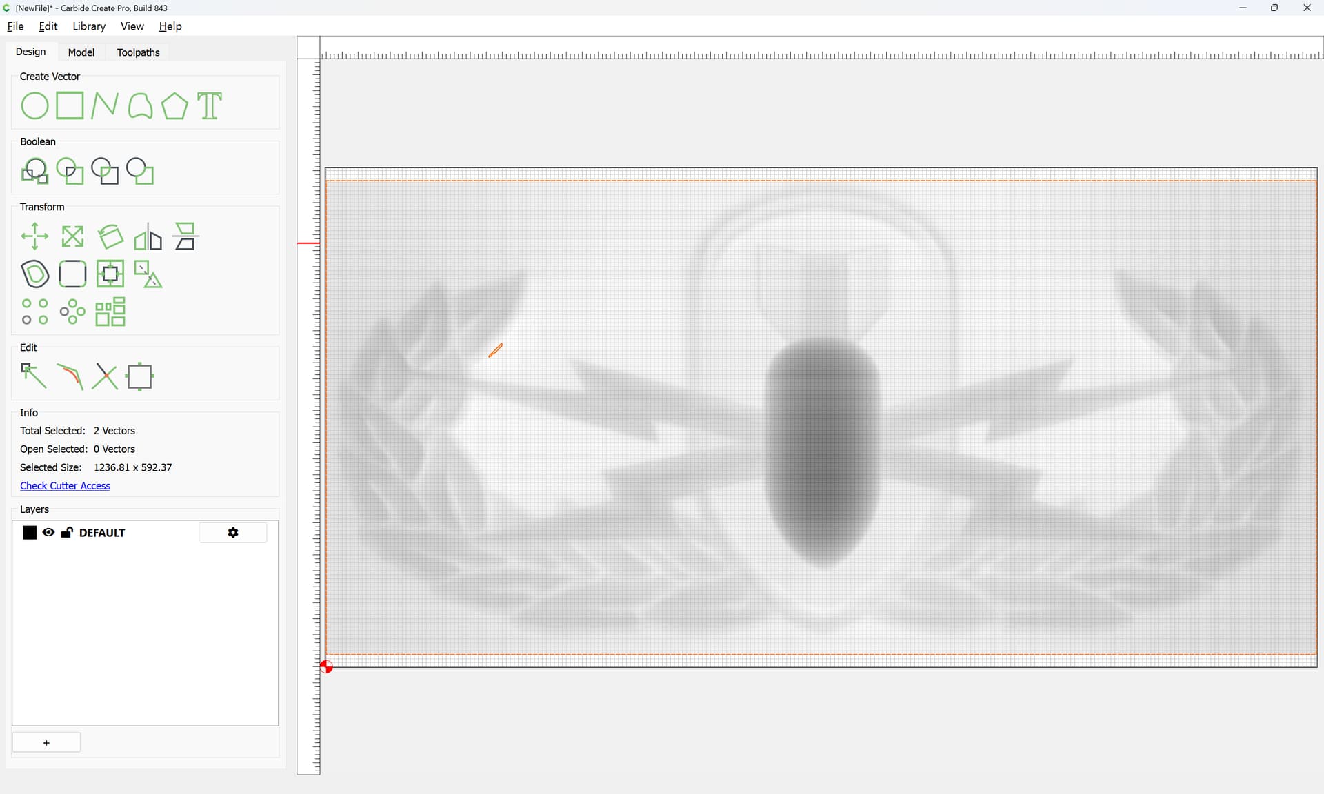

we get:
which seems to have the hole in the same area as the discontinuity observed from below.

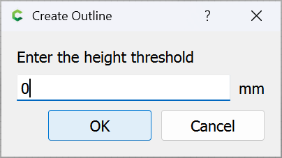

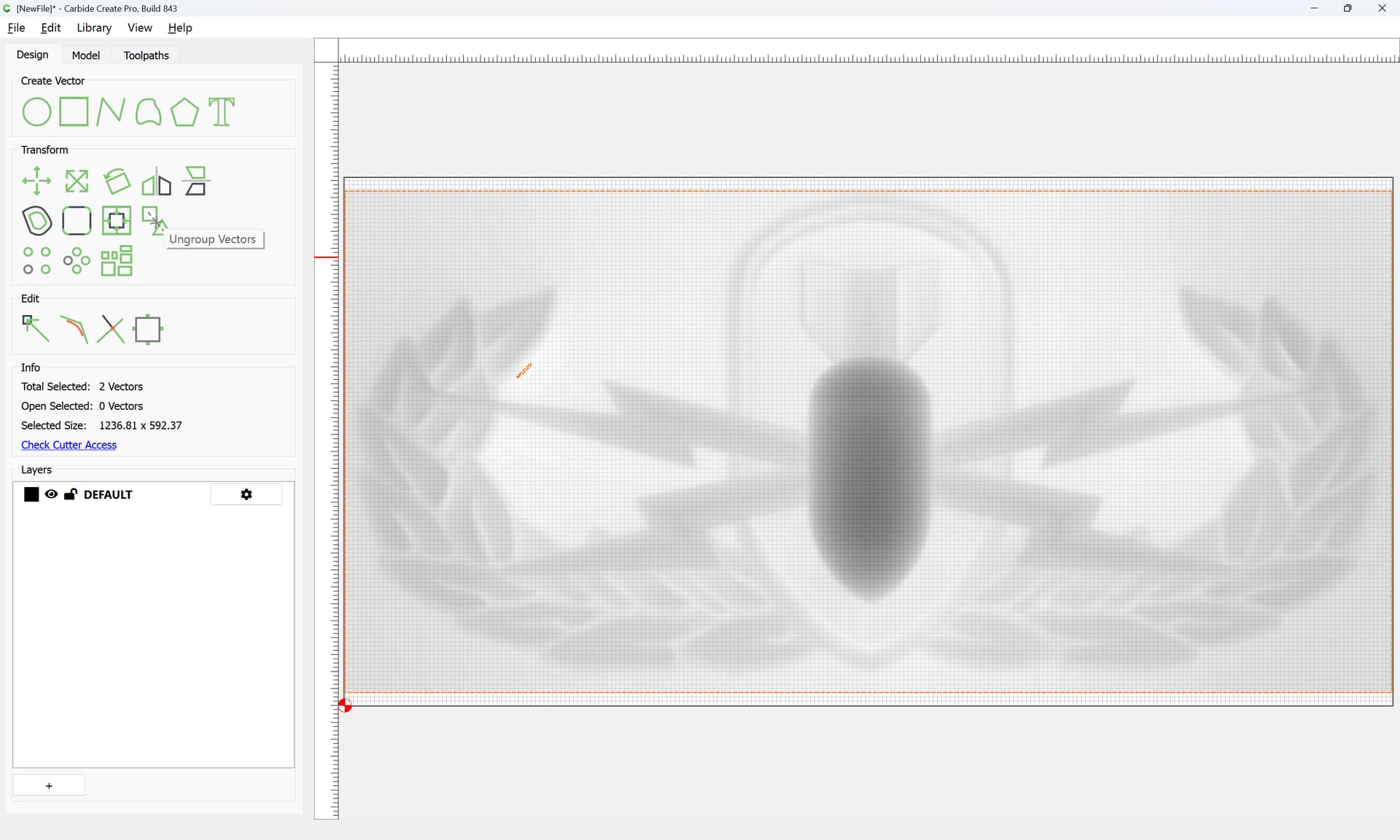

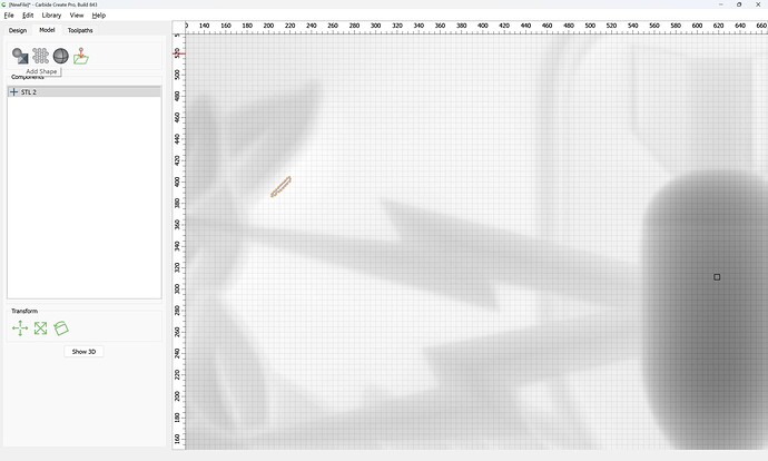

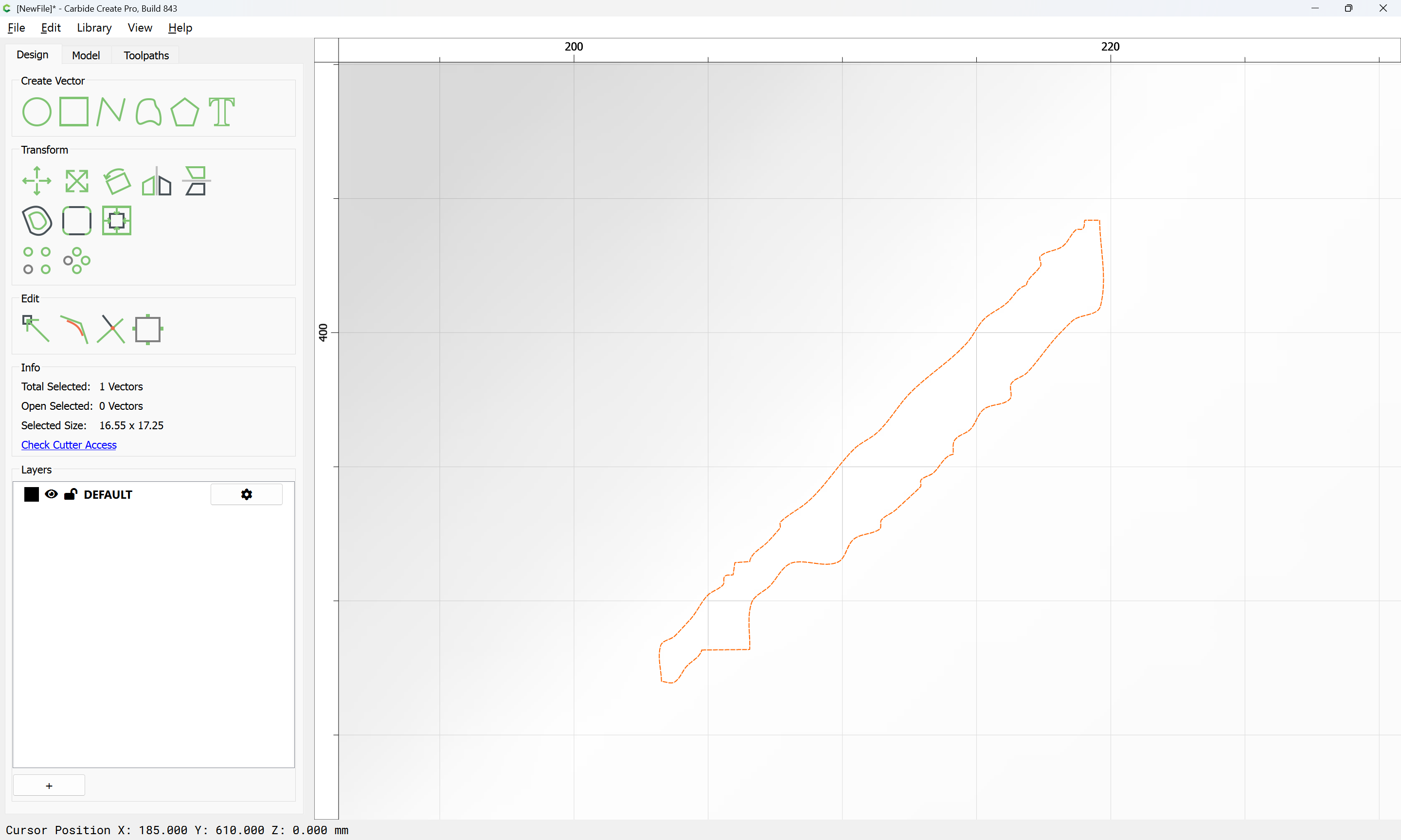

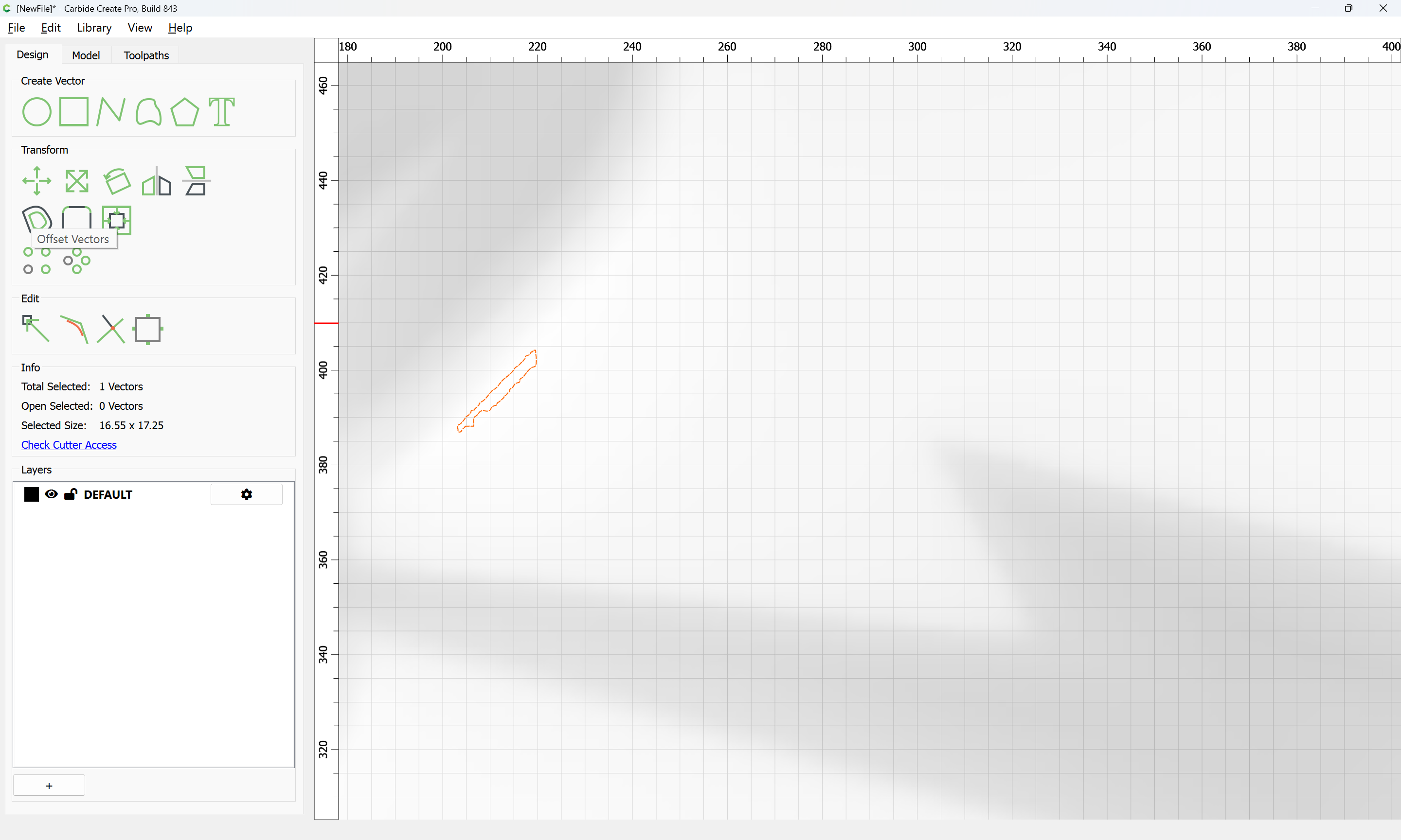

If we then trace:
then this region is identified:

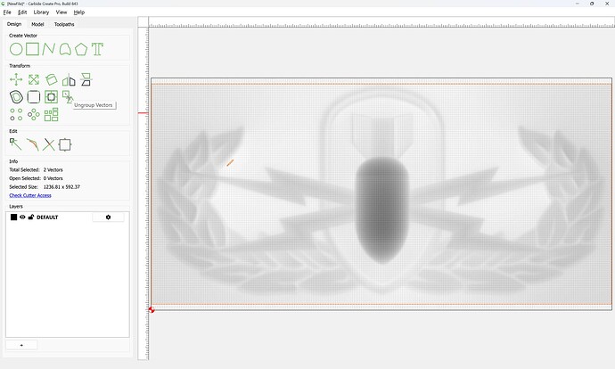

and if we Ungroup Vectors

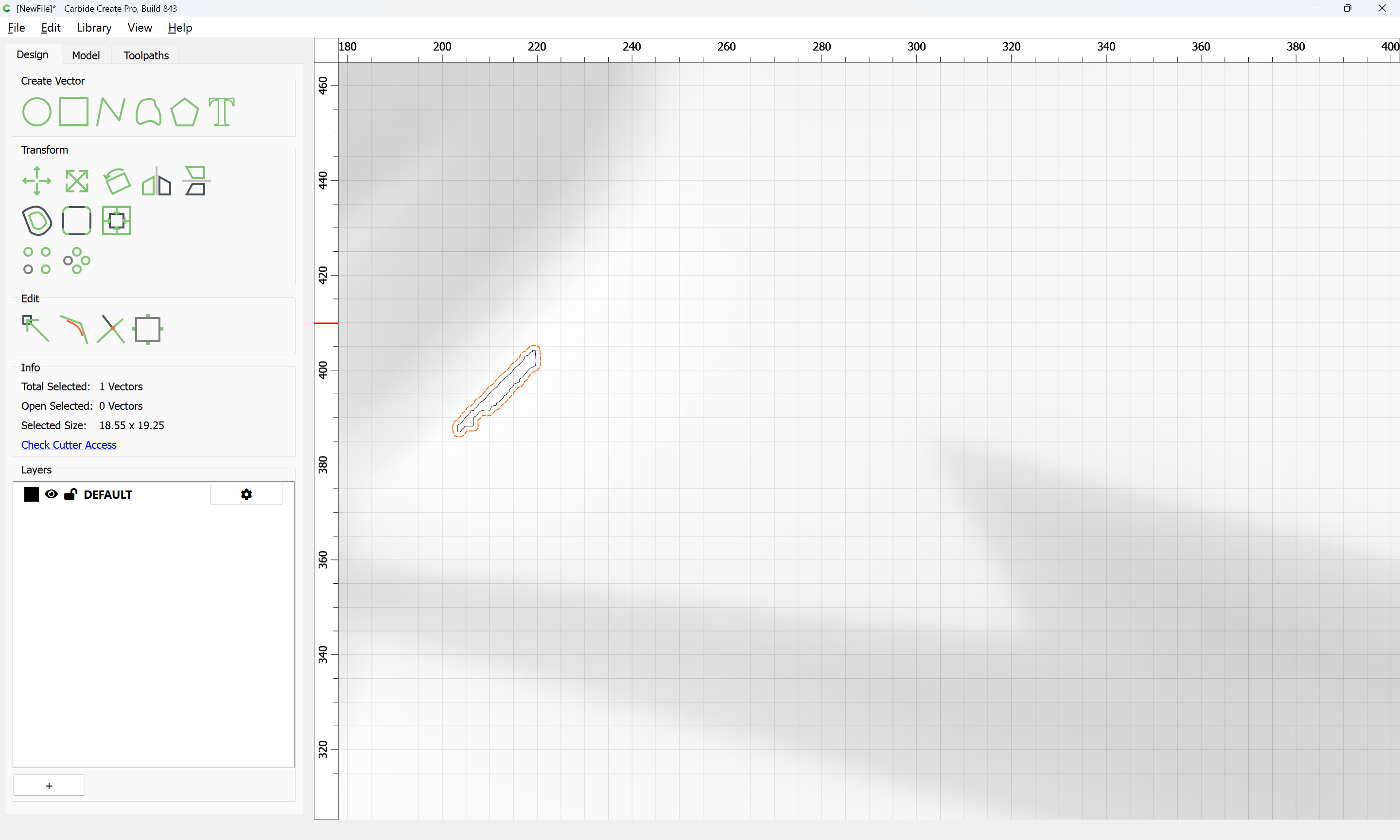

We may select only it:

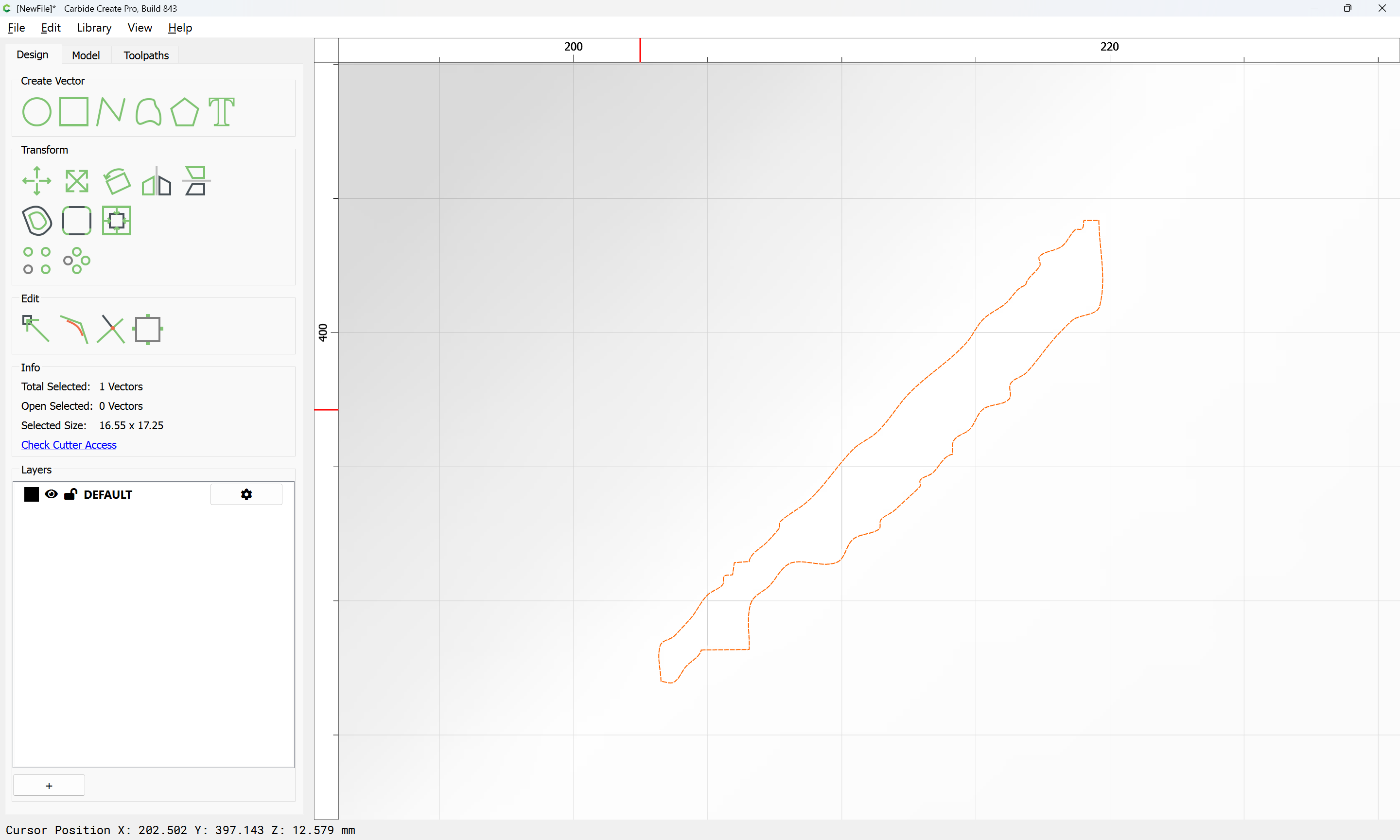

zoom in:

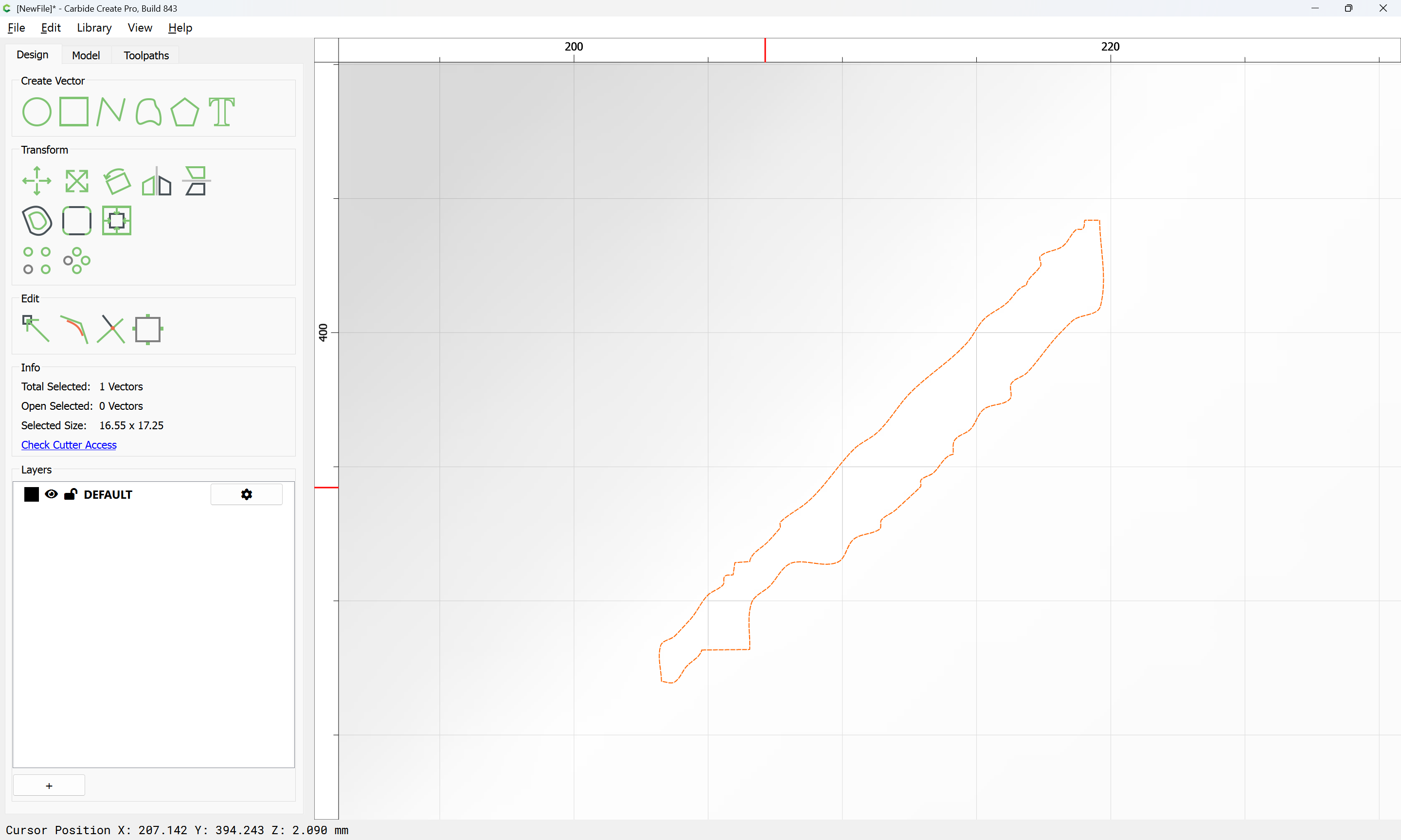

and use the mouse cursor and status bar to see that things range from a bit more then 12mm thickness in the surrounding region:
to 1 or 2mm around it:
and zero thickness inside.

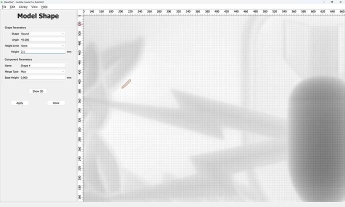

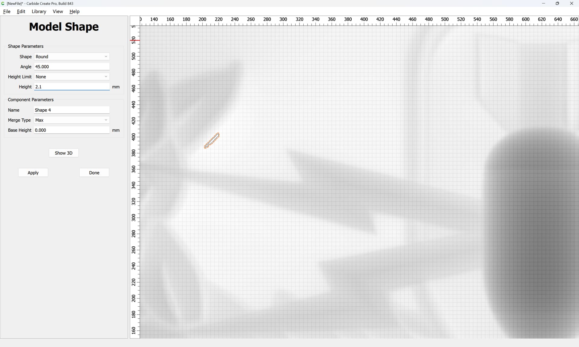

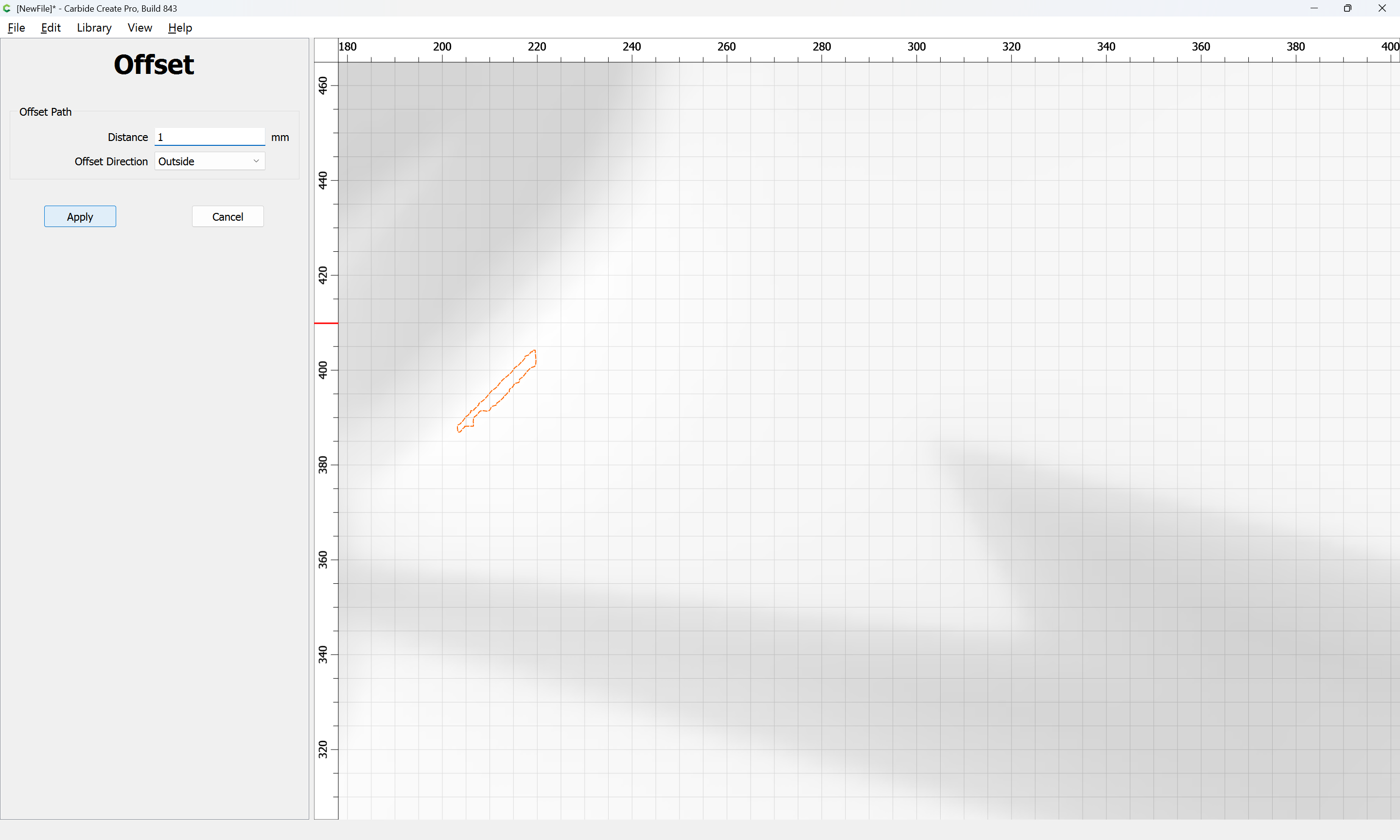

It looks as if this region should be just ~2mm thick, so if we offset it a bit:
and then fill that region to patch things:

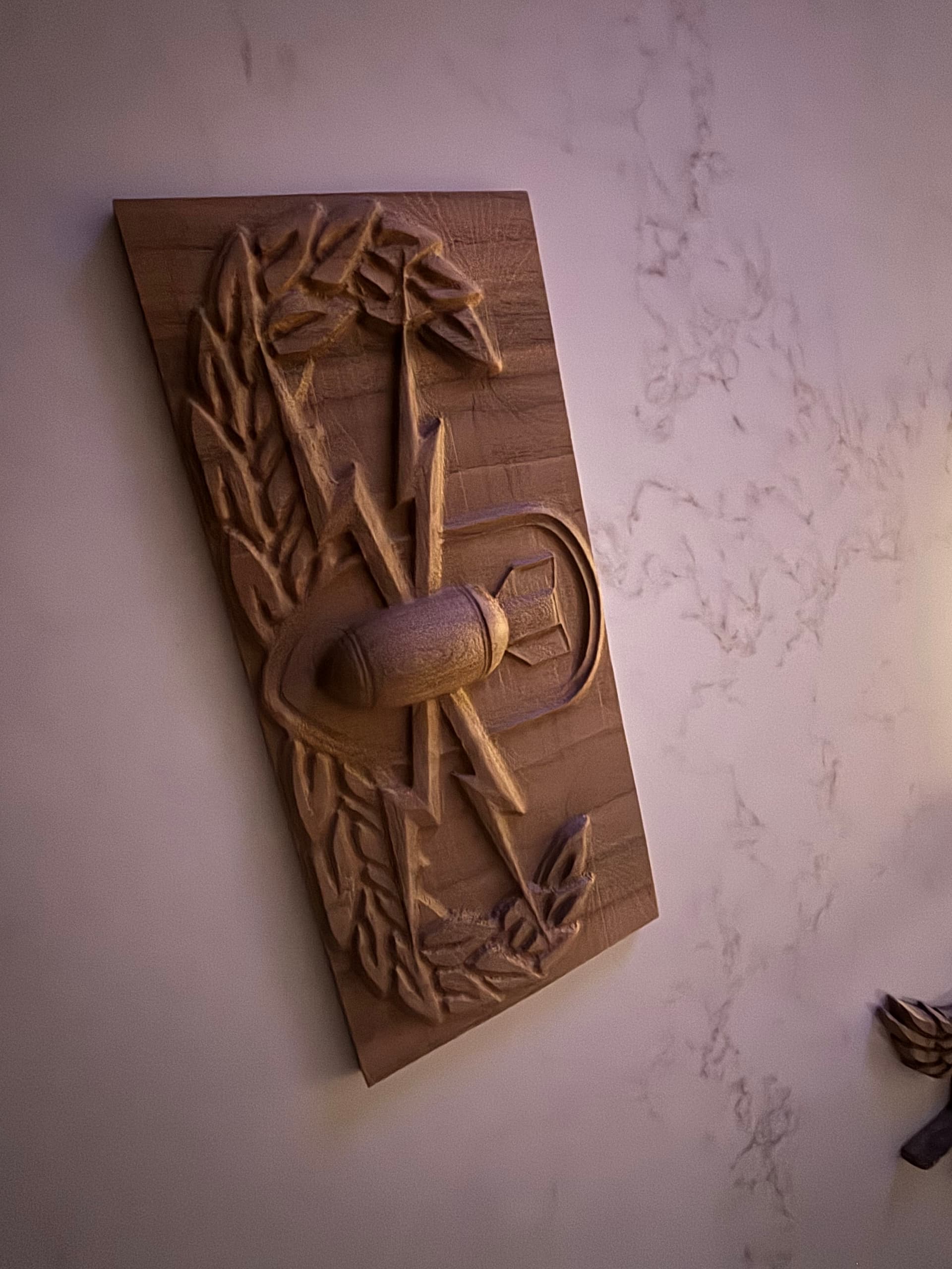

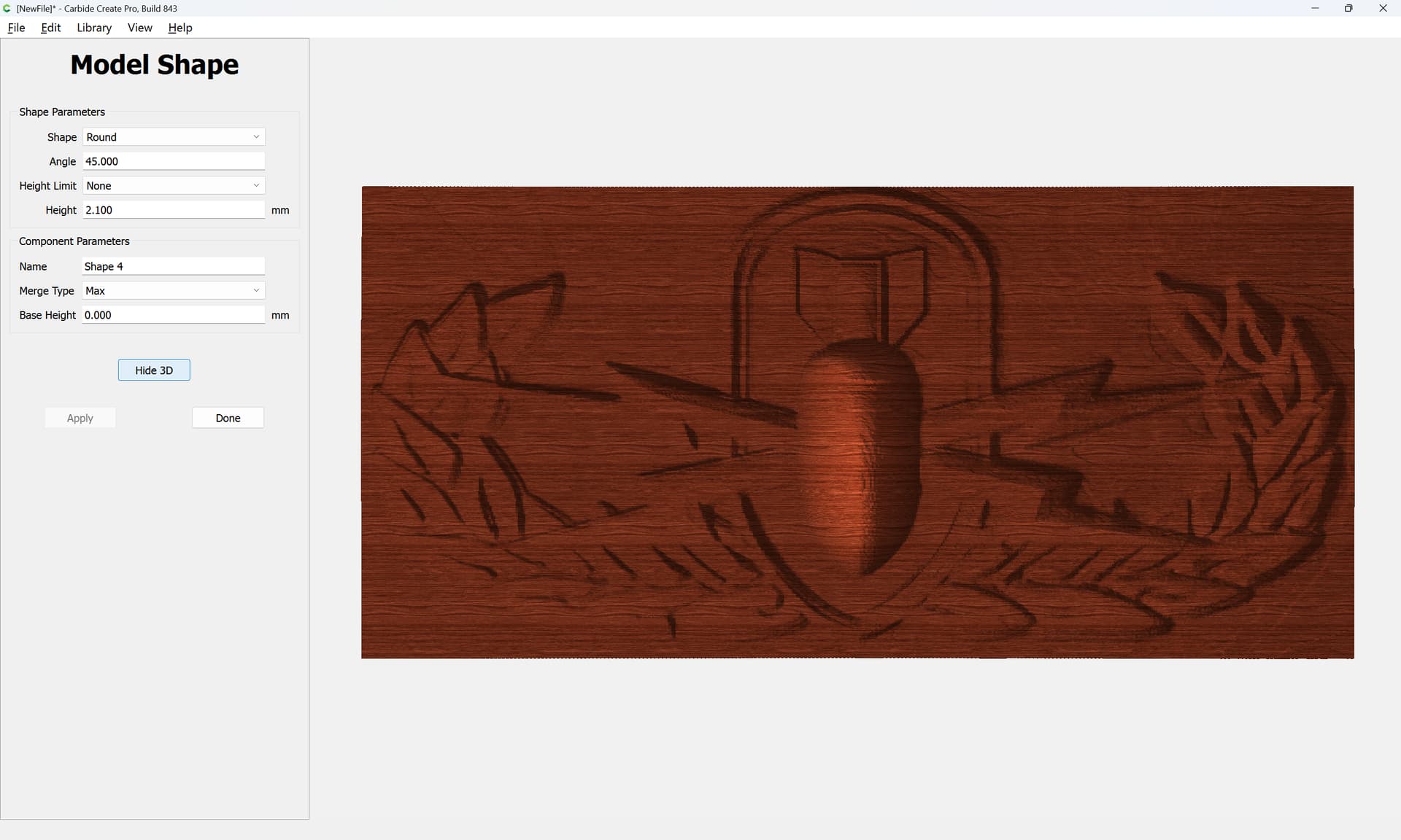

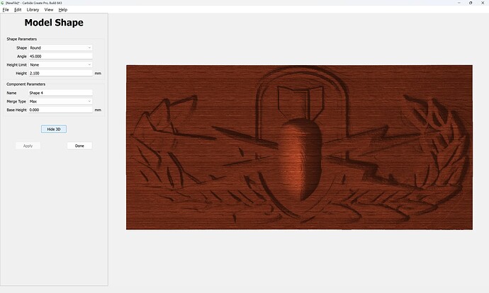

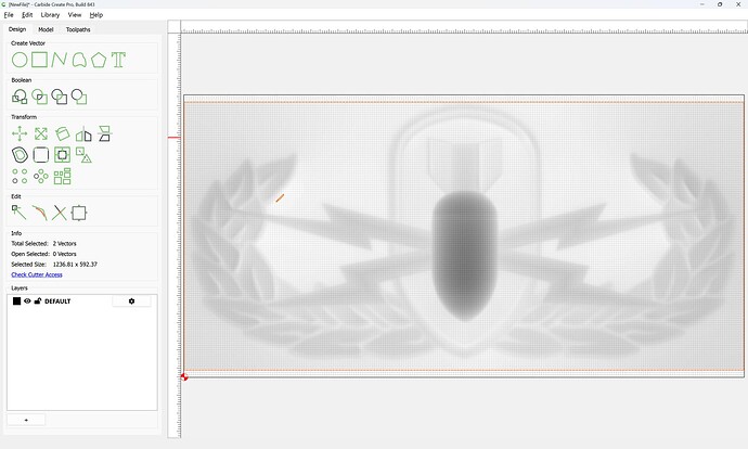

then things fill in quite well:

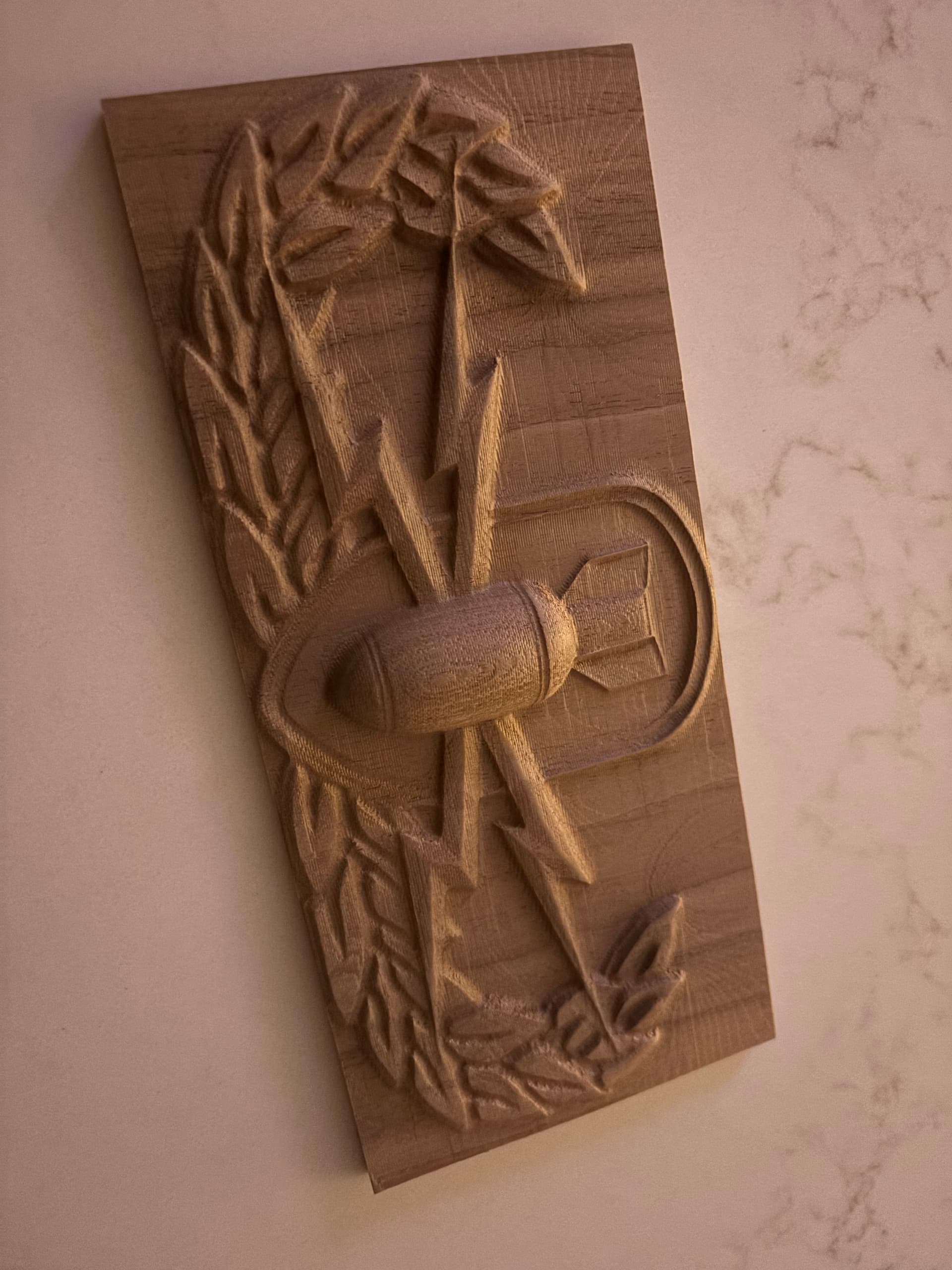

Not a bad finish! Thank you for all the help guys!
