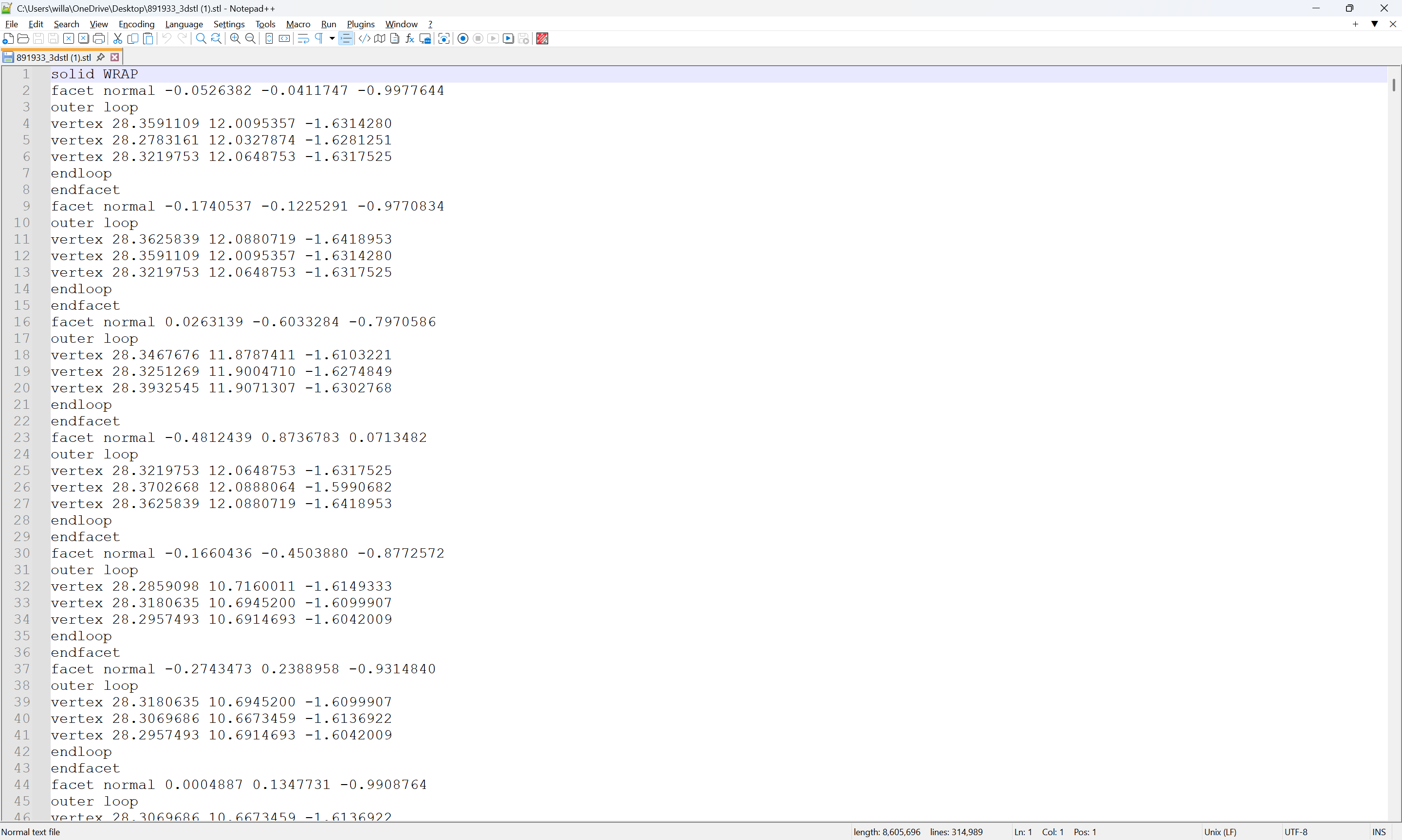

I’m trying to make a gingerbread molding using a stl from osbornewood /pierced-grape-moulding re sizing it to 6" wide 8’ long and adding a top border to attach it to a building:
**it will import into vectric but not carbide create pro (i just did vectric trial) **
WillAdams
(William Adams (Carbide 3D))
February 28, 2026, 11:49pm
2
Is it in ASCII format?

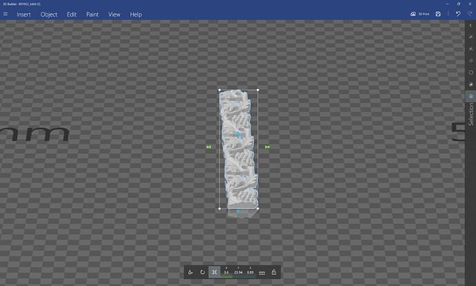

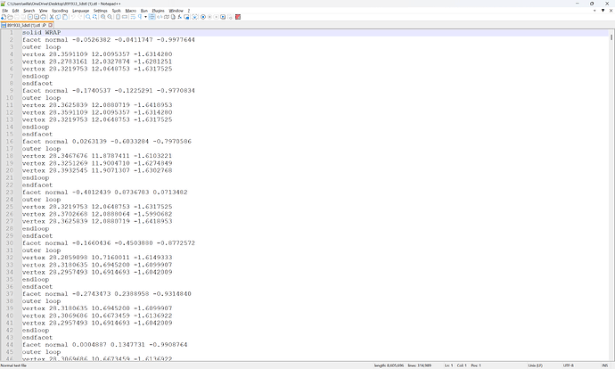

If presented with a set of STL files in ASCII format such as:
[image]
which will not import into Carbide Create Pro, they must be opened in a 3rd party tool such as Microsoft’s 3D Builder:
[image]
and re-saved as a binary STL which will then import as expected:
body_binary.stl (1.8 MB)
[image]
If that’s not it, upload the file here or send it in to support@carbide3d.com

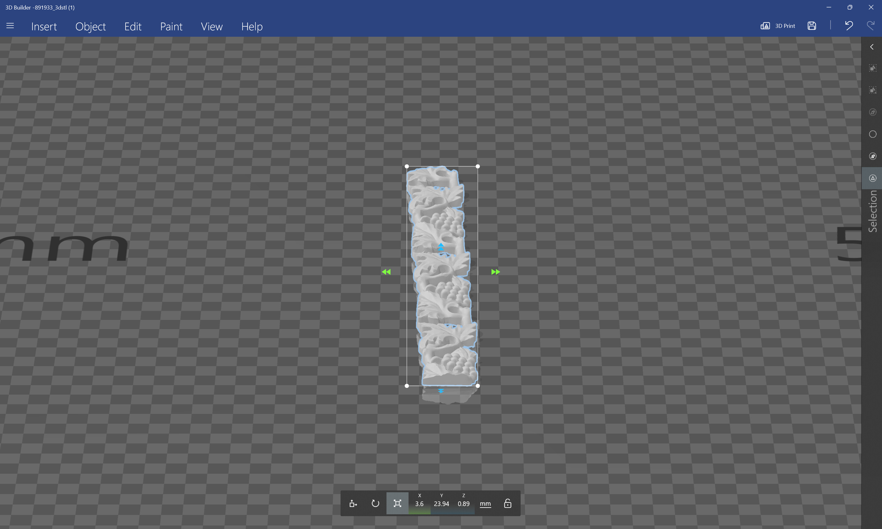

ASCII format:

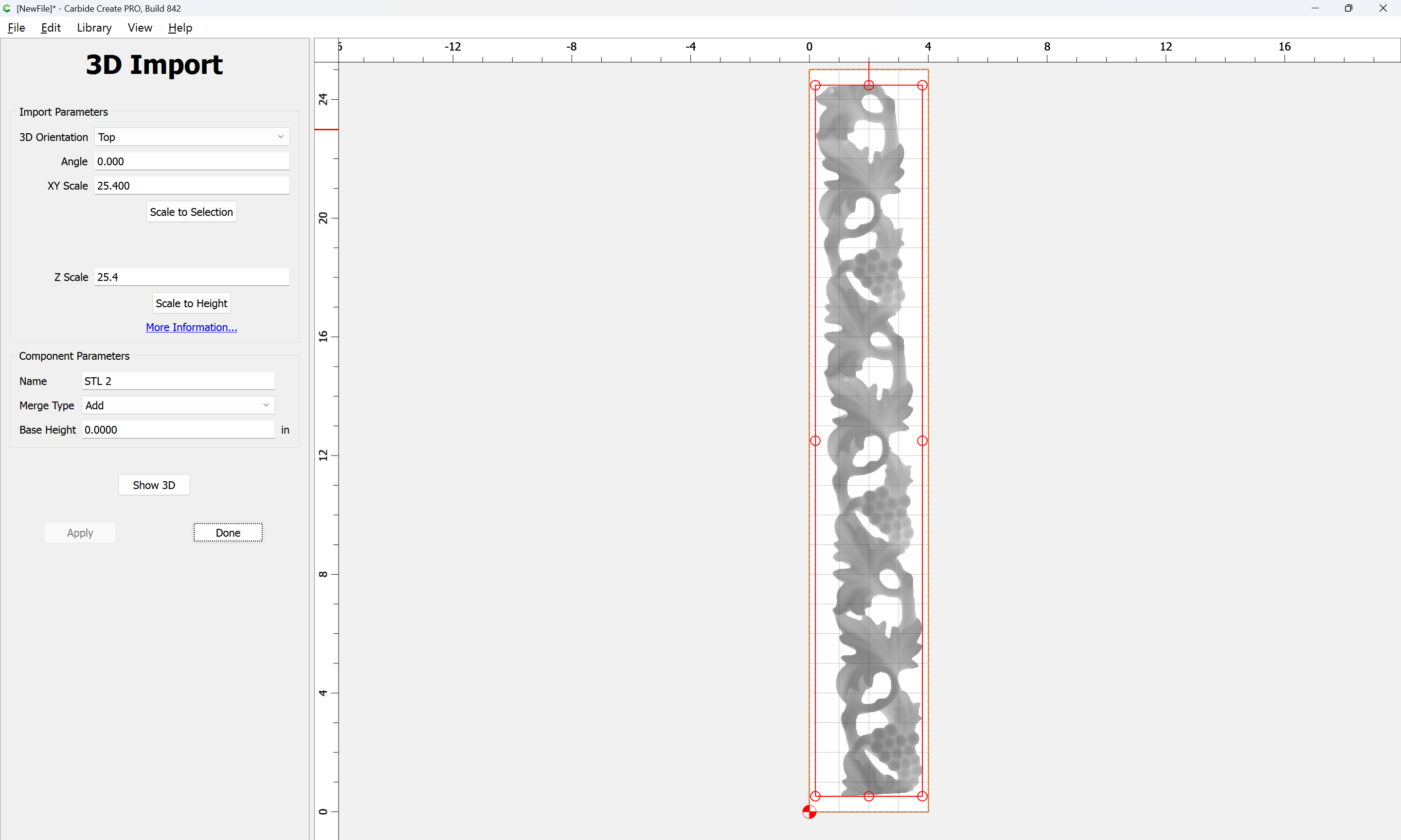

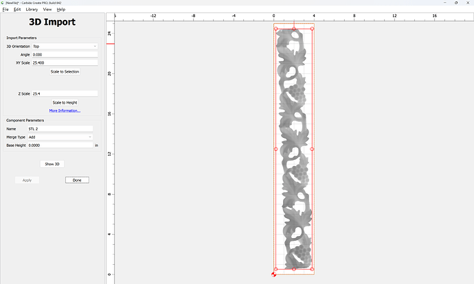

So we open in Microsoft 3D Builder:
where once it is repaired it may be re-saved as a binary format STL:
891933_3dstl_binary.stl (2.2 MB)
which imports as expected:
(scaled up by 25.4 assuming it was supposed to be Imperial measure (inches) rather than millimeters)

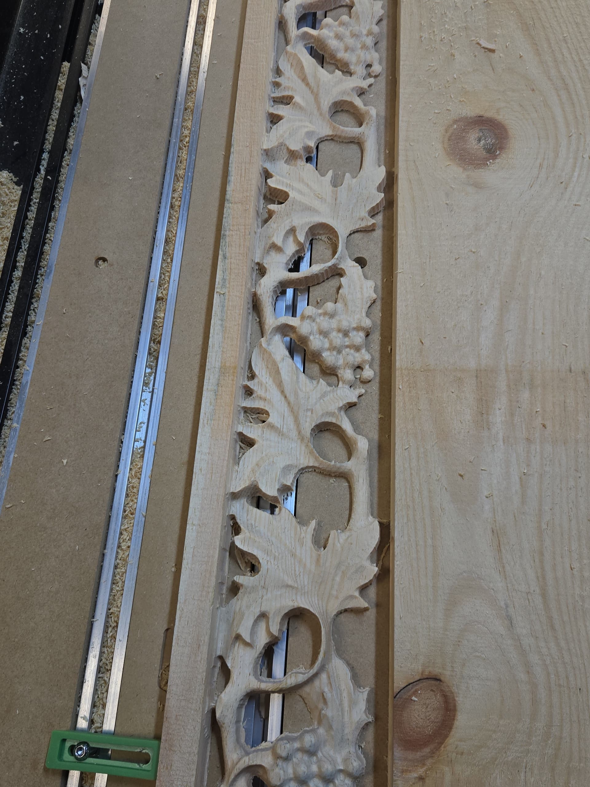

DanKas
(DanKas)
March 3, 2026, 10:49pm
6
Came out pretty good going to try to make it a little thicker by adjusting the base hight
