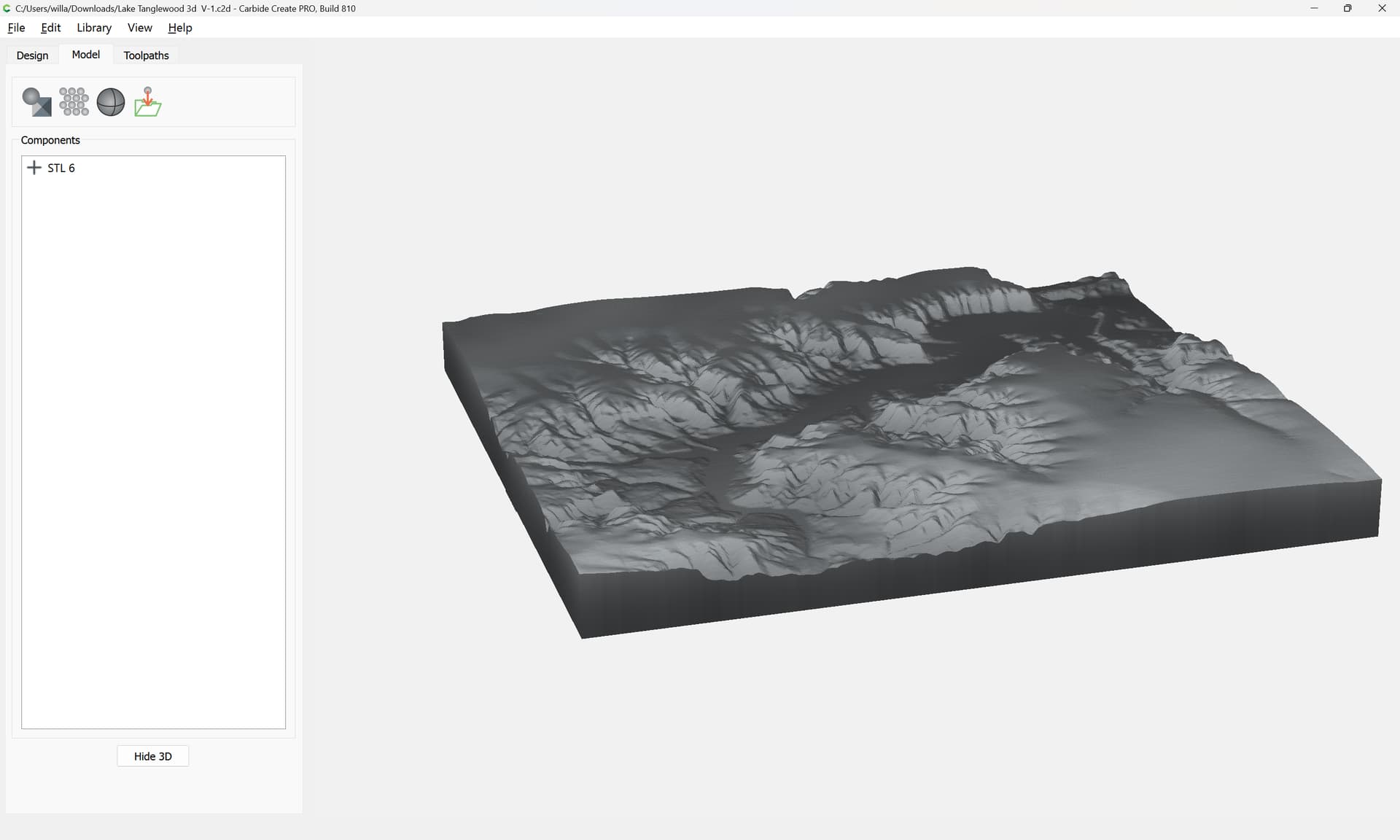

Just noticed when I right click a component in the Model tab there is an option to Create Outline Vectors.

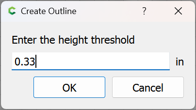

When selected, it wants a “height threshold” input.
What does this do and how does it work?
When I tried it, I didn’t notice any changes in the design.

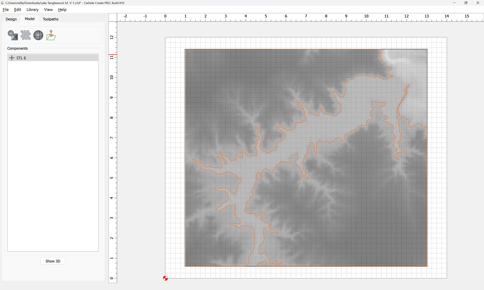

What I hoped it would do is outline the lake in the attached model so I could cut a pocket for epoxy. Any solution for that?

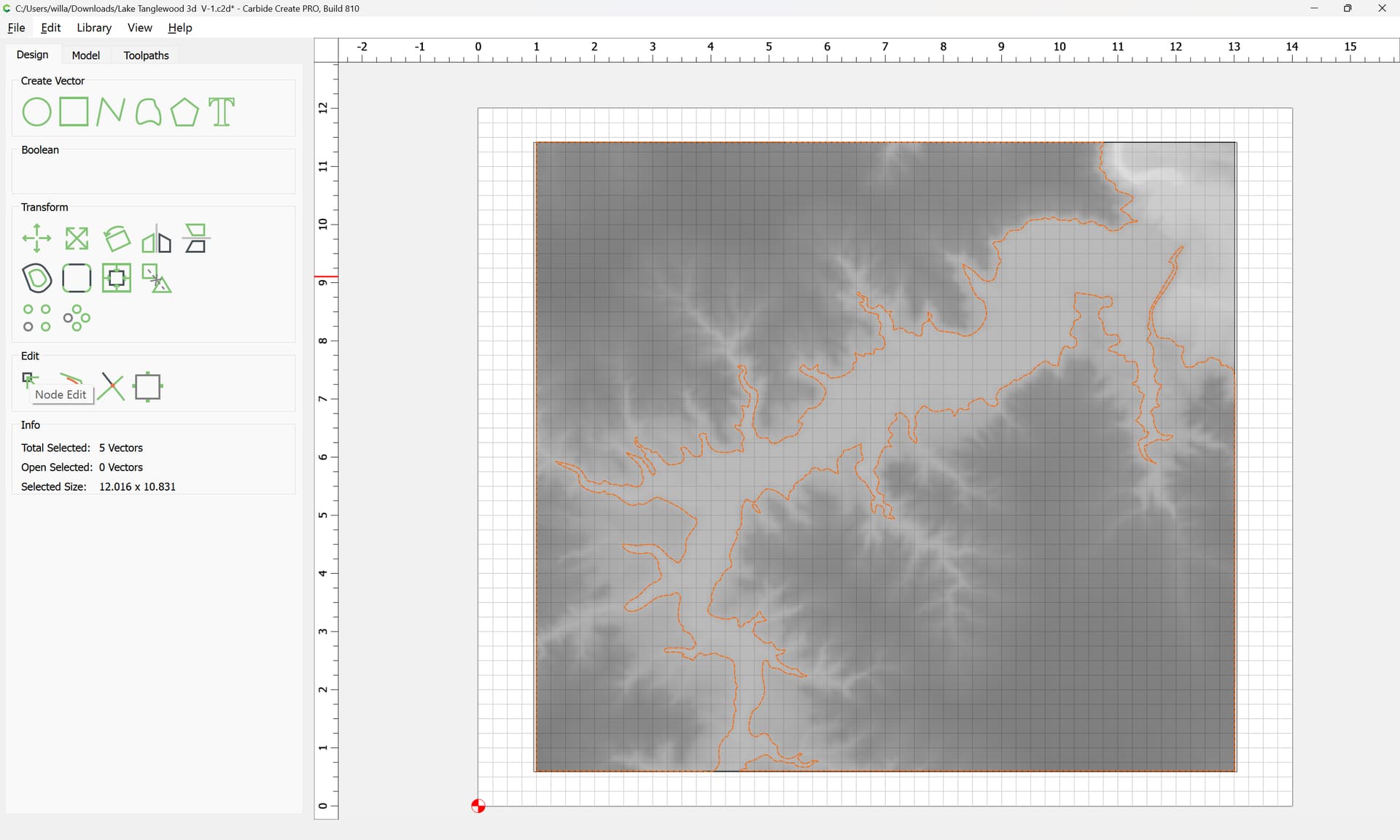

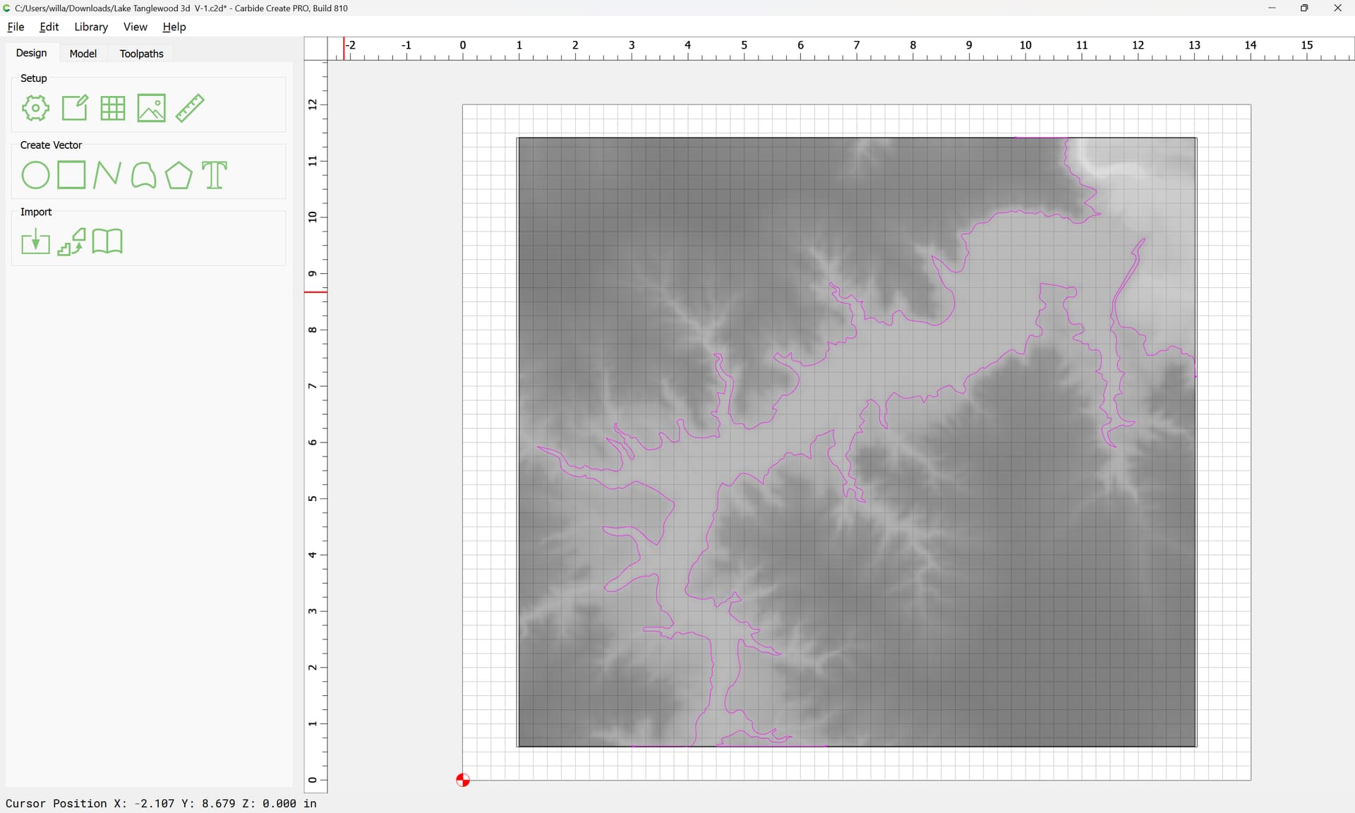

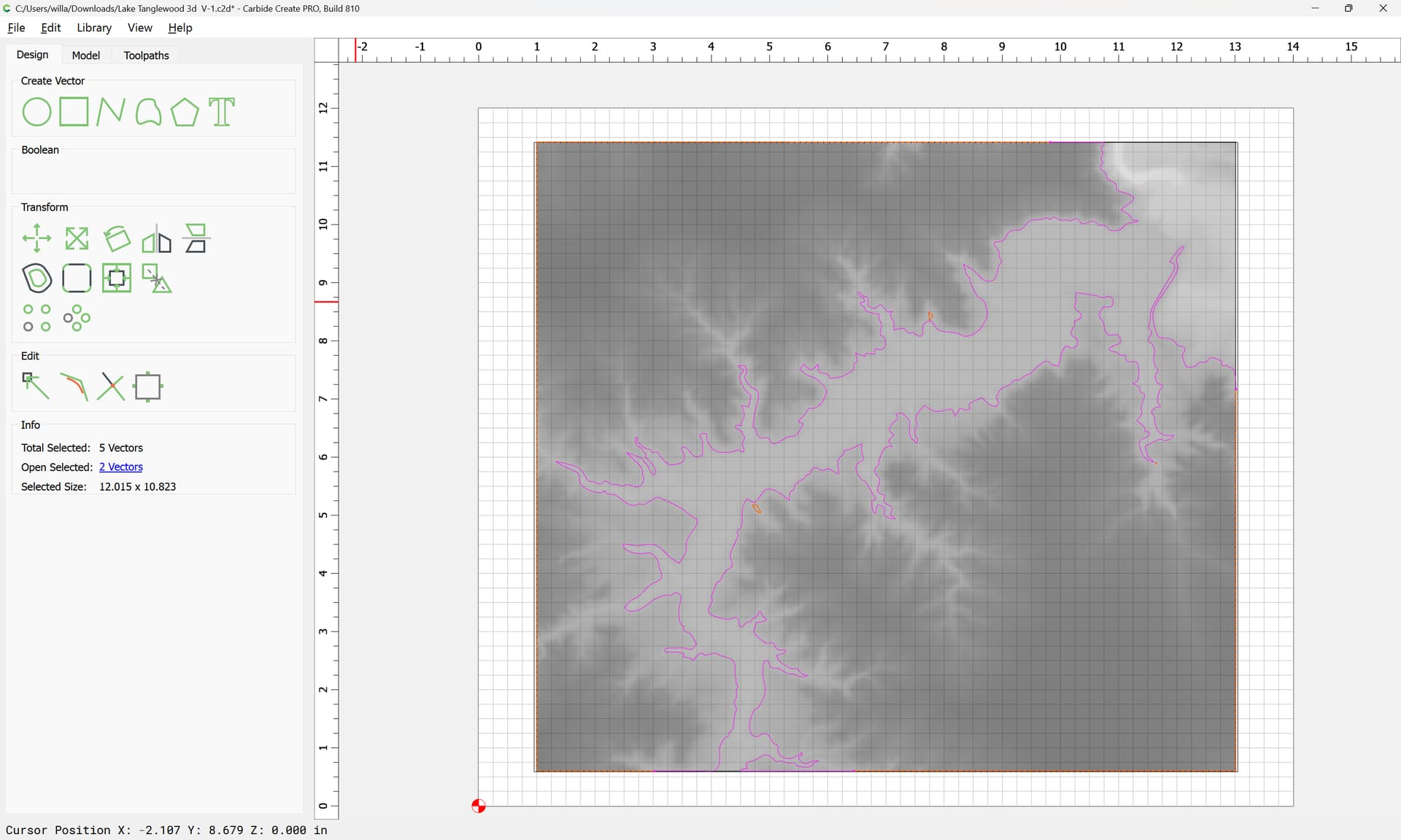

Yes, it should be usable for that — if one knows the height of the lake:

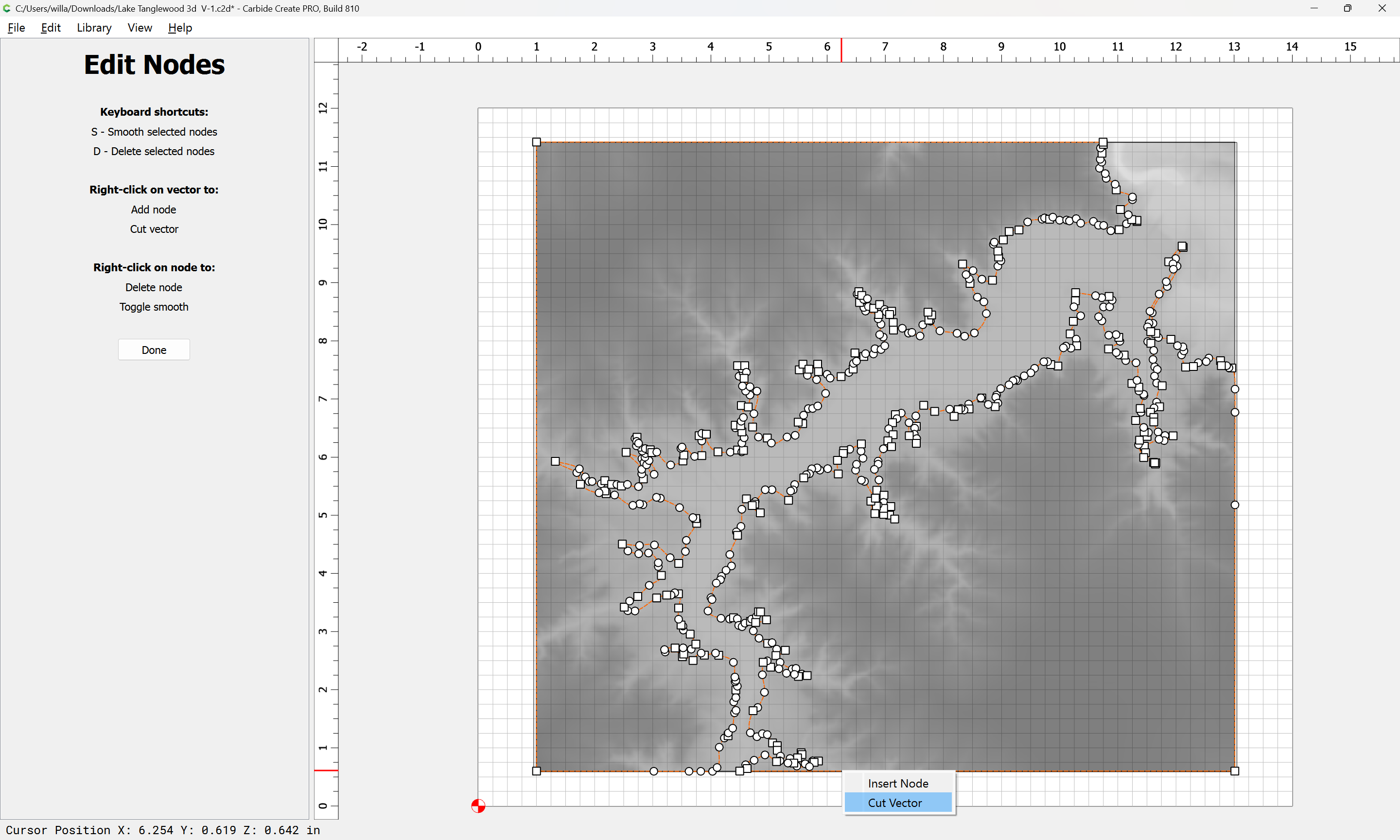

Just adjust the dimension until you get what you want, then go into Node Edit mode:
and cut the geometry:
repeating
Done
and then deleting what is not wanted:
and joining together what you want to close.
