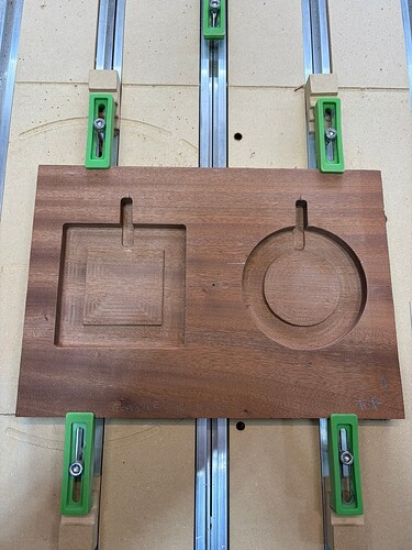

I made a jig to hold coasters in place while I cut designs into them. I created pockets into the material to place the coasters into but the toolpaths cut in a very strange way. On the outside pockets instead of clearing the pocket area in successive parallel cuts the cutter does small cuts and then does a full pass as expected. The end result is as expected but the cutting is strange.
I recreated the design and toolpaths thinking there might be something there I couldn’t see but I got the same thing.
Probably not a good explanation so here’s the file. Have a look at the simulation on very slow speed and see what you think is happening.
Coaster Jig 100mm.c2d (288 KB)

The only concern I see in your file is that the inner/shallower pocket of the square design is not large enough - needs to overlap the outer/deeper pocket area to avoid material being missed by the endmill.
@Chaotica Yeah I saw that as well. In the actual cut there is just a slight onion skin on the inner edges which cleaned up easy with a light sanding

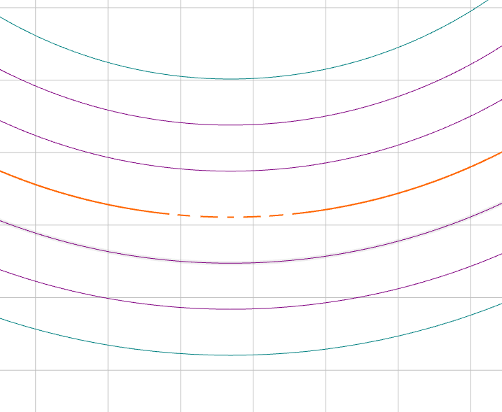

Now I see what you speak of.
If you select both circles and offset them inward 3.175mm, you will see the same thing.
This is how the pocket path calculates where it needs to cut. Even changing the stepover to 3.1 eliminates it.
Welcome to computer math, where everything makes sense, until it doesn’t.
Looks like you are running into rounding errors, so that sometimes the paths seem to overlap (so nothing else needs be done), and sometimes they don’t (all the weird little areas).
In general, if your stepover exactly divides into the width of the pocket, there’s a good chance you will run into this problem.
Since it’s human nature to make things ‘round numbers’, what I have done is to change the stepover to be some slightly ‘not round’ number. If the stepover was 0.125" (1/8"), I’ll change that to 0.126" instead. The tiny difference won’t affect performance, but it will break up all those times when it would divide evenly into what we think of as round numbers.
