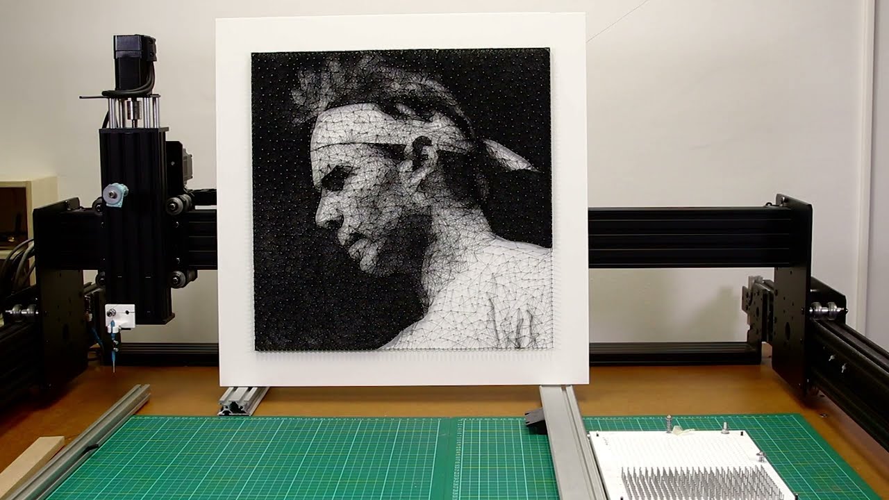

I did see that video - and it made me decide that drilling holes and placing the nails by hand would be easier than a CNC driving the nails directly. :smiley:
But yes - after that I want the CNC to do the stringing too.
Was that plotted by software or by hand?
I didn’t watch the whole video, but I think it is a custom piece of software.
I’ve seen open source versions before.
Yeah - that video is using software he developed himself. You can read a bit more about it at: Autograph: A String Art Printer | Hackaday
There are a few videos out there about the math of how to generate string art from photos.
There is an opensource version for generating patterns using a circular frame. The code is at: GitHub - halfmonty/StringArtGenerator: Web based string art generator
And a web ui to it (so you don’t have to download and figure out how to run it) available at: String Art Generator
