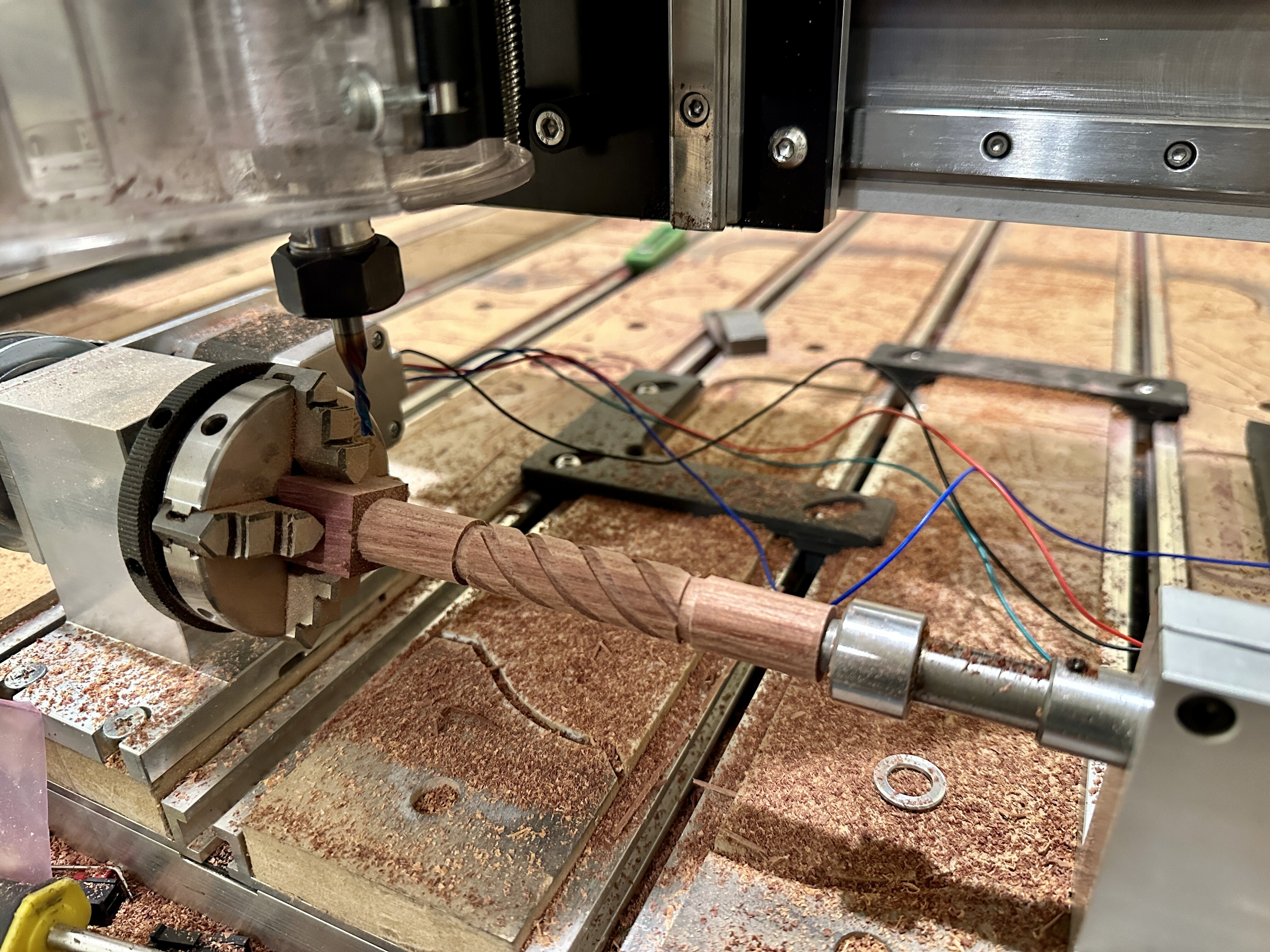

Struggling with rotary step calibration - please help, I don’t think I can overcome this hurdle alone 🙏

Success!!
I set $101 back to 17.778, used the new PP and the same 0.75” rectangle blank, gadget > rounding tool path to 0.65”
My the end result measured in at 0.635” diameter consistently across the length. I’m guessing my zero was off and the small amount magnified resulting in the discrepancy.
Will try another bank later tonight, and then hopefully start getting a little wild with some funky profile cuts.
Again, I can’t tell you how thankful I am - you’ve opened up a whole new world of design for me :pray:
Edit; Looks like I still need to work on honing in the cut depth, my end diameter was off again on this one - but over all so happy it’s coming together!!
@Crispy Chris, on my rotary setup, I measured the height down from the headstock top-flat surface to the chuck centre line as accurately as I could and wrote on the headstock what the offset of that top surface is to the centre. I probe now on the flat surface and then edit the zero reference manually - easy to do and accurate. I use gSender instead of Carbide Create which allows me to manually over-type the zero figure once probing is complete - I can’t remember if CC lets you do this, but I think it does.
