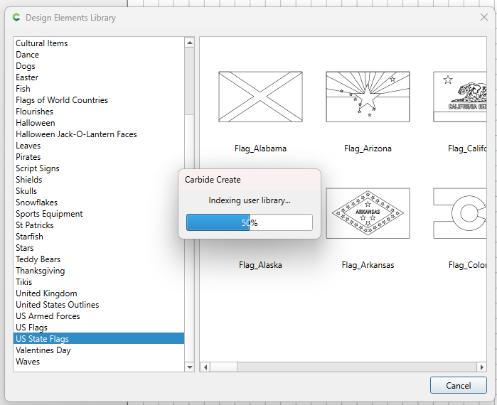

Stuck on indexing user library
When I go to Library → Show Library then it gets stuck on indexing user library. It goes to 50% then never progresses. While this screen is up I cannot do anything else in the program. I tried deleting my user local app data folder. I tried a full uninstall and reinstall and that still did not resolve it… I am on build 875 on Windows 11.

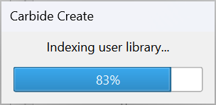

Mine locks up at 83%:

It stops at 50% for me, but pressing esc on my keyboard clears the progress bar and the library is available for use after that.
That does the trick! Thanks!!
