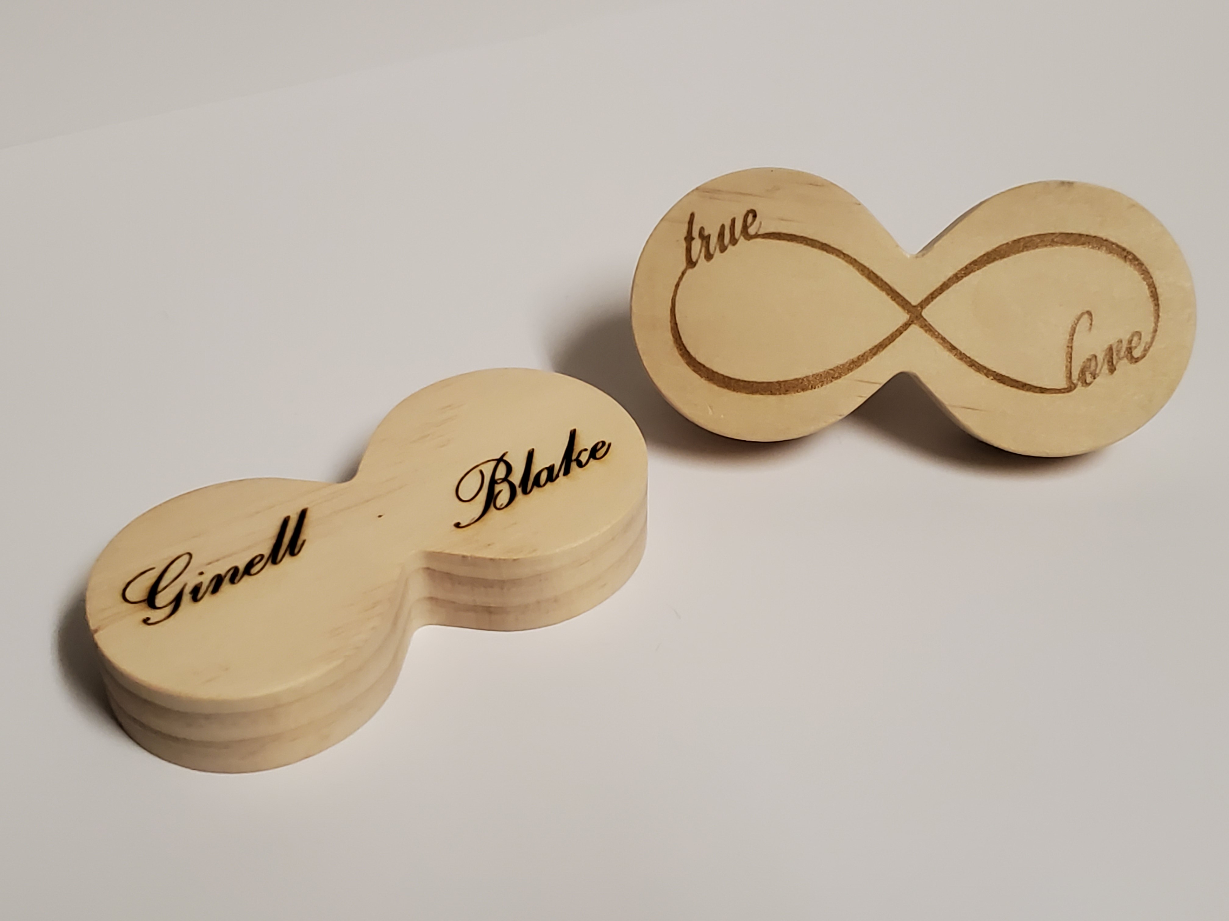

I would suggest making a test cut in a piece of scrap — that’s what I did to work up the dimension I used in: https://cutrocket.com/p/5c9fb998c0b69/ (which is only 2 in. in diameter).
Another option is to cut the bottom first, then cut the lid at a size you’re confident will be too small, test fit the bottom, then adjust the size for the lid and repeat until you get a good fit (or spoil the piece).

Here’s my first trial and error box … 100 plus of them for my daughter wedding.
And a jewelry box with no offset, just a bit of sanding for the perfect fit.
