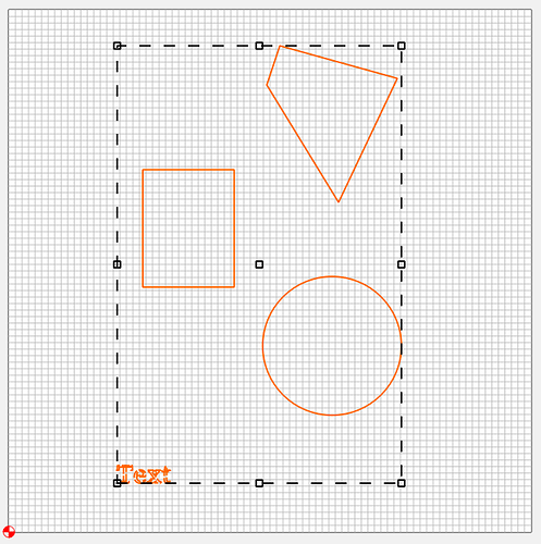

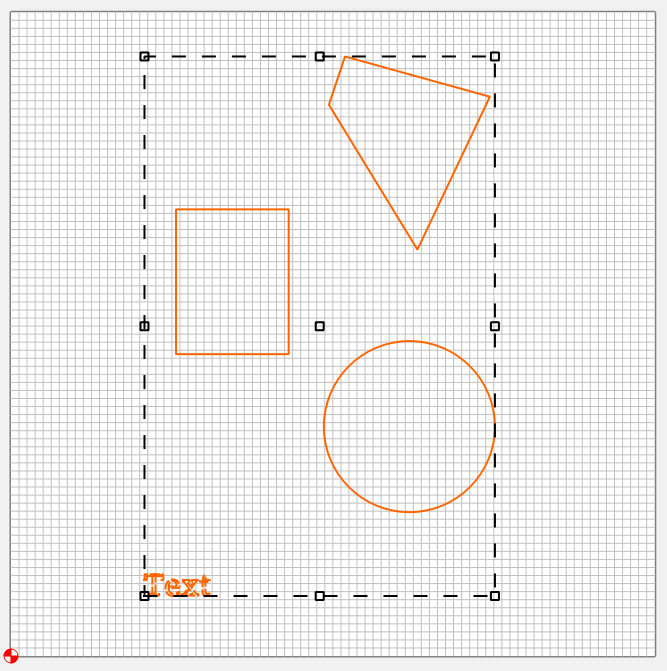

I like that function as well. Lightburn implements that one. You press Frame, and it moves around the rectangle that bounds THE CUTS of all of the objects. The Frame does NOT include items that won’t be cut. This is important, because you’re trying to make sure you’re going to be cutting in the right place on your piece.
So, for example, if you had these objects:
and the toolpaths were cutting all of them, the Frame rectangle would be:

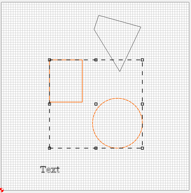

However, if the toolpaths only were created for the Square and Circle, the Frame would be:
