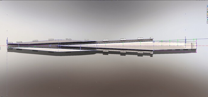

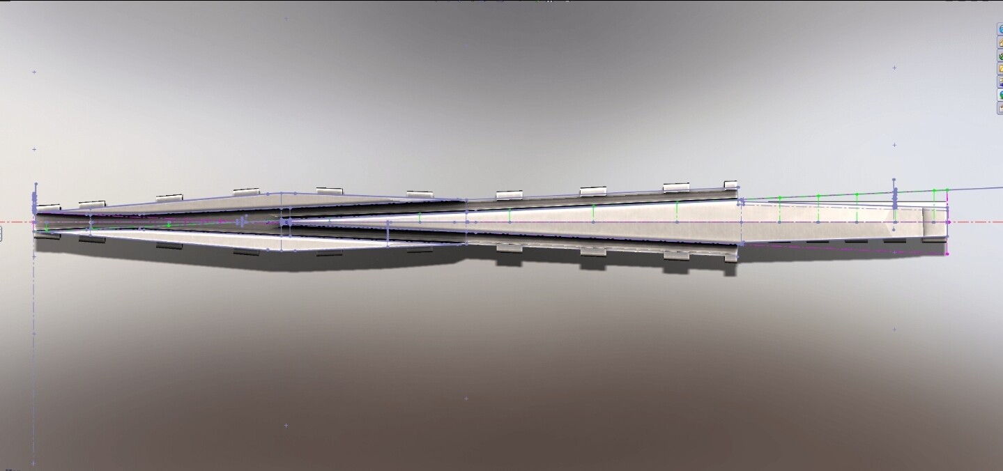

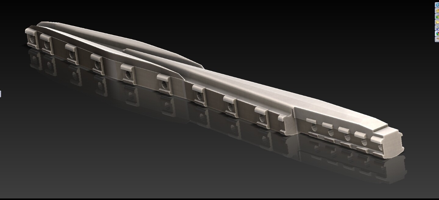

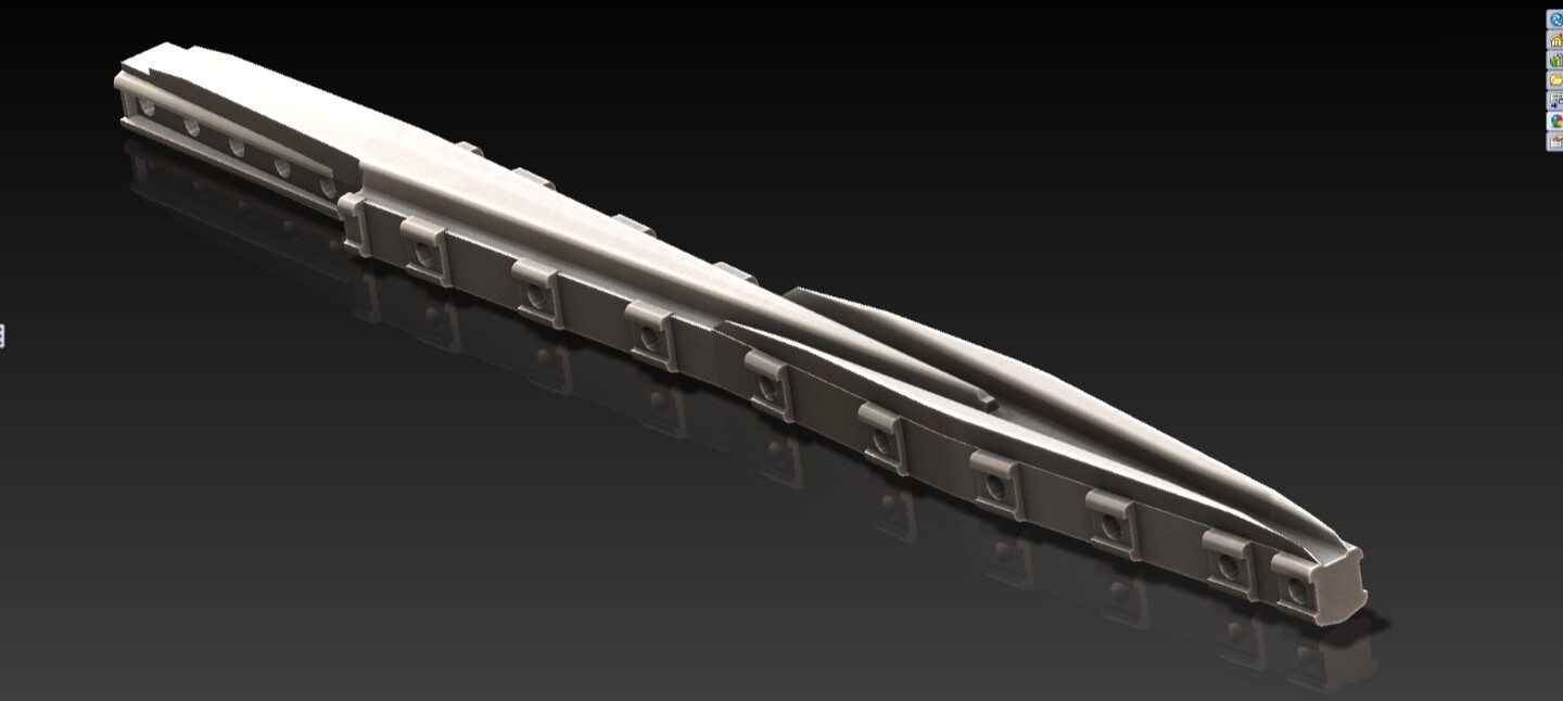

Oh wow. Yeah when I was in my twenties I got my first job doing cad work for a rail road parts supplier inputting old hand drawn drawings from the 1920s into solidworks. The parts were what’s called a frog insert. It’s this gigantic Manganese Steel casting that sits under the rails at points where the rails cross over each other. And after being cut on the cnc, it’s explosive hardened. Meaning they pack the top of it with plastique explosives and detonate it to compress the top of the steel lol
Anyway, that cnc was the size of a house. 20 years ago I was told the 6" cutter was $12,000. My first tool path I sent to the machine operator had my blood pressure sky high. Then watching that thing cut through a massive steel block like it was butter… I was hooked lol Those frog inserts come in several sizes, but the bigger ones are about 16’ long.
