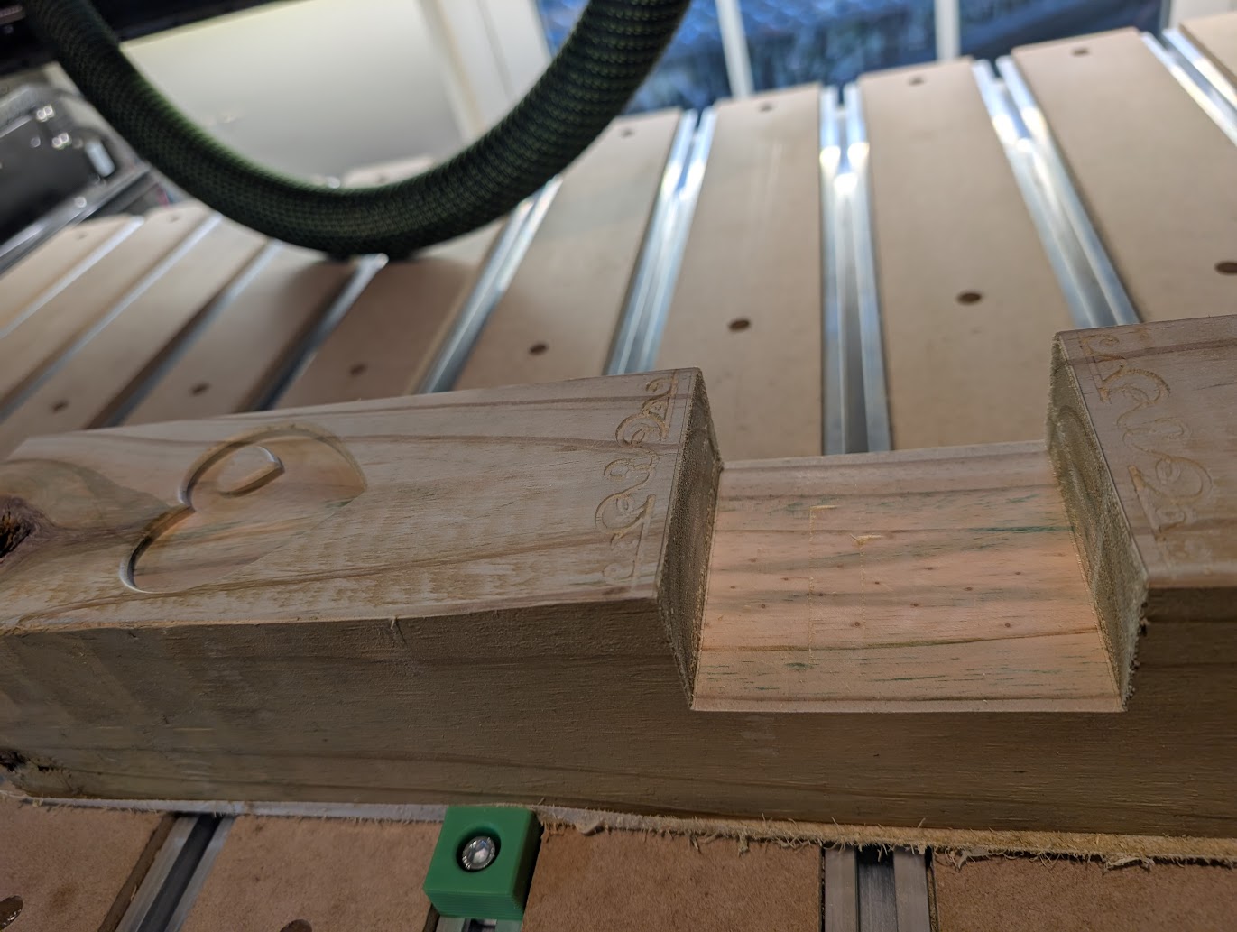

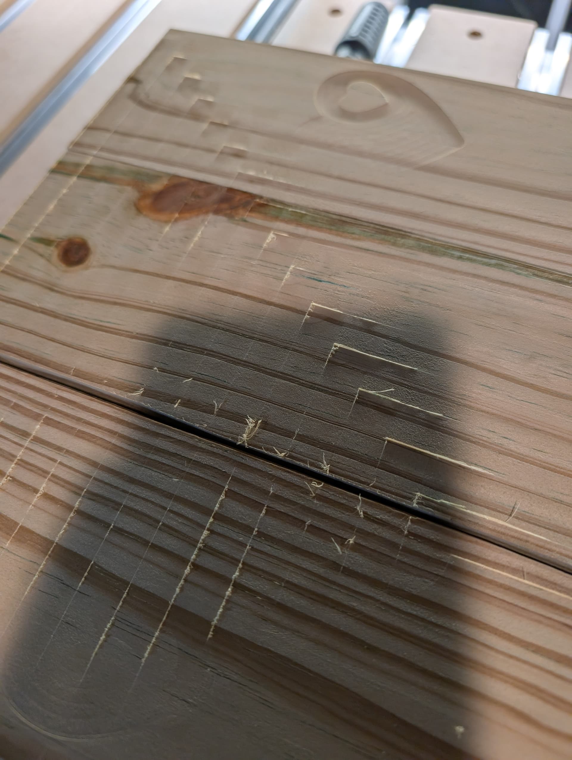

Hi all, tried searching community but not finding/connecting to what’s happening. Surfacing some treated 4x4s (making a small table for my daughter’s mice cage and trying to make them "pretty"ish). I’m using McFly and when it runs with the grain, it’s fine, but across the grain I get this trail effect (and on the cornering). Any suggestions would be appreciated, mv
Pic of trail

Pic of rough cut, what I’m doing (love that mcfly is able to cut so deep for the cross members)
Hey Mark, I had the same thing when I surfaced a round maple slab using a SpeTool surfacing bit. 80 grit on a palm sander smoothed it out. I don’t have pics but you can imagine how the square trail looked on round grain :slight_smile:
Looks like classic tram problem. Meaning your router/spindle is not square with the spoilboard.
Now that you mention that… I had to shim the slab to make it as level as possible before I cut it so even though I used a level on it it could have been slightly out
Looks like your machine may need to be trammed and your wasteboard surfaced.
It is good if your spoilboard is level but more importantly is that your spoilboard and your router/spindle be co-planar. The spoilboard and the router must be in the same plane. Using a level to make your material level with the earth is not necessary or desirable. Your material should lay flat against your spoilboard. There is nothing wrong with shimming a rough cut piece of lumber that has twist or cups so you can level it one side, then flip it over with the freshly cut side flat against the spoilboard and then flattening the second side to make the two sides co-planar. Straight boards should not be shimmed to bring them level with the spoilboard.
There are many posts here on the forum about how to tram your router to the spoilboard.
Here is one of many. Just search for hot to tram and SO5 here on the forum.
To get the spoilboard and router/spindle co-planar you adjust the router/spindle front to back and/or side to side. That will get your bit in the same plane as your spoilboard. If the imaginary line is several degrees out of the same plane as the spoilboard you get the steps you had in your picture.

I didn’t explain it very well :frowning: … I shimmed to flatten one side then flipped it and flattened the other side without needing to shim again. :slight_smile:
