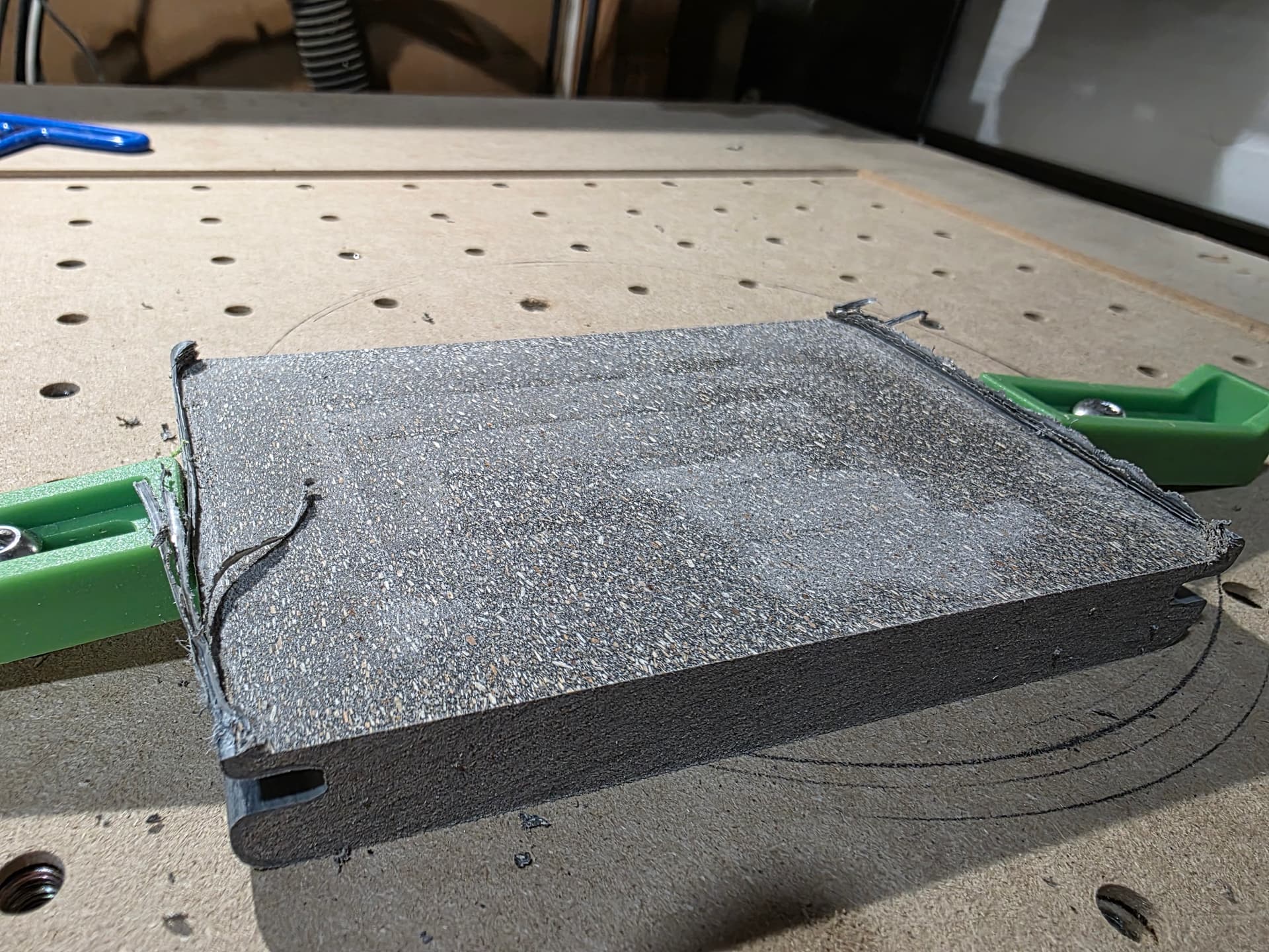

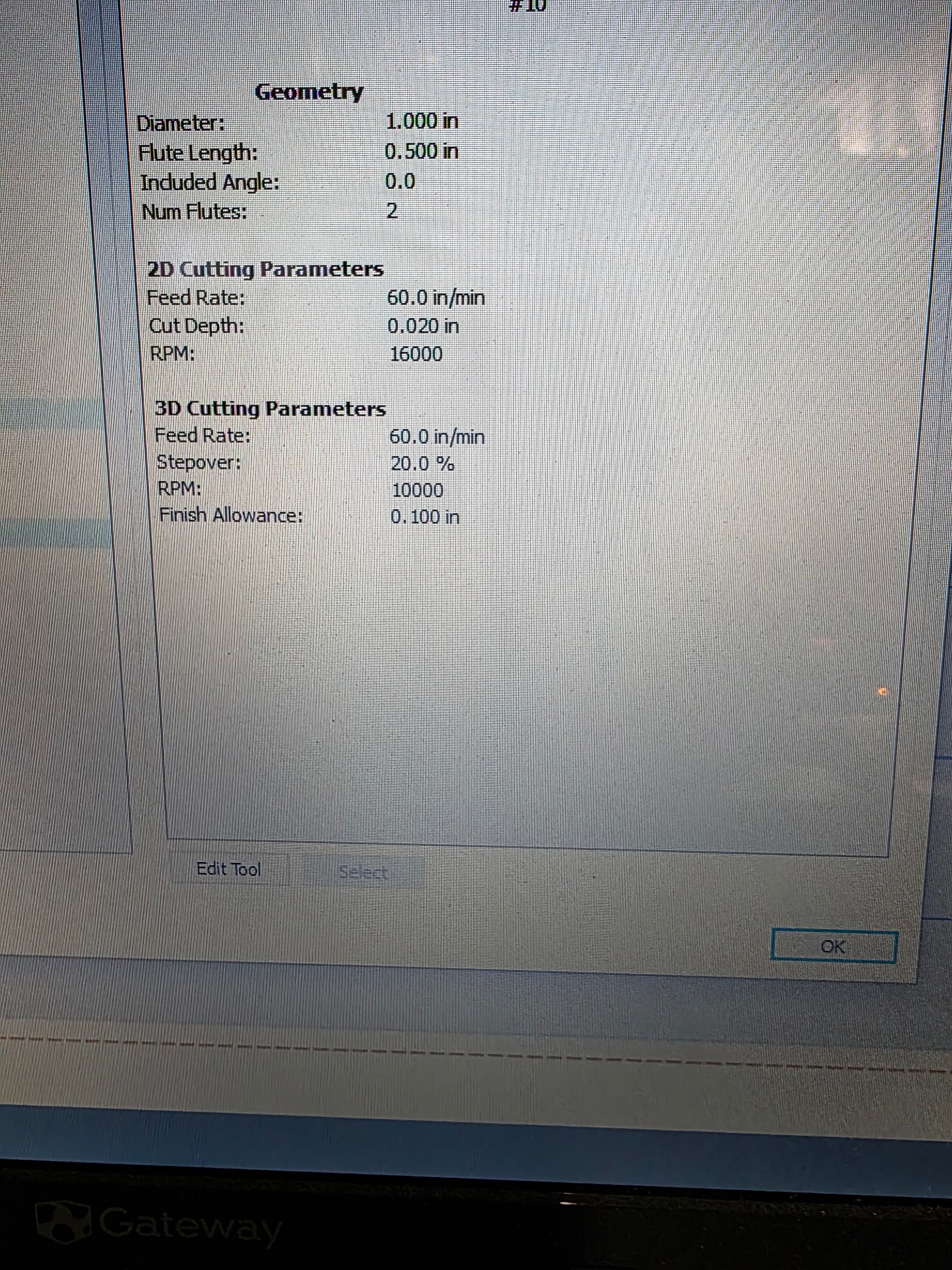

I’m trying to surface a piece of wood plastic composite (WPC). I get these lines and wonder what to do to get rid of them aside from sanding. I’m using a 1" 4 blade surfacing bit and I have the bit set as
And here is what I get
I thought a surfacing bit was supposed to alleviate that. Suggestions?

What is the step over set at? Looks like your stepping over the full one inch diameter of the bit cutting surface.

The stepover was set at 20%. I changed it to 5% to see what happens and it looks like it made no difference.

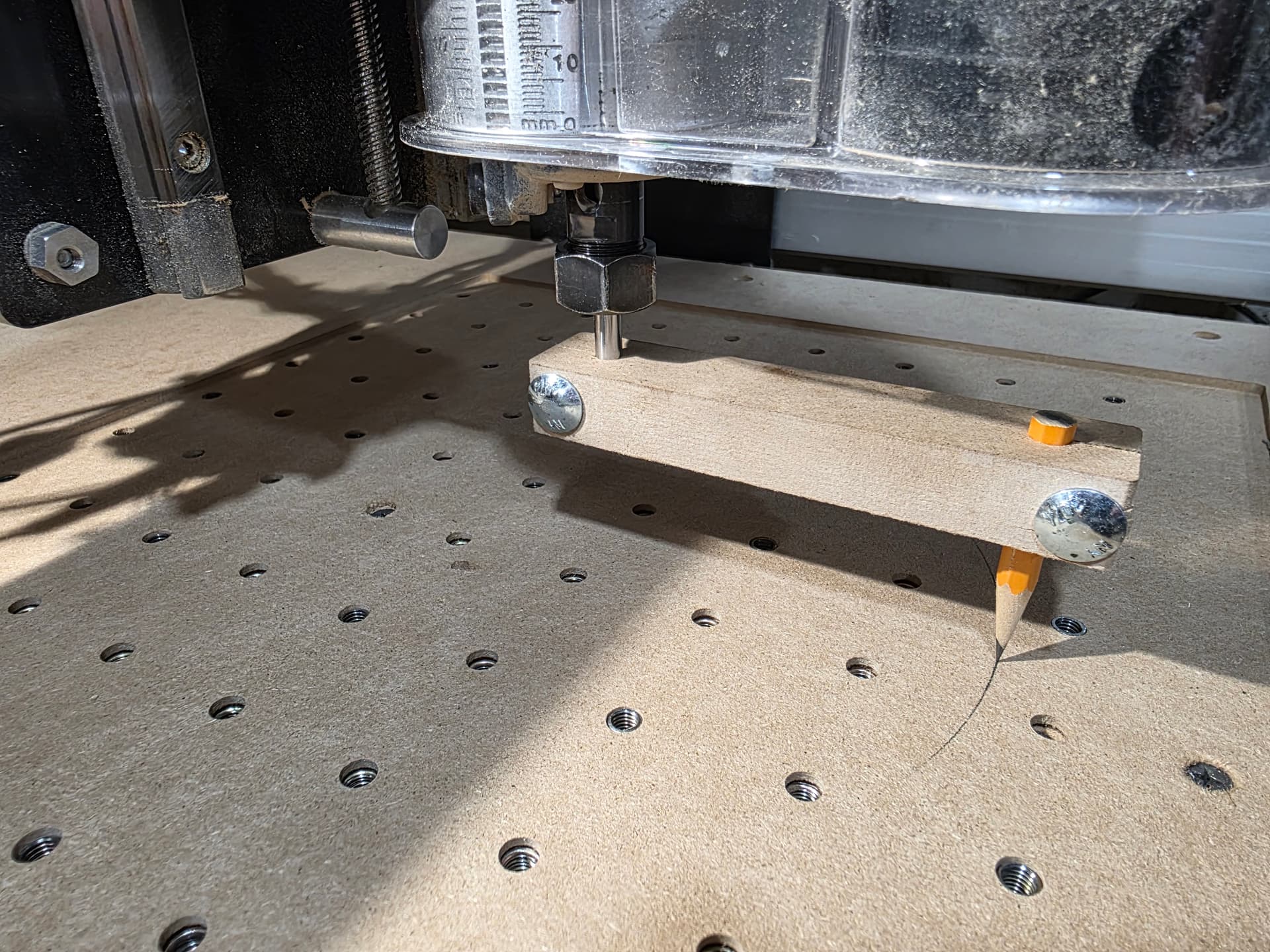

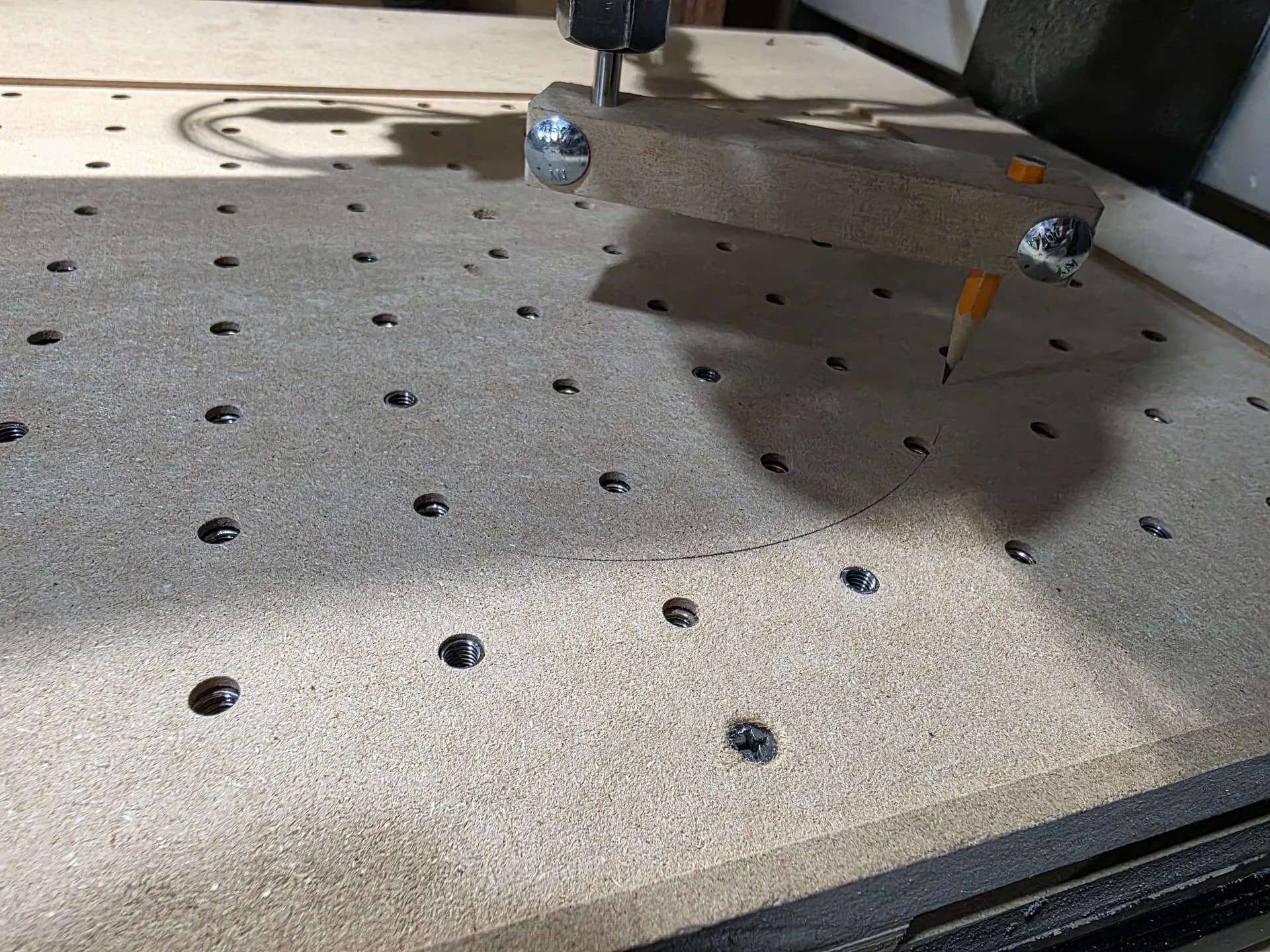

I resurfaced my waste board and then I made a tramming fixture. I can see the issue.
Now I need to figure out how to tilt it back. Any suggestions?
A lot of folks, me included loosen the screws on the Z plate and insert shims top or bottom to get the proper tilt.
Did you watch the Youtube video which @Jeffish linked above?
I loosened 3 of the 4 screws on each end of the X axis bar and tried to bias it back while tightening the screws and it helped some but it apoears to be off about .75mm difference between the back and front.
I never tried that approach, it looked like a pain to get it adjusted that way. The method I mentioned above is much easier. Get a feeler gauge, find the proper size/combo of sizes to get wha you need, tighten it down and then snap off the gauge.

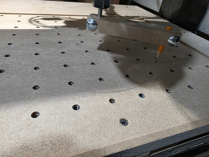

I loosened the 4 screws holding the router and placed some aluminum foil under the right spot. I’m now within .05mm of being true all the way around. I’ll see how that plays out.

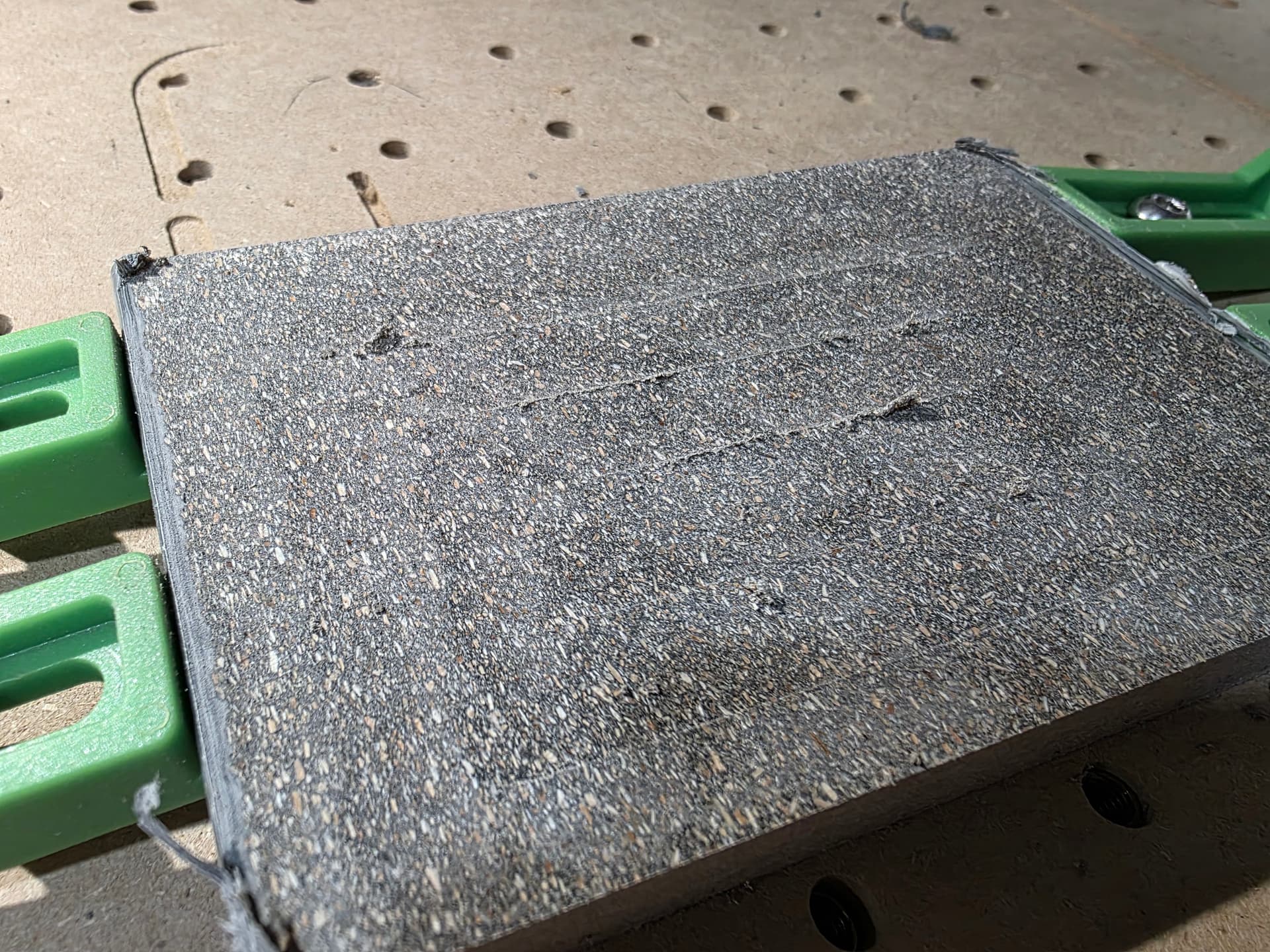

Here’s the results
Looks so much better. Thanks everyone for your help. I learn something new every day.
