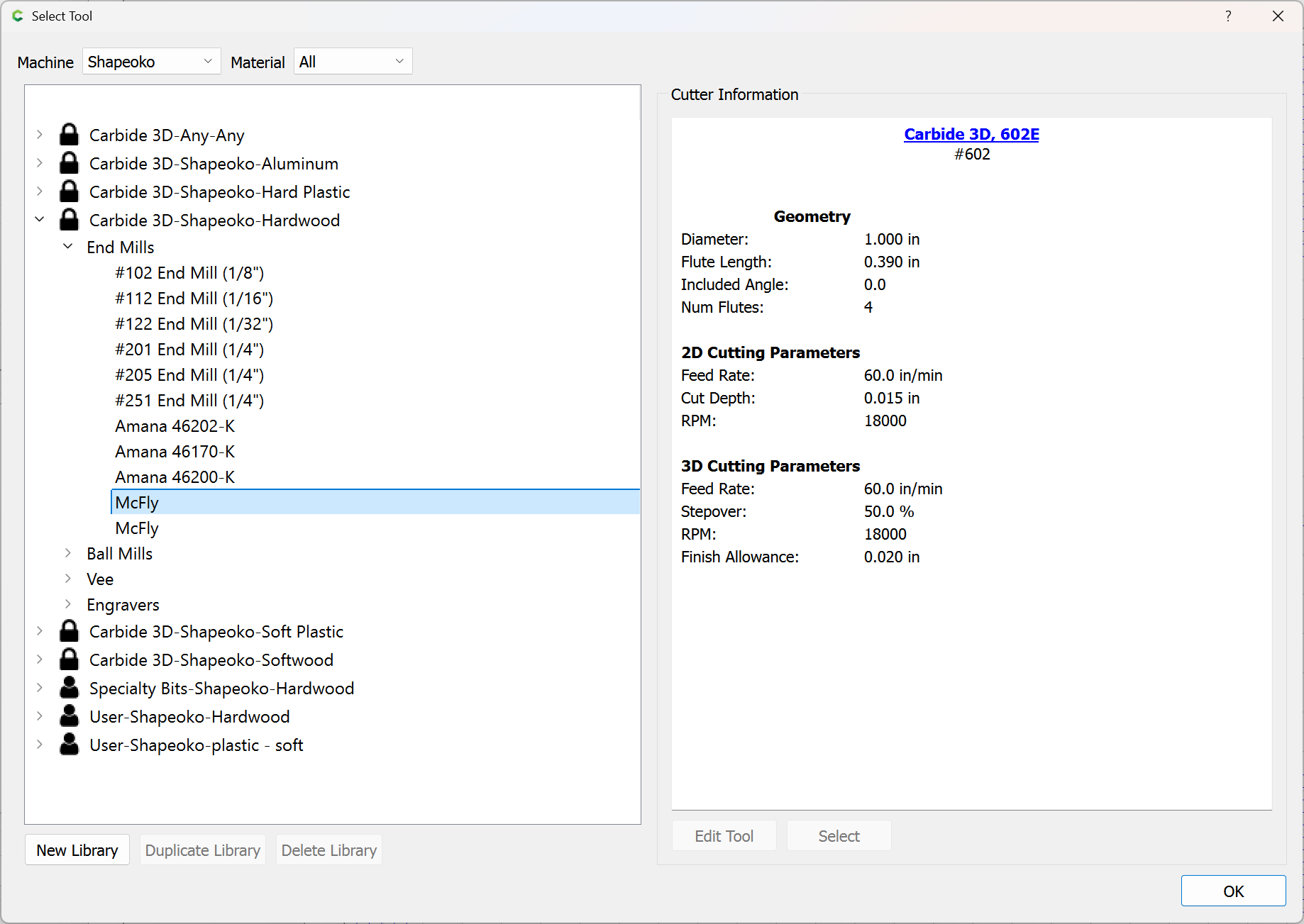

We have the very similar McFly in our library as:

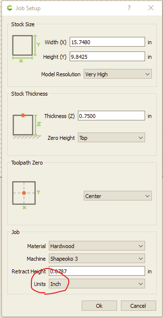

  • Make sure your project measurement setting is set to inches (because of a bug)
  • menu Edit / Show Tool Database
  • Pick your material
  • If you don’t already have a User library for that material, do “New Library” and make sure it’s for that material
  • Right click on the library, then New Tool / Endmill / Inch
  • Start filling the info for your tool in.

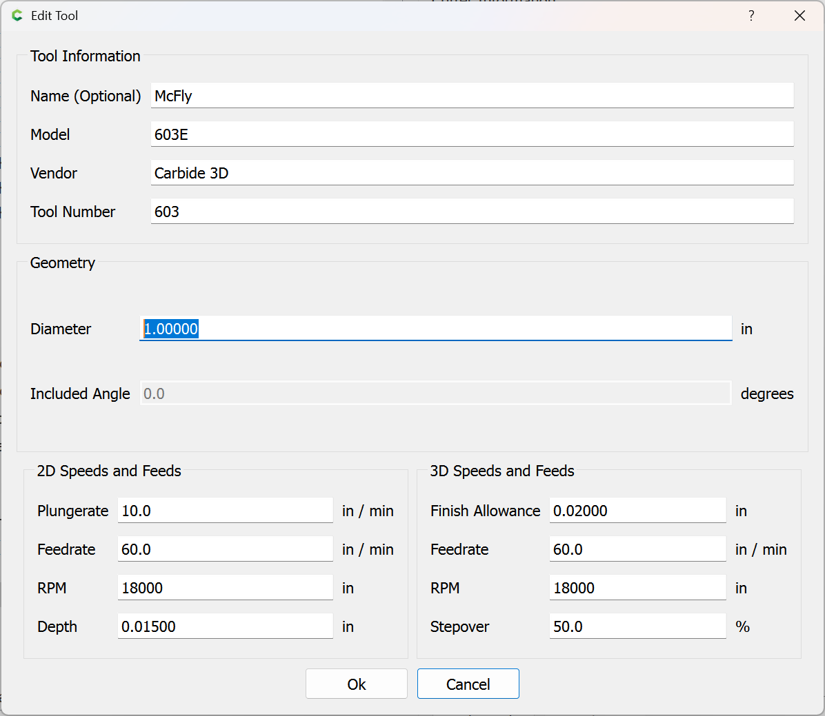

Do you know how I would add the cutting diameter of my flatting router bit? The cutting diameter is 2 inches.

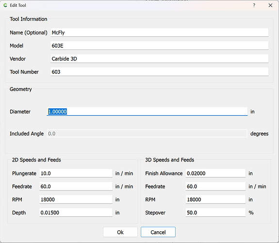

Is the diameter under ‘Geometry’ where I would add the diameter of the endmill?
The McFly has a cutting diameter of 1":
