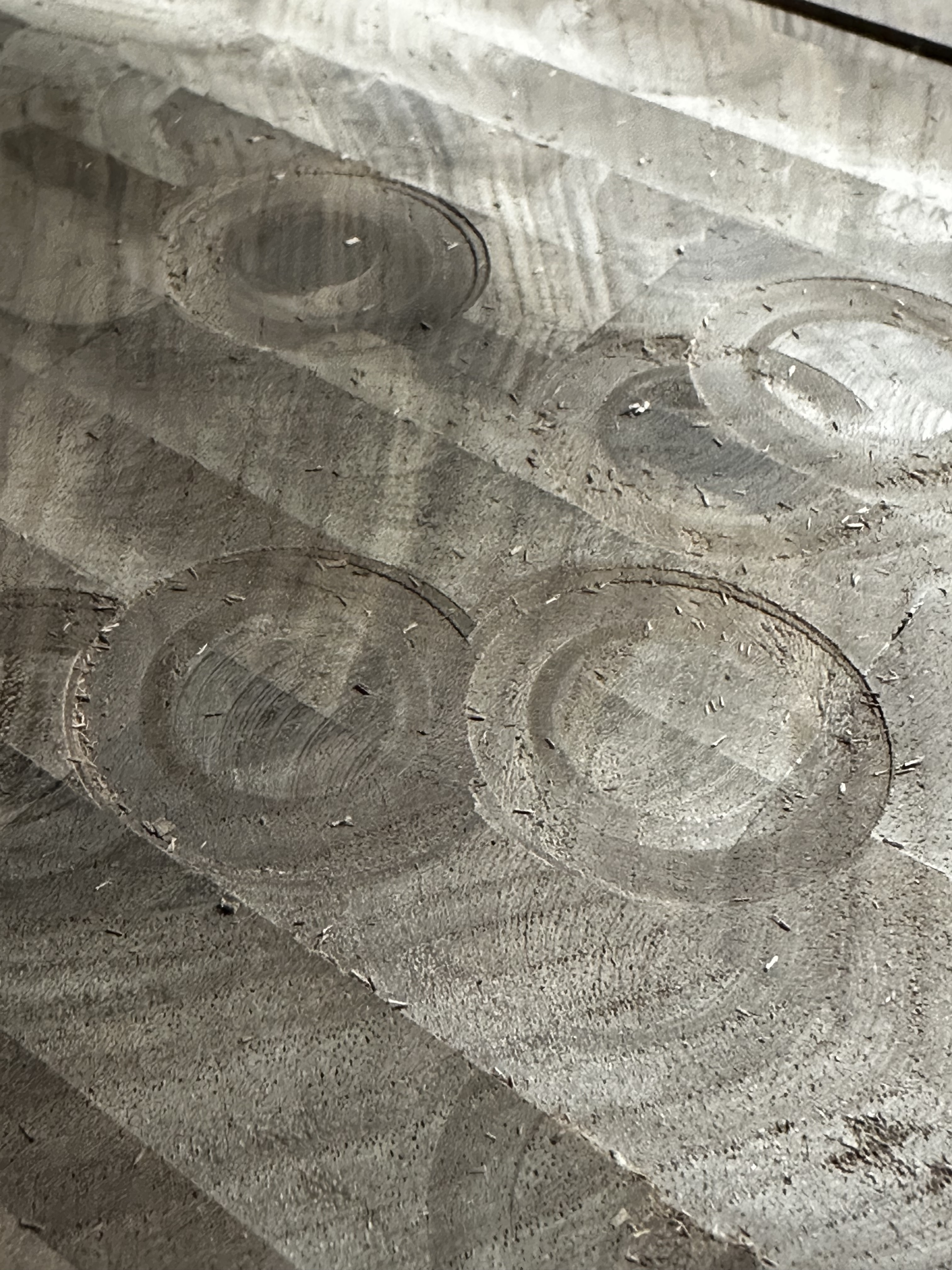

Surfacing walnut end grain. Bit is diving into workpiece
Anyone know what’s going on here? I’m trying to surface some end grain cutting boards but I’m having an issue with the bit jolting and creating divots in the work piece. I have been surfacing a lot and was not previously having this issue, and then all of sudden it started.
I have had similar results with walnut and maple end grain boards. I’ve been playing around with depth of cuts from around 5mil to 20mil and feed rate from around 60ipm to 120ipm. I also rotated all the inserts on my surfacing cutter (2+2 cutter ~1.3" diameter). Lastly, and most extremely, I upgraded my Z carriage from the stock Shapeoko 3 to the HDZ, same result before and after (I had it sitting around in the box, been meaning to upgrade anyways and thought that was going to solve my problem).
Any clues or troubleshooting tips would be great!

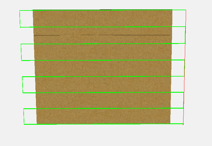

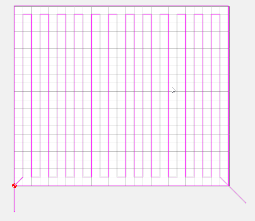

The tool paths in those instances are straight, but you’re observing a slight stall out in place, is that correct? Are there any suggestions that steps have been lost after those gouges?
What does your surfacing file look like, pocket cutting or contour?

My tool path looks more like the second image, and despite hearing an audible jolt, there is no stall in x or y motion and no discernible change in z height. Im definitely suspicious of the collet. Fingers crossed that fixes it!
Okay, been playing around for a bit and unfortunately I have made no progress.
I really thought it had to have been the collet…but I tried a new collet as well as another router I had laying around after discovering the slightest whisper of bearing play in the router I had installed. I also tried adjusting my tool path to make a a lap around the outside of the material first, to mitigate blowout around the perimeter:
Lastly I made sure to really stick my workpiece down well.
Unfortunately, I am still getting these strange jolts/formations and blowout. All the v wheels in the Z and X carriages are tight with no play.
Anything else anyone can think to try? I only have one surfacing bit otherwise I would have tried swapping that out by now as well.

Im super stoked to report the problem is solved!!
Thank you all for the thoughtful responses, of course while I was chasing down all of these machine issues swapping out routers and Zs, it turned out to be the tool I was using!
@jtclose nailed it, pulled the bottom cutters out and it cleaned right up. Seems obvious in hindsight, those bottom cutters must have just been pulling the workpiece up (maybe even flexing the Z/gantry). Seems those inserts are more suitable for soft material like MDF.
Thanks again! Learned a lot these last few days! Thats what its all about
