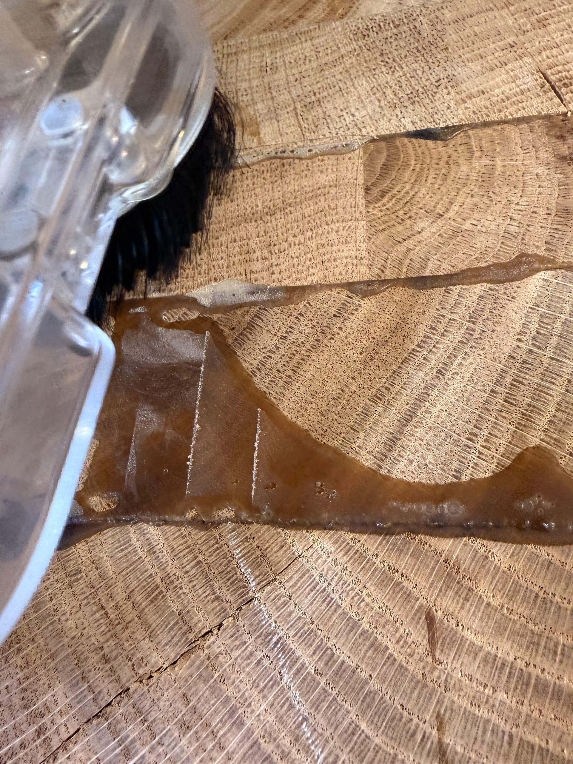

The question is which bolts to loosen to fine tune the trimmer.
Here is the issue, shown clearer on the glue. Also I notice the trimmer is making a strained noise when moving right and not left. The surfacing but is very slightly “leaning back” when going right.

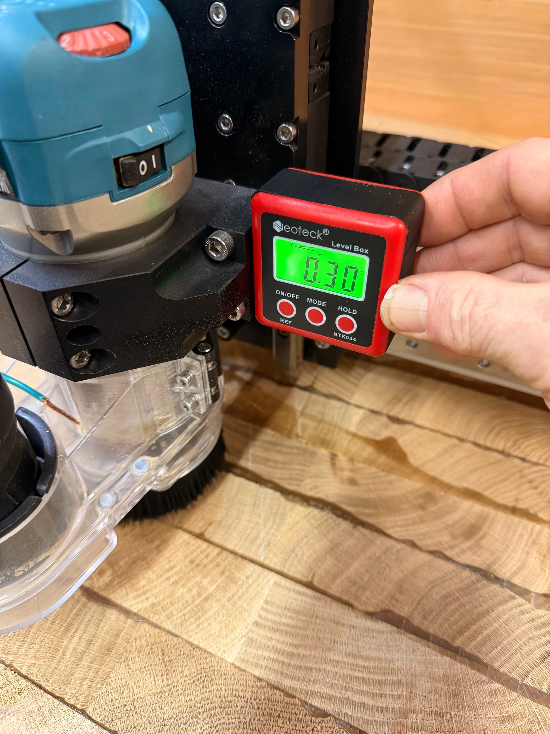

I see that the angles differ between the z-axis and the mount by 0.1 degrees:
Would 0.1 degrees be enough to generate those very slight lines and noise? If so, is it a case of undoing and retightening the 4 bolts that hold the mount onto the gantry?
I am going to answer my own question here which is, yes that fixed it. There as no noticeable movement, more of a squeeze turn and then retighten.
Did you zero the gage off the Z mount first? Normally to check the delta between surfaces you zero off one then check the other.
0.30 - 0.18 = 0.12 deg.

Interesting use of a digital angle gauge. You’re assuming, of course, that the router mount’s opening is parallel to the outside edges. Which, as you found it, is the case although I suspect that’s not one of the tolerance’d fit specification.
I’d also caution on the digital angle gauges that for actually measuring angles, most of them have a specification of +/-0.2º, which is a lot, with the “good ones” coming in at +/-0.1º, but only at near vertical or near horizontal (such as this Klein: Digital Angle Gauge and Level - 935DAG | Klein Tools ) This one is a bit more accurate: Dual Axis Digital Angle Protractor, Digital Level Angle Gauge GYRO + Gravity 2 in 1, Digital LCD Protractor Inclinometer Dual Axis Level Box 0.01°Resolution, Angle Finder with Five Face Magnetic Base: Amazon.com: Tools & Home Improvement
However, for checking that two angles close to vertical or horizontal are the same, they’re well suited. As in, repeatable measurements are usually repeatable, but the actual angle specified may not be just what the display shows.
Anyway, thanks for posting, as I hadn’t thought to try measuring that way.
