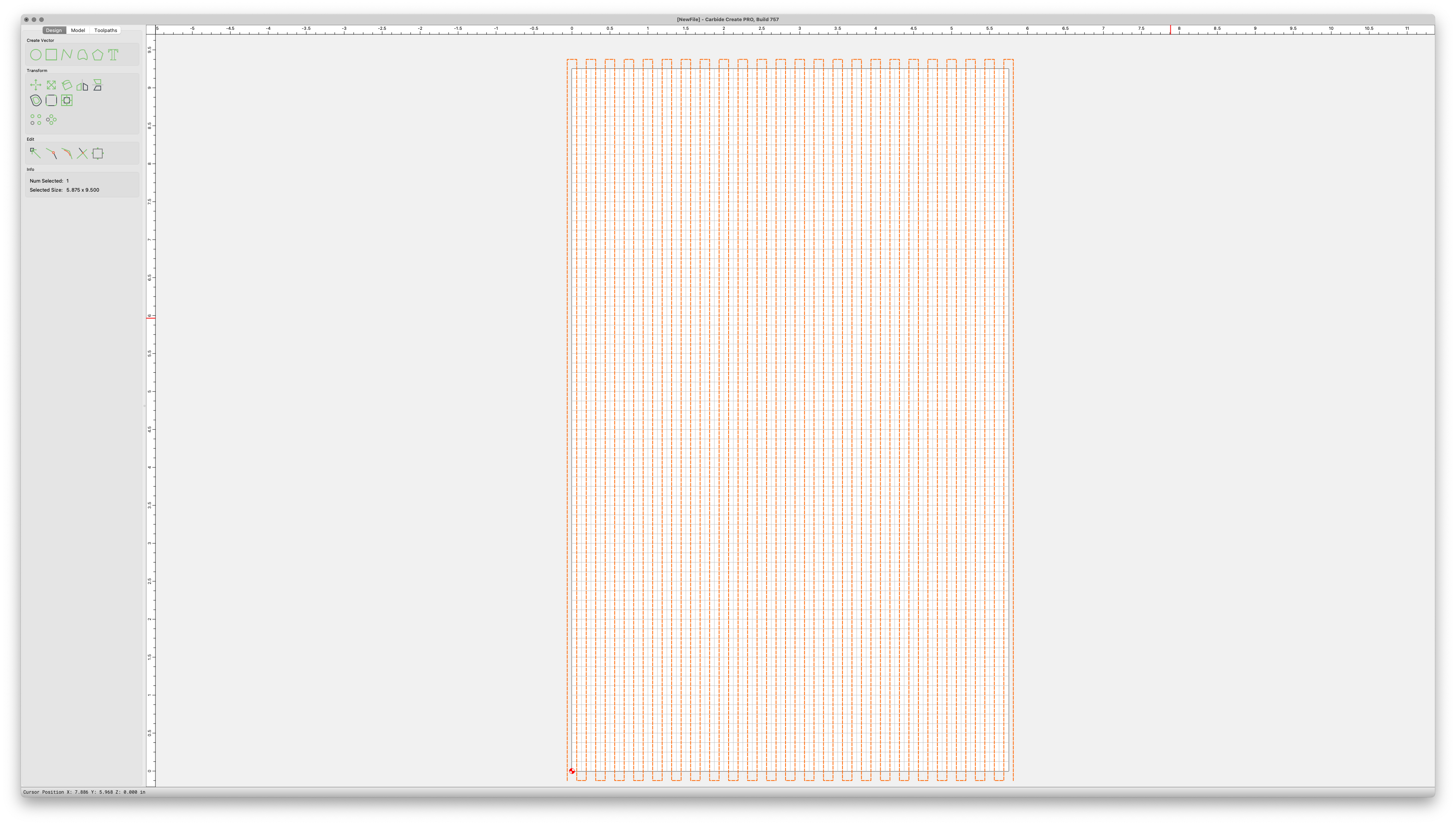

Surfacing with Texture feature
I want to surface a cutting board so it is flat smooth. I don’t want the spiral pattern of the Pocket. Is it possible with Texture?

A texture toolpath will take a long time and a lot of passes to make something even.
My recommendation would be to just draw the toolpath you want:
