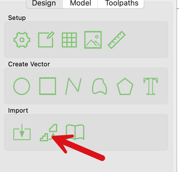

Create can load and trace an image:
Unless you have a good reason to use another program, use Create natively. We see a lot of incredibly bad SVG files in support from online file converters.

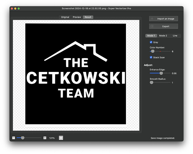

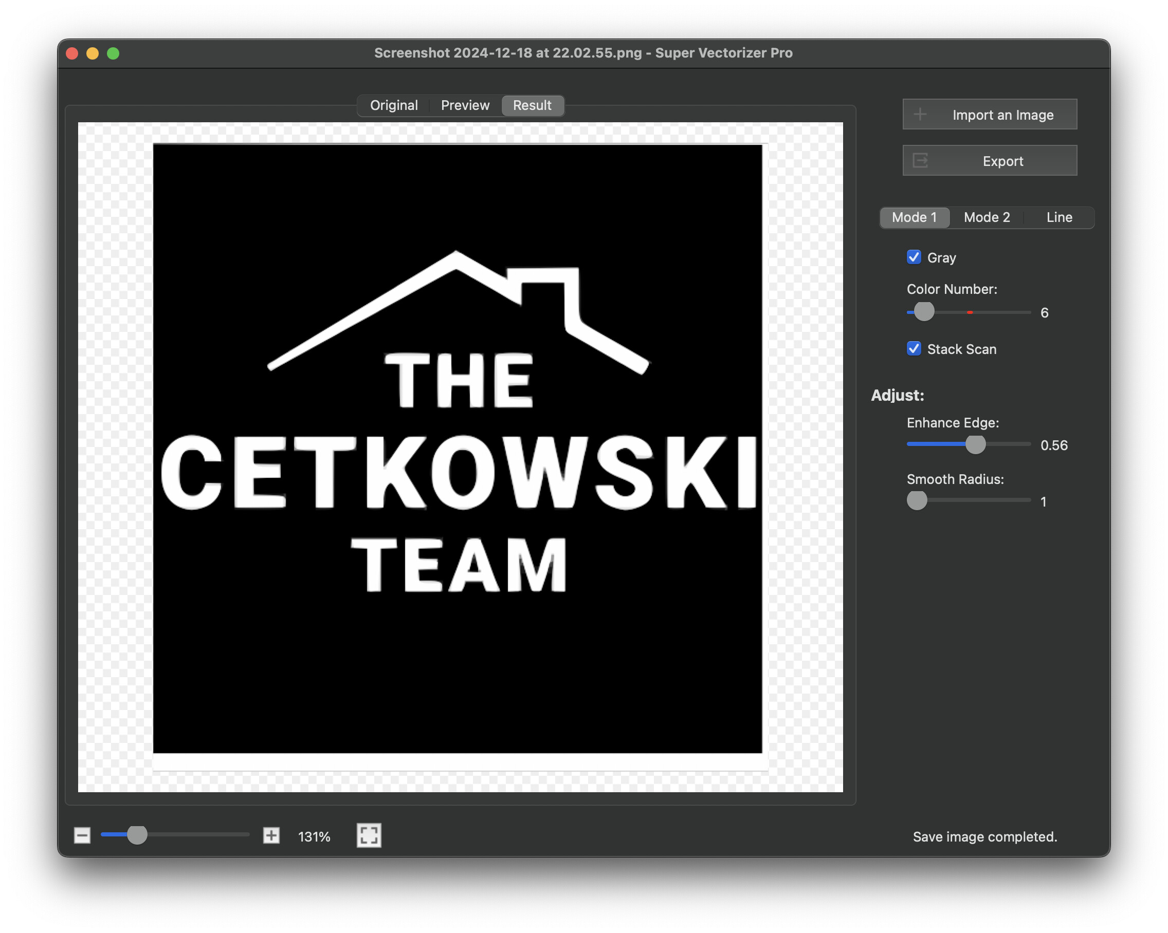

I screen-grabbed your small example image and converted it in SV Pro. Here is the SV Pro window showing the grabbed screen (.png file at nearly 80mm square.)
The resulting .svg file was ok given that all I did was pass it through the software without any work.

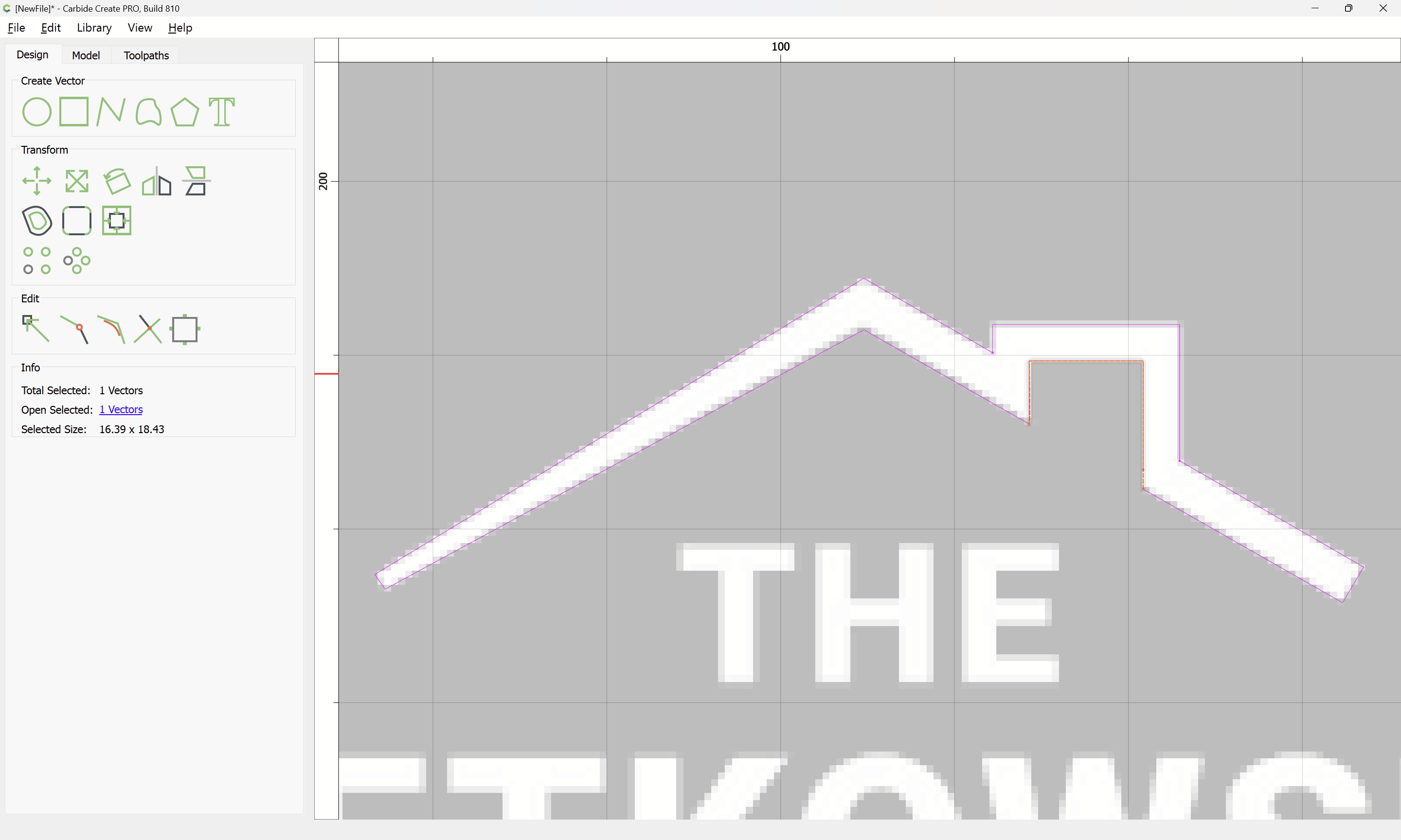

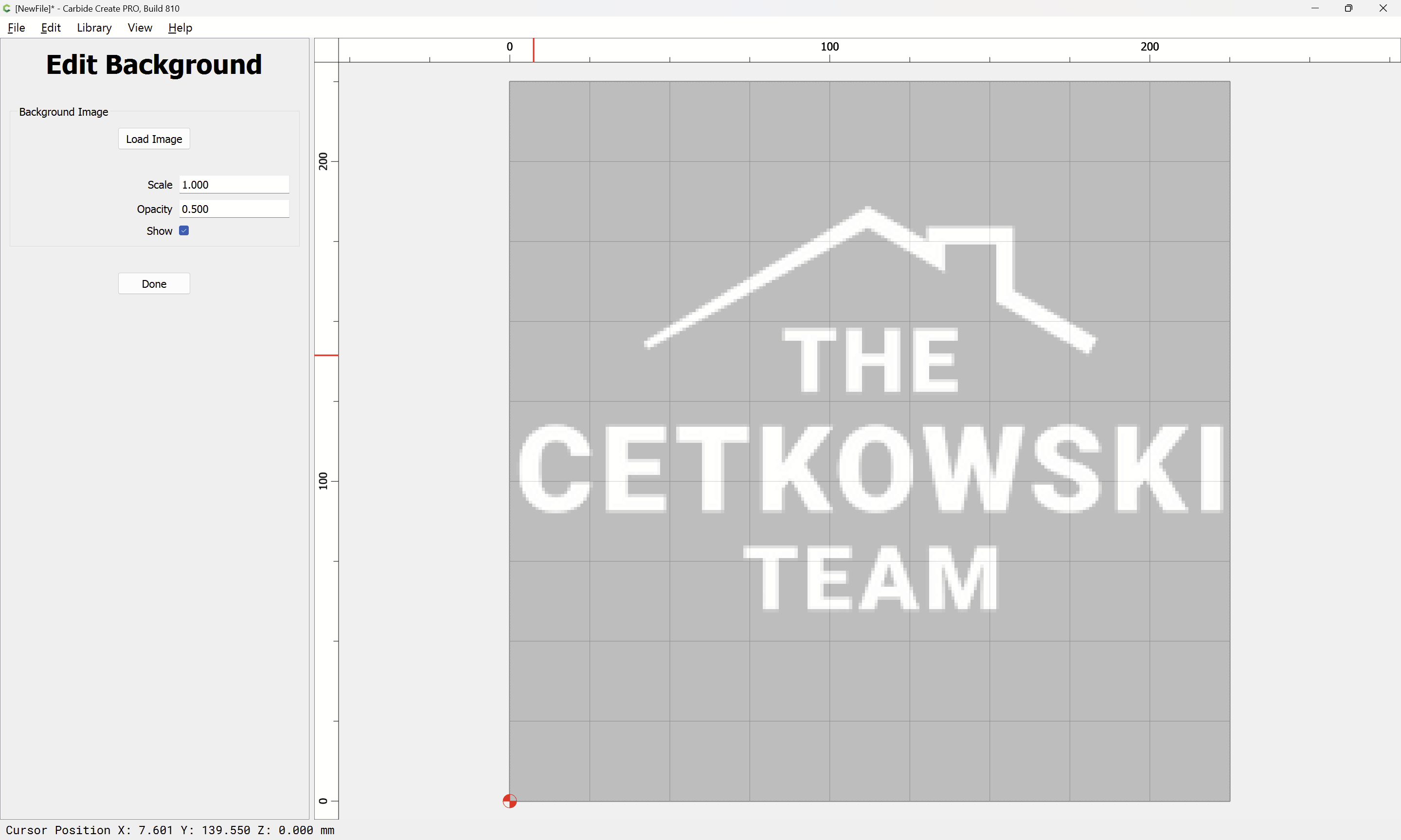

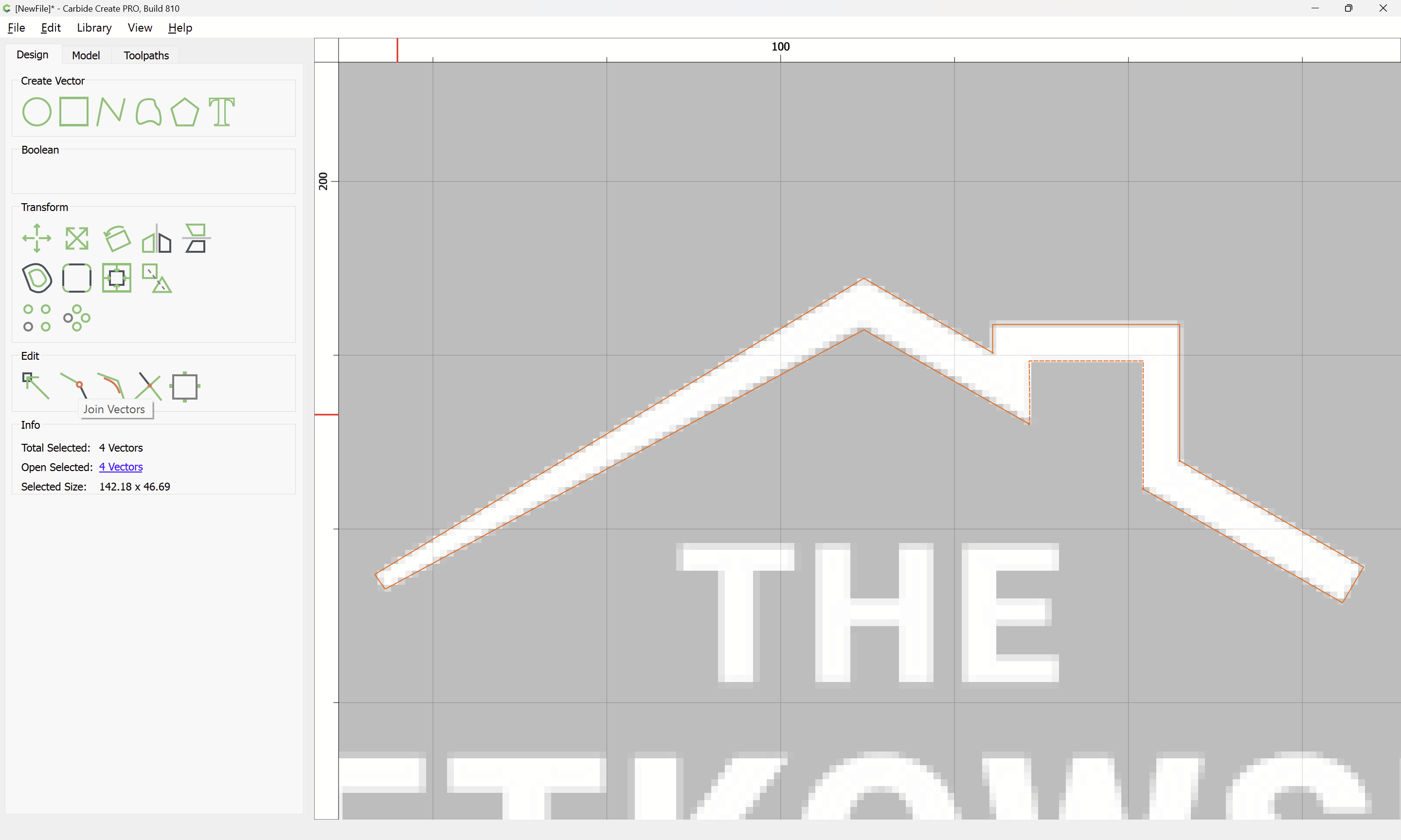

The file imports onto the background for reference:
and as noted, the roof is easily re-drawn using the polyline tool and a couple of rectangles:

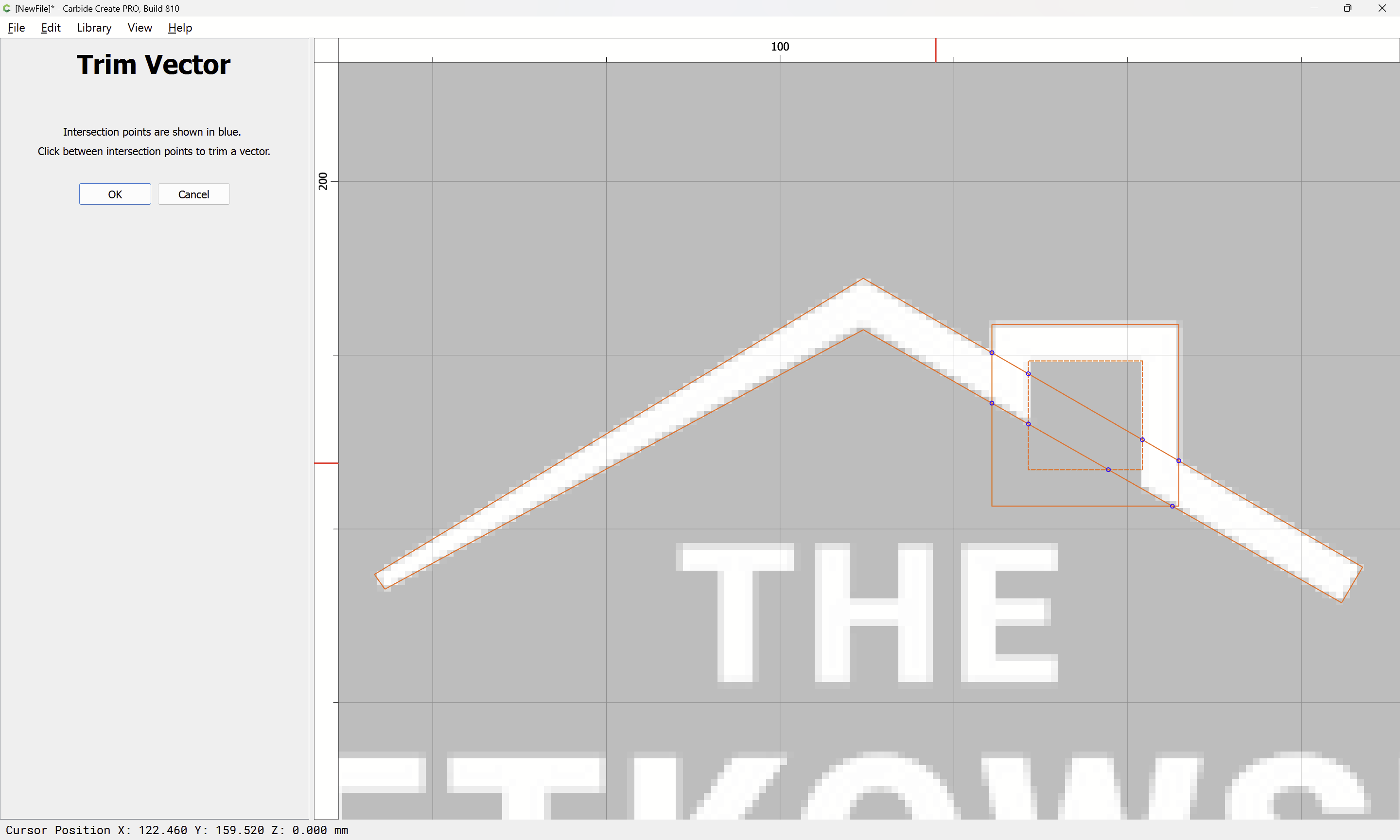

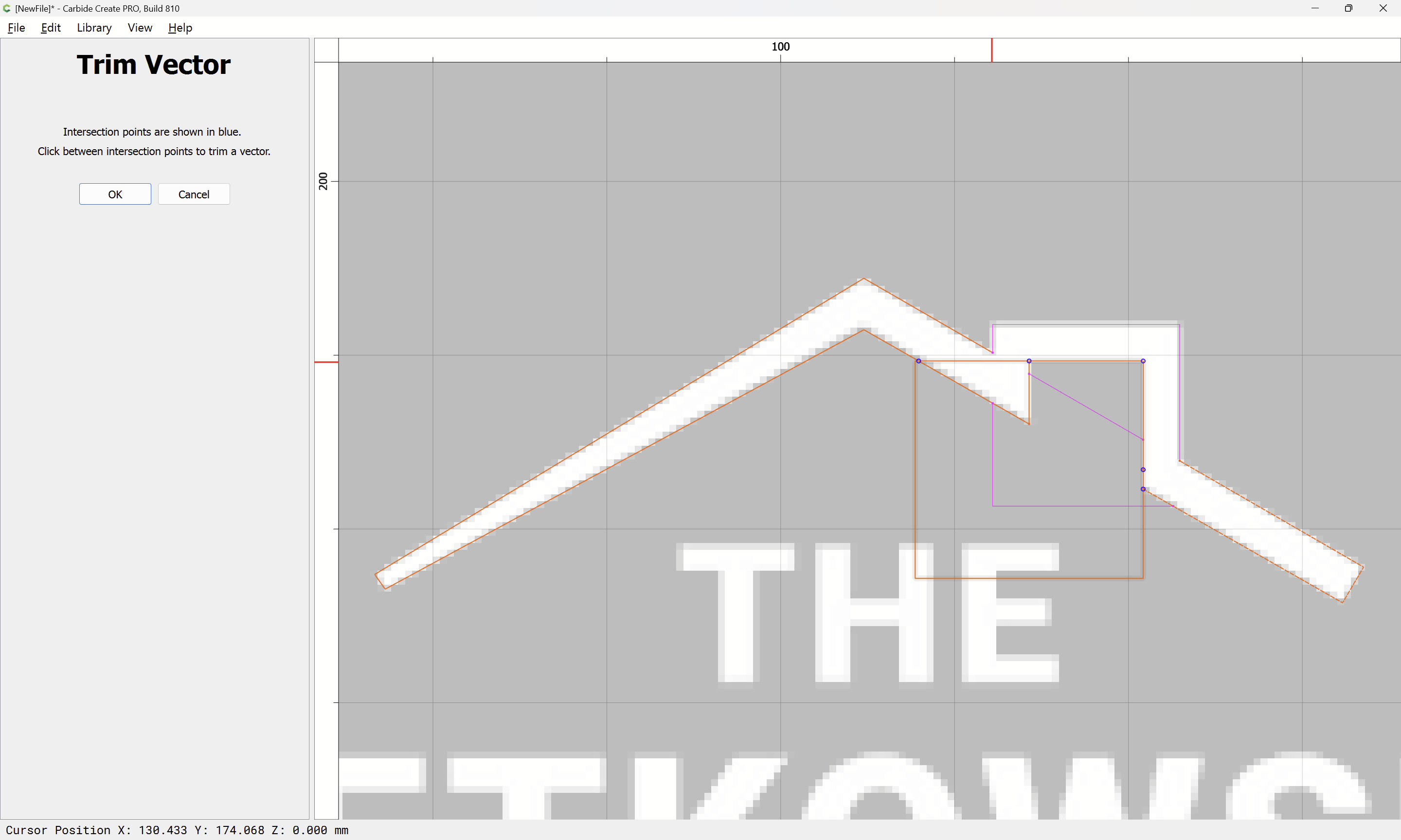

and then finish up using the Trim Vectors:
if need be, draw in additional geometry to finish:
OK

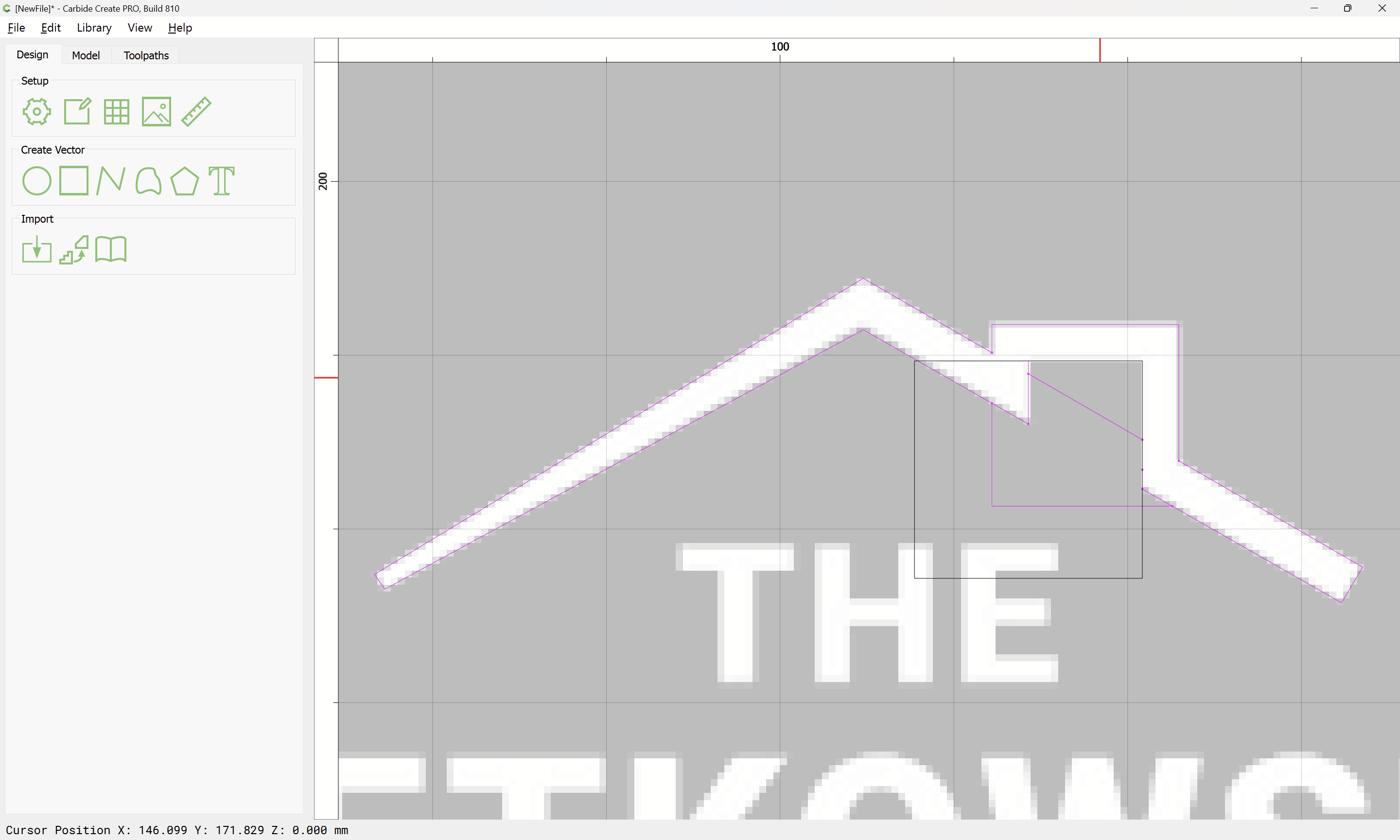

Then delete what is not needed:

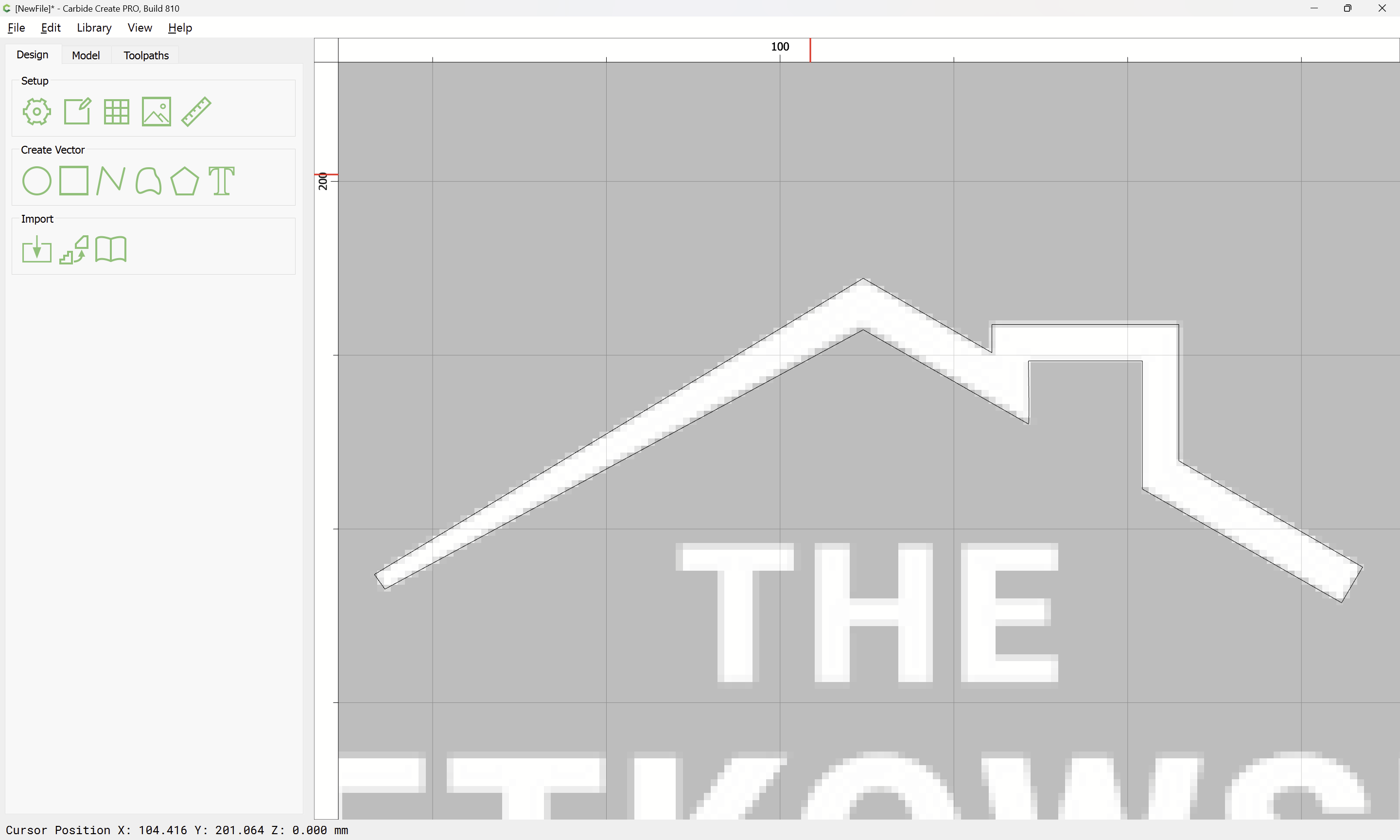

and if need be, close the gap by drawing things in:
and then use Join Vectors to close:

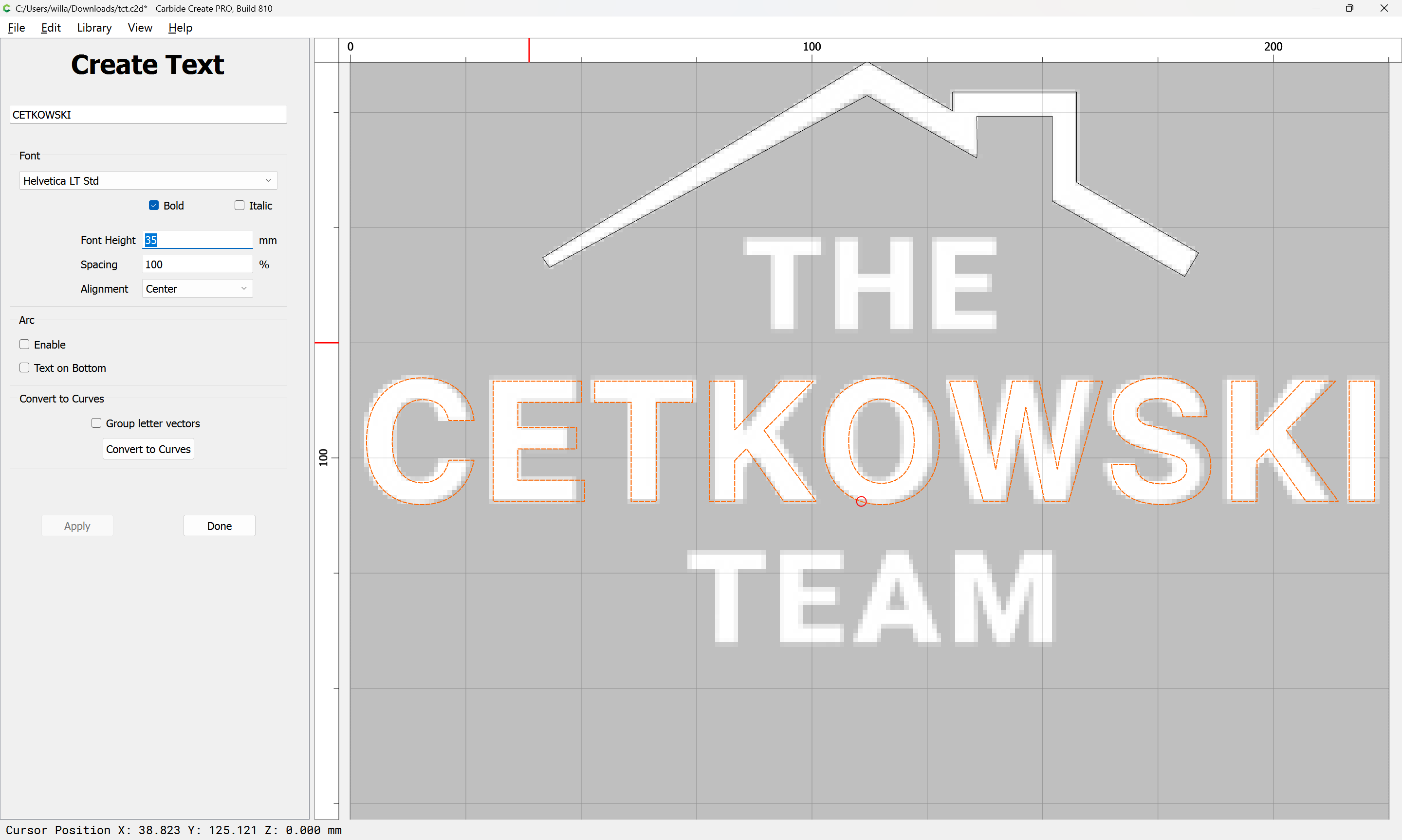

The font is Helvetica Bold:
so the text is easily reset.

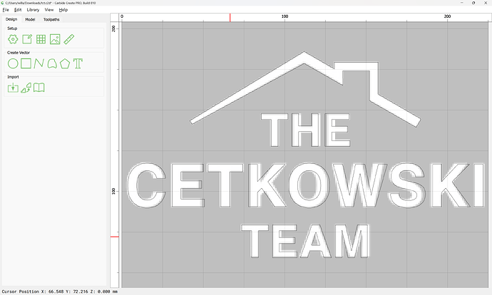

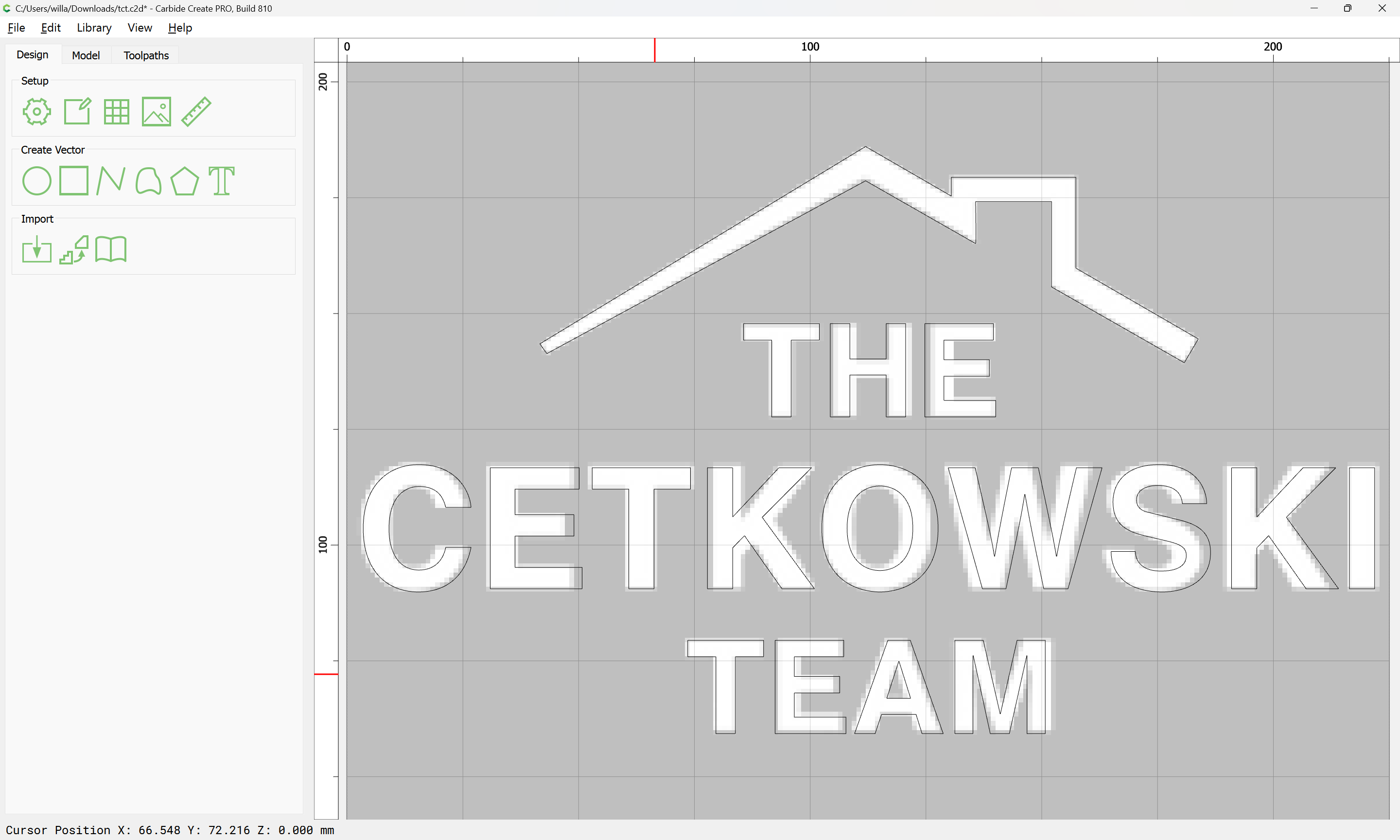

Attached as a v8 file with the text converted to paths.
