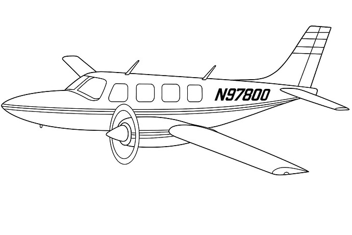

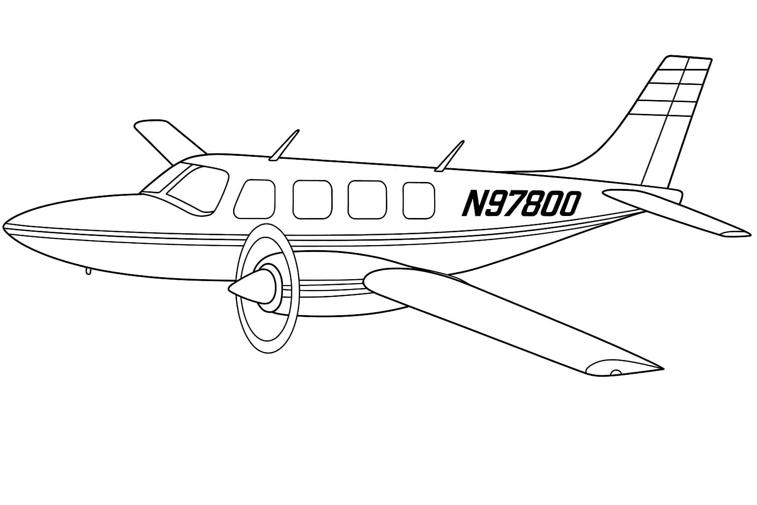

I bought this Aerostar SVG it’s too busy, I need to thin it out and just keep the outline maybe with a little detail. When I am cutting with a 0 flute upcut 1/8 bit it all kind of merges together and looks like crap.
Aerostar100

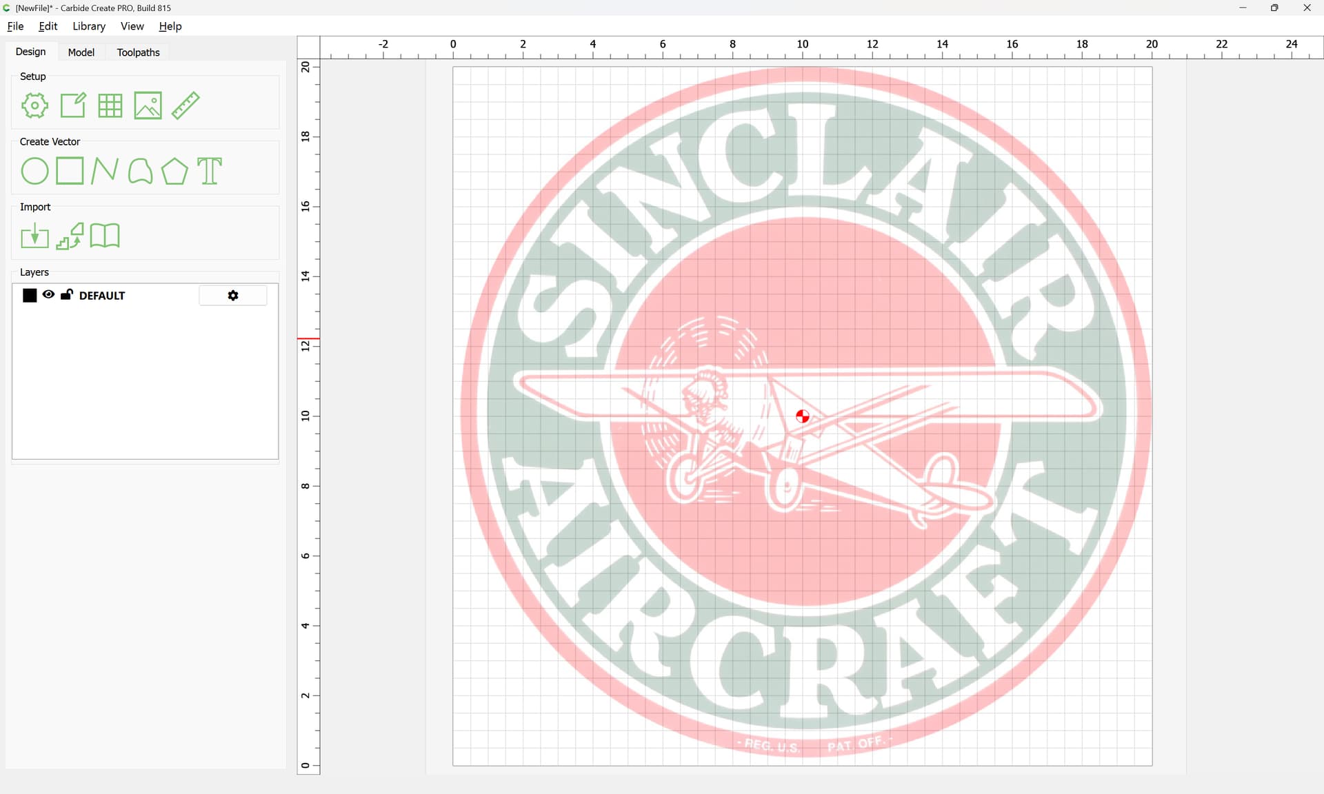

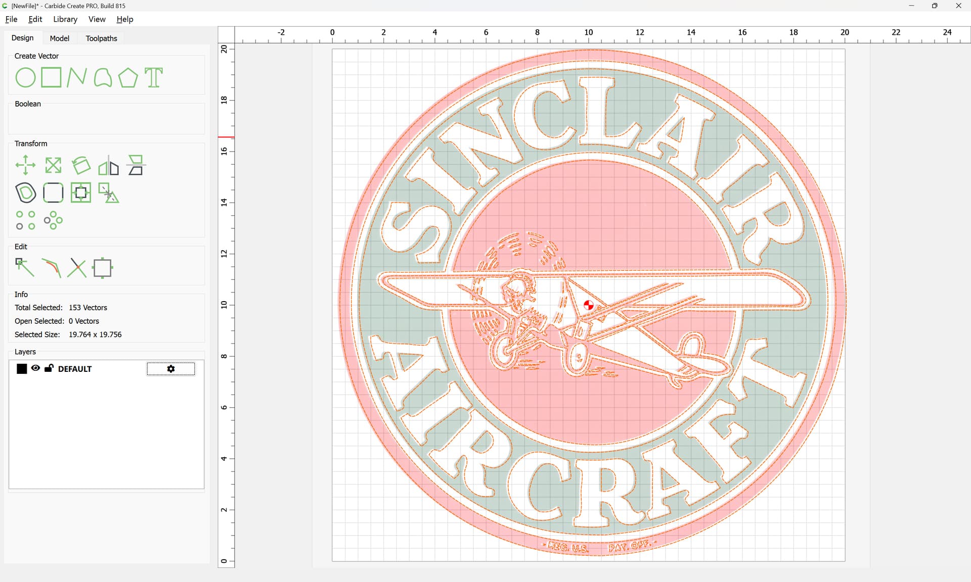

This one I used an app to make svg out of a photo and it’s rough. I need someone to clean it up and make it cuttable.
sinclairaircraft2

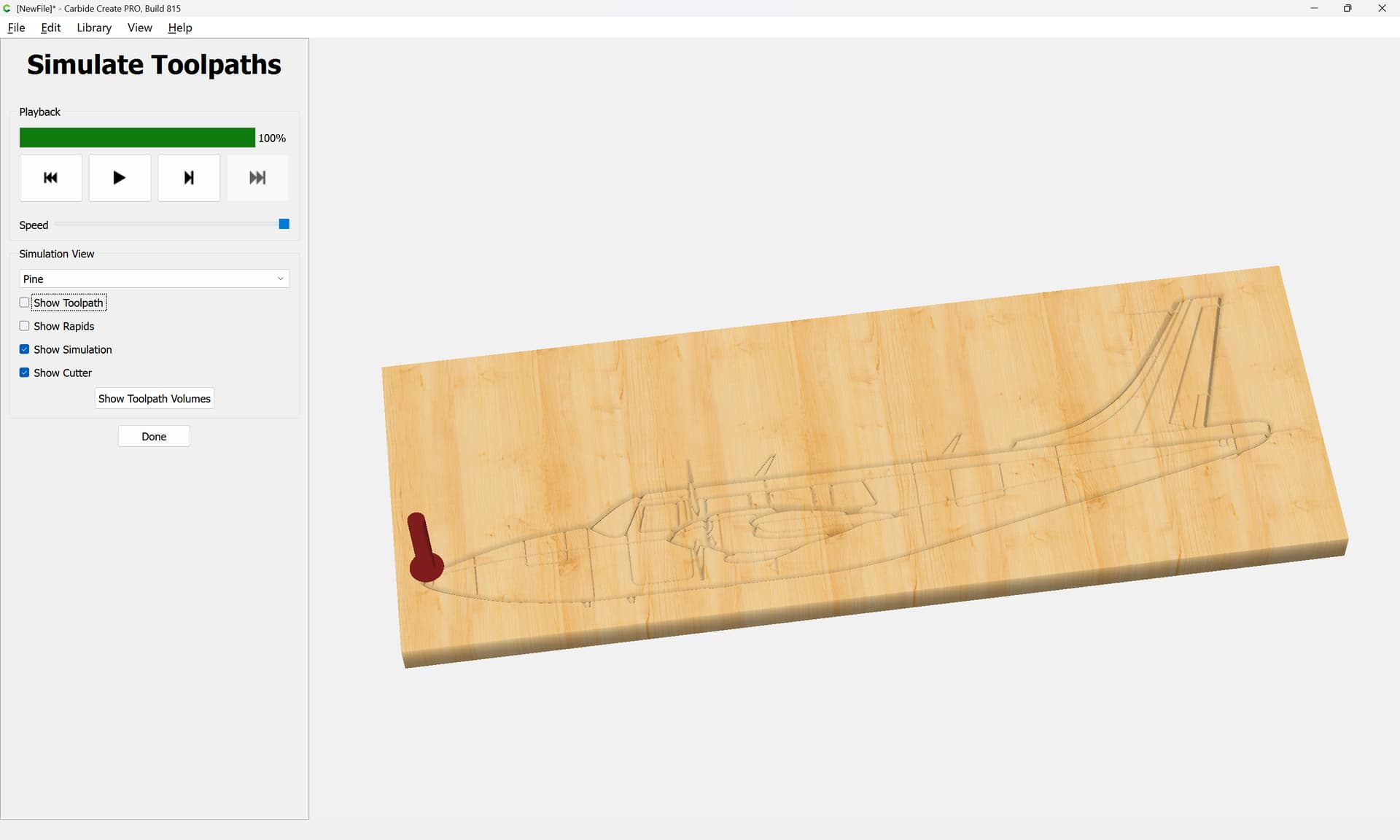

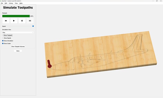

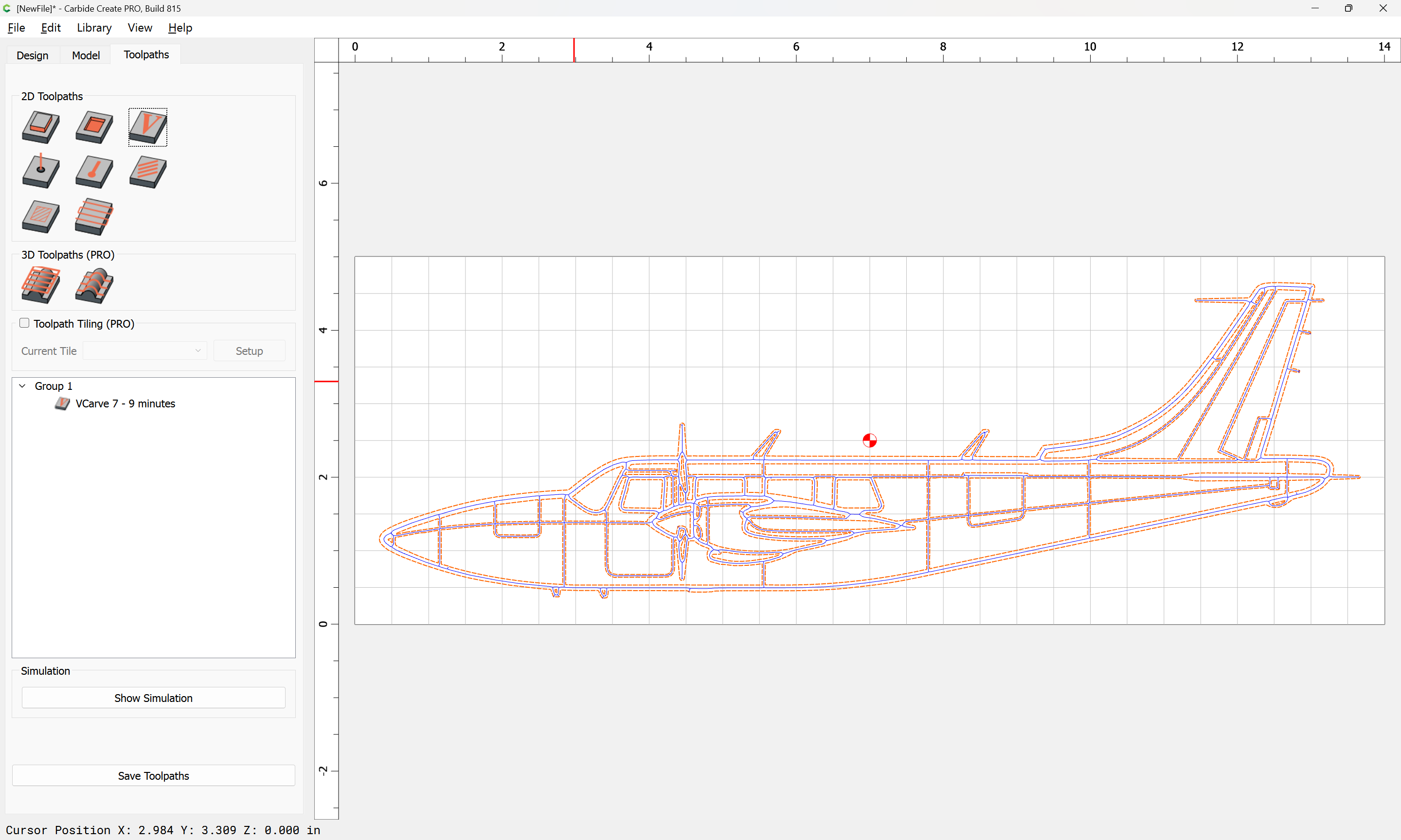

Try a simplified model. I do this kind of thing every day.

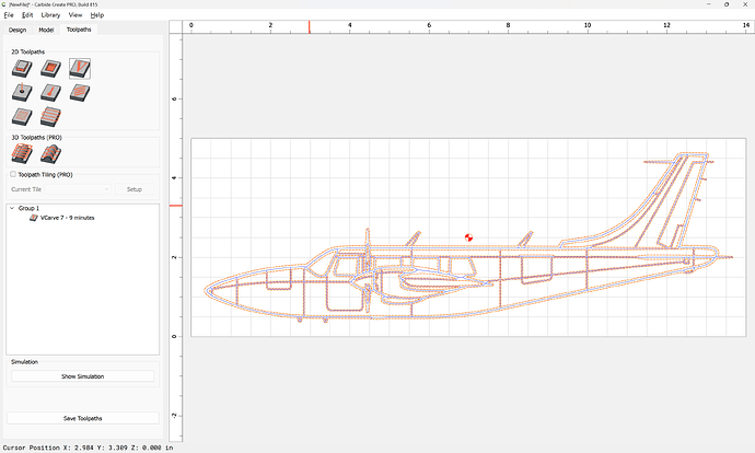

That first seems to work well as a V carving:
The other is the sort of scan cleanup we walk folks through pretty regularly, hang on, we’ll walk through that in a step-by-step tutorial.
Cool yup this one works fine, its just too busy. Lines that should not be there, and when cut looks not really great. Thanks

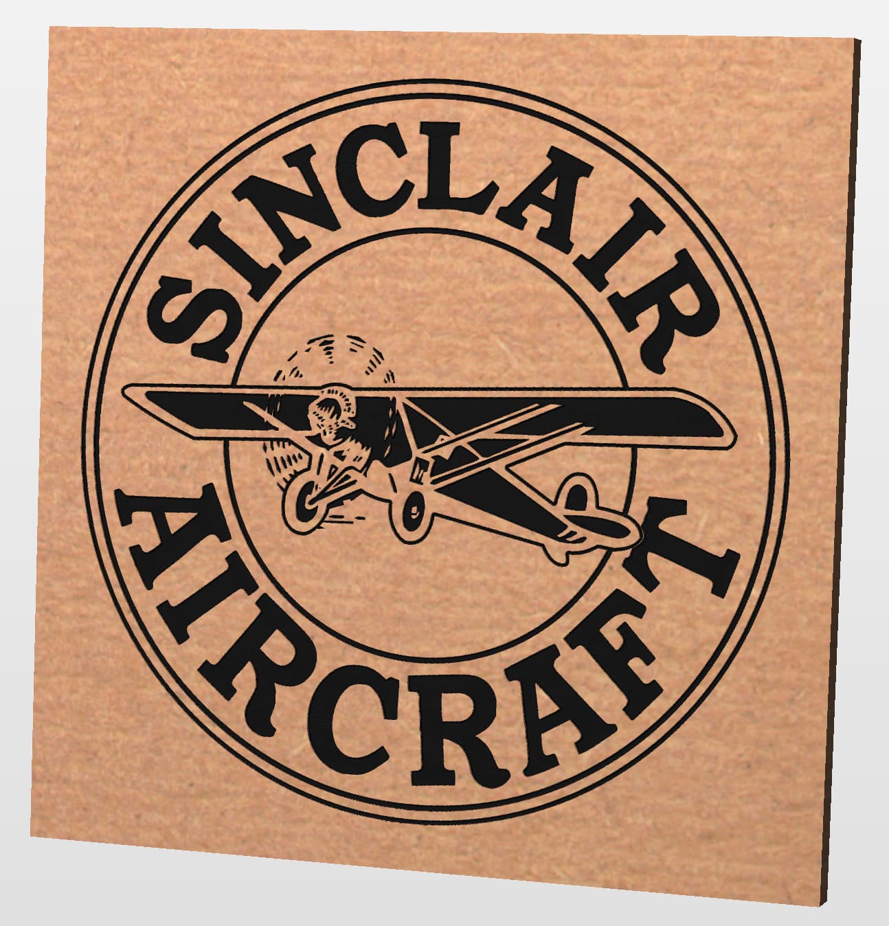

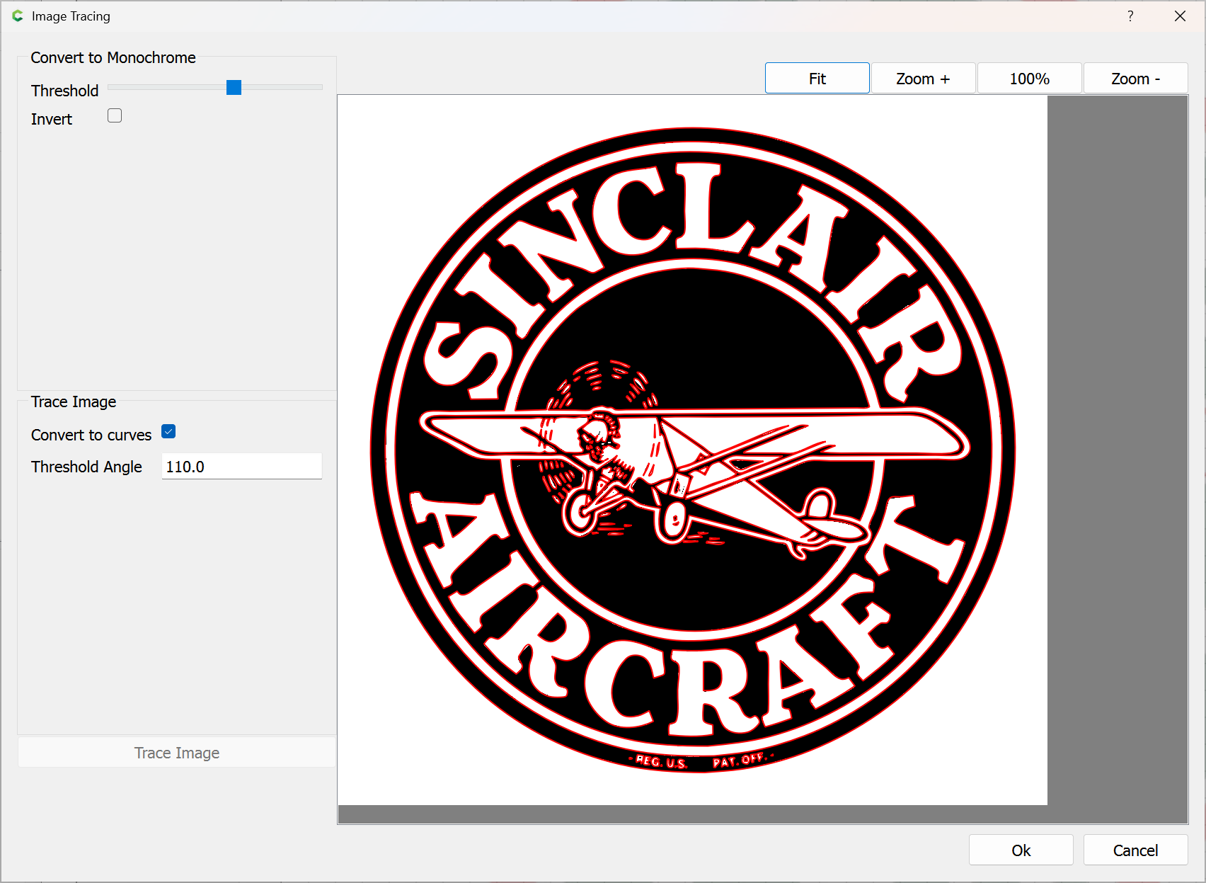

What was the original for the Sinclair Aircraft?

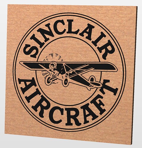

A cleaner original should work better:
Attached as a v8 file.
sinclair_aircraft_v8.c2d (1.2 MB)
Thats really NICE ! Thanks! I guess the pro has a few more options, and your knowledge makes it happen.
Really appreciate it !

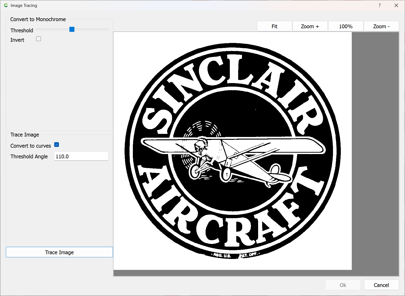

Image trace is in the bundled version, just a matter of having a clean original.

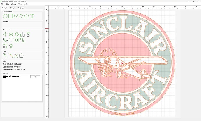

Although my work can look cartoony…cuz I do a lot of that… I prefer to draw vectors rather than trace them. As one gets better at it…and it takes a lot of practice…it actually becomes faster to get a useable drawing than repairing thousands of traced nodes. In a case like this it makes a lot of difference depending upon the use. Traced images are good for 60 degree vbits but not as good for 3d relief sculpting. Although I have to say that Will’s svg looks pretty darn good.
