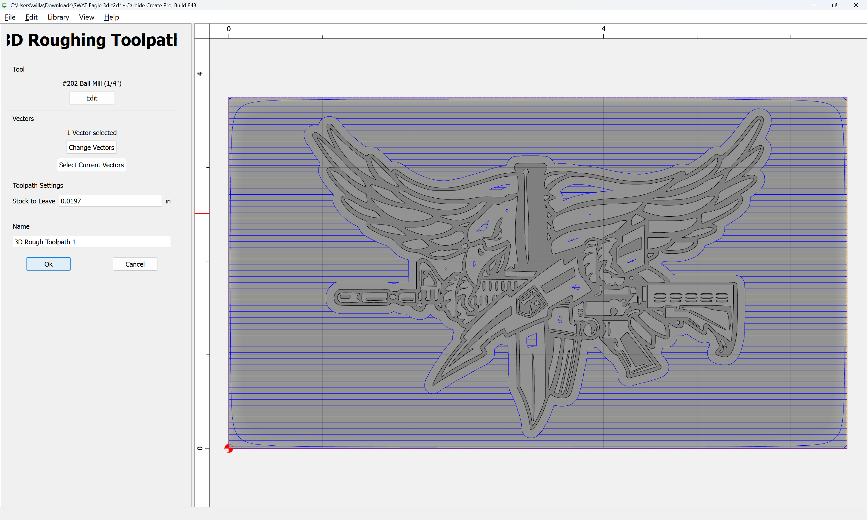

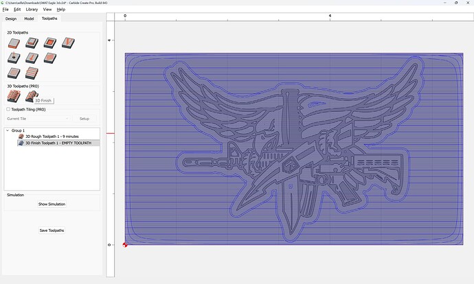

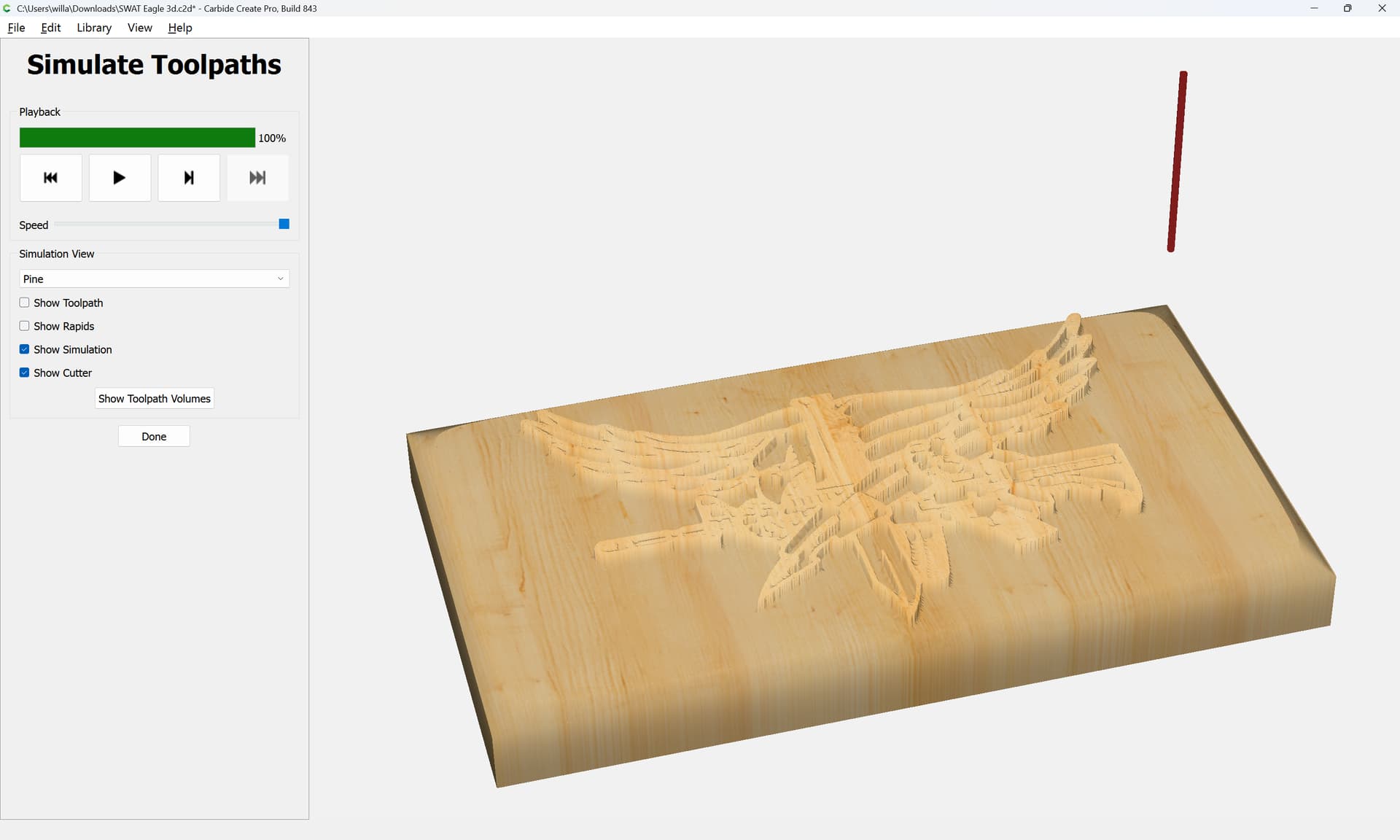

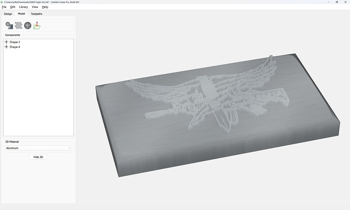

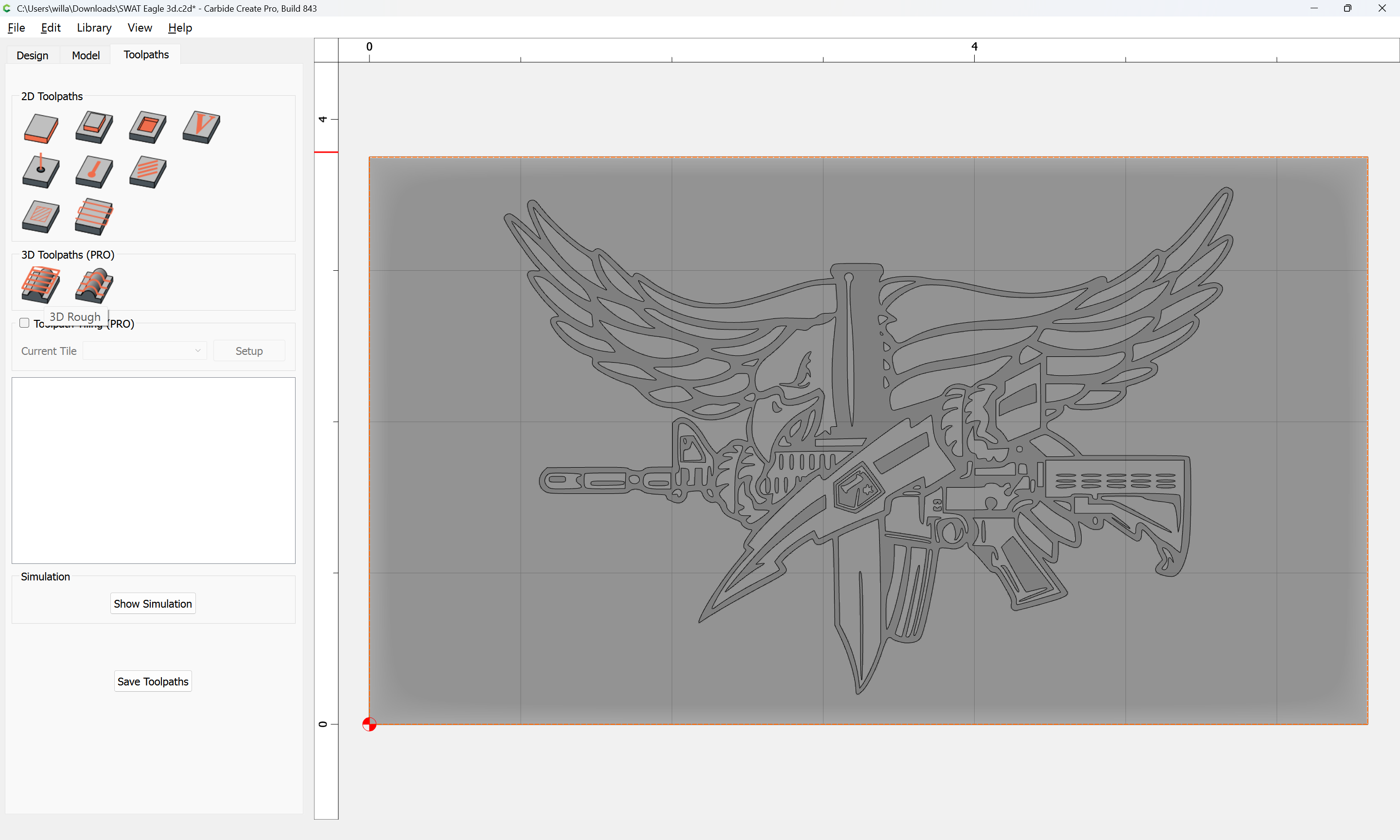

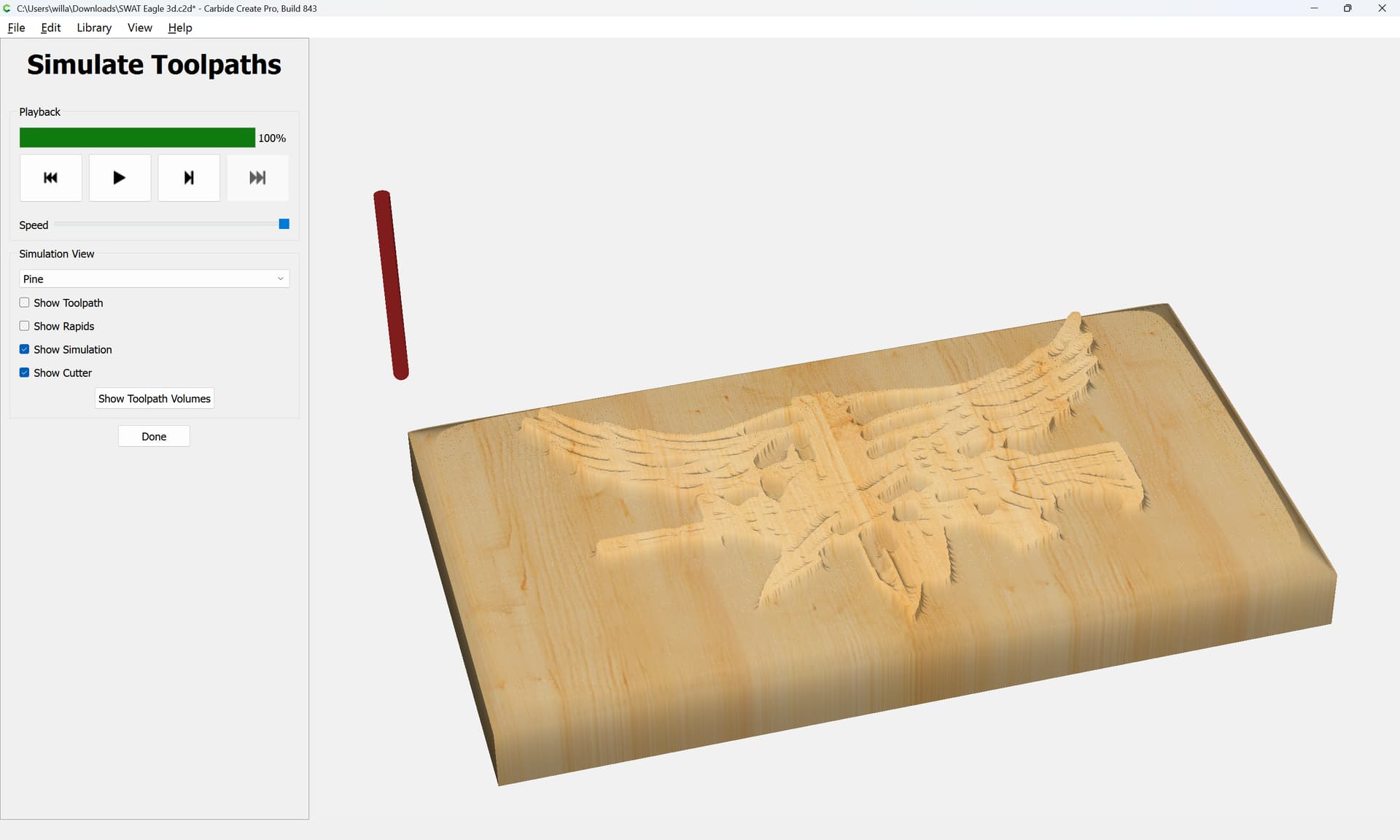

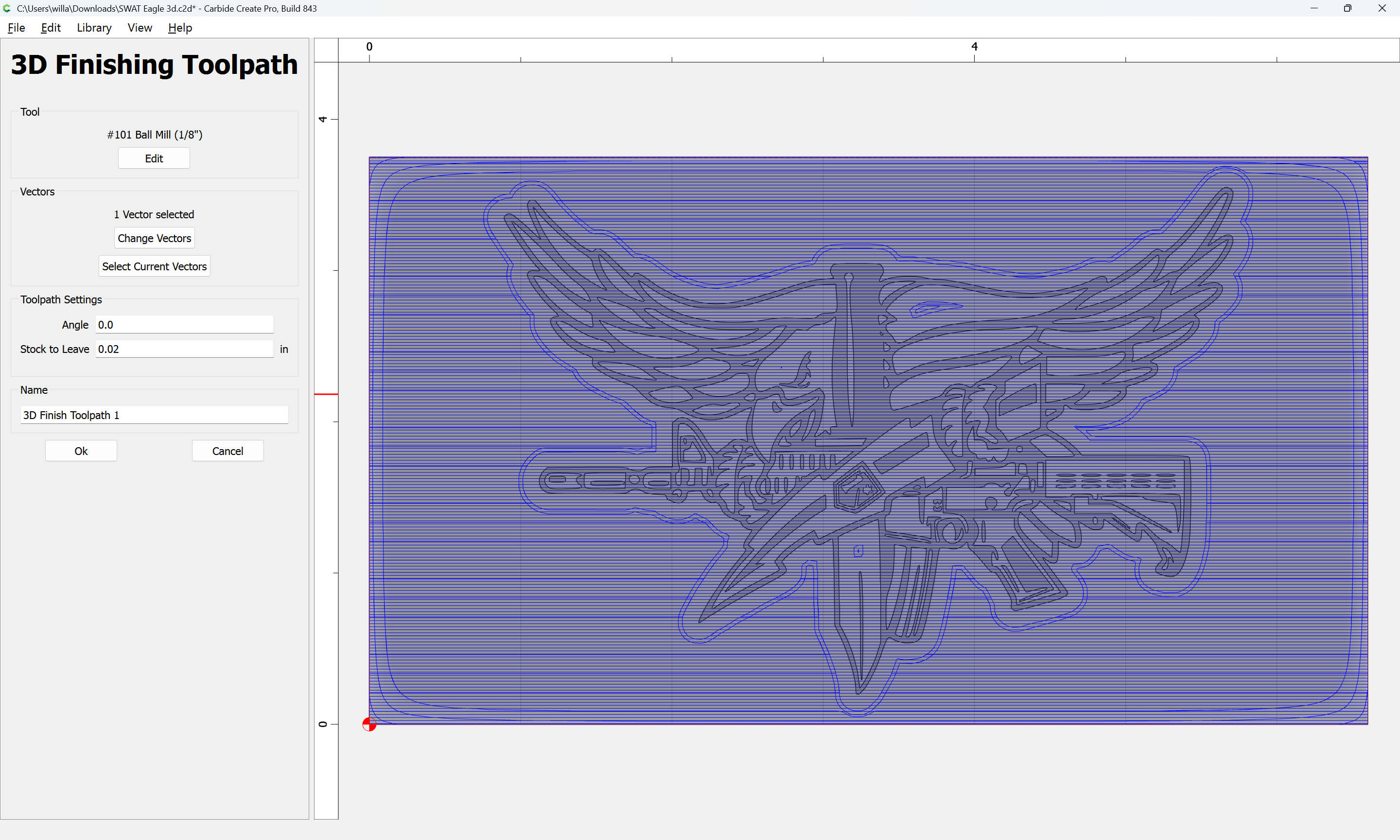

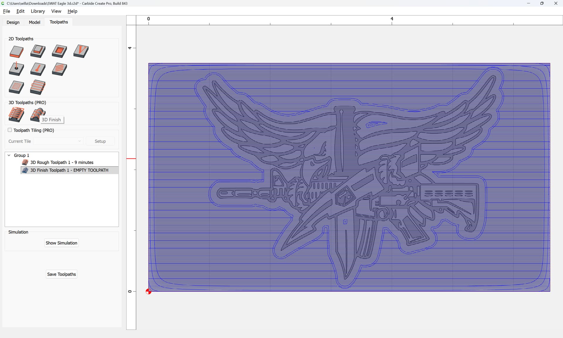

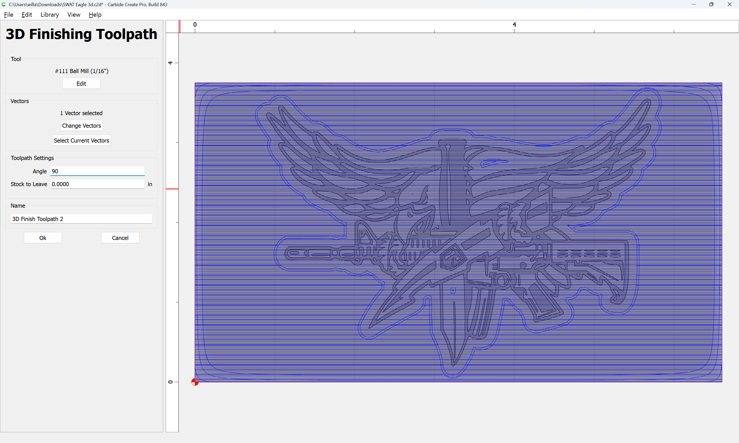

I just cant get the 3d file to work properly

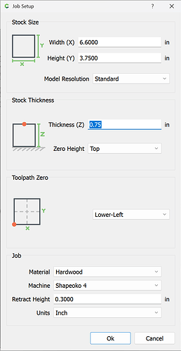

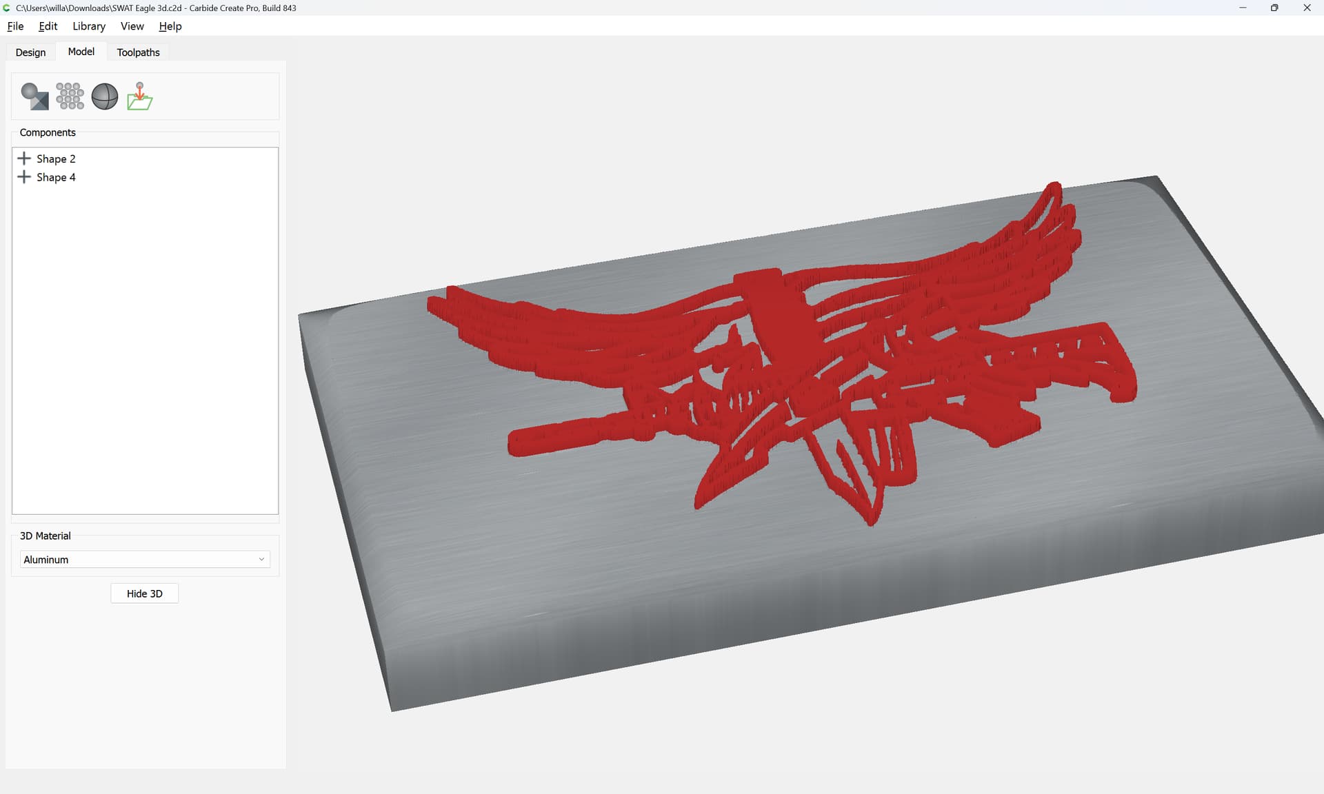

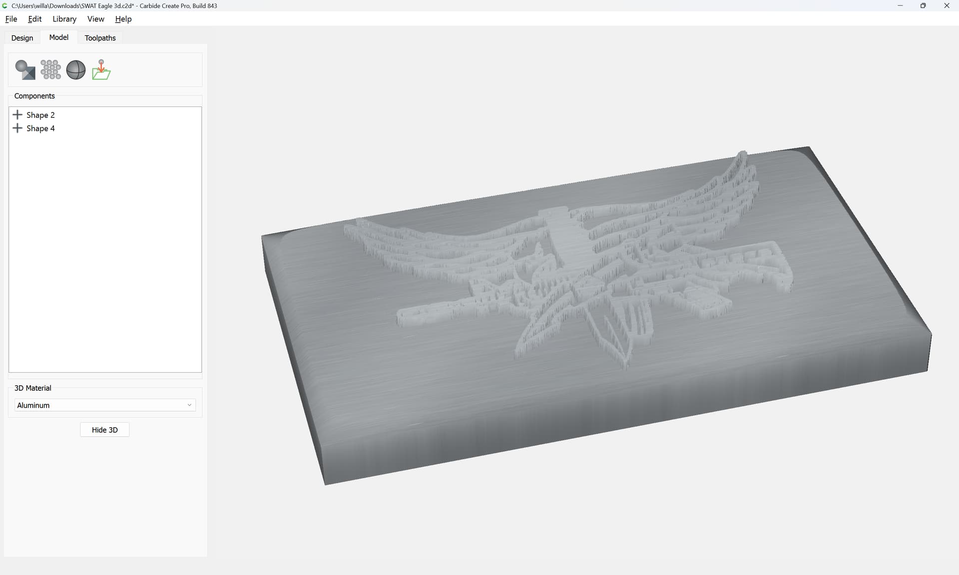

The problem is you have modeled this to be thicker than the Stock Thickness in Job Setup:
(the red regions are higher than then top of the Stock)

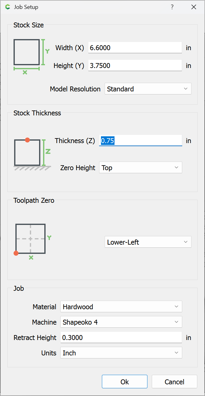

If you increase the Stock Thickness:

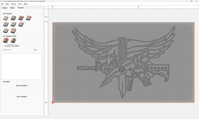

Then 3D toolpaths will work as expected:
and one may adjust things to have a second Finishing pass:
That said, you may want to try a V-carving or re-working the 3D model.

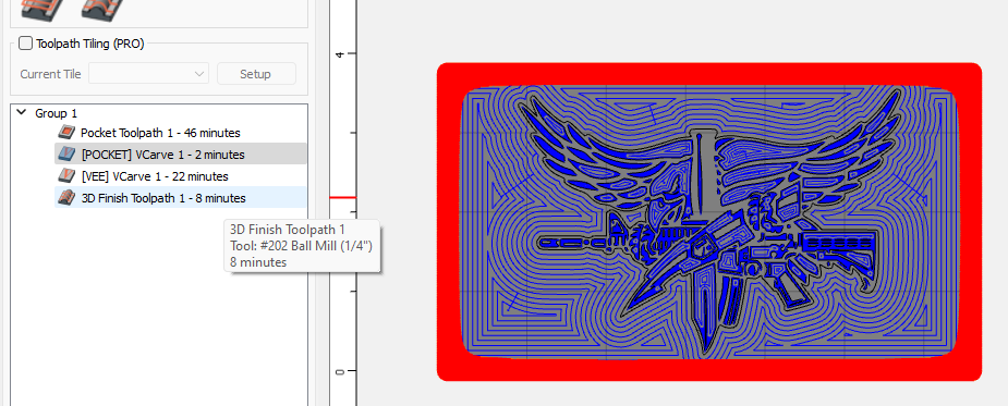

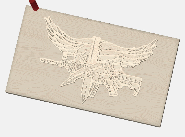

Start with:

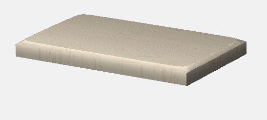

Indeed! Curious why using 3D on the whole model when the only 3D feature is the bevel around the edge. You can 2D pocket around the logo, V-carve the inside of the logo, and then just 3D carve the bevel
And you only have to model the bevel
