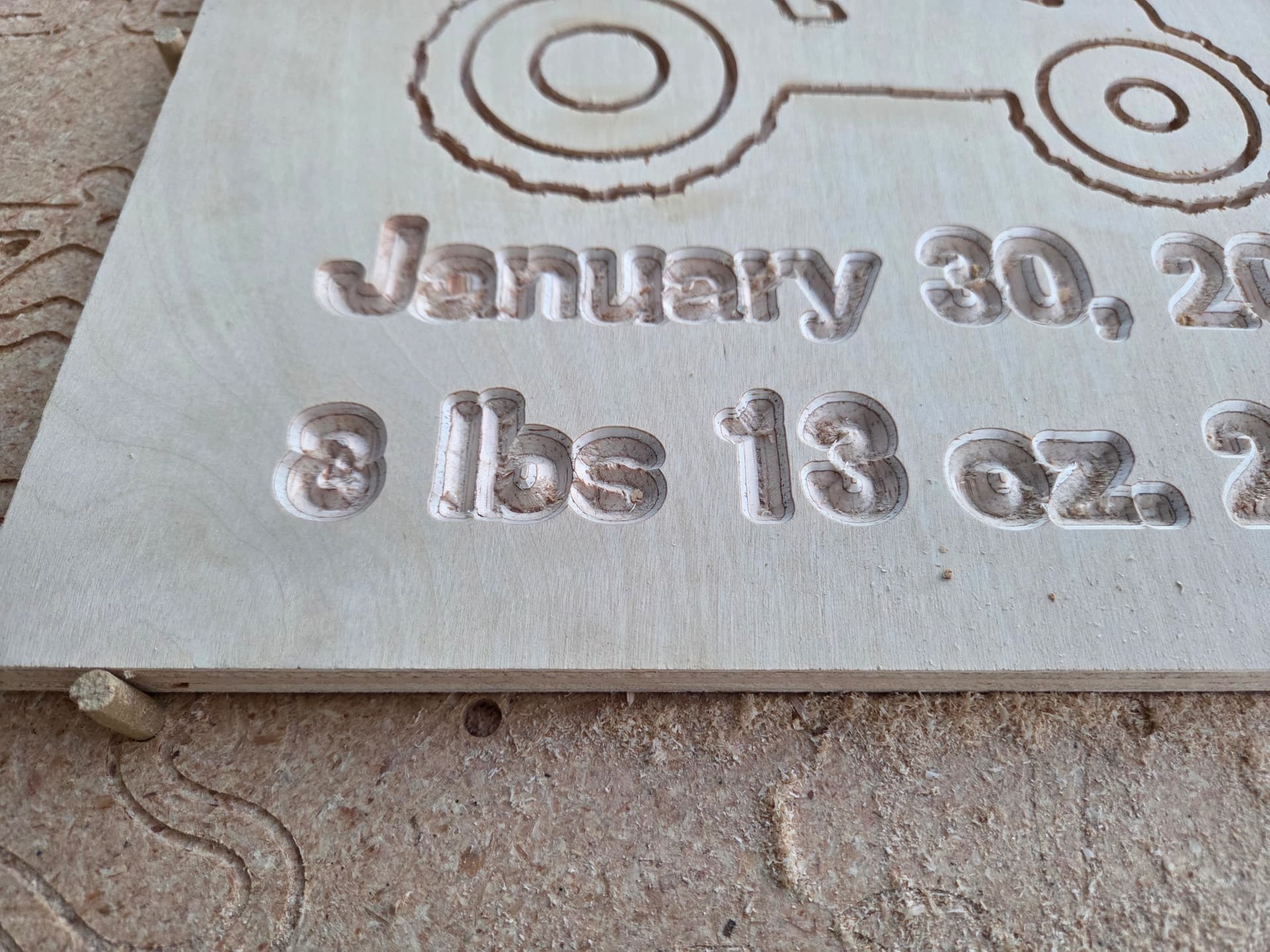

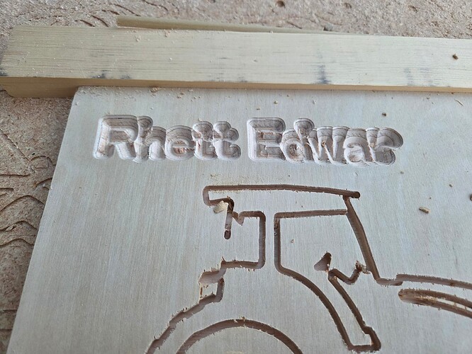

Im just wondering what other peoples suggestions are for switching bits mid project. Im using an 1/8" bit for one part and switching to a 90° bit for some letters. What are your suggestions for keeping the bit the same hight as the prevous bit.

Ive included pictures of the project im working on.

Seeing your 90 degree carving you might want to change to a steeper angle bit and do an advanced vcarve. Plus plywood is very susceptible to chipping. Like the center of an a the center section that is left is likely to chip off the plywood. Plywood is bonded layers that are at 90 degree offset for each layer. That is why plywood is usually relatively stable about changing sizes when weather/humidity changes unlike solid wood.
I often use 15 degree vee bit for making lettering because it is a steeper angle going down the sides of each letter. If the letters are big enough you could use a 1/16" (#122) and get flat bottoms on your letters which make it easier to read the text. At the very least change to a 60 degree vee bit over the 90 degree vee bit.
