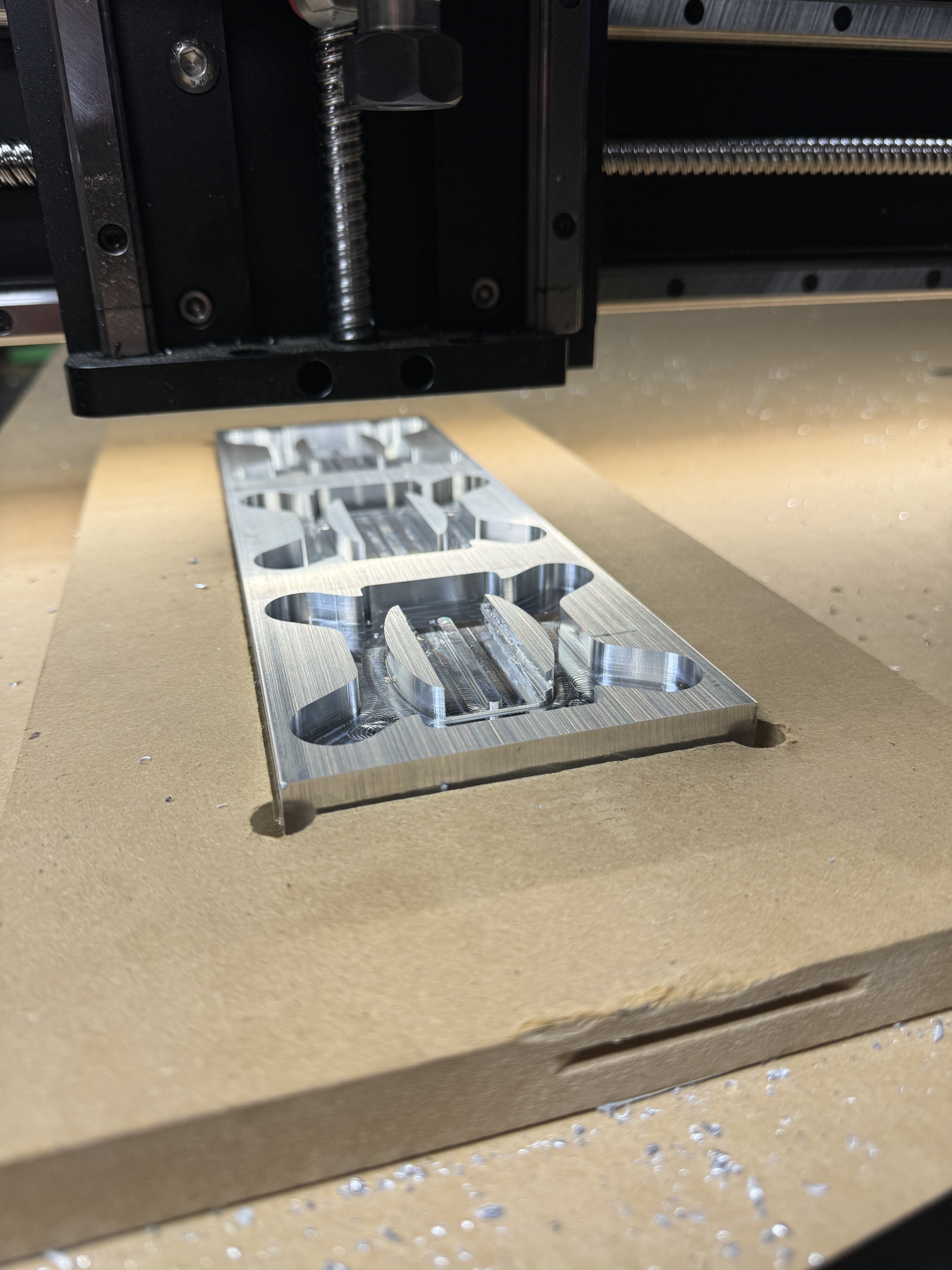

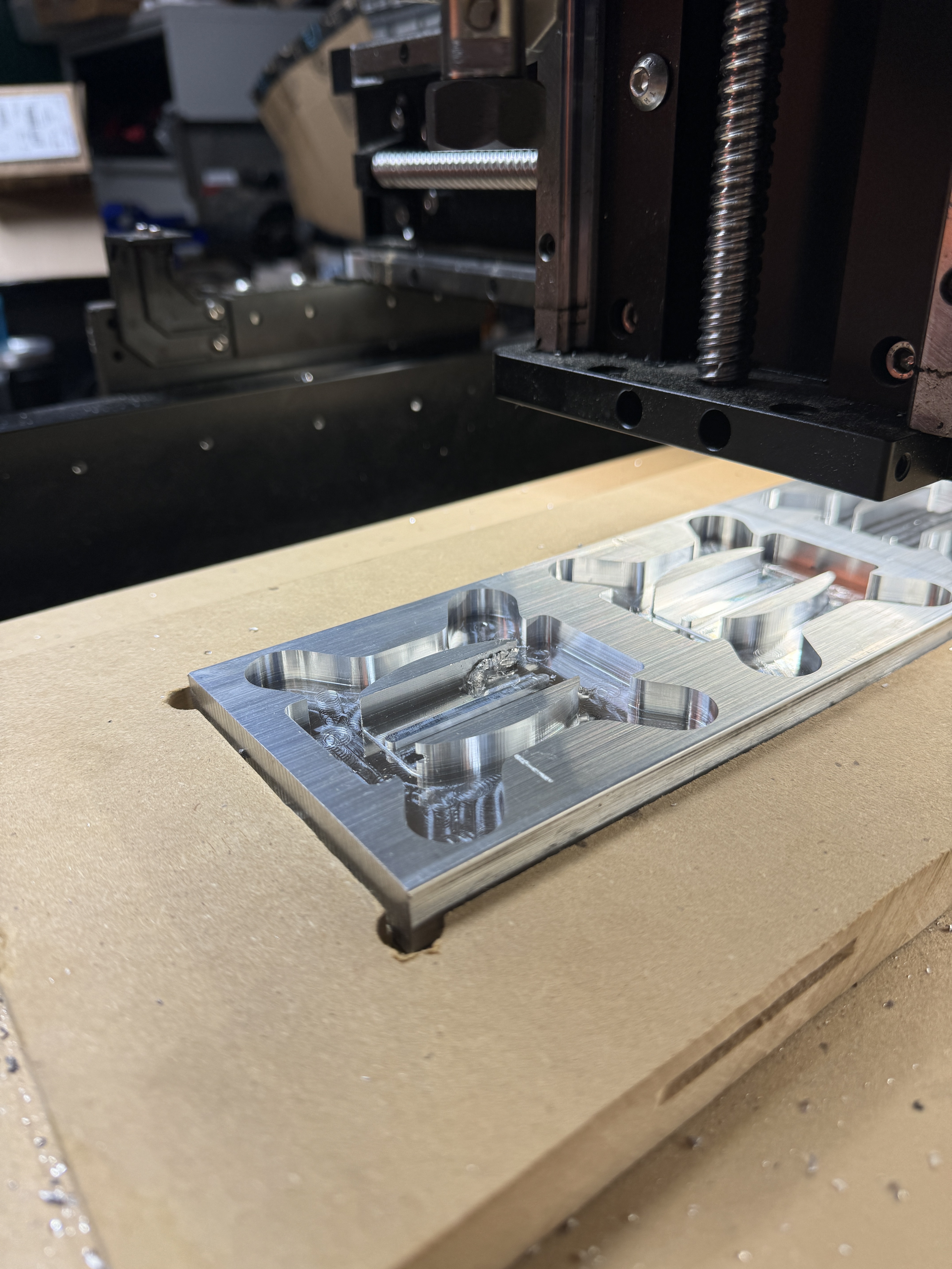

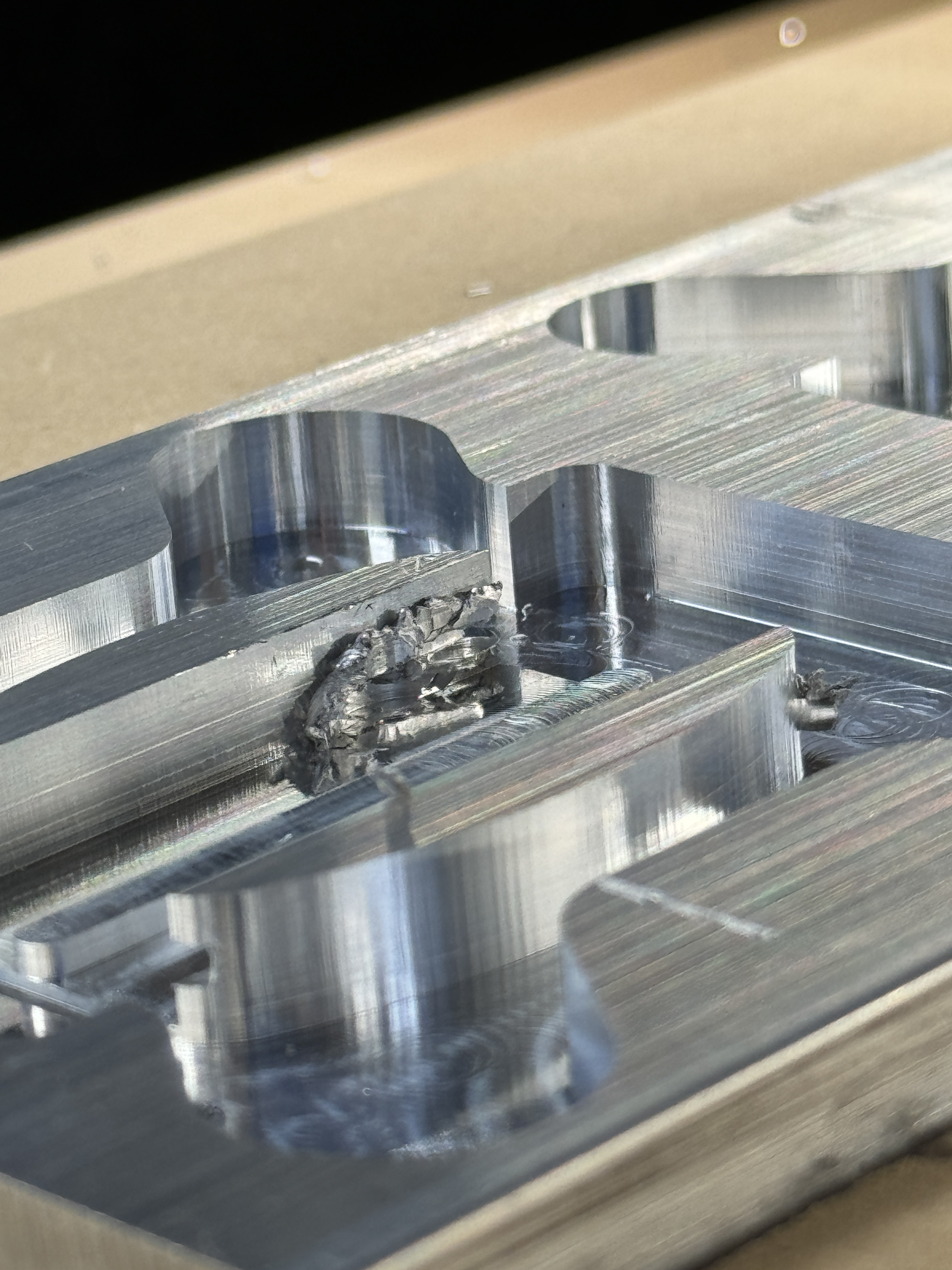

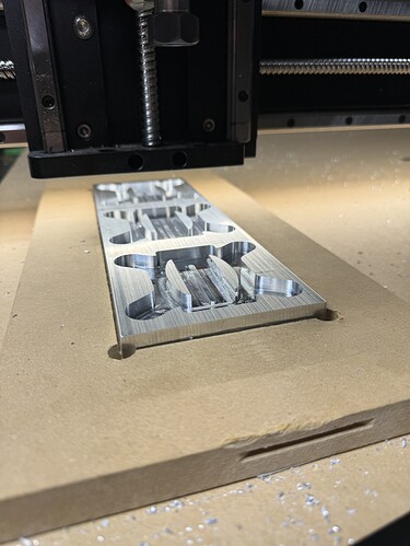

Hopefully someone here can lend some assistance on feeds and speeds for running this bit on the Makita Router on my Shapeoko 5 Pro. The manufacturer has no listed speeds and feeds that I can find on their site for this particular bit. I am trying to cut a slot in 6061 aluminum and had my speeds and radial DOC horribly wrong on the first attempt. The tool is a Datron T-Slot bit (SKU: 0068423) 10mm cutting width. The first attempt melted the aluminum to the bit so obviously that was far too fast and deep. Anyone here with experience cutting a key slot or T slot?
10mm is about 3/8", so for 6061 I would go with 8000 - 10000 RPM, and a 0.010" - 0.015" stepover.
I would not try to cut the whole slot at once, unless I was using an adaptive toolpath & some good air assist / coolant to get the chips out of the slot.
Another consideration is the start point. I doubt you want to cut this like a keyhole where the tool plunges to full depth & then cuts out the slot.
Looks like you added pictures while I was typing. So you’re adding a side slot to that vertical wall?
I cut retaining ring grooves with a similar cutter in aluminum at 10000 RPM, 40 IPM, 0.010" stepover
@Tod1d thank you for the quick response. Yeah I messed up with the depth of cut, for sure. I will try your recommendations this morning and see how it turns out. It was a mess for sure. Not only did the aluminum melt but the angle of the flutes pulled the bit and Z down as it went into the material and made the mess even worse. Do you use a conventional cut or climb cut with your bit?
