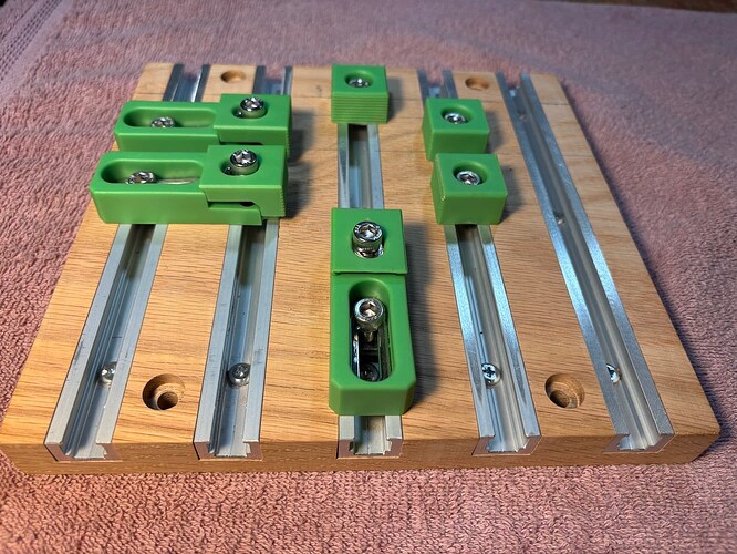

I’m looking for T-TRACKS that will fit the CRUSH IT clamp size.
Everything I find is too small. I want to make a special spoilboard with t-tracks, but I want to use my existing clamps!
Does anyone know the source for these? There must be an aftermarket track that will work. The CRUSH IT clamps have a 5/8 base.
Thank you!!

The Crush-it clamps will work with those T-tracks — I use them on my SO3 thus w/ the Woodriver T-tracks.
The part which is specific to Carbide 3D are the Teez-nutz:
The various Crush-it clamps:
work fine with pretty much any T-track, but the Teez-Nutz are sized so as to fit the Carbide 3D Hybrid T-tracks, and I don’t know of anyone making a compatible T-track system.

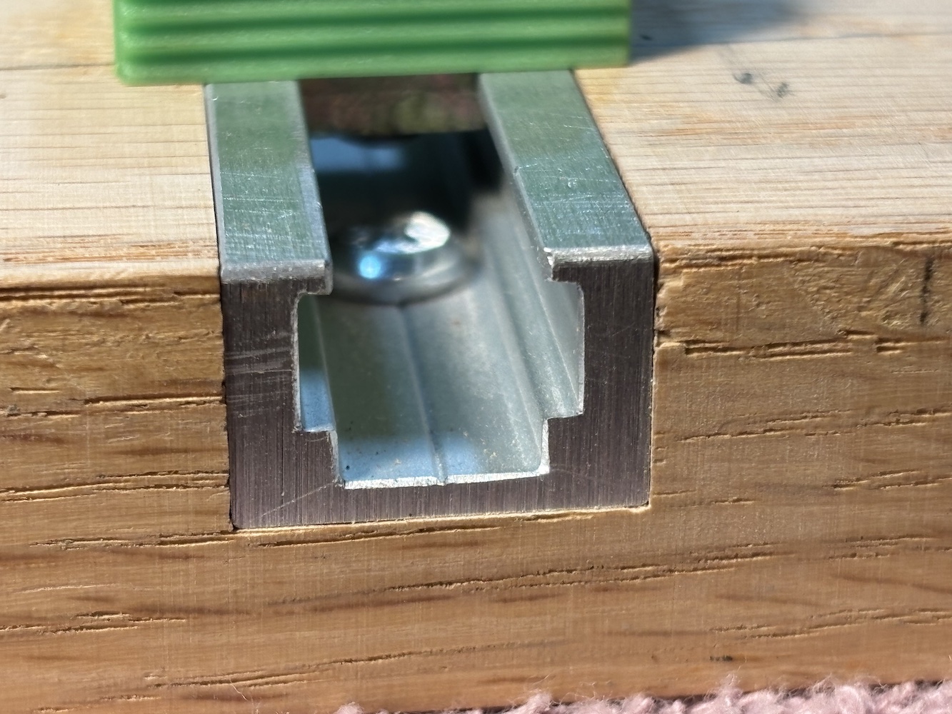

I unsuccessfully searched awhile but couldn’t find the Carbide T-track. But it’s fairly easy to find
this deep 1/2" wide track that works well when flush. Got some square M6 nuts off Amazon, had to slightly file some of them for fit in the track.
