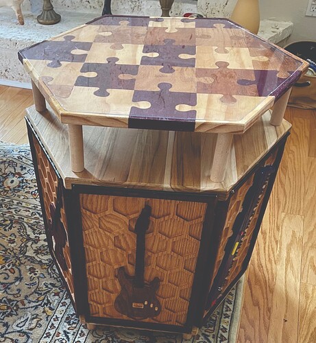

Table top puzzle made from scrap pieces of purple wood, mahogany, oak, walnut, pine and maple. I use a Shapeoko Pro XXL.

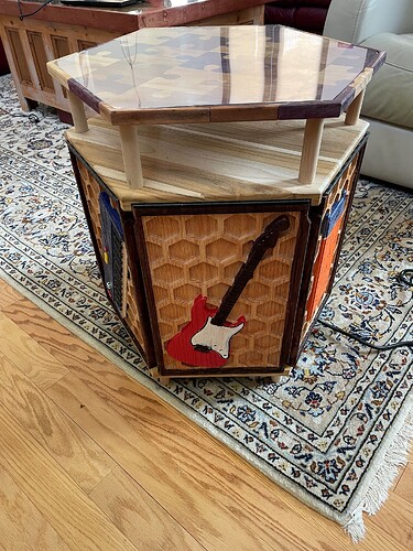

All 6 panels made from 11.25" x 17" x 3/4" Oak. Instruments and hexes carved from same plank

Thanks, it wasn’t easy - took many evenings to draw and many hours to cut out. I learned to stain the intricacies first then mill. For example, on the keyboard, I stained the black keys black and then made the grooves between the white keys and then milled the white keys. It made the staining a lot easier in this manner and made the grooves with no burrs on top. If i cut out everything first, there was no way i could stain the black keys without getting stain on the white keys.

Thank you Anthony: Lots of work to make a second table but then again, all the programming is done. Also, I learned a lot from this first one. I left gaps in the puzzle thinking that the pieces won’t interlock unless a loose fit, but I found that a line fit works well and looks cleaner - I can tweek the drawing to improve. Also, will mill most of what needs to be milled about 90% deep, then stain, then complete the milling with an up cut to get rid of any burrs or splashed stains.
