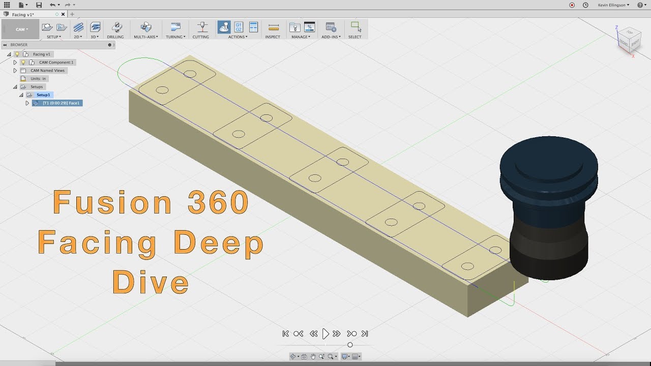

I need to resurface my spoil boards so they are level with the new set up. I have purchased the surfacing cutter off the carbide3D store. From some of the posts I’ve read in other threads it seems like the working area that can be surfaced is smaller than the total area of the spoil boards. It was on older posts with the other shapeoko machines. So I wasn’t sure if it applies to the SP5.
Does anyone have any recommendations on how to do it properly?
See:
If you plan to eventually use Fusion360 or some other CAM, facing the spoilboard seems like a good starter activity and makes more sense than trying to design a pocket in Carbide Create to accomplish the same. I followed the facing tutorial here which requires the additional activities of setting up a machine and tooling in F360 as well.
You should be able to jog around the 4 corners of your machine with the facing bit installed and determine if it will give you full coverage of the spoilboards - on a S5P 4x4 I was able to do it but it’s snug in X.
Happy to share the Fusion360 machine, tool, and facing .nc file for the 4x4 if you like. I can’t promise they’re perfect as I’m learning as I go as well.
