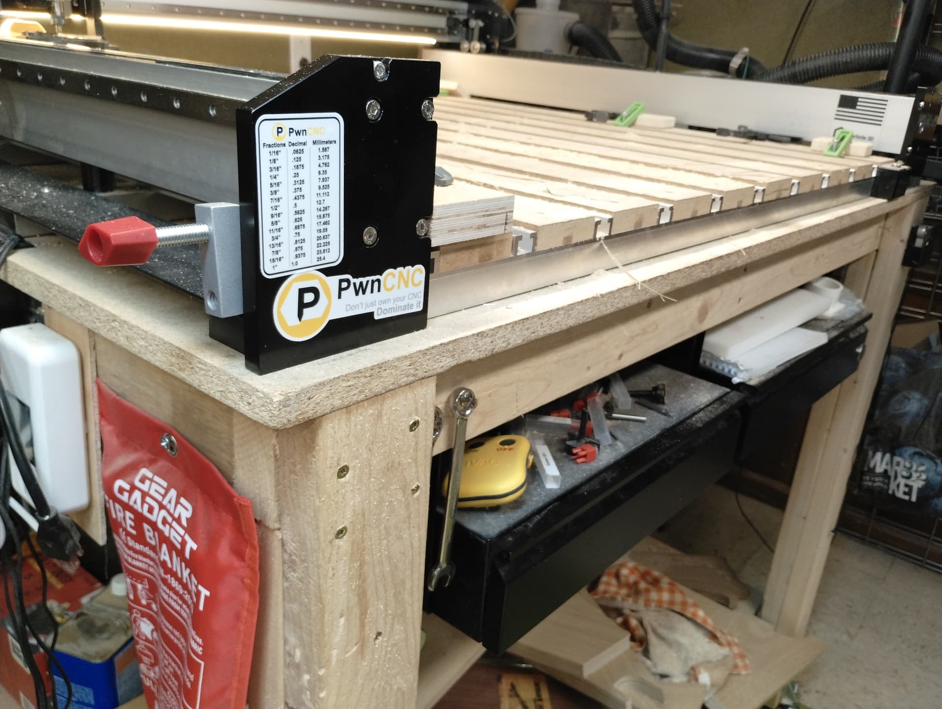

I have just finished building my table for my 5 pro. I have about 8 or 9 inches in front of the machine. In addition, on the side I have a flip up shelf that is on drawer slides that pulls out front for my computer. I still have to build drawers in the front.

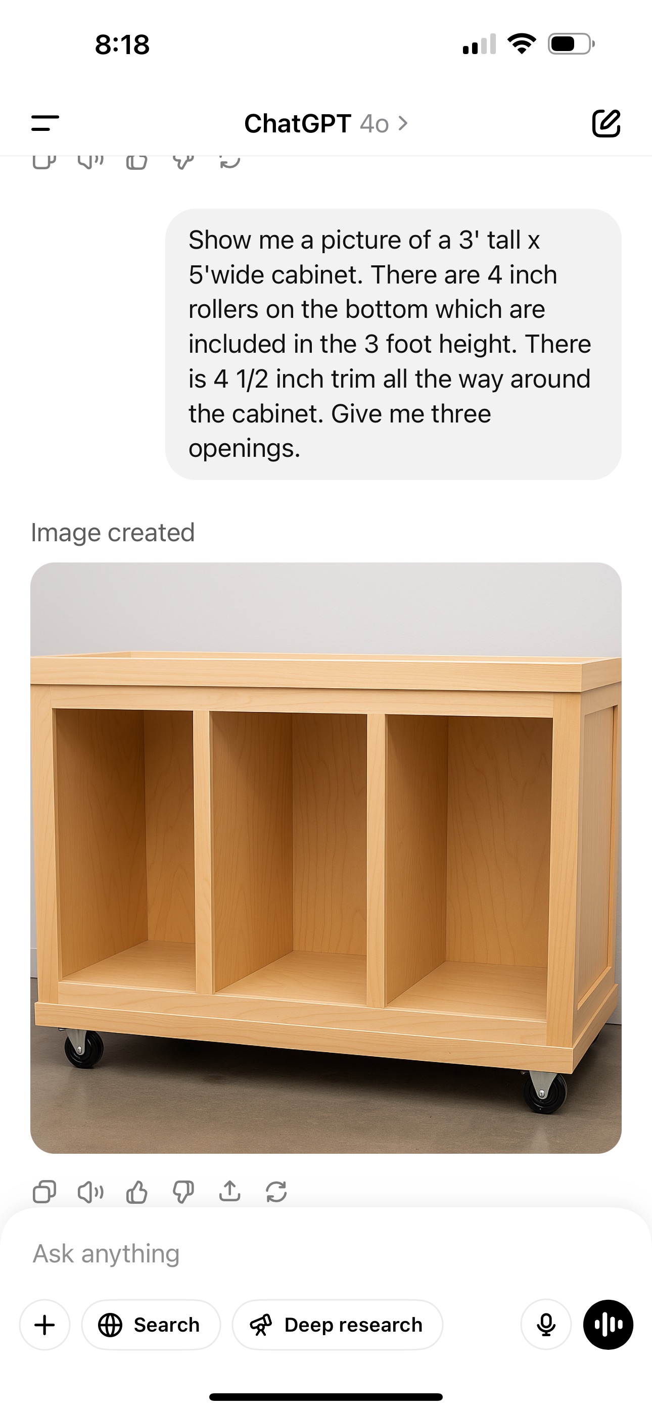

Interesting thing I did today. I just wanted a basic visual of what a version of the potential table would look like…so I turned to chatgpt. This is all I prompted it. Literally in 2 minutes I had something to see.

All my tools are hanging from hooks on the front of the machine.

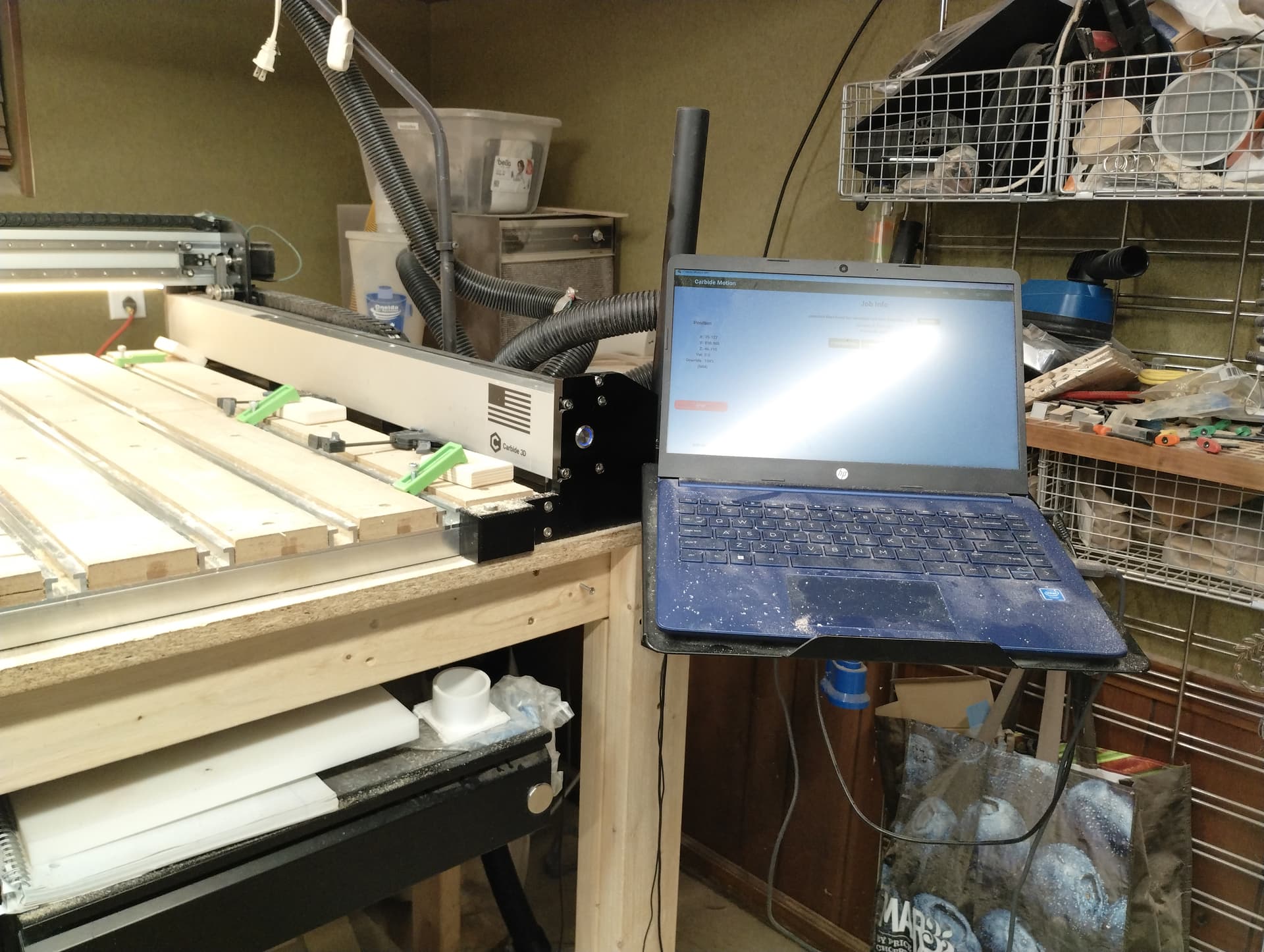

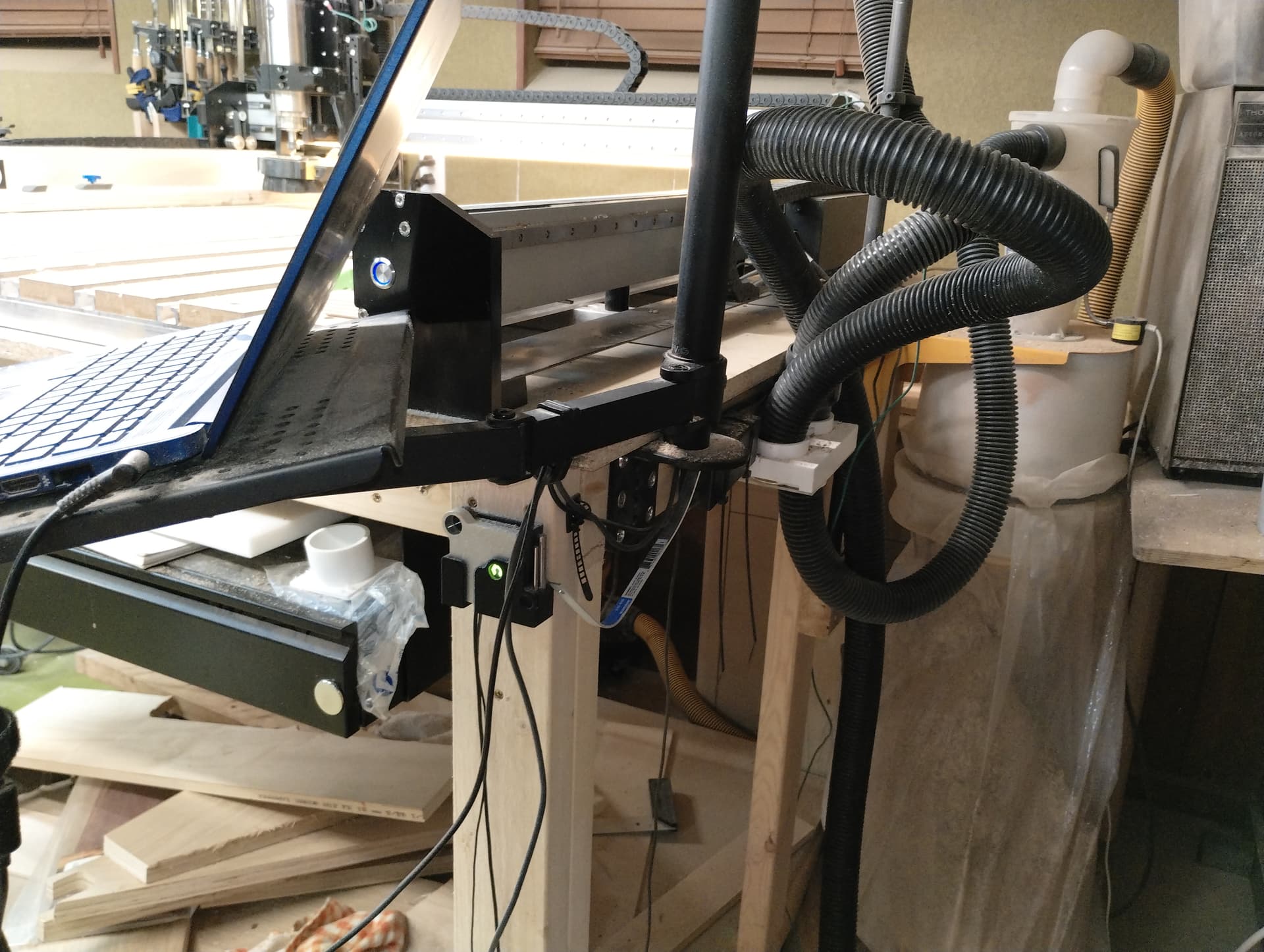

I think it is good to have the laptop attached on a laptop stand, I have this one:
and I also have some items hanging at the side or the front like wrenches, bitzero,
and drawers.
That is how it works well for me:

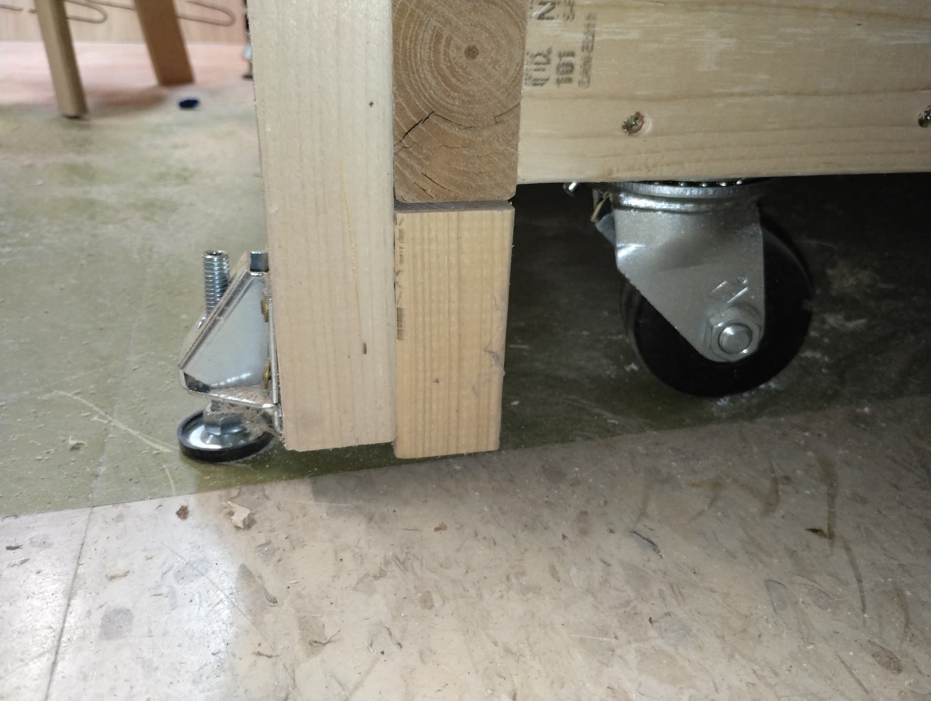

Wheels IMHO are necessary. I came to that solution
with these casters:
and leg levelers:
because those are crap and break within weeks:
