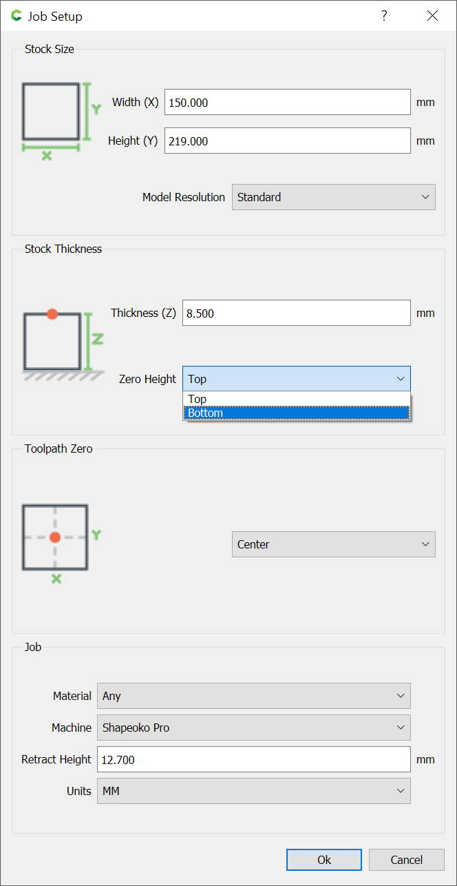

If you are getting inconsistent depths on your tabs then you need to make sure your material is a uniform thickness and you are measuring it correctly. I use the bottom of the material for most projects (Spoilboard) and I get very consistent tabs. The only down side to using the bottom is if you measure incorrectly the material thickness the first cuts either are air cuts or cuts that cut more deeply than intended. So try the bottom of the material and see if that helps your tab size issues.
I have been using the top of the material, but using the bottom sounds like a better idea. What would I have to do differently in the program? How do you set the zero?
In Job Setup:
I use the bottom almost all the time. As @WillAdams showed above select bottom (spoilboard). I put my BitZero on the spoilboard and zero Z only. This takes some getting used to. One caution is if you regularily check the Z+6mm in rapid positions make sure the bit is setting over spoilboard and not on top of your project. If the bit is over the project it will come down and crash into your material. The rapid position for X and Y still work just as before and the Z+6MM does take some getting used to.
