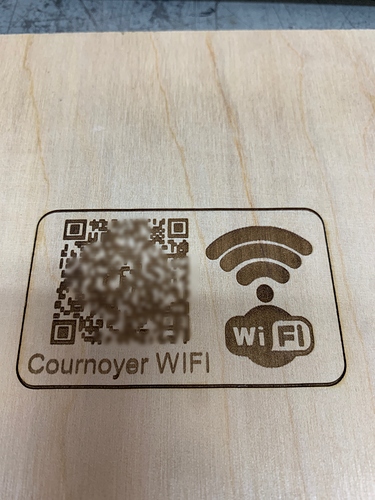

  3. Opened GRBL Laser, moved the machine around, imported a photo and made a nice BLACK photo…See you need to know HOW to use the laser to use the software…Errr…Chicken and the Egg. Kept playing around with the power and speed setting until I got a less ashy, but crappy photo of my dog…Oh…different wood burns differently…oh, boy this is going to be a long road. The software is VERY limited as to what it does well…operated the machine, but it’s not a very good at creating fancy Graphics which i needed to drive the machine (IF you are not going to download photos to print),

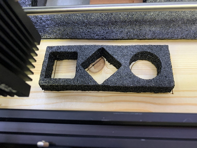

3b) Looked for some GRBLLaser (Software) tutorials and found none… But I do (NOW) understand the difference between an Image and Cut graphic. I jumped into Carbide Create and made a Circle Diamond Square (CDS) CUT file (SVG). Placed some 5/8 thick FOAM in the machine and ran the CDS…ran it 6 passes…it cut through in 4…(See photo_. They are (about) 1.050" (Laser melt). Pleased with the results…I can see a LOT of foam cut things coming up…so pretty.

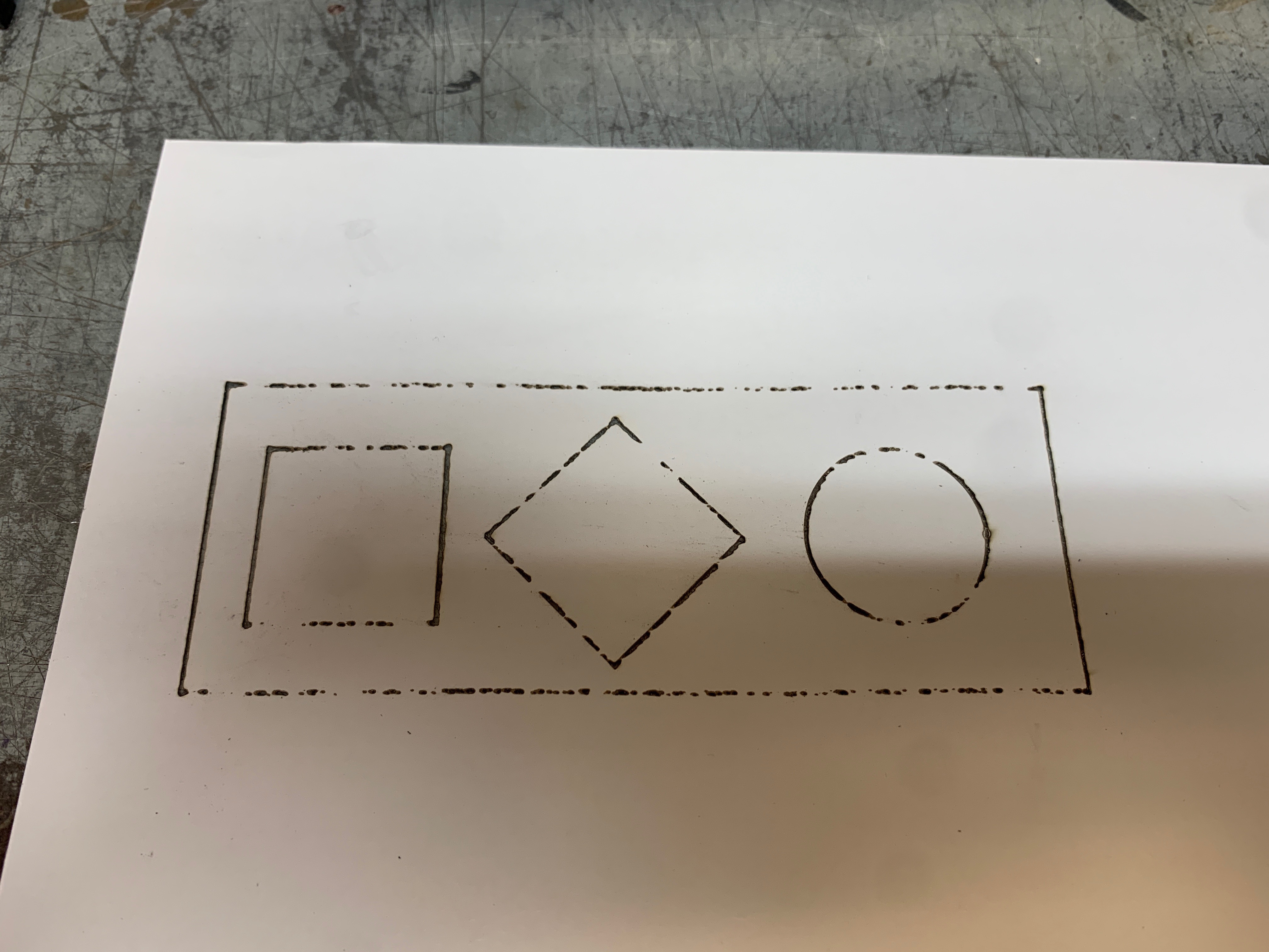

3c) I ran the same successful foam cut file on a sheet of paper (I think it doesn’t like white paper)…but it wouldn’t cut through … even after 12 passes…(Anybody??)

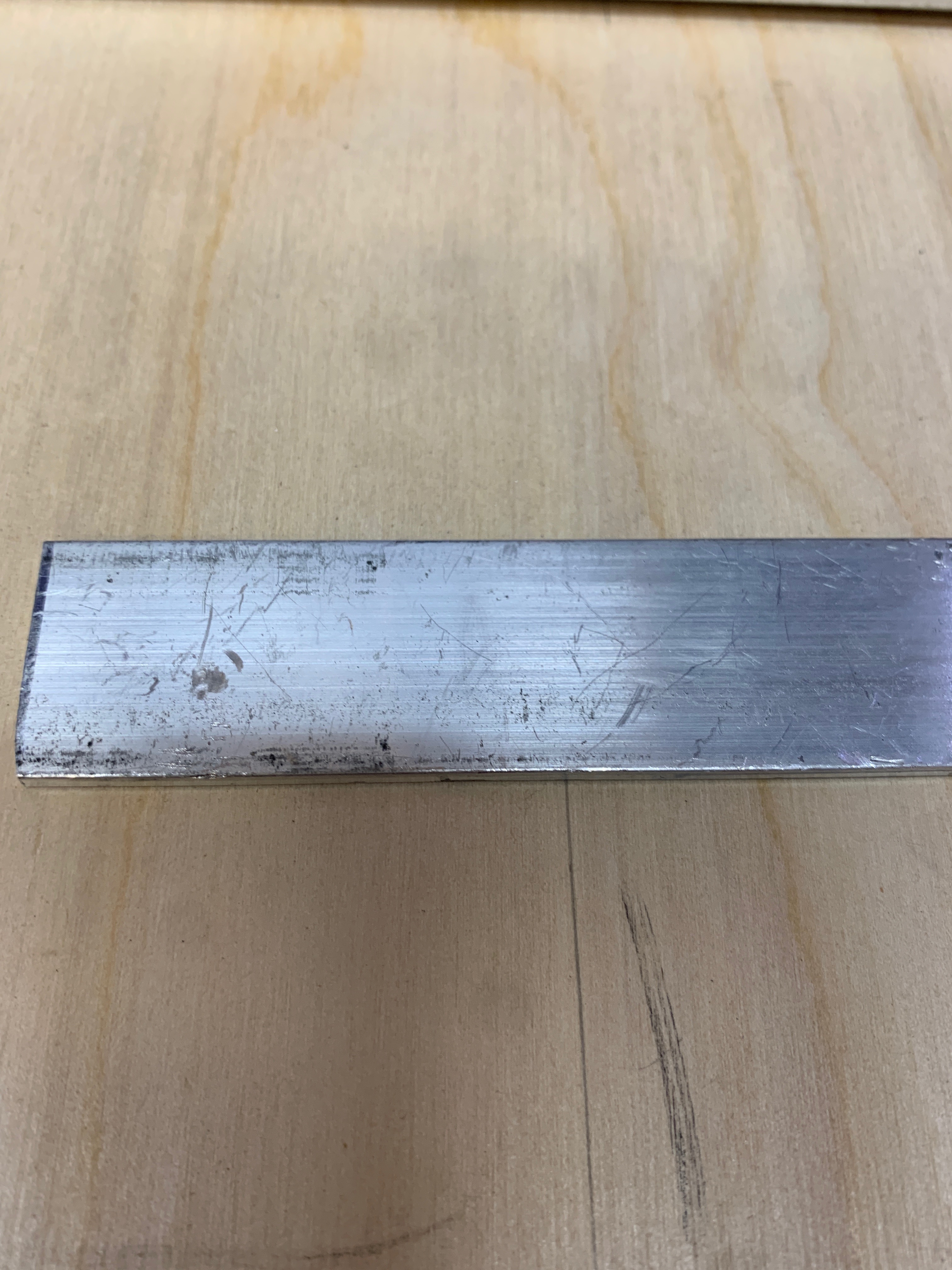

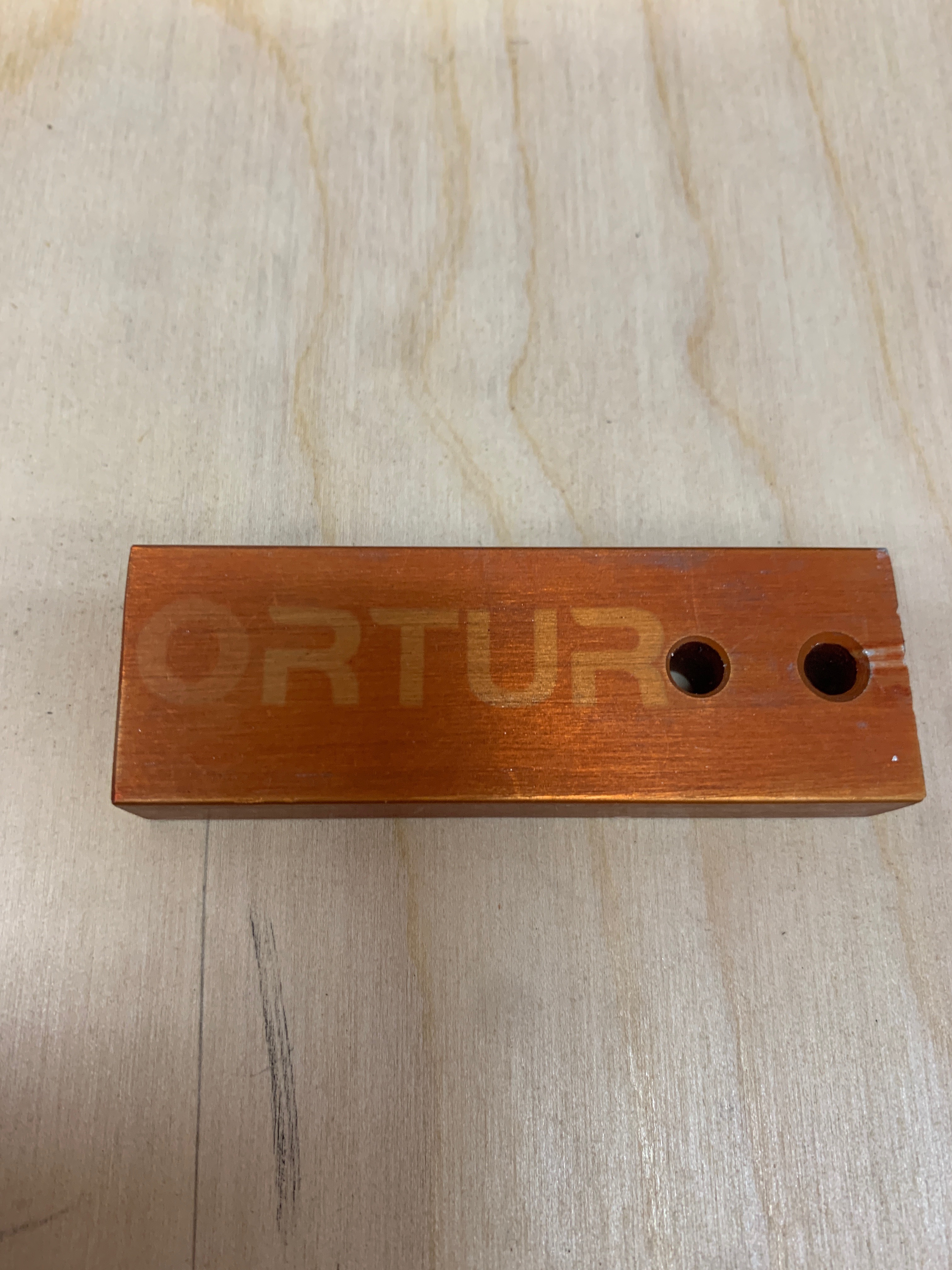

Other things I’ve learned: Does NOTHING on Bare Aluminum…a little on Anodized aluminum…going to try some Mustard and Stainless Steel tomorrow… (google it)

Laser on my Home DIY Anodize
5/8 Foam
Paper (No Bueno)
Baltic Birch (Blurred out)
