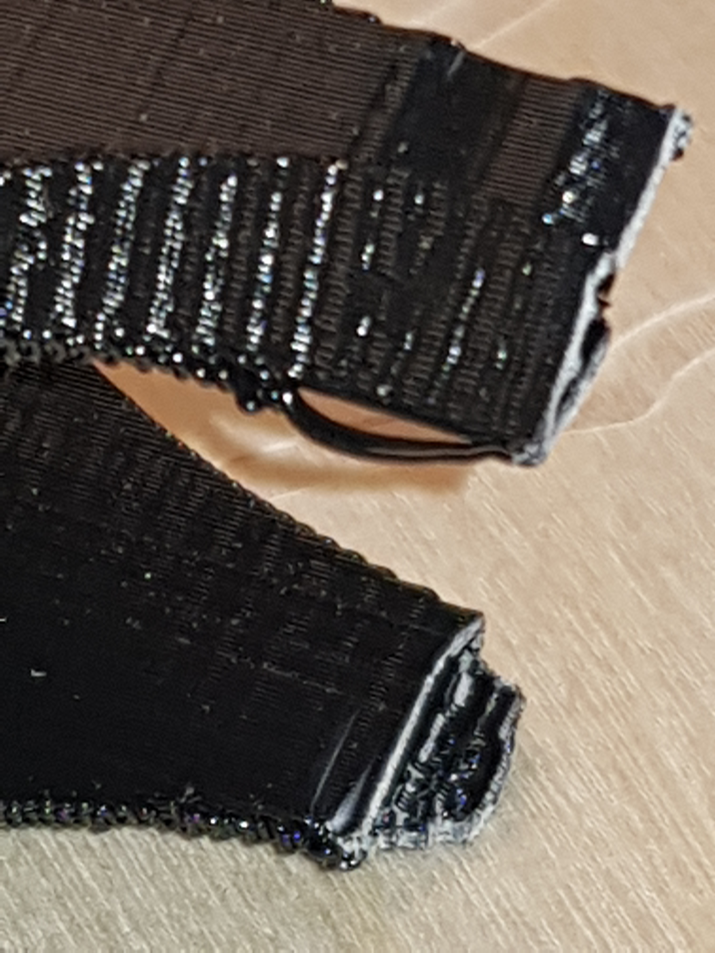

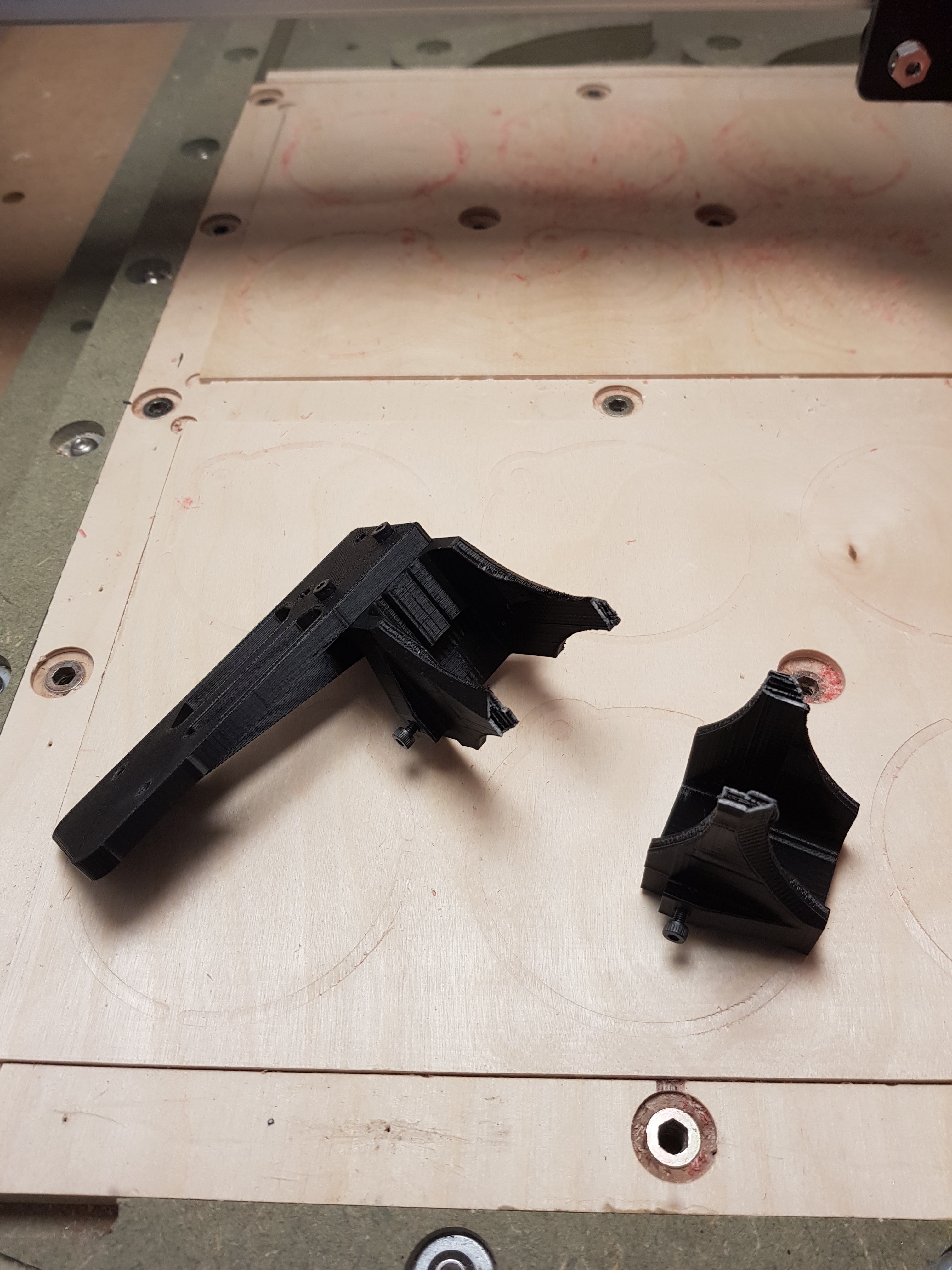

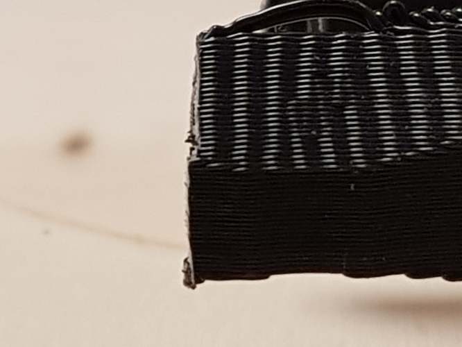

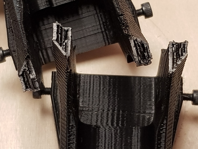

OK, so, started installing the JTech laser last night. I only installed the dust boot mount option. It was a bit tight but went on OK. Then as it was late I called it. Today went into the shop and saw that the mount had split clean in 2. I don’t mean a crack I mean complete through break in half. it was just held in place by the little screws otherwise it would have just fallen off. Some pics;
I don’t know much about 3d printed parts but looking at the cross section of the break it looks like a really weak part.
To the 3D printer guys and/ or engineers here what do you make of it? Why did it break overnight because it certainly was not broken last night it would have been obvious. Is it a temp expansion thing??
I’m waiting for JTech to get back to me.
Ouch. This is plain weird, I have never seen that happen in any of the prints I have done over many years. I dare not think that it was broken and they just glued it and the glue let go ?
Any pets (or kids) that might have done this and not confessed yet ?

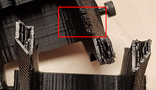

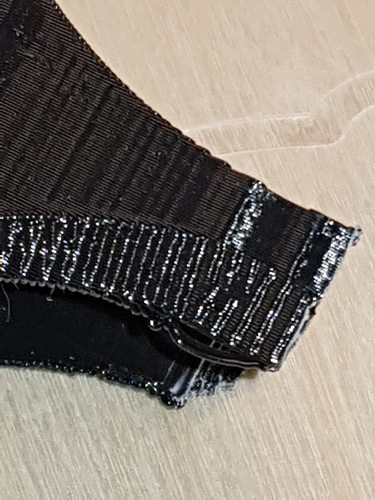

Anyway this is a poor print, regardless of the break. That part right there shows that something did not go well when they printed it:
maybe not a coincidence that it broke not far from that squiggly mess?

It’s hard to tell in the pics but has it fractured along the layer line in that narrow part of the body?
(layer line is the horizontal layer of filament that gets laid down by the nozzle leaving visible ridges like sedimentary rock on the outside)
Nada! twenty characters!

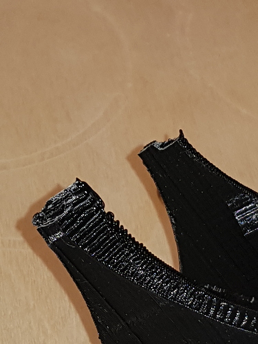

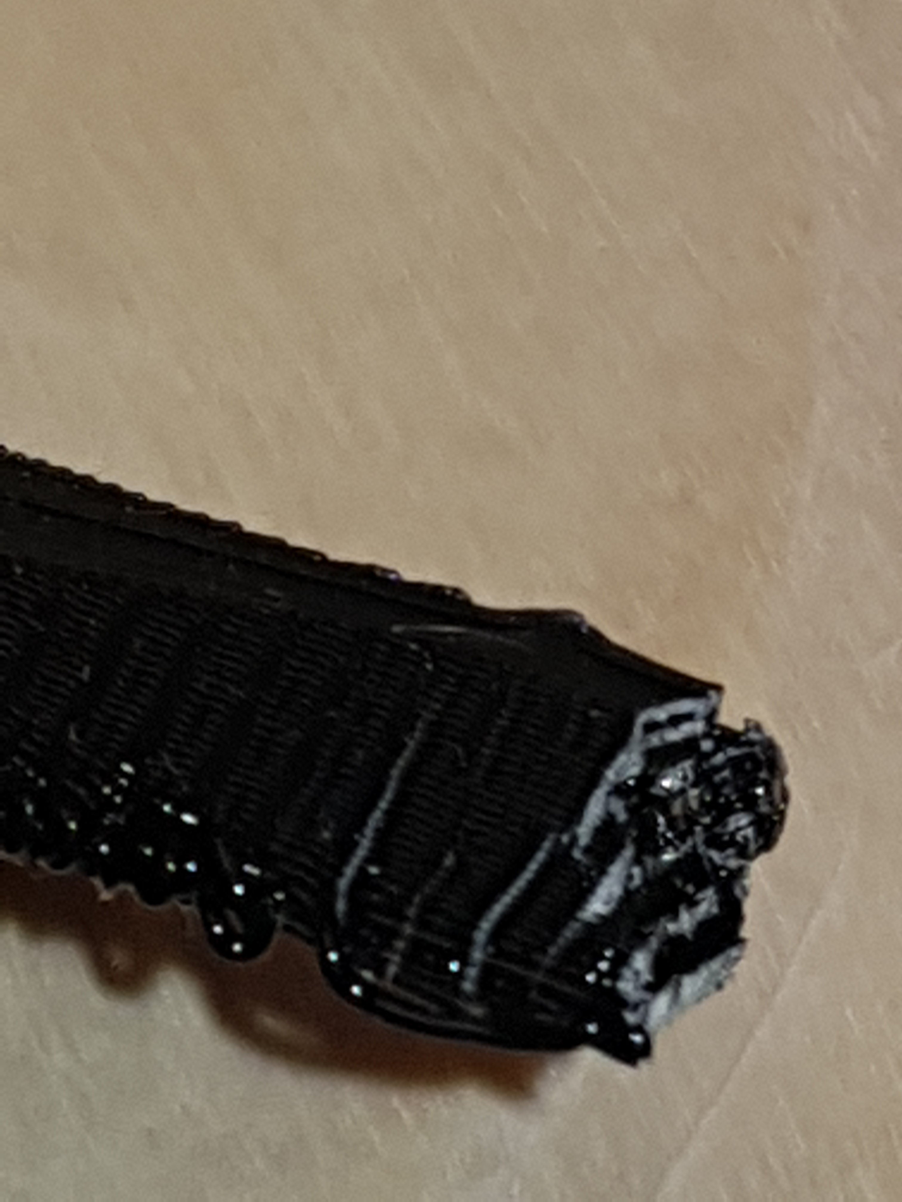

Not sure do these help. Also looking at the break it looks as though its not quite solid has voids in it, the dark areas in the break.
Hmm,
May I say “Eeeeew!” it looks like the break is actually across the layer lines not a shearing between layers which is quite uncommon. 3D print is like wood, it has very little tensile strength across the ‘grain’ which are the layer lines and reasonable strength in both directions of the plane of the layers. The part designer is responsible for thinking about how it will be printed and how to deal with the weak axis.
What’s more concerning is what appears to be a quite severe case of the wigglies and the stringies in that print. The wigglies are so bad that they looked like the layer lines to me and the layer lines looked like a textured filament. The number of under and over extruded parts (Julien identified one above) is sufficient that I would have checked the printer and slicer settings to see what I had done wrong with that part.

It looks like the design has the layer lines in a sensible direction and could work if printed well without obvious defects, so a well printed replacement should work a lot better.
Yes, but it was very late last night may be that’s a perception issue. It was a snug fit but pushed onto the aluminium mount. I did up the screws and attached the laser, gave it a little wiggle to check its security and then left it for the night. This morning went back to it just as I was removing the laser noticed that things were all loose then it became obvious why. It is possible it was broke last night and I didn’t notice.
When 3D printed plastics let go under strain it’s frequently a complex process. It looks like the print had a number of deficiencies which would give it many areas of existing weakness and stress concentration.
It is likely that as you tightened it up one of these existing weaknesses started a crack propogating through the material. These can happen quite quietly sometimes and don’t always go the whole way immediately, depending on the plastic they can continue to creep if the strain is still applied.

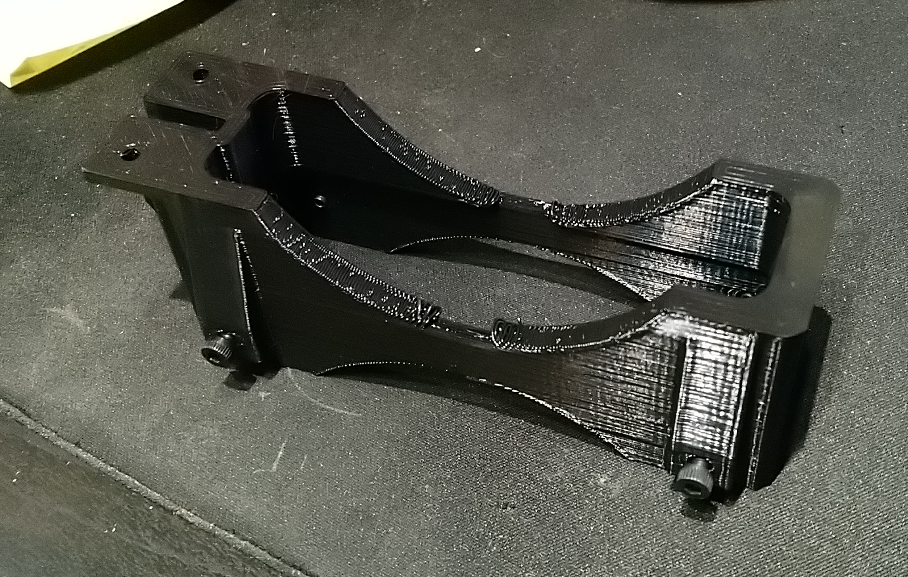

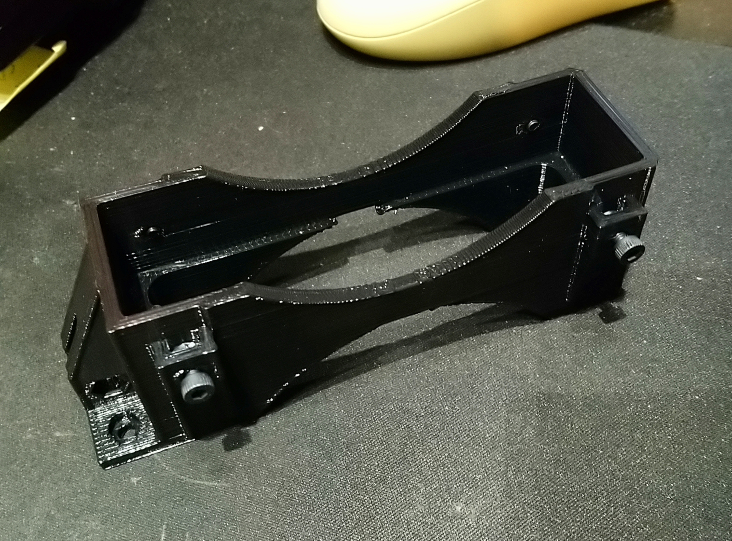

I remembered I still have the printed parts I got with my JTech back then, I never used them (just because I wanted to design a custom support)
Here’s what the part I got looks like:
Better but it does have the squigglies in the same place (but as @LiamN said, the design is printed in the correct direction, so apart from not looking great there should not be any functional impact).
Your part looks thicker at the failure point. The one I have does not have a box like profile, its sloped so there is less material there.
Yep,
That has the look of a part that is being printed quickly to increase throughput. It looks like there were no supports which would need manual post-processing and take extra time. The fairly thick layer thickness is actually good for strength as well as print speed. The squigglies are an indication that the printer is being pushed beyond the print speeds that it’s really good at in the interests of overall print time.
Nothing really wrong with it, if it works, but it’s not going to win any prizes either.
