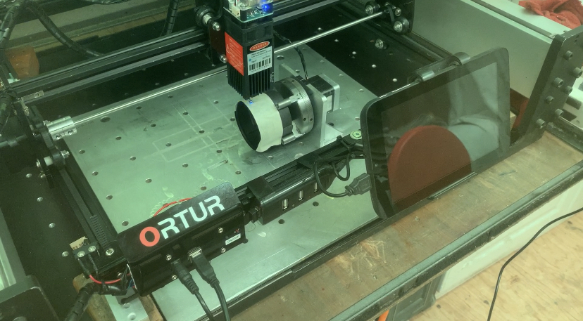

Edit (ADD), But since it is a separate machine, (and completely self contained, using my old 7" Win-Tablet), it can chug along all day long without affecting my Shapeoko output…right?

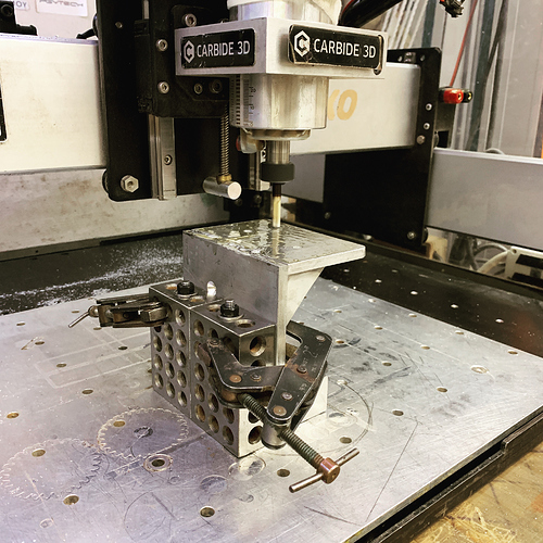

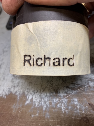

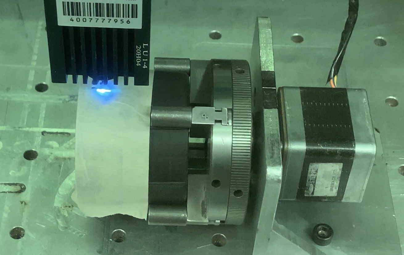

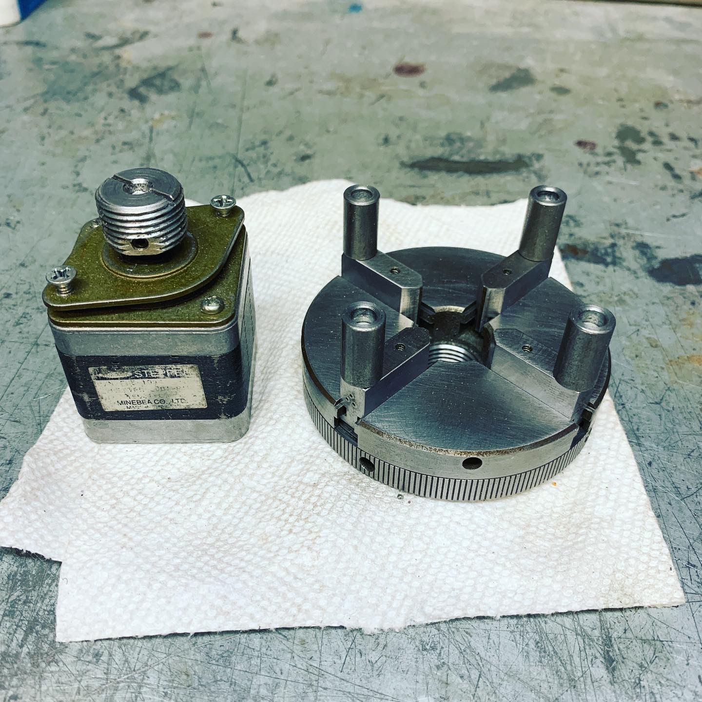

Well, not being able to leave well enough alone, I took the Shapeoko and cut out some parts for a small knee, welded it together, then machined it square on that Shapeoko. Mounted an old Nema 17 stepper, made a M/F cable to plug into the Y-Axis, made a few settings in Lightburn and BAM…it works. I need to make a few changes, but that’s for Rev B…so now…it works!
Test Burn on some masking tape/spray can top.
