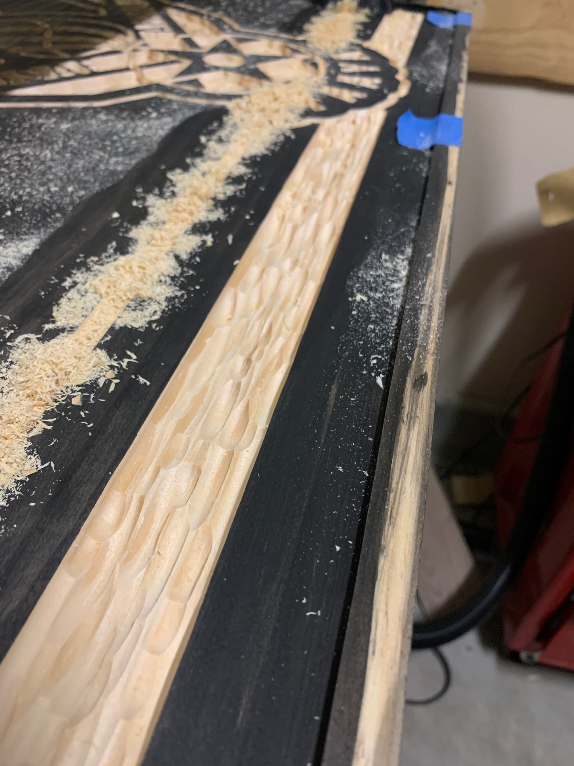

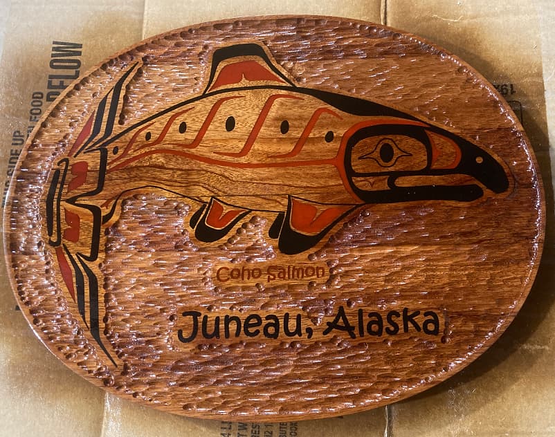

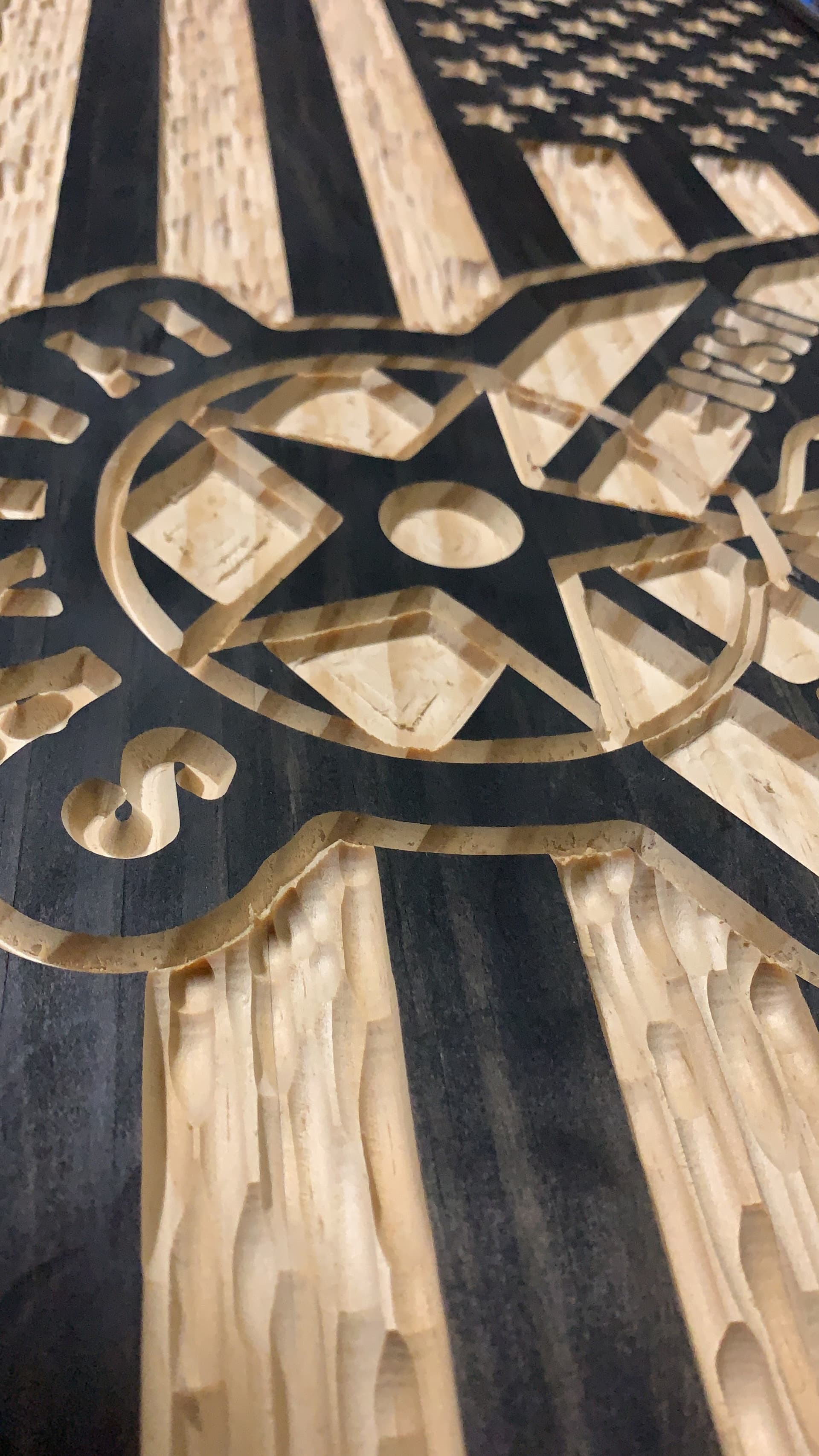

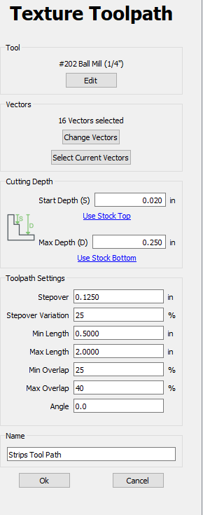

The texture toolpath cuts a single pattern/texture. You have parameters to adjust the width, depth & length of the cuts. It’s made to simulate using a gouge chisel to clear out an area. I’ve only ever used it on one project. Other textures can be made or found in STL & cut with a 3D path.

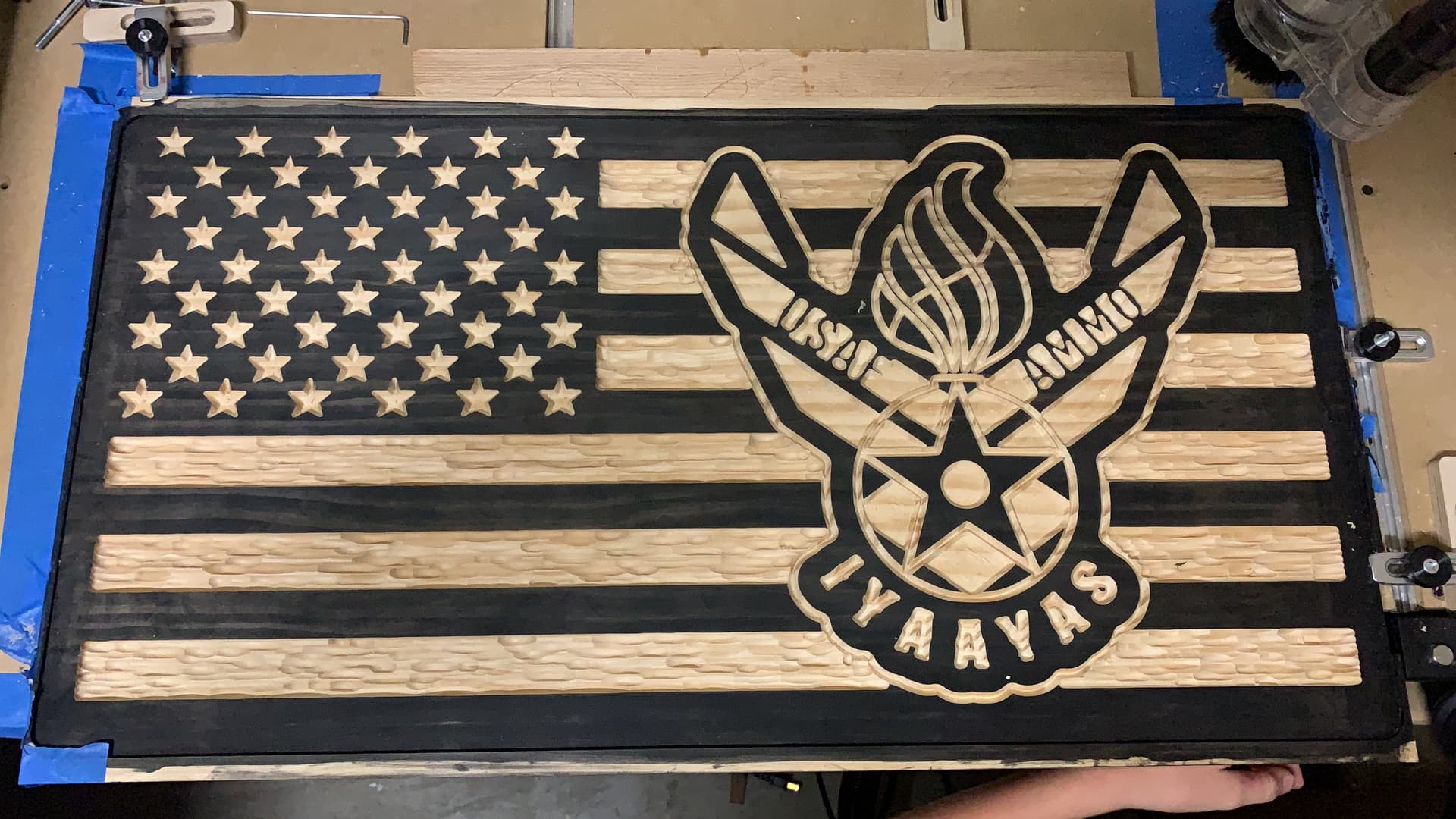

Textured Flag
@SDGuy
Nice!! That’s exactly the kind of texture I want to pull off. Nice clean edges on the flag. Would you be willing to share the tool paths?
Here you go.
Pisspot Final with Textured Stripes.c2d (2.8 MB)
Thanks! I will be using this exact toolpath on my next experiment! Looking forward to seeing where it goes!!
